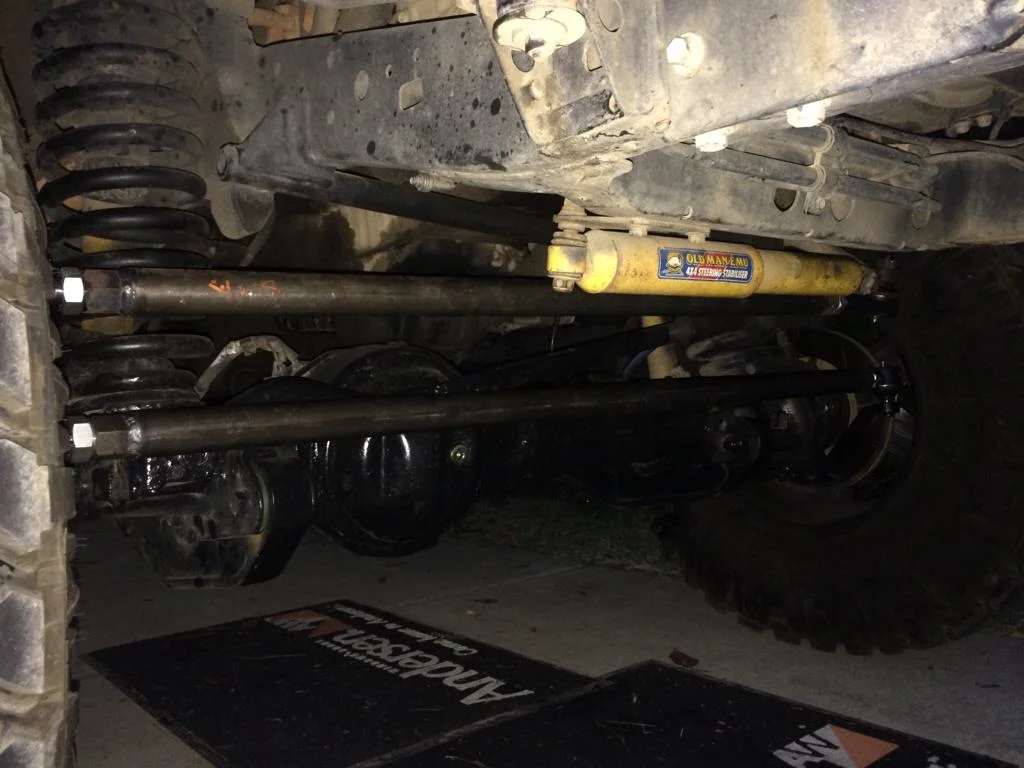

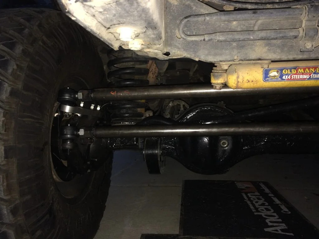

Sorry if I missed this someplace but how is the panhard addressed with the kit?
Understood the draglink under the hi steer but you still need to raise the stock location of the panhard correct?
And what about clearance between the panhard and steering links?
Thanks
-A
Thanks
-A

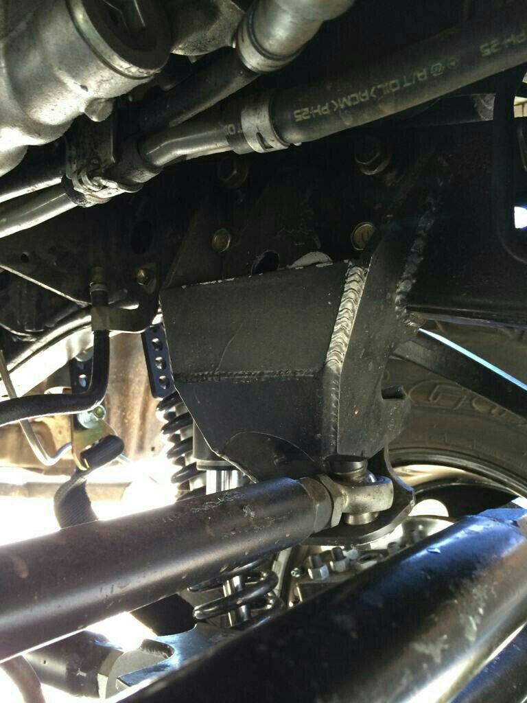

New frame mount
New axle mount, sitting behind the draglink

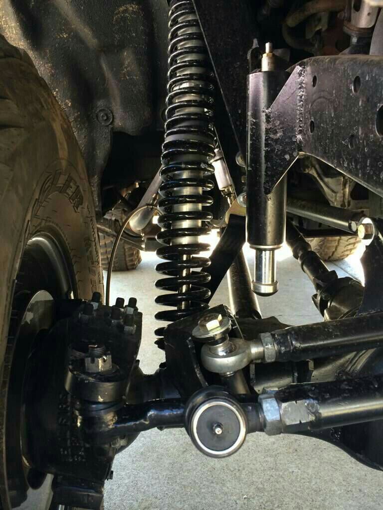

Okay so to everyone that has asked what steering do I need to run with this 3link lets go over the basics.
Factory steering will work though I recommend that after a certain point hi steer will be an asset to your performance. Lets call it after 3"s of lift I recommend going to high steer. I know Action Jackson did it with 6" and you can too I just recommend a high steer arm at some point.
Hell Fire Knuckles. First off let me say this any hi steer arm you buy will require you to run the drag link under that steering arm. This was done on purposes for clearance reasons and wheel travel. So hell Fire Knuckles require you to run the Drag link under the arm. The Hell Fire system is the only system that allows you to run TRE's instead of forcing you to run Heims. You can choose to run the tie rod in the factory location, or with a chevy Y style system or you can get the over seas arms and run the drag link in front but you will have to use heims with this last option because of limited space. We are fairly certain that you wont be able to get a TRE on top of the stock steering arm and a TRE under the hi steer arm. Just not enough room because of the tapered stud being built into them very unlike a bolt that slides thought a heim.
Slee Hi Steer. Chances are that the Chevy Y style wont work here since Slee arms are typically for heims. Beyond that the tie rod can go in front of the axle provided you have the over seas arm for double shear or behind the axle in the factory location. The drag link still needs to be under the hi steer arm.
Any questions
Theoretically you could though right? If you drill out the Slee arm and use a tapered insert on the bottom or ream it out from underneath, it should be the same as a Hellfire setup right?

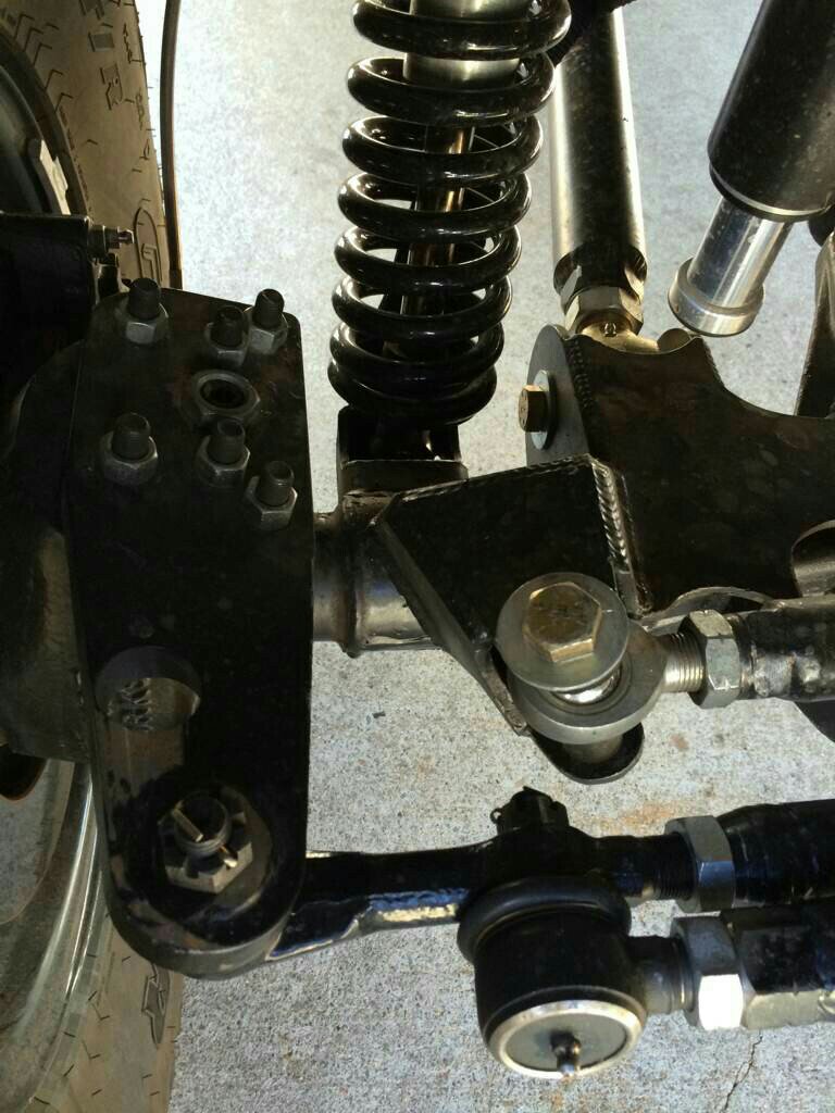

You mean something like this...Work in progress...
Going to have to switch this up a bit as Jose mentioned, drop the drag below the upper mount and run Y link most likely with coils still on the rig. Once you go to a 3 link with coil overs... That opens the doors for more options as you have way more room for brackets and such.
