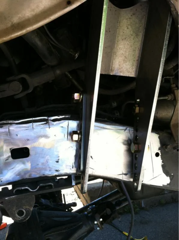

I was leaning towards the Ballistic towers because they're the only ones I know of that don't require modification and are adjustable in height. But you say these are weak. Is it because the way they bolt up? I've seen two builds on MUD using them and no issues that I'm aware of
@sorensenjg with your 3-link kit

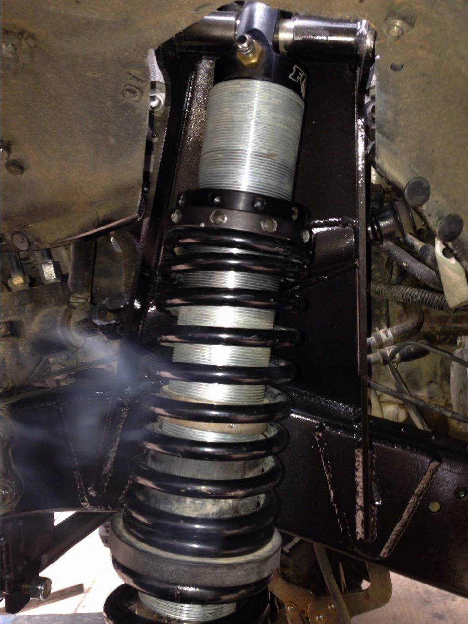

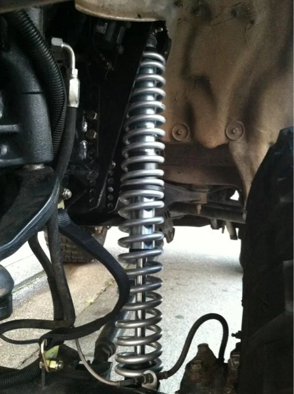

@jodo used some custom towers (made by Currie I believe?) which he had to extend in order to run 14" coilovers. No issues with the steering shaft though.

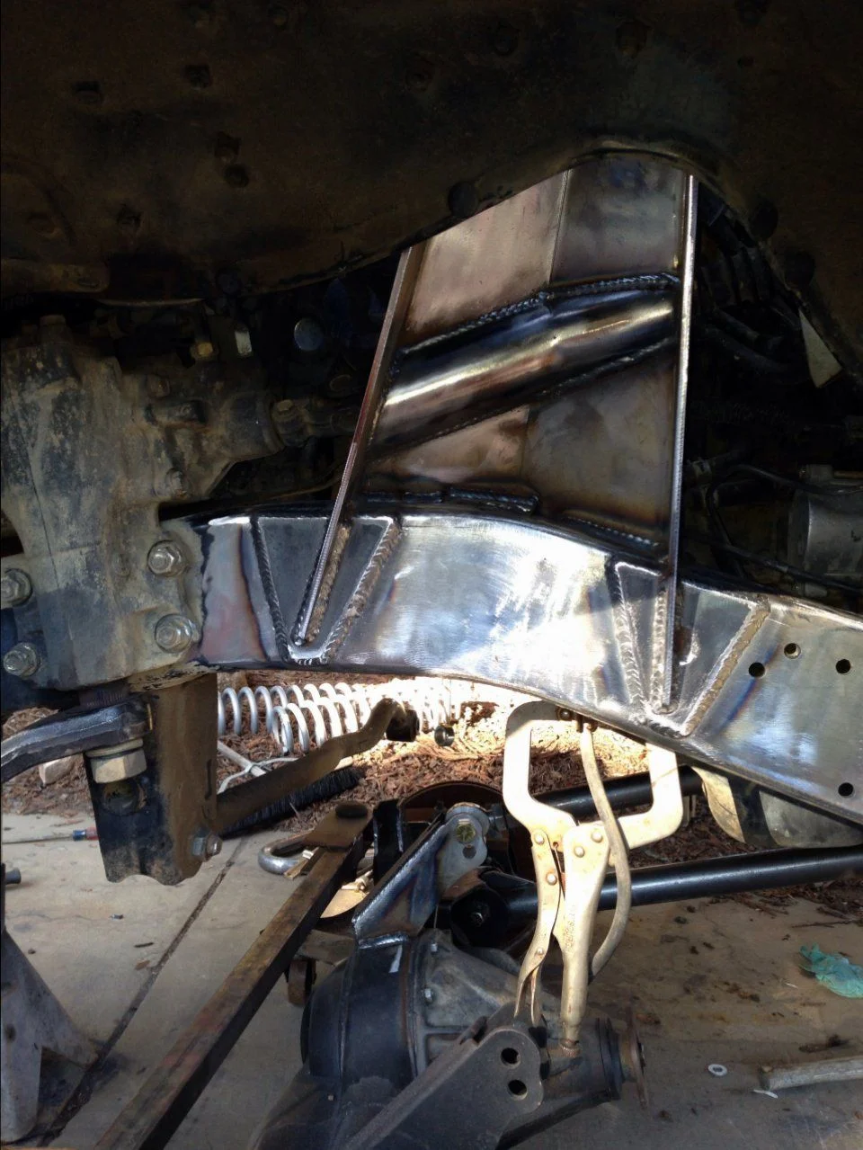

Then @Booger weldz used the Ruffstuff towers which are built like tanks, but required some notching to fit steering shaft. Perhaps I could bribe him to notch a set for me? :D
