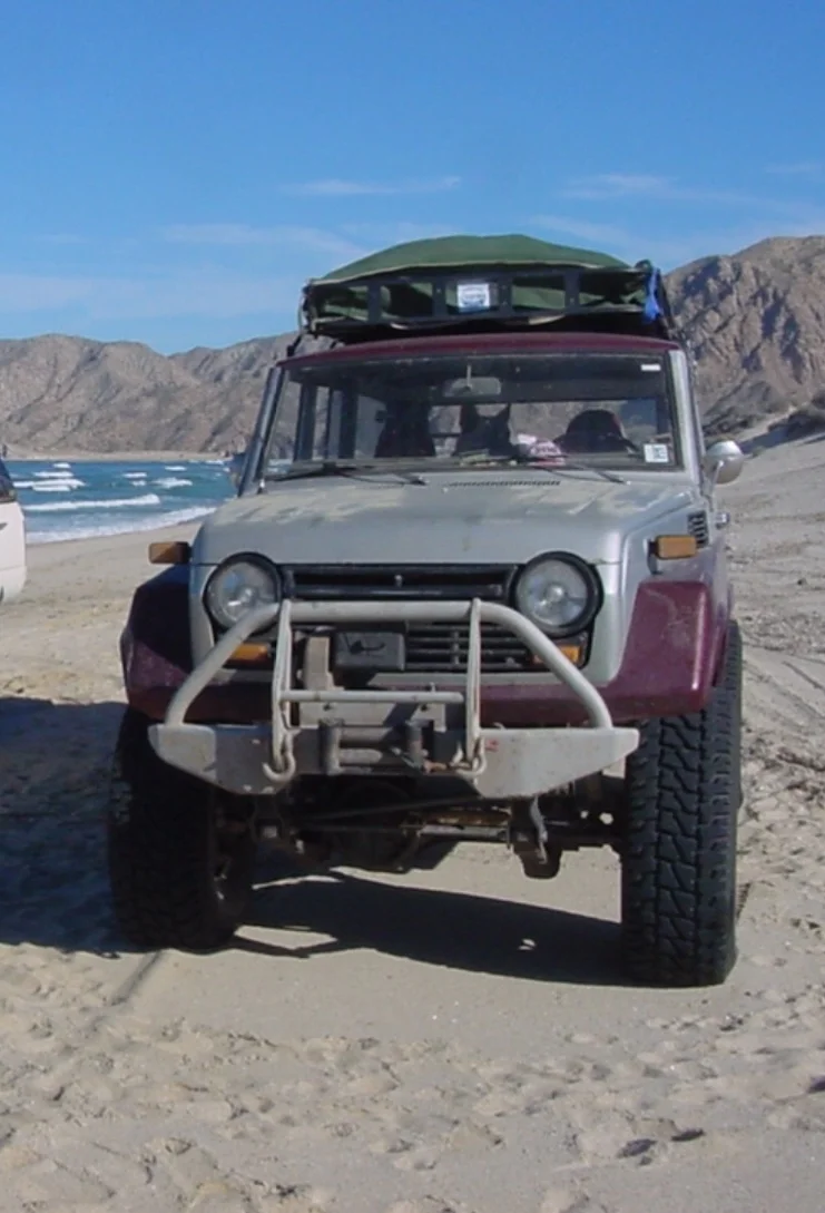

Like this one? @lcwizard might know…
Not seen on in a 55. I have a 40 and a 60 with @lcwizard stuff. Great person and products. On the 40 I have a forward rake bumper. On the 60 there is a specific bumper for the 8274.
