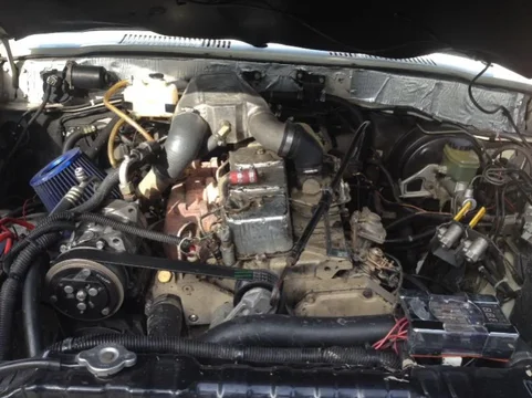

Cold out tonight but snagged a picture. Exhaust manifold will be in this orientation but have a second that I am cutting down to lower the starting bend location.
Your tensioner is in the wrong place. Looks like it could hit the fan pulley. This is how it's supposed to be setup with the 6BT accessories.
That makes more sense. It gets more wrap around the ac compressor. It just comes in contact with the fan pulley unloaded. Was planning on double checking that at some point. It does fit but was worried about the wrap on the ac.
Yessir. Swap the tensioner location and you should be good to go. I've put ~15,000 miles on that belt setup I pictured and there's no issue whatsoever.

Yes he is. He's got the same brackets I do. They came off of late 12v 6BTs.
I figured out what I did. I used the stock tensioner location and bracket for the non a/c brackets that was on my 4bt originally. I bet my old belt will fit bypassing the AC. Kind of ironic that the belt fit just adding the compressor and belt. Bet t would have slipped though.
Thanks for the help
Yes stock dodge brackets. These came of a 98 12v. I believe the top water neck had some variation through the years. And bus applications had some mid mount ac locations

You can actually leave the tensioner there and run the belt in the following configuration:
Big crank pully
Past (under) tensioner
Around alternator
back and around water pump
back and around AC
big crank pully

I'll look into that belt routing. I have the tensioner for the other set up so it's not a big deal. The are different based on the alignment dowel
