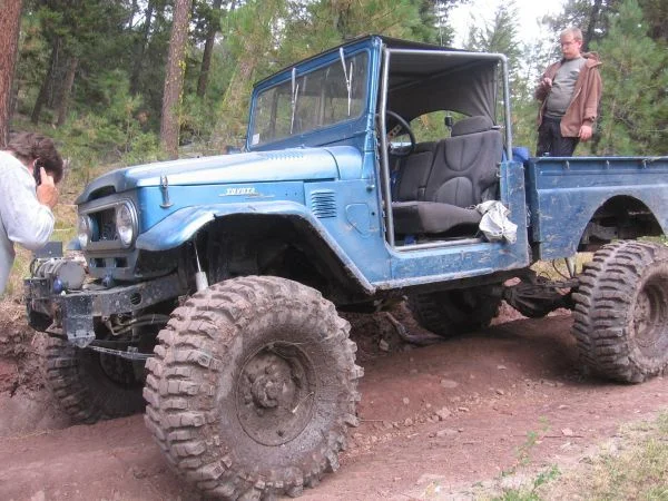

We ran into this guy on a run a year or two ago.
If I remember right he's was running a 455. Portals, 44s, coils, and missing a driveline. That much power is going to eat some s*** up. Be prepared to go monster big on everything. Pretty much nothing Toyota ever made is going to handle that kind of HP.

Actually this is Rod Peters 40. It has a corvette 350 in it. But his brother has a FJ-45 pick-up with the 454 in it. Good guy's, and great wheeling buddy's.
