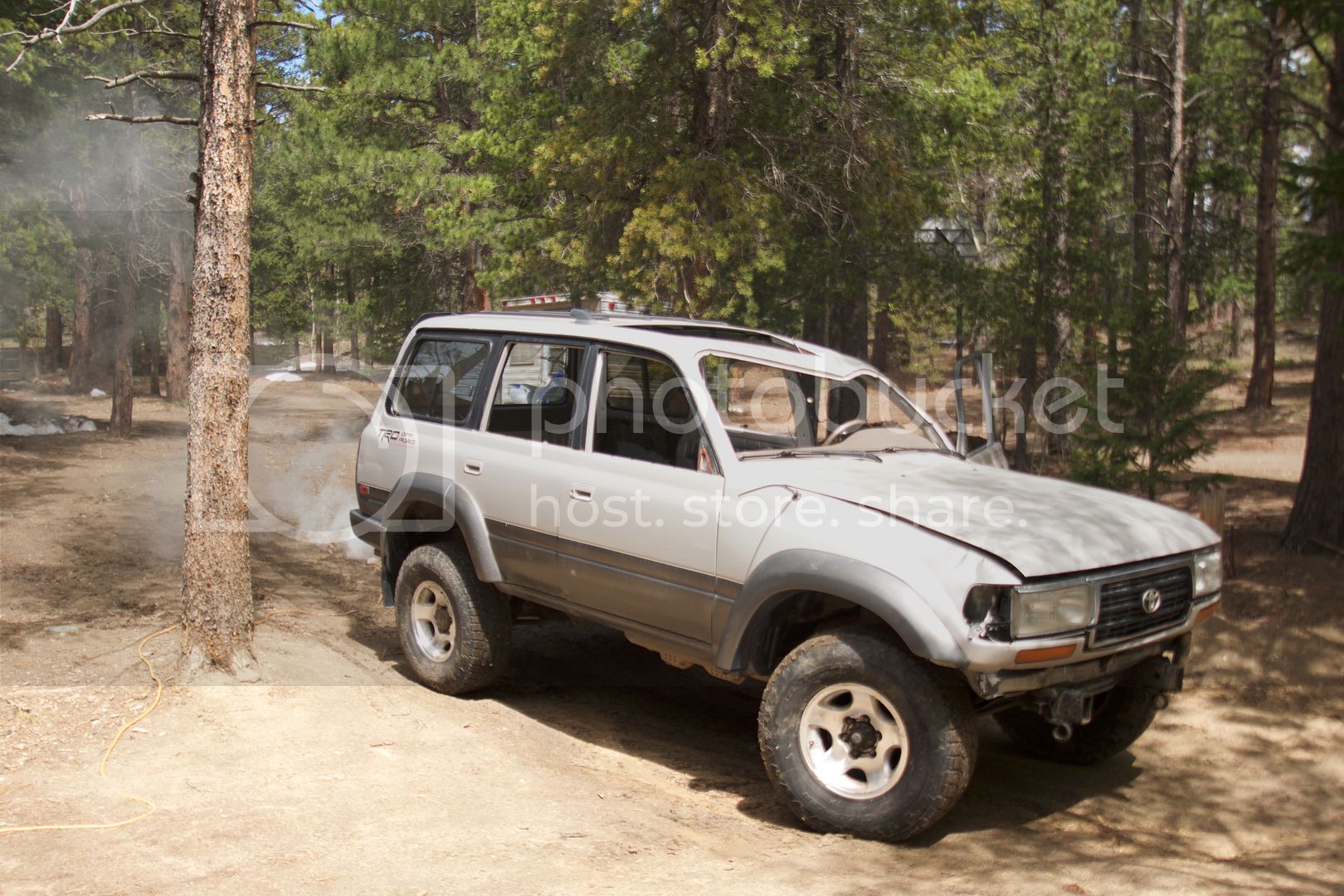

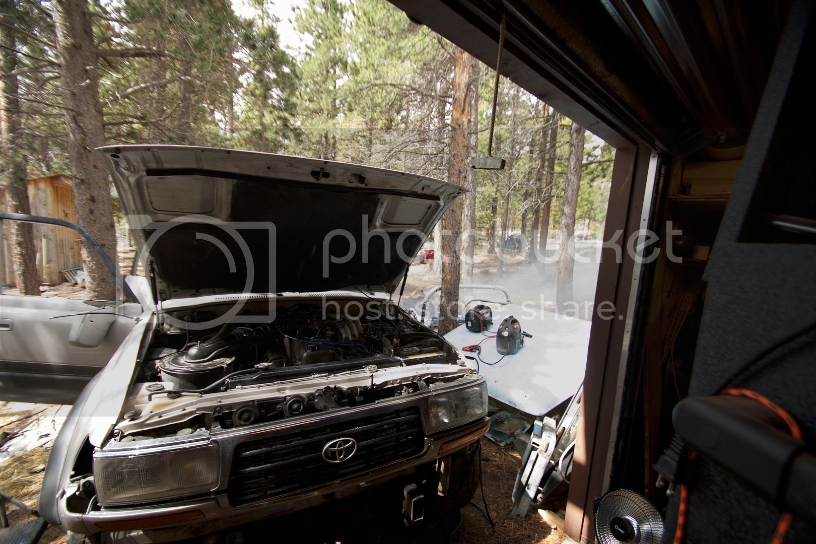

I got a TON done today. First and foremost being I got the truck to run! I spent the morning tearing the passenger doors down until my parents got back from town and showed up with a new air intake tube from the post office. With the last part of the puzzle needed (I had been using my sister's 80 as a parts truck when I had tried to start it a week ago, and ended up just buying a new intake hose off ebay for $25). I used the shop vac and some fuel line to suck the cylinders dry and then tried to crank it.... no luck. The engine sounded like it would turn half way and then struggle at TDC. I pulled the plugs back out and all of them had oil on them still. I wasn't sure what to do at this point so got a little creative.... Since the shop vac obviously wasn't sucking out enough oil, I decided I would pour gasoline in each cylinder to clean the oil out. My thinking was that the gasoline would clean up the oil, and would also provide a lot of liquid I could easily vacuum out vs the sticky oil. I did this with all the cylinders and also put a new battery in instead of trying to jump start the old battery, and turned the truck over a few times while vacuuming to try and get as much s*** out of the cylinders as I could.
Long story short, it worked like a charm! I cleaned the plugs off with alcohol and threw them in and the truck fired up like there was nothing to it!
It smoked like a mofo for awhile, though not surprising since it literally had 1+ quarts of oil in the cylinders (based on how much I had to fill the engine back up with). I put a camping chair in it and drove up the road a little bit, and she ran like a charm! Sounded totally happy, and not even a check engine light! (Though granted those usually pop up after a few miles, not a few minutes, of driving)
I took it through the gears and low range and everything seemed to check out great!

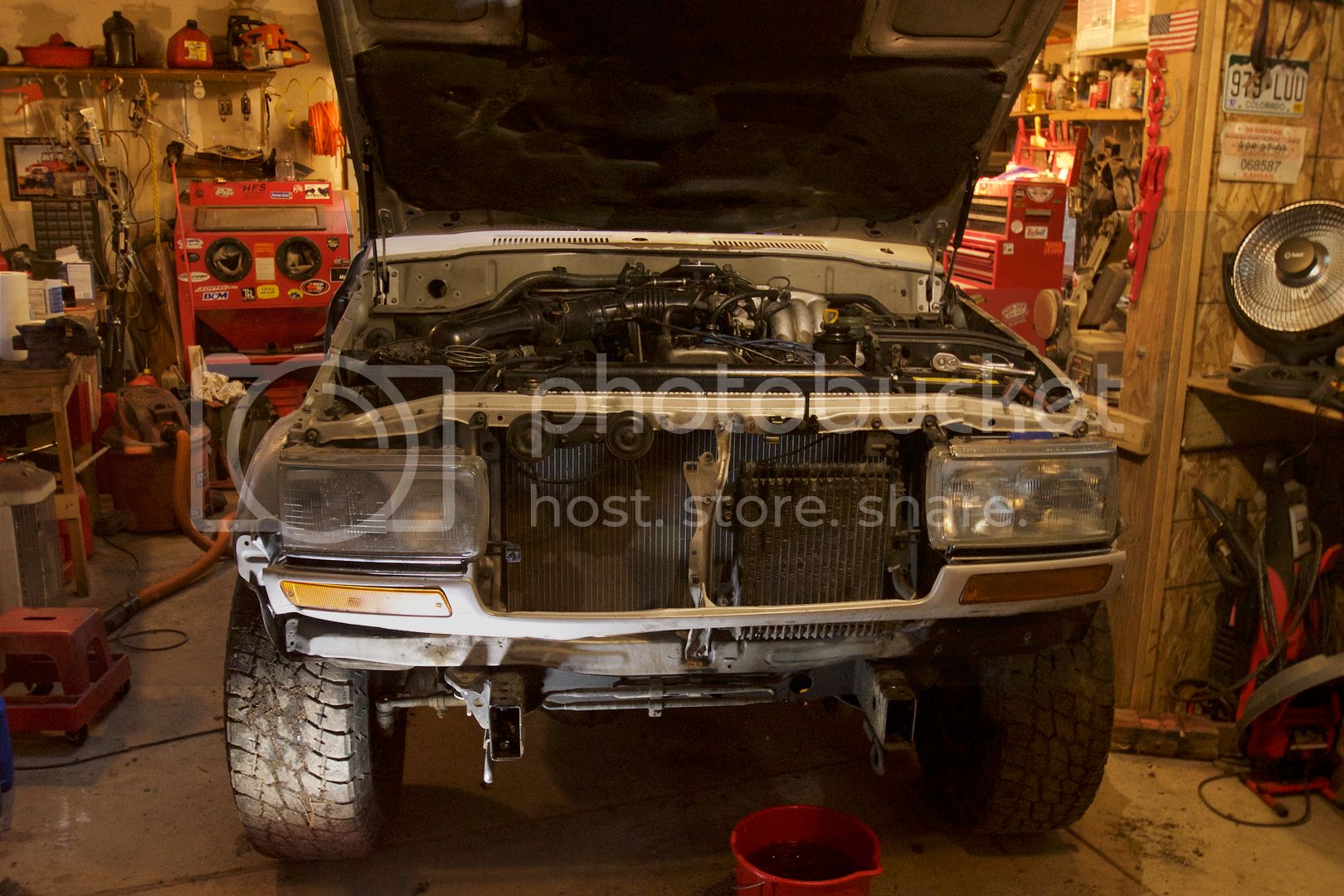

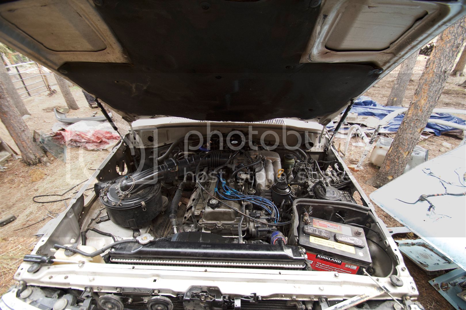

The passenger side is starting to clean up nicely. I'll figure out what emissions stuff I can remove and hopefully clean up the drivers side a bit.

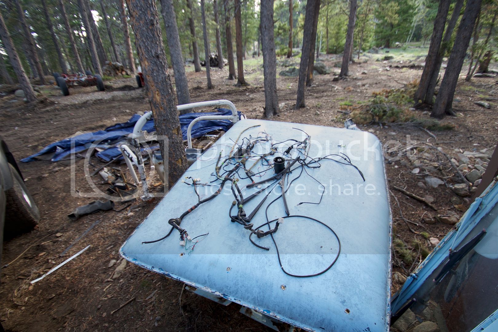

At least since the 80 isn't super new, the wiring is pretty easy and straight forward to pull out and not worry about it ruining something. This weekend I will probably order some wiring from Painless so I can start hot wiring the ignition and integrating the master kill switch.

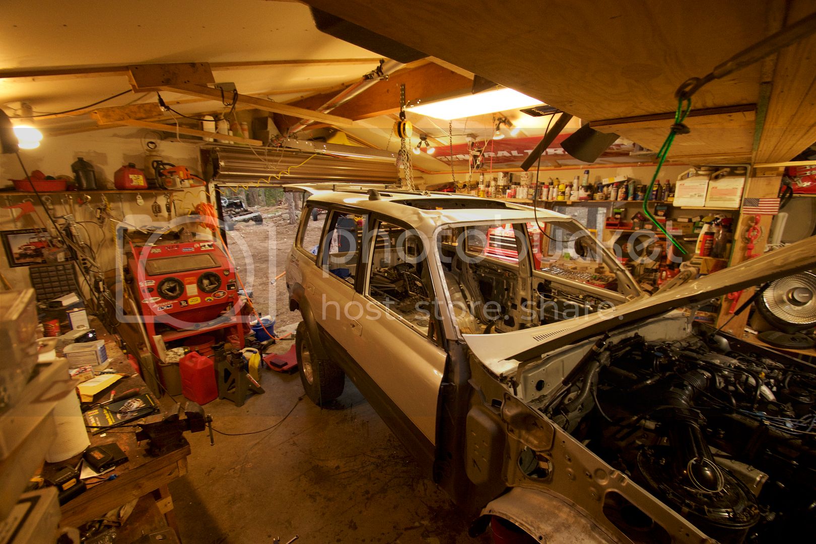

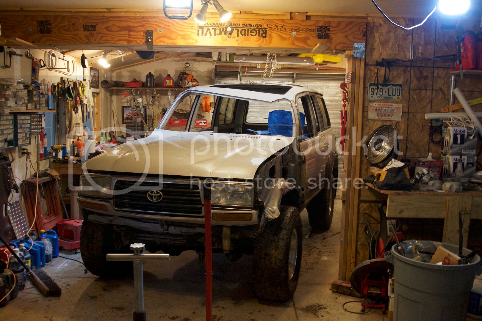

And then here is how the truck wrapped up the night:

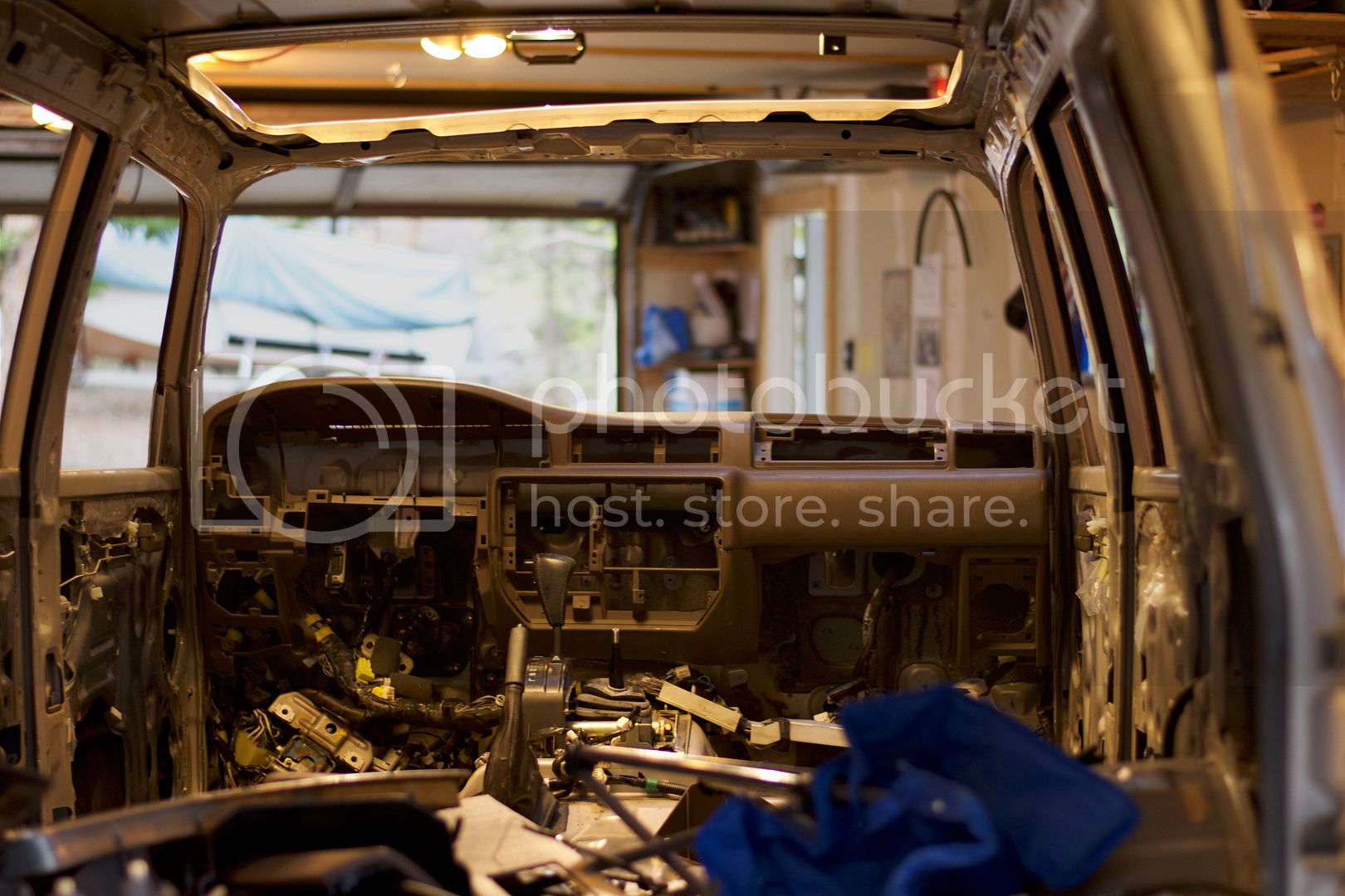

I wasn't really planning on taking the dash off completely, but halfway through chasing wiring and crap I didn't want, I decided I should so I can replace the cross member piece with the cage plus be able to 100% remove any thing (like the ventilation system) that I won't use to help save some weight and complexity.
I will probably order seats this weekend and also a quick disconnect steering wheel. Using the 80 wheel would be cool, but it's not practical really. I still plan to use the majority of the dash to keep the control area still "obviously an 80". This weekend I will probably order tubing, or pick some up next week, so I can start laying out the cage. The truck is coming apart very nice and easily so far (knock on wood), so I'm exciting to start transitioning from tearing down to building up. I am flying to the East coast tomorrow, so there won't be anything exciting until Wednesday. Happy Memorial Day!

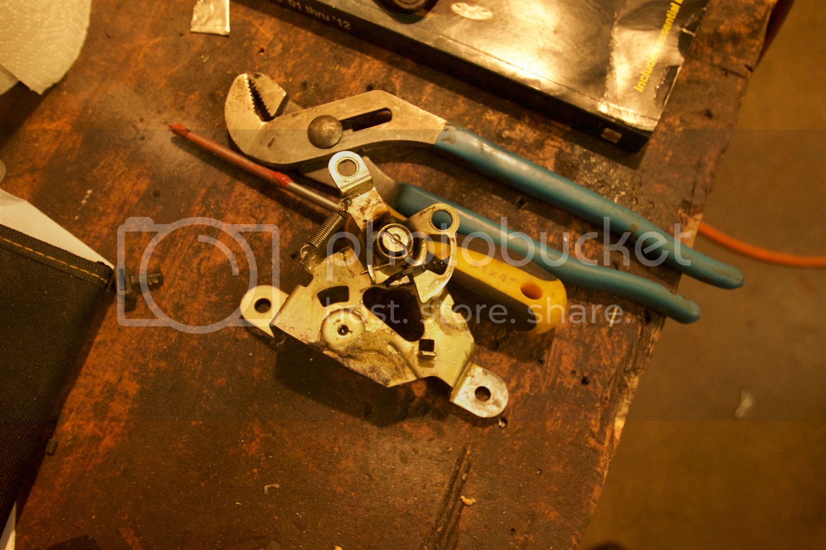

What are you using for latches? The only kind of latches I really picture are like tool box latches or bathroom ones, which I feel like probably aren't what most people use haha
On the front doors I use the factory latch as my primary and a spring loaded pin for my secondary. For the tube tailgate o use 2 spring loaded pins.

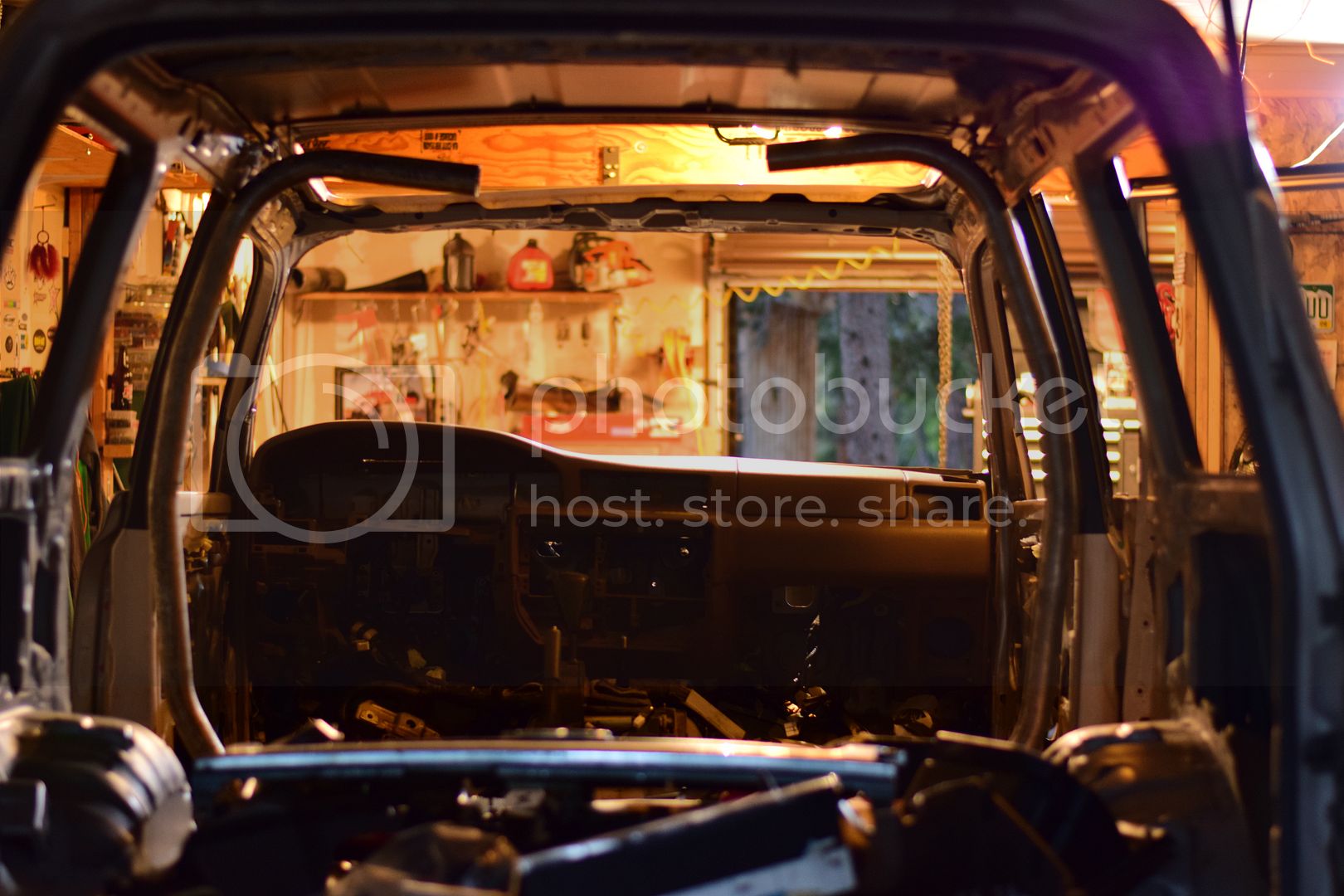

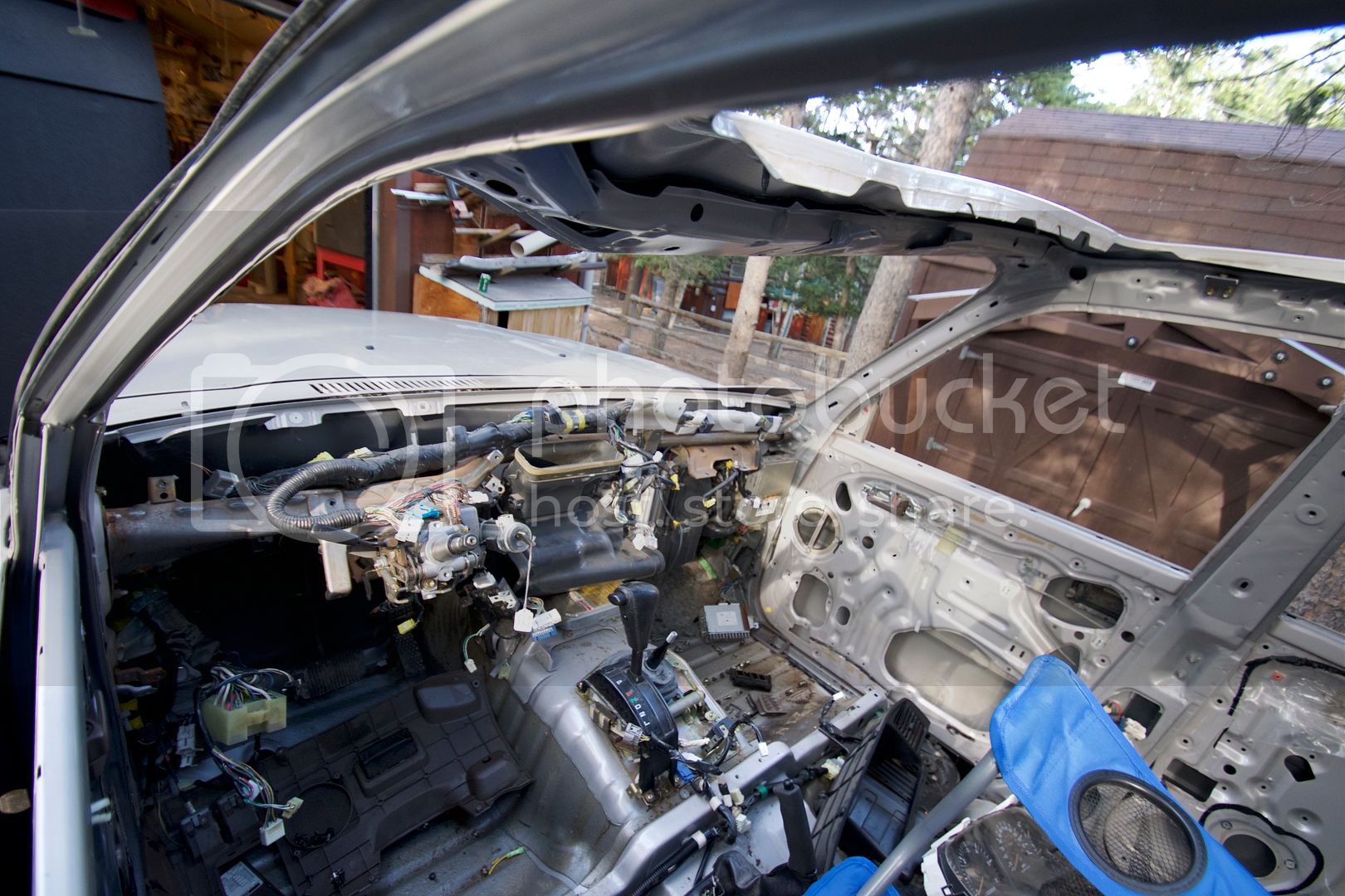

I spent all weekend in Kentucky with relatives and got back today around 2pm. I spent a few hours working on my girlfriend's old car so we can sell it soon and get it out of the garage, once that was taken care of I pulled the 80 in since it was raining and started working on it.

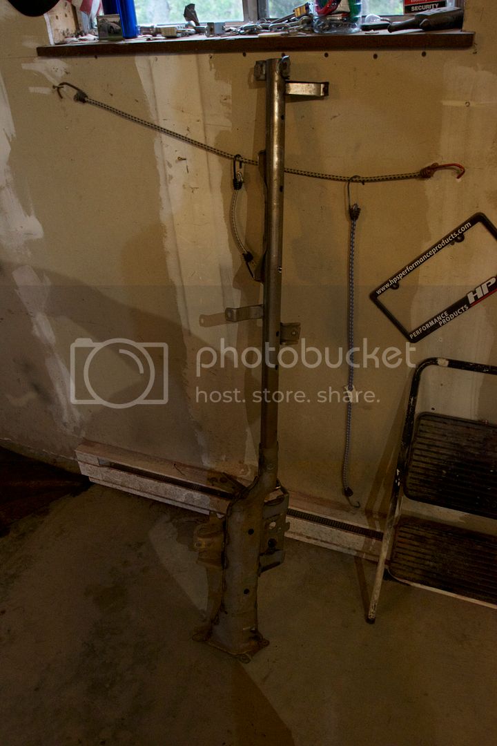

The first major thing I did was finish tearing out the dash cross beam.

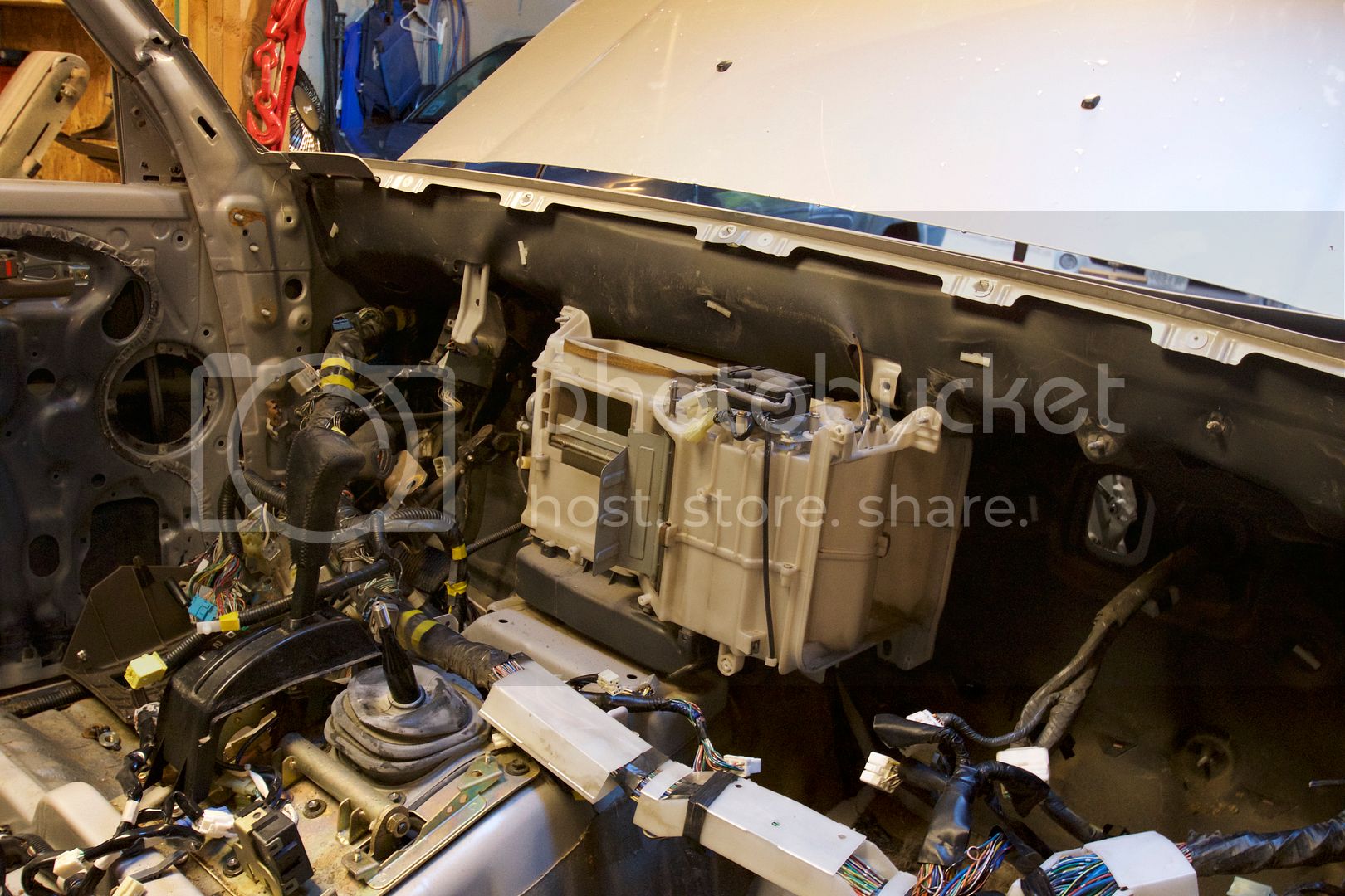

After that I set to work tearing out everything behind/under the dash, meaning all the climate controls essentially. This then lead me in a circle of working with the engine bay and the inside of the truck. I was able to take out some of the A/C system, so all I really need to do to fully remove it is to tear the compressor out.
I finished tearing out the fan assembly on the inside as well as the A/C assembly. This left the heater core. I spent awhile screwing around with all the hoses in the engine bay, I got most of them and took the heater control valve out. The remaining hoses/hard lines run to the rear heater. I may end up just leaving those hard lines in unless I can easily reach all the bolts holding them on since it's obviously a tight squeeze between the engine and firewall there.
And that's about all the work I was able to get done today.

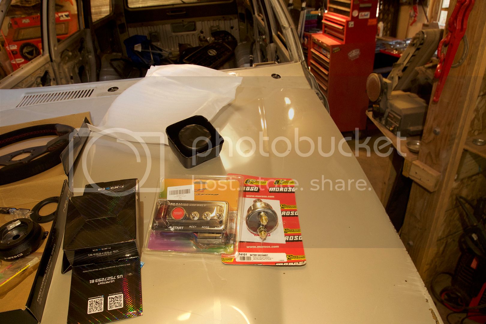

I ordered a pair of PRP seats from SRQ Fabrication, those were a pretty penny... Also ordered a NRG steering wheel and quick release, and lastly ordered some electrical switches. So essentially I've ordered a lot of the items I'll need to start planning out the cage. I realized today that I'm ripping out everything the dash bolts into normally, so if I intend to keep the stock dash I'll have to put mounting hardware on the cage.

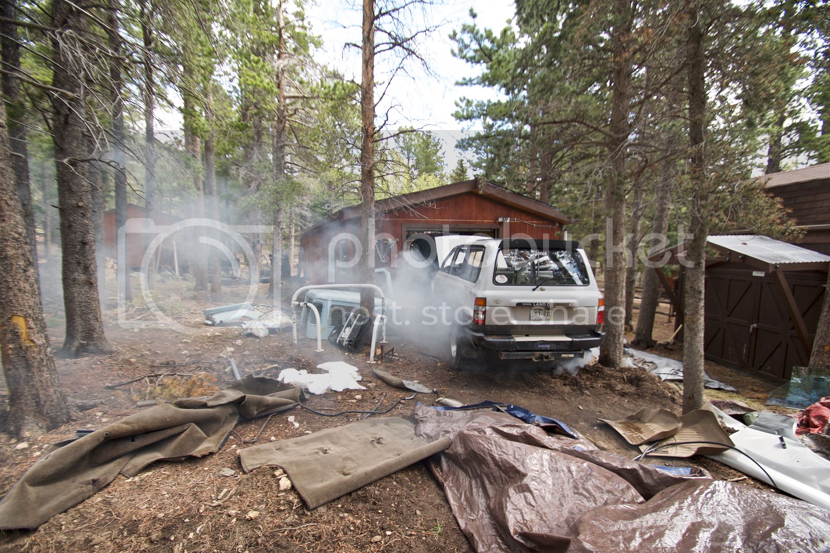

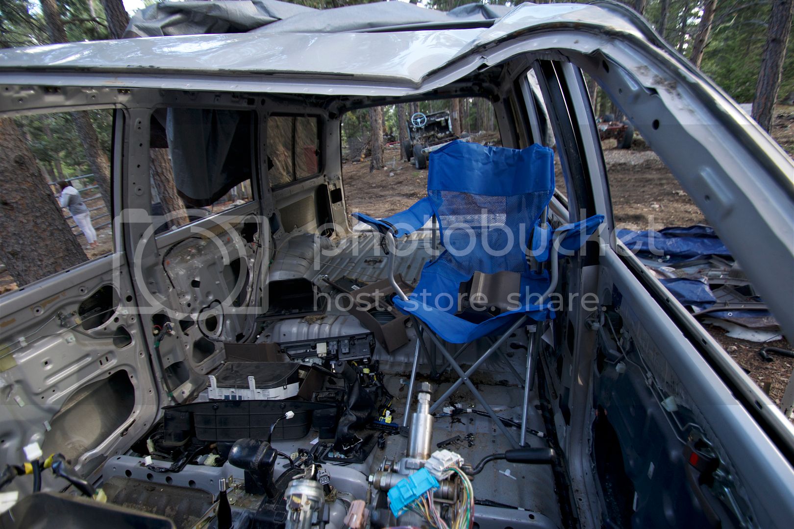

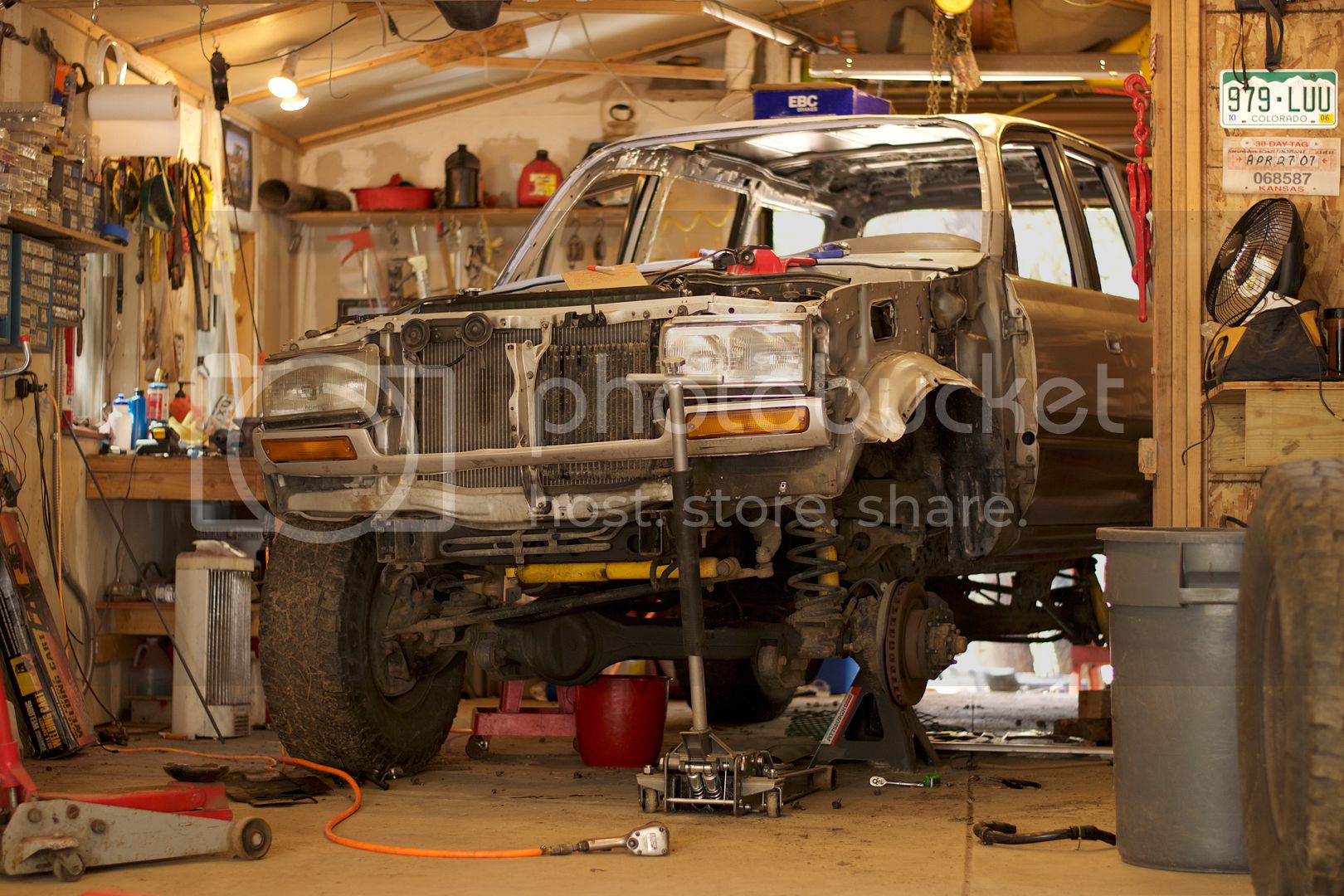

I pulled some of the coolant piping out for the rear heater along with some heat shields, though can't quite get the last heater hose on the firewall. Gotta love inline engines where there's 1" of room between the engine and firewall... I kinda doubt I'll ever get those pipes out, but every other coolant and A/C line in the truck has been removed.

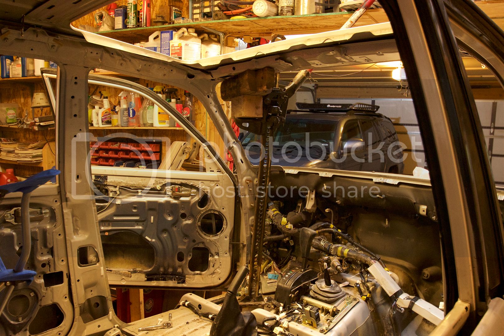

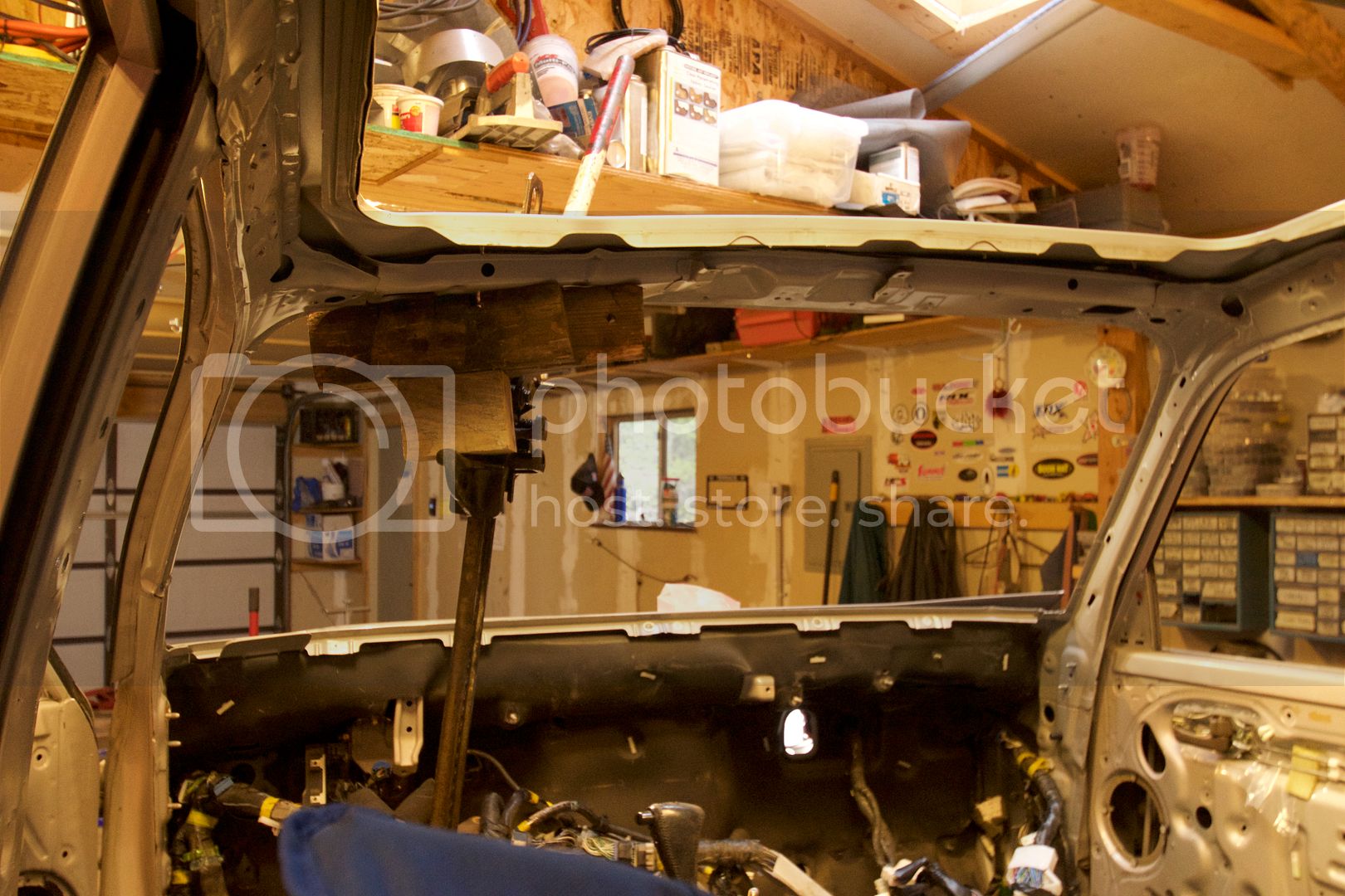

I then went and jacked up the roof.
Kinda sketchy, at least nothing could fall and kill me though (or less likely). Old 48" hilift wasn't quite tall enough, so had to add that extra 4x4 cube. I used a big block of wood at the top to try and distribute some load instead of just crushing part of the roof with the jacks claw. It actually worked out great, I had to go back a second time since I was an inch short of what the passenger side was, and after that it was as close to perfect as I was gonna get it.

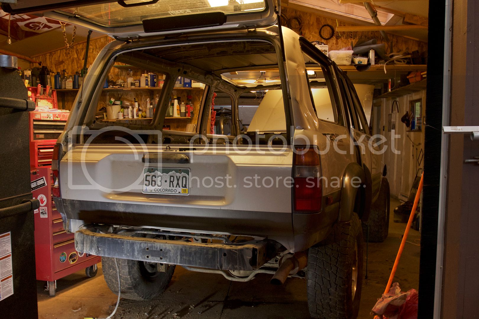

After that I removed some miscellaneous brackets and wiring/door sensors and then removed the back windows. Sadly I destroyed the framing on the passenger side (the glass panes themselves are fine) until I found out at the very end that the entire window assembly is literally just pressed in place. Drivers side I just went around with some flat heads and popped it all out as one big blob. Following that I yanked the spare tire and corresponding assembly, then the hitch, and finally removed the bumper pieces that were irrelevant.

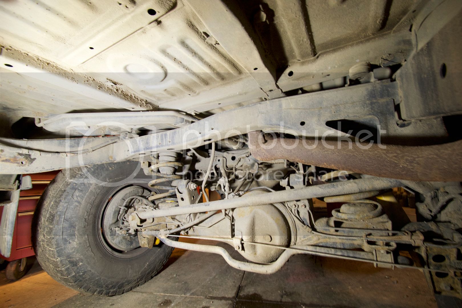

The exhaust is heavy, I would drop it and run a short dump in front of the rear tire. Get under the hood and start pulling s*** that's not needed, all the AC, evap canister, heat shields, cut some holes in the hood between the bracing, yanking the wipers and motors. Cut the big chunks of frame overhang off the front and rear and tie them together with tube. Not sure if you can but maybe get rid of or significantly trim the inner fenders? Can you loose the headlights? They are glass and not great anyways.

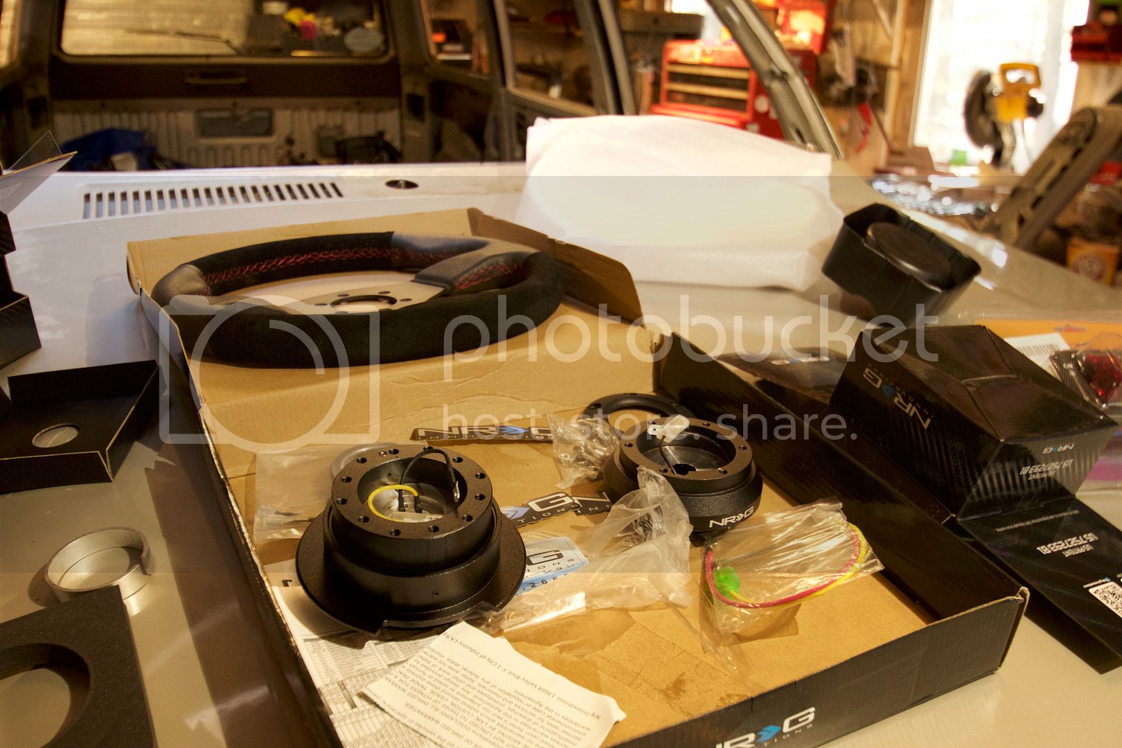

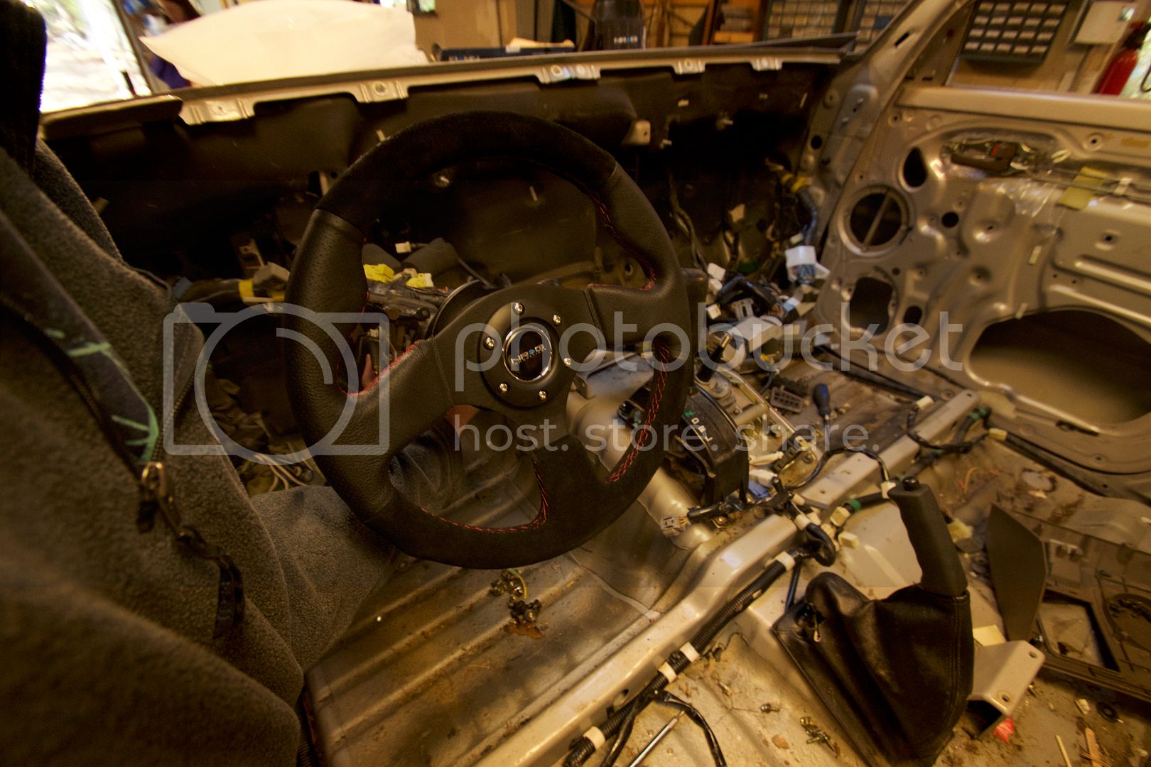

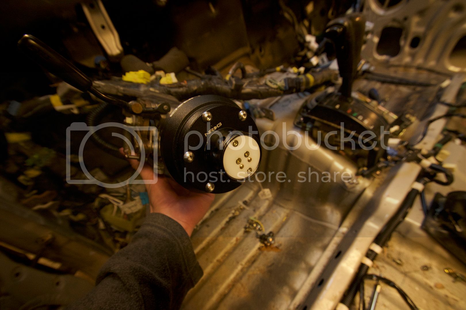

Didn't get much done today. I got the steering wheel and some switches in.
It's super ricey and seems like something a 16 year old would put on his Civic, but I must admit it's pretty fun to play with and should make climbing out of the truck a little easier.

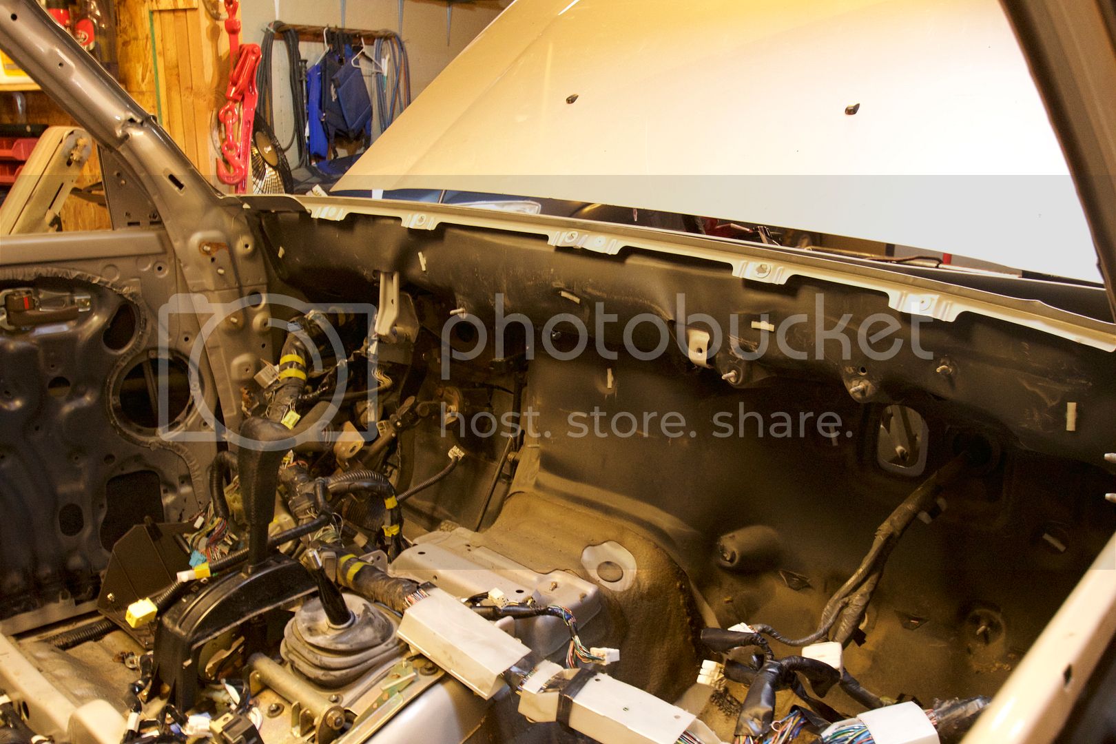

I took the remaining rubber blanket/insulation off of the inside of the firewall. That was kind of a bitch since I had to unbolt the two pedals to yank it out fully. Then removed the windshield wiper actuators which was annoying since I had to pull the hood, I'll just leave it off for the time being. After that I started to focus on the rear hatch which I haven't touched so far. I gutted the top half and decided it'd be cool to have the handle/latch still functional. The stock assembly is a cluster of locking and moving mechanisms.

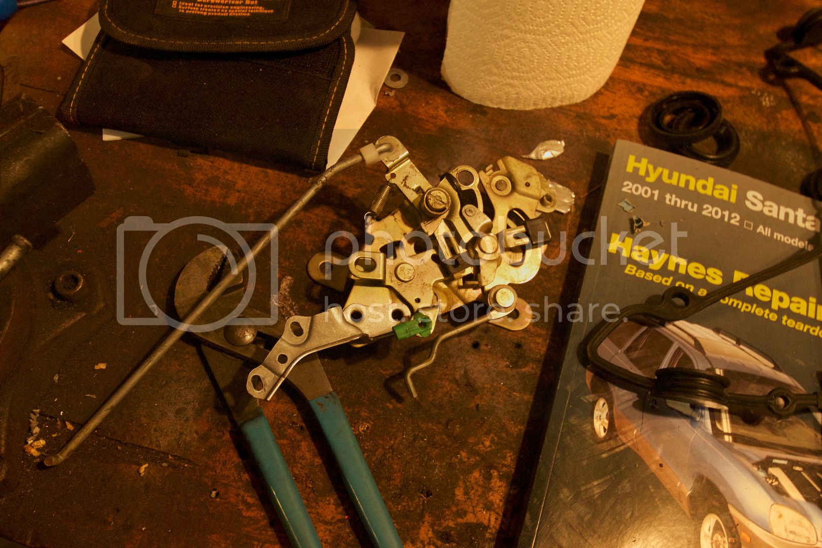

So I simplified it a bit, and it works like a charm! Top half opens and closes just like normal but everything else to add complexity is removed.

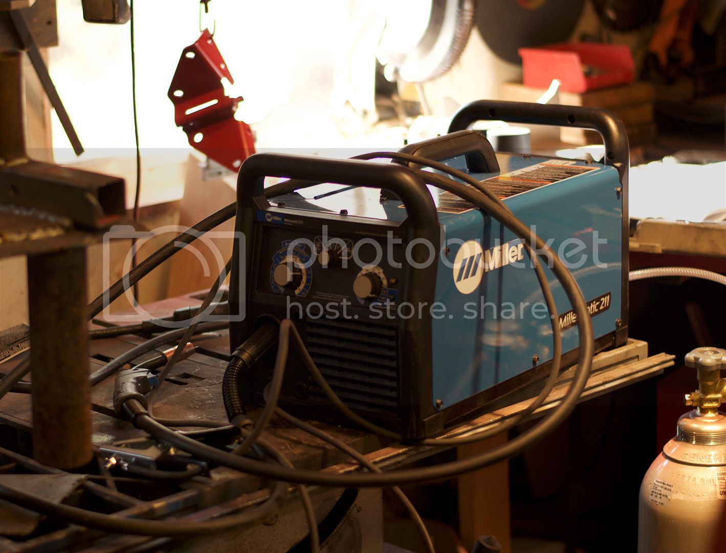

On Friday I went and bought a Millermatic 211 to hopefully help step up the fabrication game. The thing is a HUGE improvement over the old Harbor Freight welder I've always used. I was even able to do some decent (imo) overhead welds on the first try which I've never been able to do with the old welder, and the beads in general are way better and fatter and far more consistent.

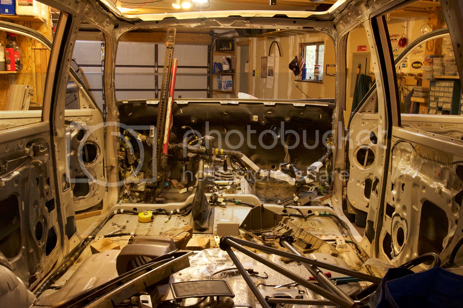

Today I pulled the rest of the rear wiring out, though still have to keep the harness in place for the fuel pump and also need to figure out if there's any reason to keep the passenger side harness (it crosses over near the shifter to tie into the driver's side harness); otherwise all the wiring in the back of the truck is yanked out. Once that was done I started caging finally! Yesterday and today I played around with the cage in CAD, which was a pain in the ass in SolidWorks so I ended up just parameterizing cage requirements for myself. I did a quick long hand and then a FEA of the cage stand offs from the frame I'll be doing. Originally I thought I would need the stand offs for the A pillar and B pillar, but turns out I just need it for the A pillar.
