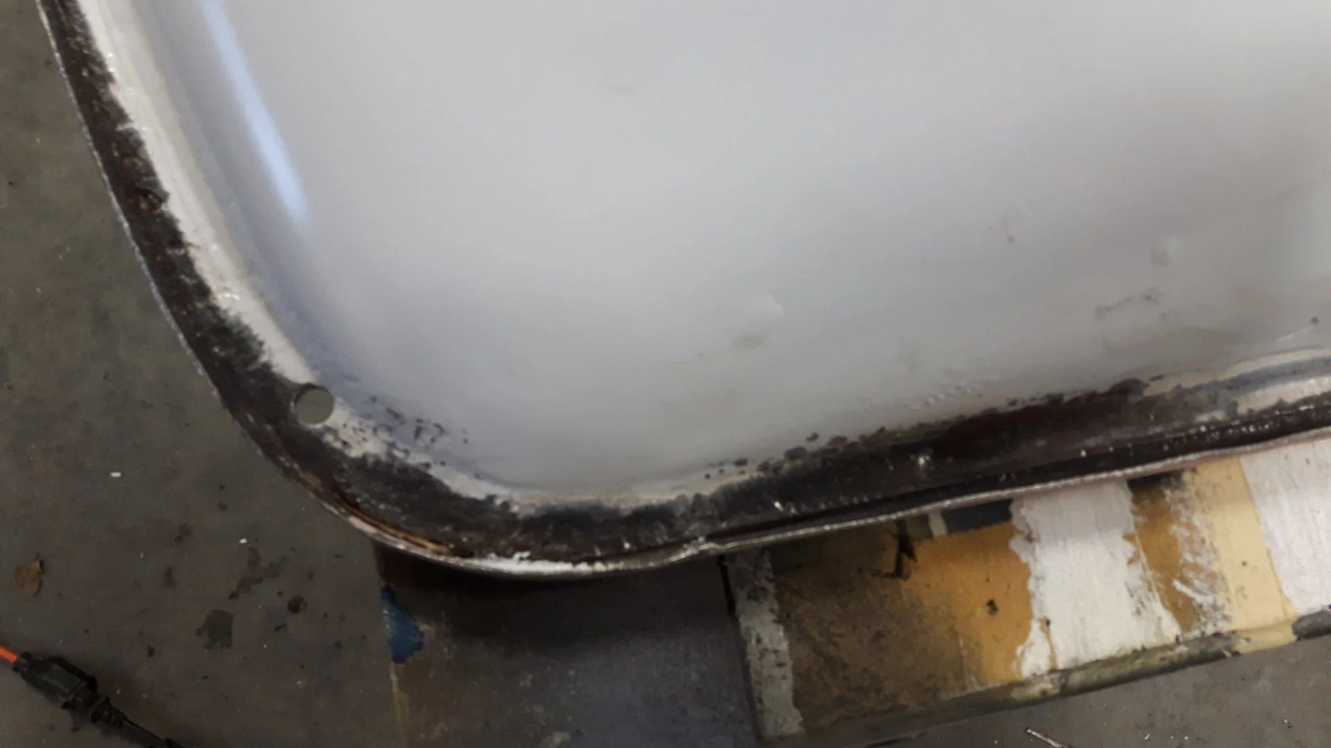

Just finishing some body work on my roof and was wondering about the best way to apply the seam sealer? Any tricks??
Thnx dan
Dan, That roof is too far gone. You better send it up to PG so I can dispose of it properly for you :grinpimp:.
All kidding aside, I would Rust Mort the seam then sandblast the gutter and then epoxy prime. Might take some time to find but I believe buckroseau went into good detail using self leveling sealer on his gutters on his LV build thread. Just my 2 cents.:beer:
