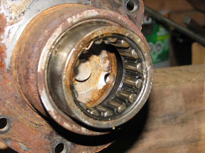

got the bearings out anyways, as Mr Kay would say, ******* the pusher... ( it blew an o-ring...hence the puddle of goo and me goddamning it :rolleyes:)
if your wondering at this arrangement for getting the bearings out, I once tried the slide hammer method, borrowed a big one from work, and succeeded only in giving myself the classic slidehammer pinch.
at that time I had the diff out so it was a bit easier to jack from the pumpkin hole, but this worked.
Anyone know which way they're SUPPOSED to go back in? they came out with the open side of the bearing facing out, just want to make sure that's the right way.
I don't have a manual around with shiny pictures for me to look at.

i have always just busted the rear semi float bearings out with whatever, hammer, screwdriver, chunk of round stock. it's the race in the housing that's a bitch. pull the seal and smash away.
you having trouble getting the race out? a little trick i learned is to put a bead of weld ON JUST THE RACE ONLY, right in the middle of it all the way around.
shrinks the bastid just enough to pull out with your finger (when cooled of course).
new race taps in like a good thing, and i think the bearing only goes in one way.
it's been a while, so i might be talking out my ass... but that's what i remember.

nah, no problems.
I made a little hunk of metal that fits inside the axle tube and when you turn it sideways it catches the edge of the race.
So the bearings, race and seal all pop out in 30 seconds with the this method, provided your jack doesn't suddenly spring an arterial leak...works great.
Easier with the pumpkin out, but I was too lazy for that. had toyed with the idea of end for ending the diffs and doing the knuckles but I'm putting it off...:lol:
still, got the second one loose, and two whacks with hammer and it was out.
Not looking at it right now (still in exile) but I think the bearing could be tapped in either way, straight cut and all, might have a bit more chamfer on one side tho. and if that chamfer agrees with the way the old ones came out, that's how I'll stick them in.
it would get more oil if the open side was in, that's why I sortof wonder if they were in right.
