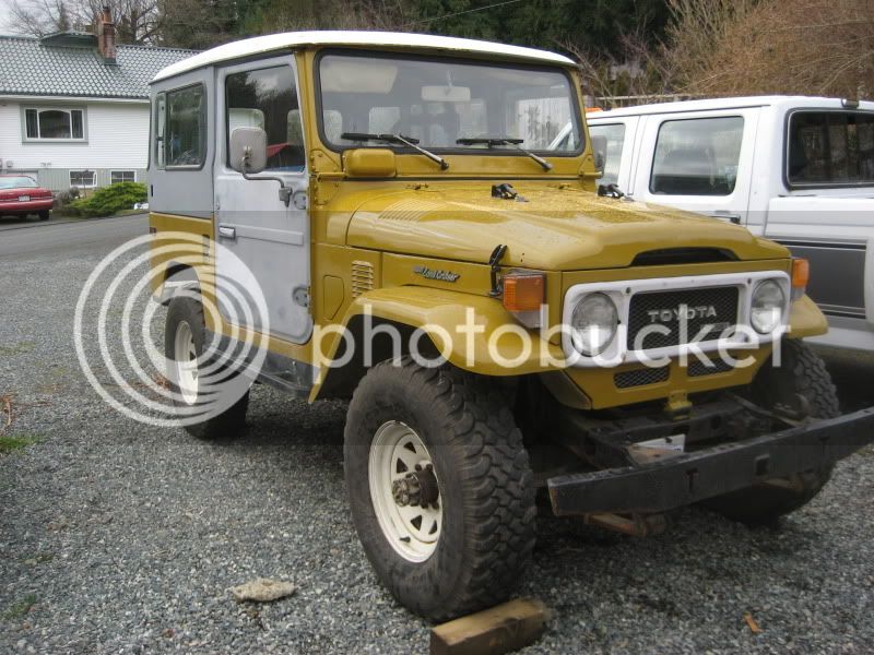

to say these roll a bit smoother would be just a wee bit of an understatement...I initially made metaphors involving warm tropical beaches vs non consentual prison sodomy that I was asked not to repeat....:lol:
kinda funny tho, same rims I had on the old crackwhore, then on the 45, then on the 70...and once again, I had to go to surrey to get them, history is repeating itself, tho I'm not going to turn this one into a 45 then get pissed off at it.
Tires themselves aren't s*** hot, still going to buy some new ones, but at least I can drive the damn thing while I snoop around for a deal. 255/85/16's

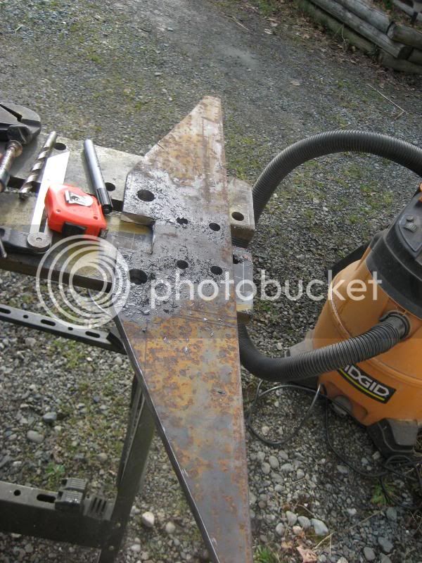

also started on some sorta rear bumper beefup.
picked up a pintle hitch yesterday so I can actually do something with my m101, and figgered I should beef up the rear crossmember before bolting it on.
I have a vague plan in mind to trim the bumperettes, cap them with some plate so they're steps instead of dog leg breakers...but we'll see what I come up with when I start cutting tomorrow.

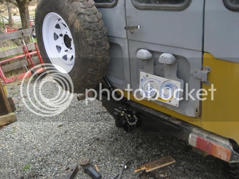

got the hitch thing pretty much done...seems I'm dealin with hitches two weekends in a row, a bit less drinking involved in this one tho...:lol::lol:
here it is mostly done, might cut those long diagonals off, had originally thought I'd weld it on, but decided for bolts. it'll wait till I figger out what I'm going to do to the bumperettes first...
can also see the blingin trailer rim.
bum looks a little less naked now, in the gratuitous driveway shot, cuz gratuitous driveway shots is what it's all about...:hillbilly:
