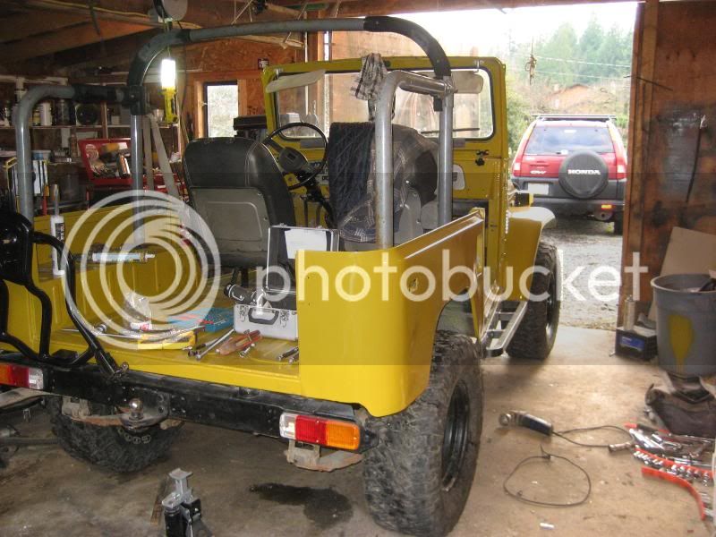

First test drive is complete....a few rattles but no wobbles, so I'd give that a passing grade.:bounce:
always an important moment...when instead of it being a pain in the ass that lives in the garage, it's actually useful.

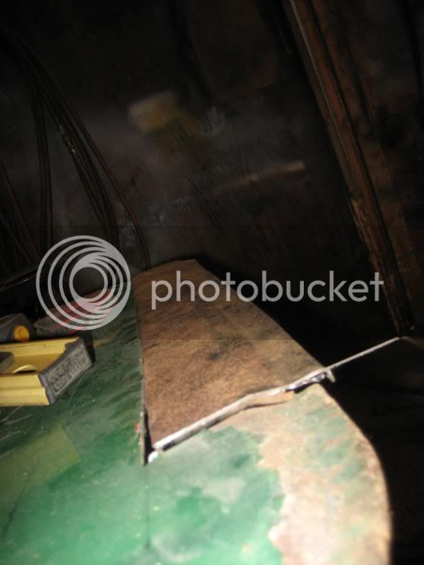

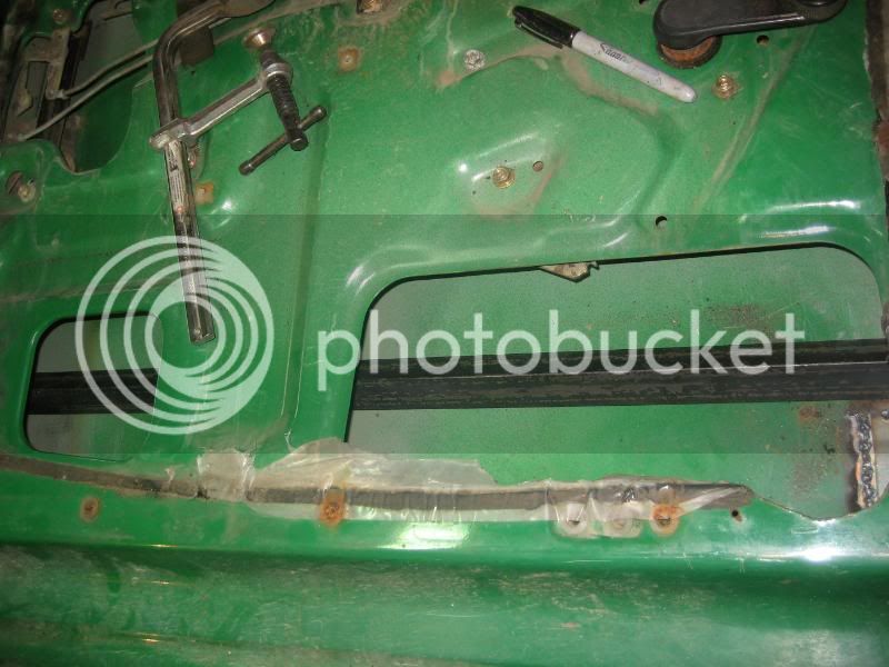

Used my flanging tool to patch the bottoms on. worked pretty well. I'm sure they won't be dead flat, but my give a s*** quotient is decreasing as I get closer to driving..:hillbilly:
second shot shows the flange stamped in.

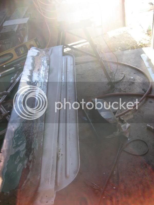

and doorfest continues...
decided to keep my spare door intact and go all "foxhole" on the bodywork...

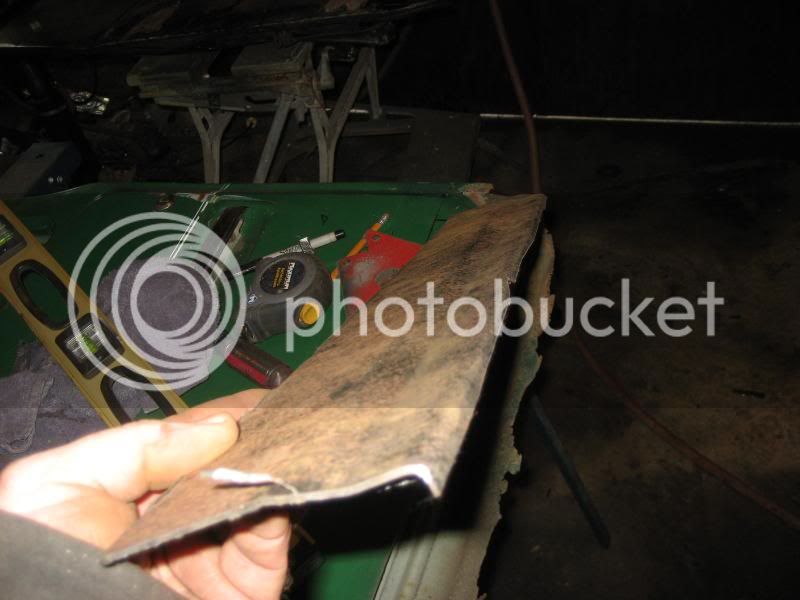

strip of metal, hammer and vice and ended up with this. fit ok, was a bit of a bugger doing the corner, but my vice has a knobby do'er on the end so that helped.

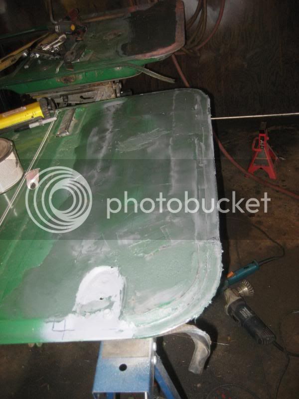

cruiser doors kinda suck. they're so flat it takes nothing to warp them, and this one was wowed way in before I even touched it. so I made a little cheater bar to stuff inside. helped flatten it a bit, but it's hardly perfect.
and then I zapped in all the scraps of metal , etch primed and put some "weld improvement compound" on it...
tomorrow I'll sand it off and see how it looks. probably good enough. Think I'll spray some rockerguard on the bottoms of these...

how did you do that double bend about 1/12 inches above the bottom of the door?? I was thinking of doing it with 2 or 3 pieces but your method is much better.:hhmm:
Looking good "MacGyver"
just vice and a hammer....:hillbilly:
drew a couple parallel lines on it, and whacked it one way and then the other...
if you slide it along only a little bit at a time, it helps keep things lined up
I have another vice that's more of an anvil, so it's good for making 90's at the edges.

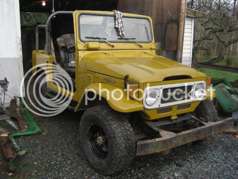

Well, ahoy there our Spudacious friend, you need to have a look at the project Land Cruiser that landed on my doorstep last night... if you're driving by, it's a little hard to miss, though it can't stay out too long or the neighbors might complain about their property values going down.
~john
uh oh... dare I ask?
something I once owned and bastardized perhaps?
Unfortunately, I don't think your hands have touched this one. It's a 1977 FJ45 that has mostly been sacrificed to the coastal rain gods.
There's barely an intact panel, though the hood is quite good.
The engine cranks over, and I'm sure if it had some gas it would start right up.
~John

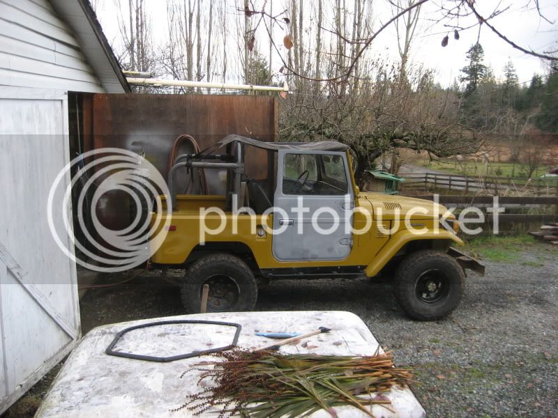

well, it got me to the liquor store and back...:hillbilly:
got the doors into primer , and then said, fuuuuckit I'm sick of this painting bull****, so I stuck them on squirted some oil into the rear diff and took it for a burn...
then I promptly came home and tightened up the steering box:eek:
stays in one lane now for the most part, some interesting grumbles and growls, but all pretty much functional.
I'm pretty sure I'll have to throw a new clutch and brake master into it at some point soon, actually kindof shocked they still work, this thing sat for 10 years.

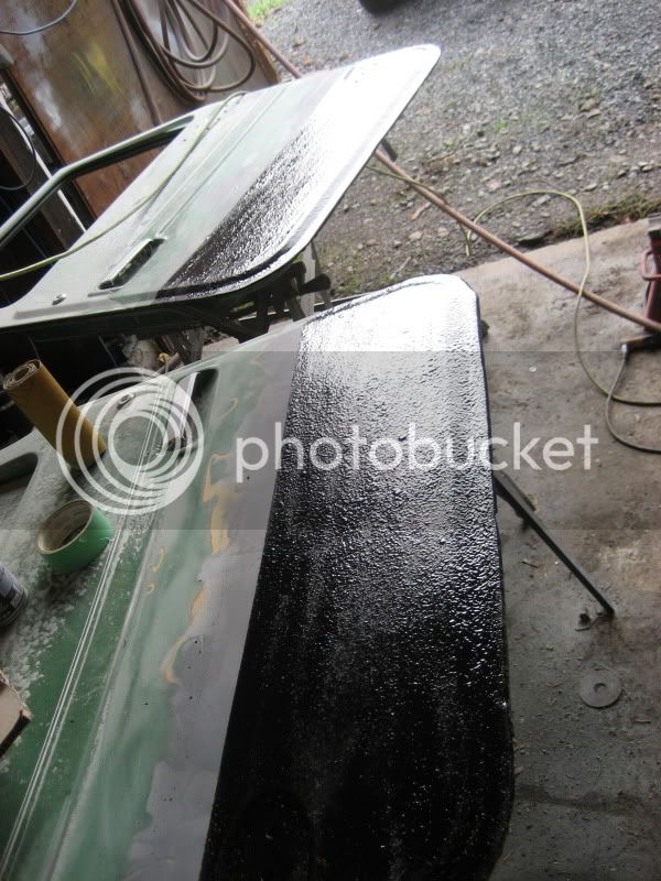

door with rockerguard (aka wonk covering muck) on it...
primed...
all together, and ready for the sketchy test drive, where you wonder which noise is the one that's from you forgetting a couple bolts....

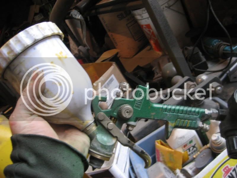

and for wombat, this is the gun I use. works great, and cost about 30 bucks. with my abilities, I'm not sure a 400 dollar gun would give me a better paint job...so I'm pretty happy with it.
