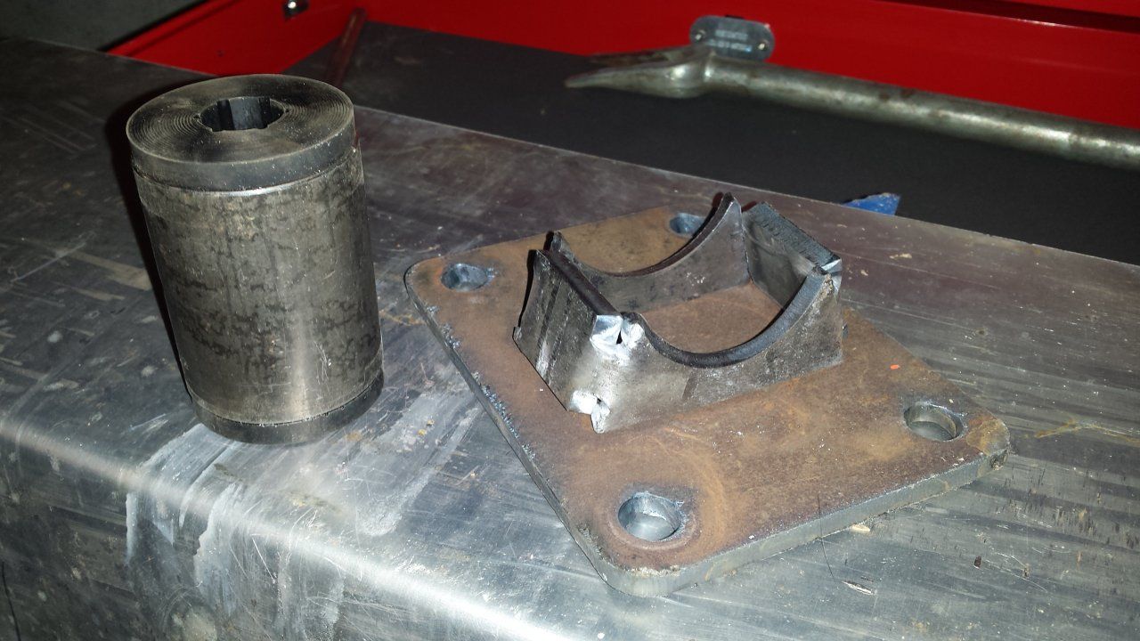

Motor mount development is underway. I made some educated guesses and whipped up this first version(engine side). It needs to be revised, which is why it's not welded. I'll make some changes and see how it goes tomorrow night. Wasted a bunch of time tonight screwing with the Torchmate trying to get it to cooperate.
This design would work on the passenger side, but the bushing needs to sit tighter to the engine for the driver's side and I'd like to make them the same. Pardon the rough finish quality of the parts. These are fresh off the table and strictly proof of concept. I will almost definitely farm out actual production to a laser shop.
Looks good to me and better than anyone can do freehand with a torch. Kirk on this board used the stock fluid filled mounts from an ls2 powered trail blazer and built the stands like you are doing. I always thought the urethane bushings transmitted a lot of vibration to the chassis. Do you think there's a way to do this on your swap?
