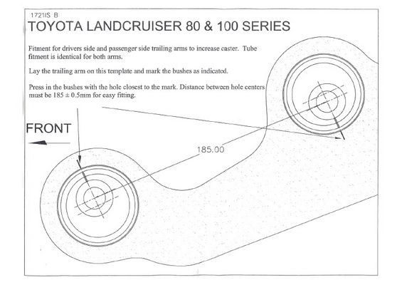

Regarding the H3 pan clearance and the need to push the axle forward, one thought to gain a bit of clearance without new brackets is to use caster correction bushings. Simply don't rotate them to achieve caster correction, rotate them both in the same direction to push the axle forward. You won't get the full 1", but perhaps between the bushings and the motor mounts, you can obtain the clearance needed. OME installation pic attached for reference.
I've been watching this thread, and the thread by Cardona1 on the beefier tie rod which goes up front. Looks like that kit is around $240, so wouldn't that resolve the oil pan interference issue, while getting a strong tie rod set up?
I was thinking of this exact thing, may not be enough but worth looking into.
