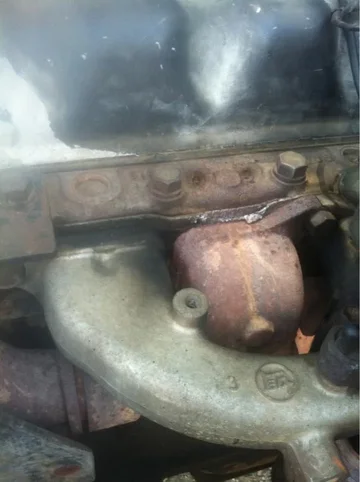

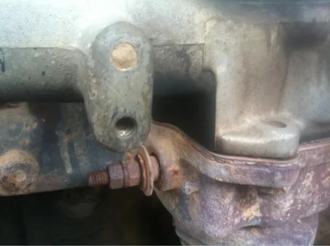

Has anybody fixed and exhaust manifold leak on a 2f. Mine seams to be getting worse.
The scorching is new. Noticed it after fixing
Carb and being able to go above 45mph.

I've had good luck with the felpro gaskets, both with the stock manifold and with headers. I actually have one in my stash. If you're ever in Memphis again, you're welcome to it.
I got this one from Cdan, but you can get them at Advance for about $15.00. it's the same part.

May be cracked. If so, best to replace with header.

If you go to a header, you will have another set of issues in that most (all that I have seen) headers have a thinner flange than the aluminum intake. I have tried cut washers/shims/double gaskets, remflex gasket, single gasket doubled on the exhaust port...I haven't found a long term solution yet.
If you have the factory PTO....only the two piece shorty header will work...unless you want to section and rotate the collector:wrench:...then if you do a shackle reversal, upper shackle bolt wants to be exactly where the collector sits....:bang:
Don't ask how I know all this....
