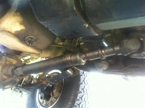

Above pic is where oil is pooling then dripping.

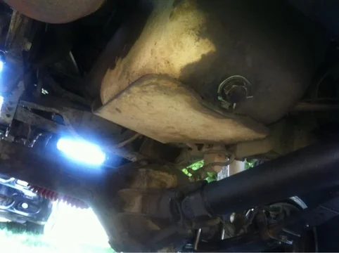

This is drain plug. Looks good.
Clutch will not leak oil. Looks more like rear main seal. That's my uneducated guess.
Engine runs better with clutch disengaged because it has less parasitic drag on the motor. My 4Runner does the same thing.
EDIT: Or, could be from transmission. There's a seal there, too, right?
