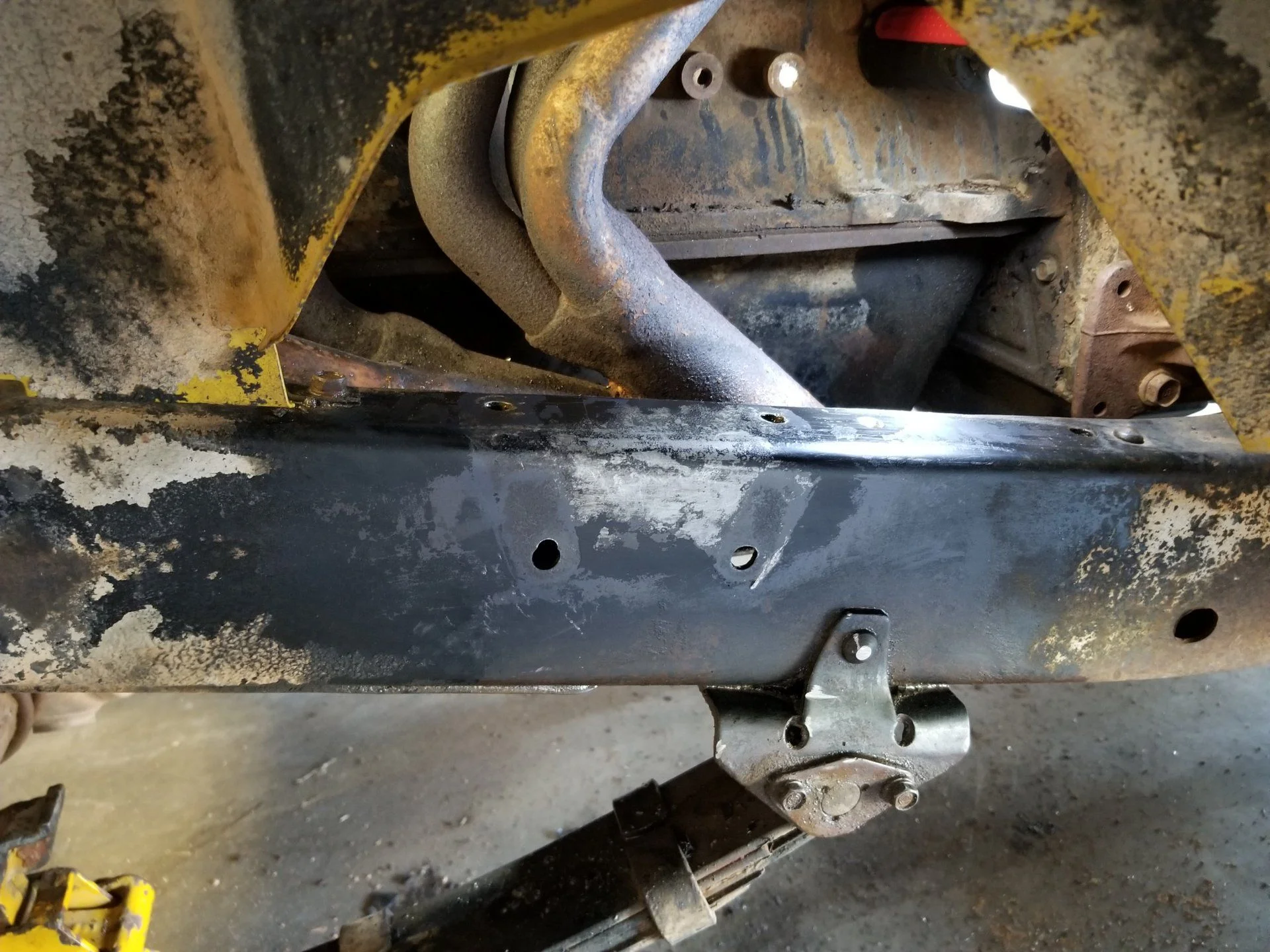

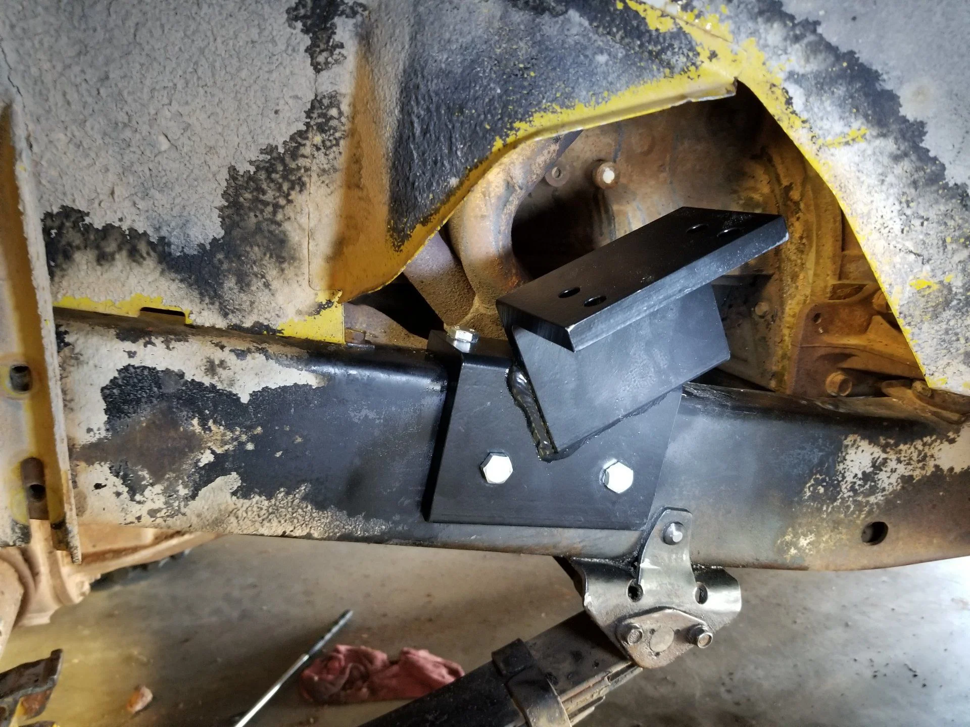

The hard part is done getting that old pedestal off is a bitch. I ended up sliding the fender out slightly to get the old steering box off and then drilled out the rivets after I knocked the heads off of them.
Holy freaking pitman arm Batman. It took literally two hours to get the pitman arm off of the mini truck power steering box. Took lots of heat and a lot of pressure.

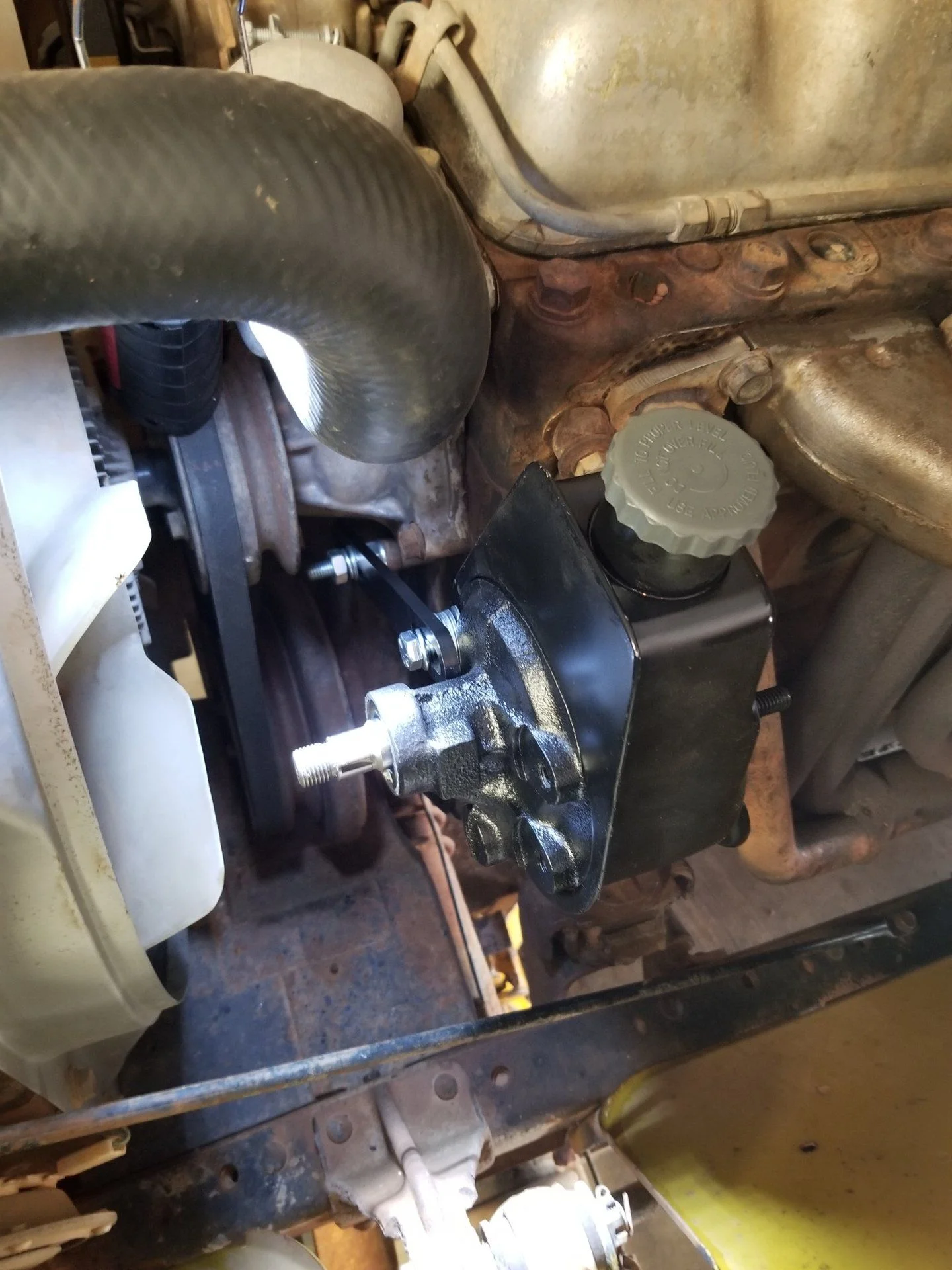

George's Saginaw bracket and Pulley are the best on the market. The other brackets use the front 2 headbolts and you can never get the belt lined up.

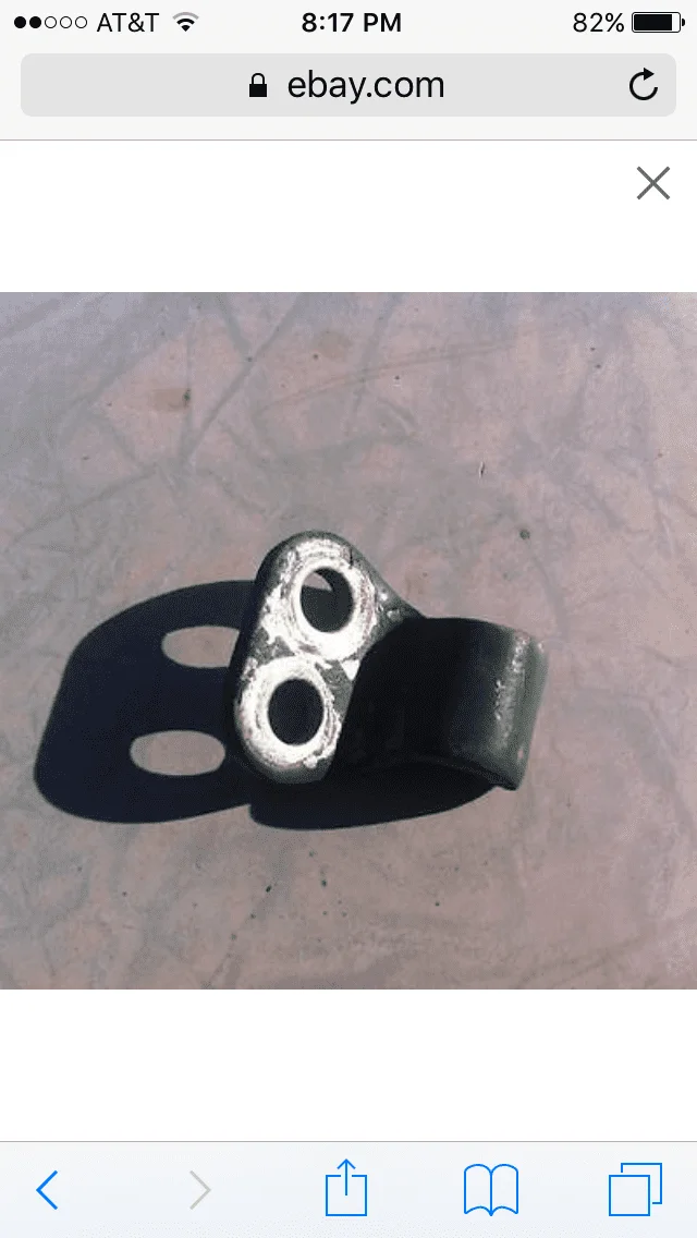

Does anyone have a spare later model 40 tire carrier swing out latch hook. I'm trying to figure out something for my missing Kaymar swing out catch and figured I would see if this would work.
They are still available from Toyota
Are they pricey? I kind of wanted to just borrow one to mock up and see if it would work.
I can't imagine they would be over $20. Go to sor.com and drill down on the part number.
