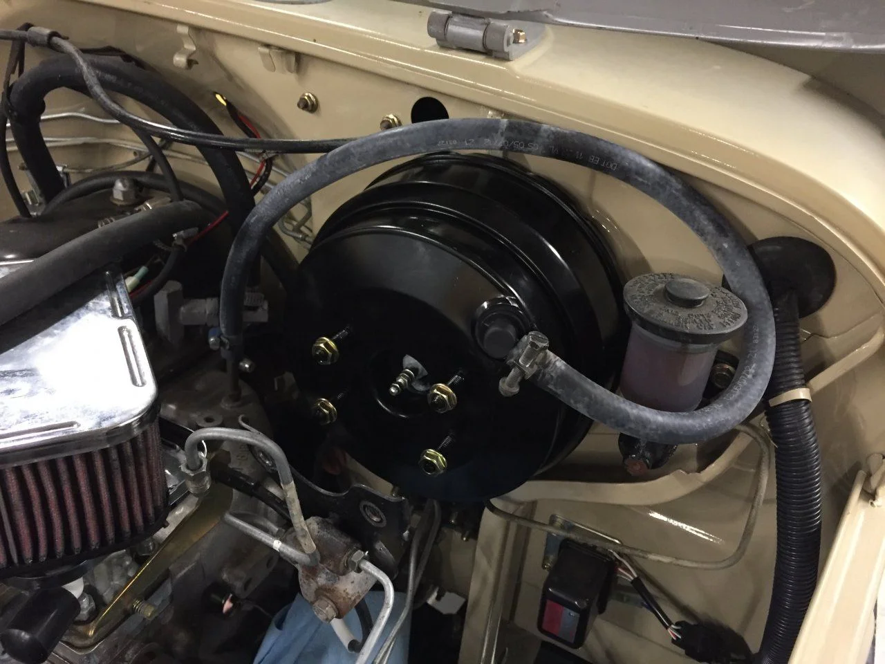

Brake booster mounted up just fine, but def found the problem with the old one. The plunger from the old booster was lodged in the master cylinder, and the source of my breaking issues if I had to guess. Unfortunately it won't dislodge so my master cylinder is shot now. Big fun.
I just used the 80 non-ABS master that Cam recommended. Ports are on the side instead of the top which requires a little bending, but it worked great after a number of plunger length adjustments.

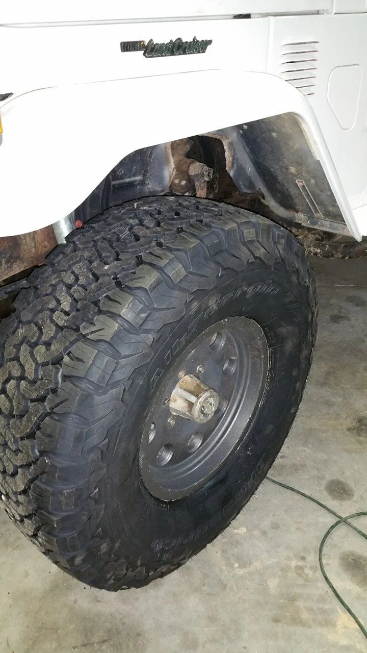

49 tire hooked me up with a nice setup! Hope these bitches stuff ok. Mardi krawl test coming up
Just now put them on @wct49
@beno hooked me up w a new OEM at a great price.

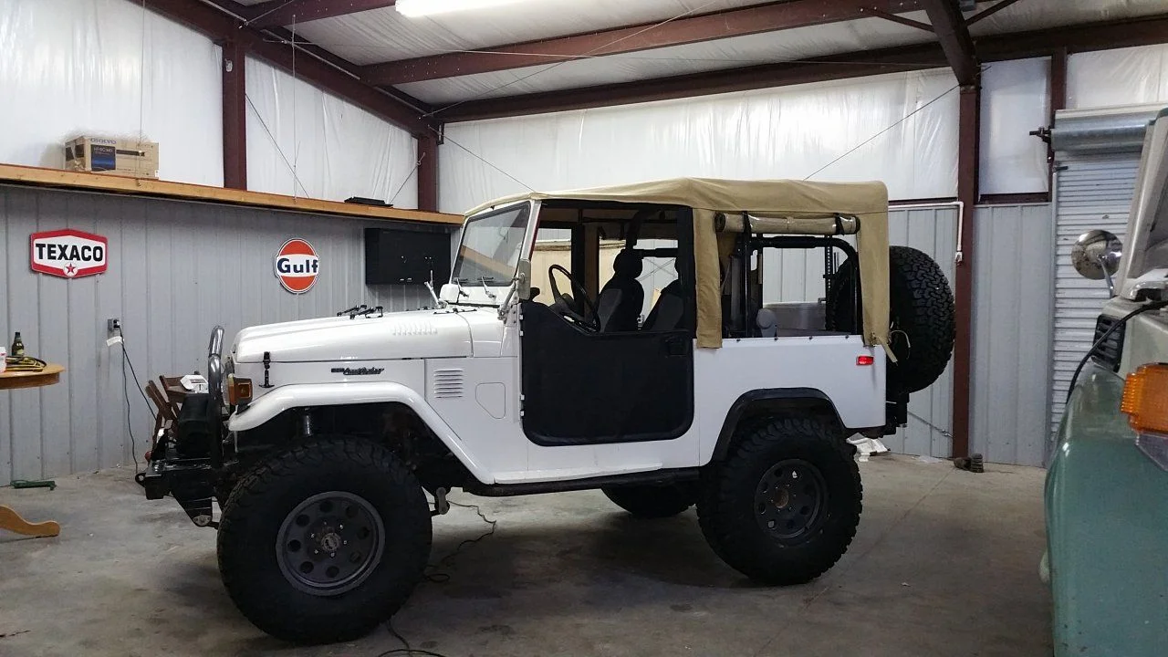

Hot damn, @jasonbraswell ! That's a great looking 40. I don't think I've seen a pic of it before. Got a build thread?
Does this booster have a built-in check valve?

If you were observant, you'd have known I got it already. It's Andy's old 40.
