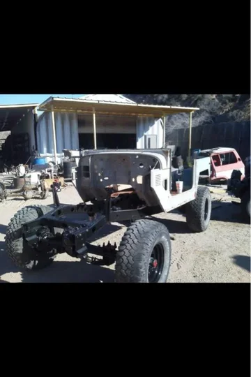

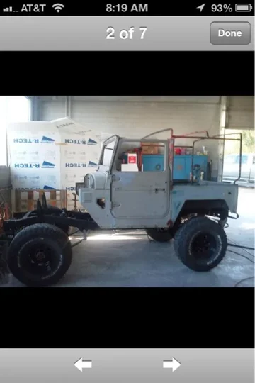

78 with completely rebuilt 60 axels ARB x 2, long-fields,FF rear with poly pro, shackle reversal. Rear stretched powder coated frame new Mojava springs. Set up for v8 all work done by Dave at 4 plus in globe AZ. Complete body with soft top a ton of new parts.
Missing: seats, fuel tank, motor,trans,transfer case.
