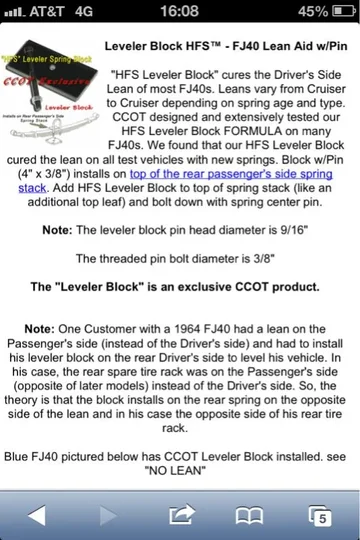

Next question. Anybody ever used one of these to level a 40?
http://coolfj40.stores.yahoo.net/leafsprinoem.html
