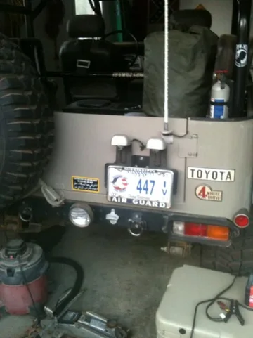

I built a permanent/bolt on tailgate. Bolts to the holes for the door hinges. I put my license plate holder on the tail gate. I'll get a pic for you.
Here ya go
There has to be a company that offers a bolt on tailgate. You could build one if you were Jrob!
Surely you can have one made for less than that!
Mine is very simple. 1/8th inch steel with 2 tabs and a 1x1" across the top for stability. Works great.
