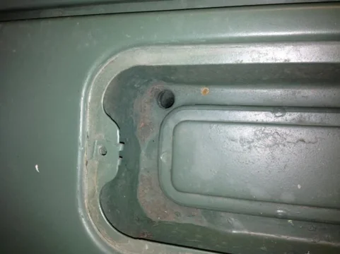

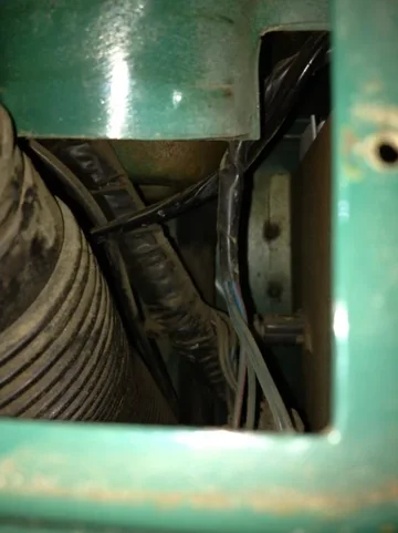

R drain hose looks good.

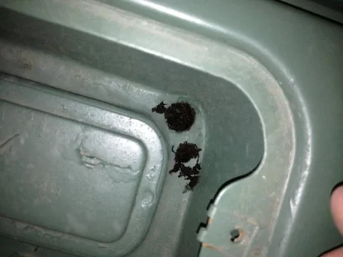

Is this area that drains into hose. This is pic of right (passenger size). Was clogged.
This is left (DS). Clear of debris.
have your son spray water over the top and hood and sit in the truck and see where it drips from.

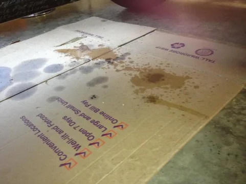

is this pic showing that water comes into cab through firewall and then drains down and out of the floor?
your PO either sucks or never drove it in the rain.........
Yes and yes to never driving it in the rain. I try not to. As soon as it was in garage I had fans on it till this am. If WS gasket is bad, where does that H2O go ?
Down into the firewall and either onto your floorboard (probable) or down into the engine side of the firewall.

I haven't fixed mine yet, dreading it, but my cowl vent is full of rusted out pinholes. You might want to check that, but yours looked good in the pic.
