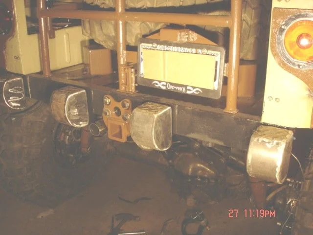

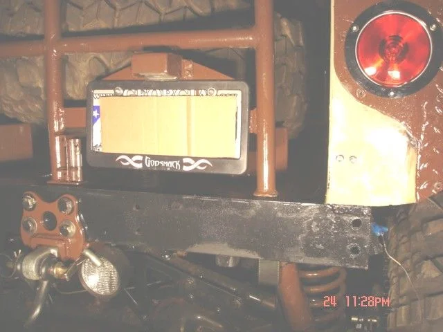

After my recent GSMTR event, I realized I needed to lighten up the rear. So, off goes the Gordofab Engineering bumper & the rear doors. I needed to relocate the Hi-Lift, spare tire, license plate, tail lights, receiver mount & cargo cage latch. I started off cutting out some plate to affix some flush mounted tail lights. Then, moved on to the license mount & the cargo cage latch. The spare rests in the cargo cage & the Hi-Lift will go behind the seats. I've started cutting out the receiver bracket that'll bolt to the rear channel w/ 6 1/2" bolts. I was thinkin about fabbin up some heavy duty bumperettes, that may have to wait cuz the Razorback Ramble is a little over a week & I still have to replumb my hydroboost brakes for an adjustable prop. valve. More pics later..... ;)

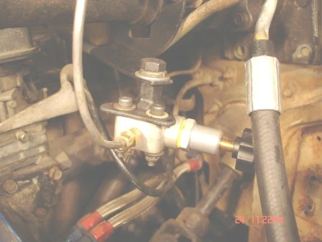

Chuck, did you figure out your brake binding problem?
Yeah, I kinda figured the stock prop valve wasn't up to a hydroboost system & was locking up my rear disks, so I ordered a Wilwood adjustable valve from Summit & plumbed it in the rear brakeline:

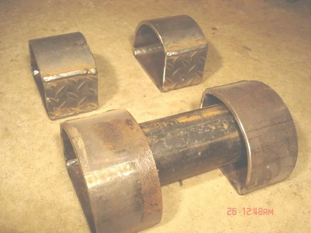

Didn't think I'd get this much done tonight, but I really gotta finish it this weekend. Mounting it will take longer than actually cutting, welding & grinding. The outer brackets are made from 1/4" wall & I added a diamond plate top for traction. They're cooling off so it's still roughly done. The center pipe will not be used, just for your reference - I'm using 1/8" wall for the center, shaped to the same contour as the outers:
Almost Done:
Just hafta add the center tubes. I thought about rounding the outer end corners, but since I took yesterday off for some R & R at the lake, I ain't got much more time. I should be slappin some paint on them later today:

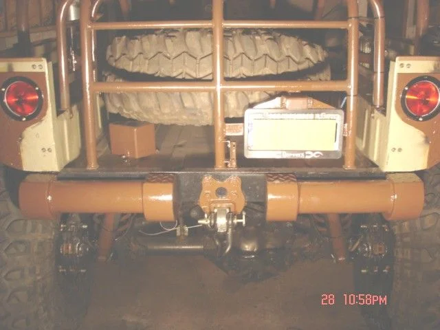

Ready To Ramble!
Just finished bolting up the bumperettes. Everything's hooked up & works, now I gotta dial in my rear brakes. No time to fool with the coil spacers now. Leaving Thurs. AM, so I'll be good to go by then :bounce2:
