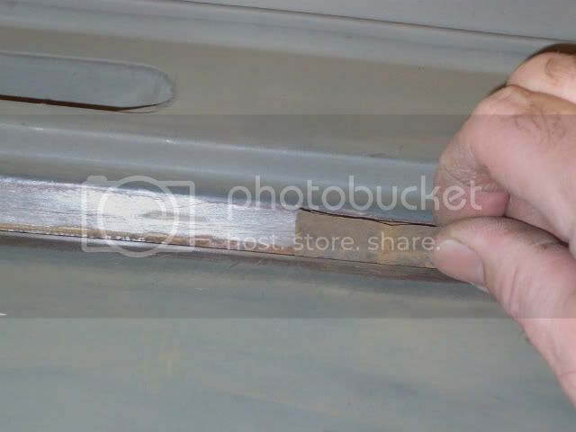

up close you can see the rust setting in where I scraped out the old seam sealer. Once the sealer starts to break up, water can just wick right through. I you are careful, you could use a pick to get the old seam out without damaging the paint(I went a little happy with a wire brush).
