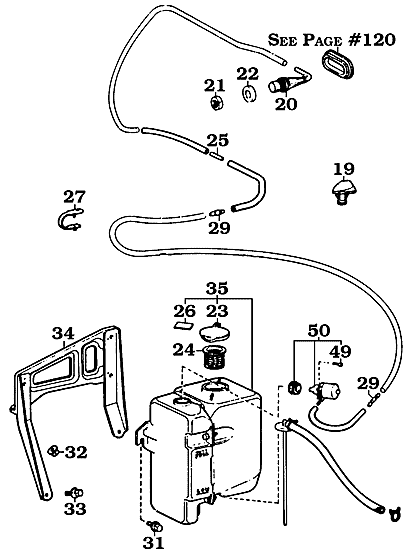

I have two squirters, neither of which work, the hood mounted due to the paint over.
Line is blocked, about to redo harness, so curious which is accurate or better.....since one has to go.
Soak them in lacquer thinner?
hood squirter should be a blank.. Windshield squirter line is easy to replace with a piece of 1/4" drip mist line.
I agree with @cruisermatt if it's spraypaint at least.

Thanks for the detail.
I'm trying to determine what I should mention/ask Coolerman on a harness rebuild and that came to mind, since integrated to in.
