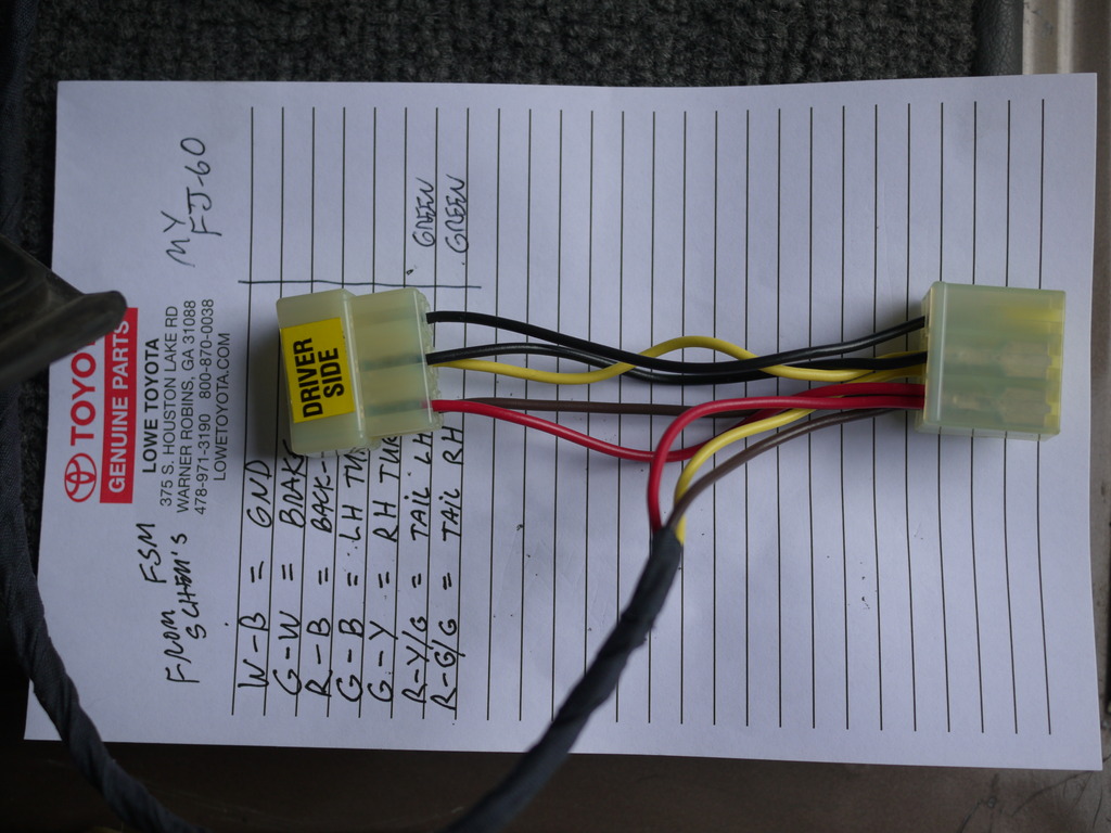

The Hopkins 43315 ($25 from amazon, $40 from autozone) wiring kit for 1984-95 Toyota pickups and 1995-2004 Tacomas can be modified ever so slightly to work with a 60-series land cruiser. The plugs fit the LC, but the wires are in the wrong locations. Taking out the wires from the plugs isn't too hard and requires about 15 minutes of time. I used a long straight pick to lift the catches to removed the blades and receivers from the connectors. Then you need to replug in the wires into the correct locations. I did not record LC location list. However, wire colors are below. Anyway, once all of this is done, the kit is a "plug-in simple" (Hopkin's saying) for the LC and adding a four wire trailer connector requires no splicing or anything else into the factory wiring harness.
Hopkins wire///Toyota Wire///Function
Green///Green-Yellow///Right turn signal
Red///Green-White///Brakes
Yellow///Green-Black///Left Turn signal
Brown///Green///Tail lights
White///Brown///Ground
Anyway for FJ 60 a few pics of what it looks like AFTER you move the wires in the connectors (driver's side shown):
Driver's side connector picks up tail, brake, and left turn. So it has 3 pigtails to the black box. This pic is before I cut the 3 wires just after the wrap so I could route thru the grommet and trim the excess length. If you don't do this the grommet won't seal. I suppose you could slot the grommet, but I'd rather not. YMMV. If you have good solder equipment and shrink tube its very easy if a bit time consuming. I do not use crimp connectors if I can help it.

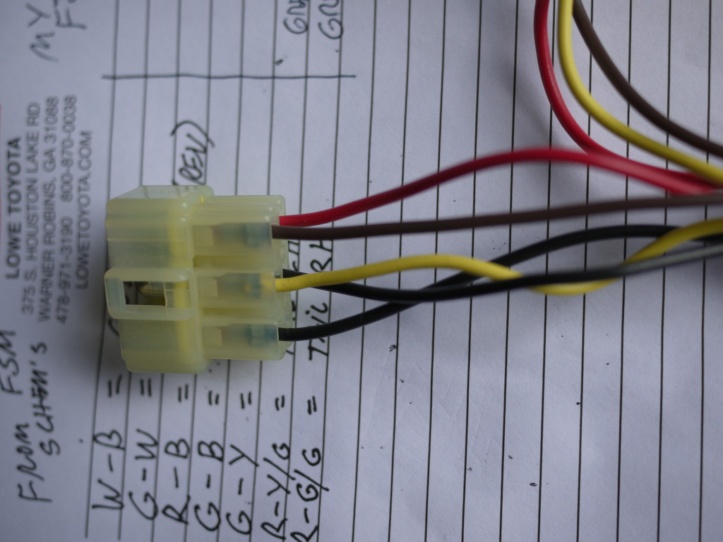

PS. Pass side only picks up right turn signal , so one wire. It goes to the tab side center slot of the connectors. The other 4 wires feed straight thru.
Note: On either R or L side connector, the center slot on tab (latch) side is the turn signal for that side.
