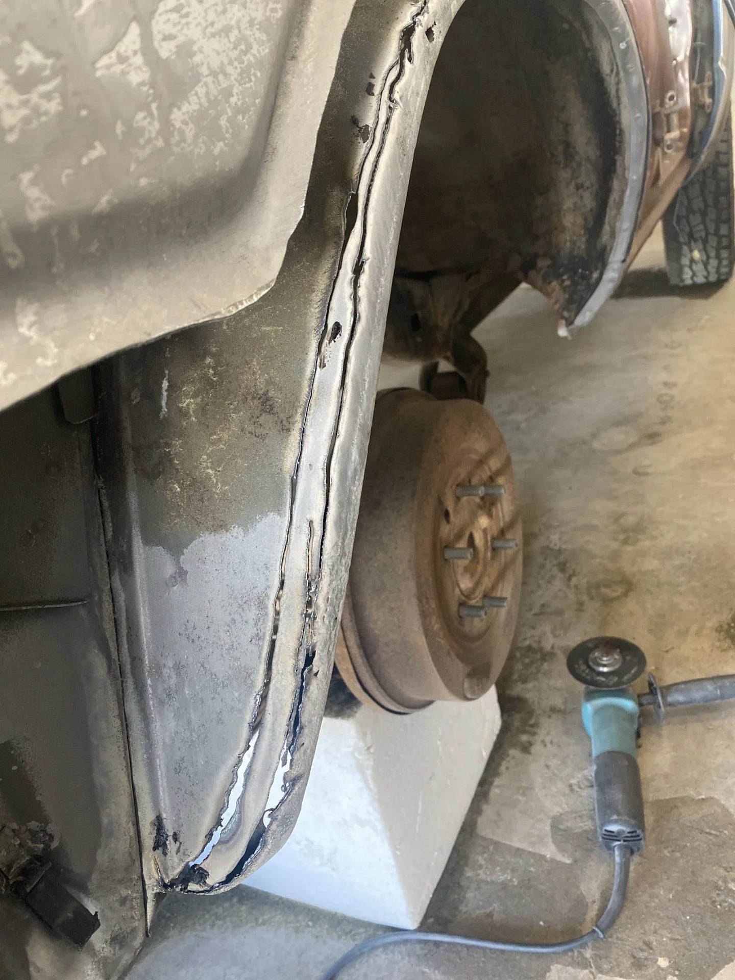

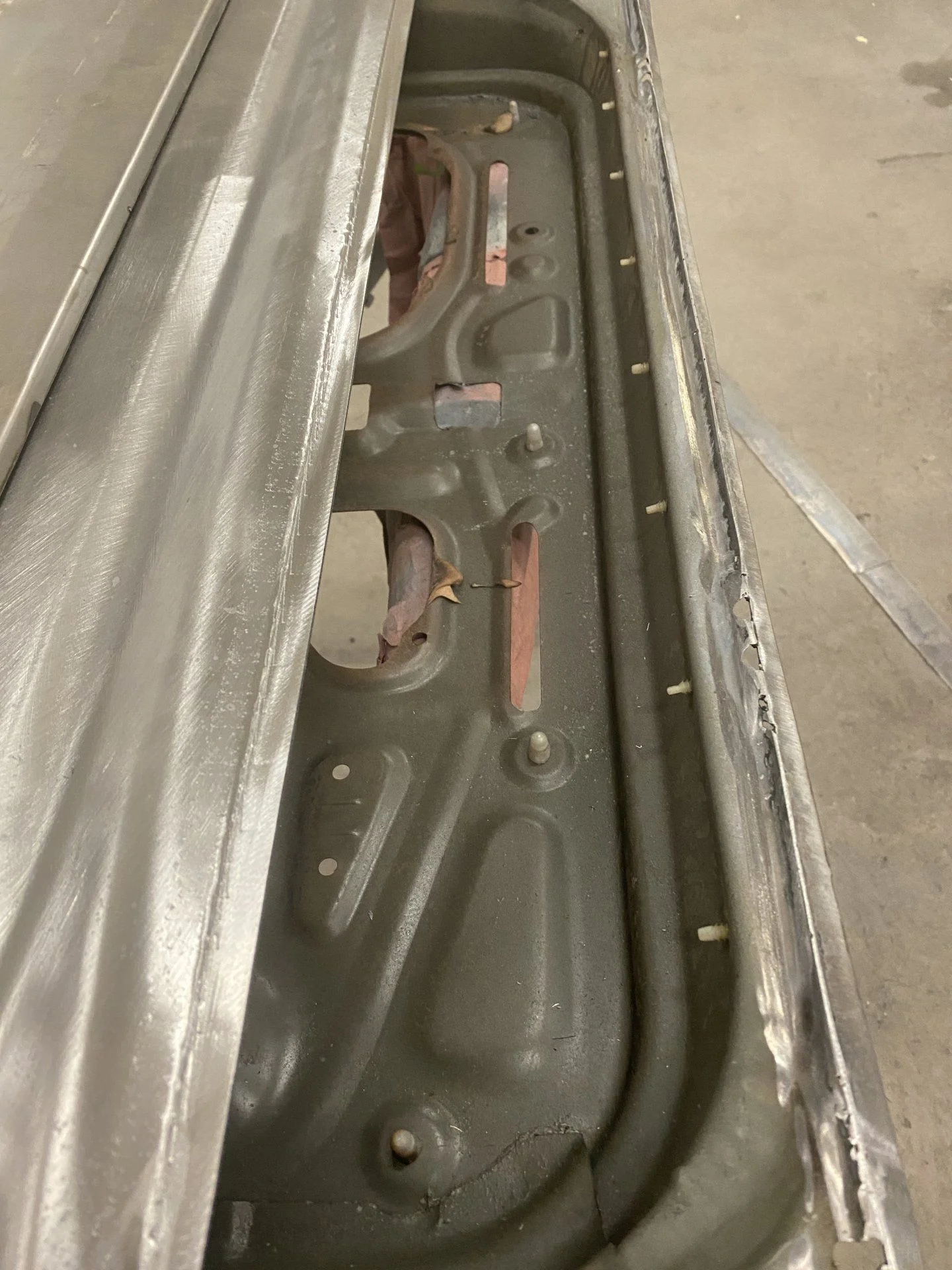

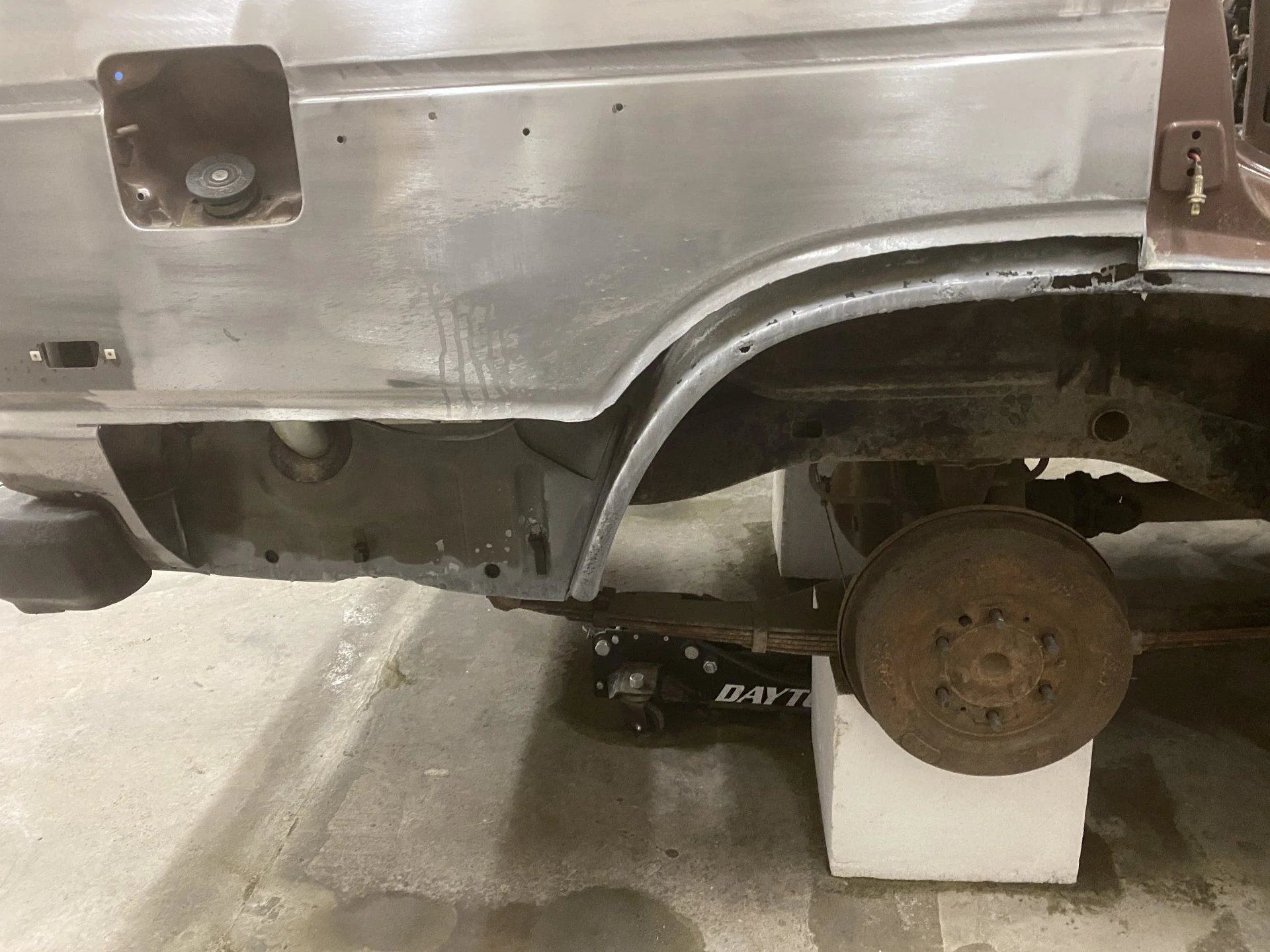

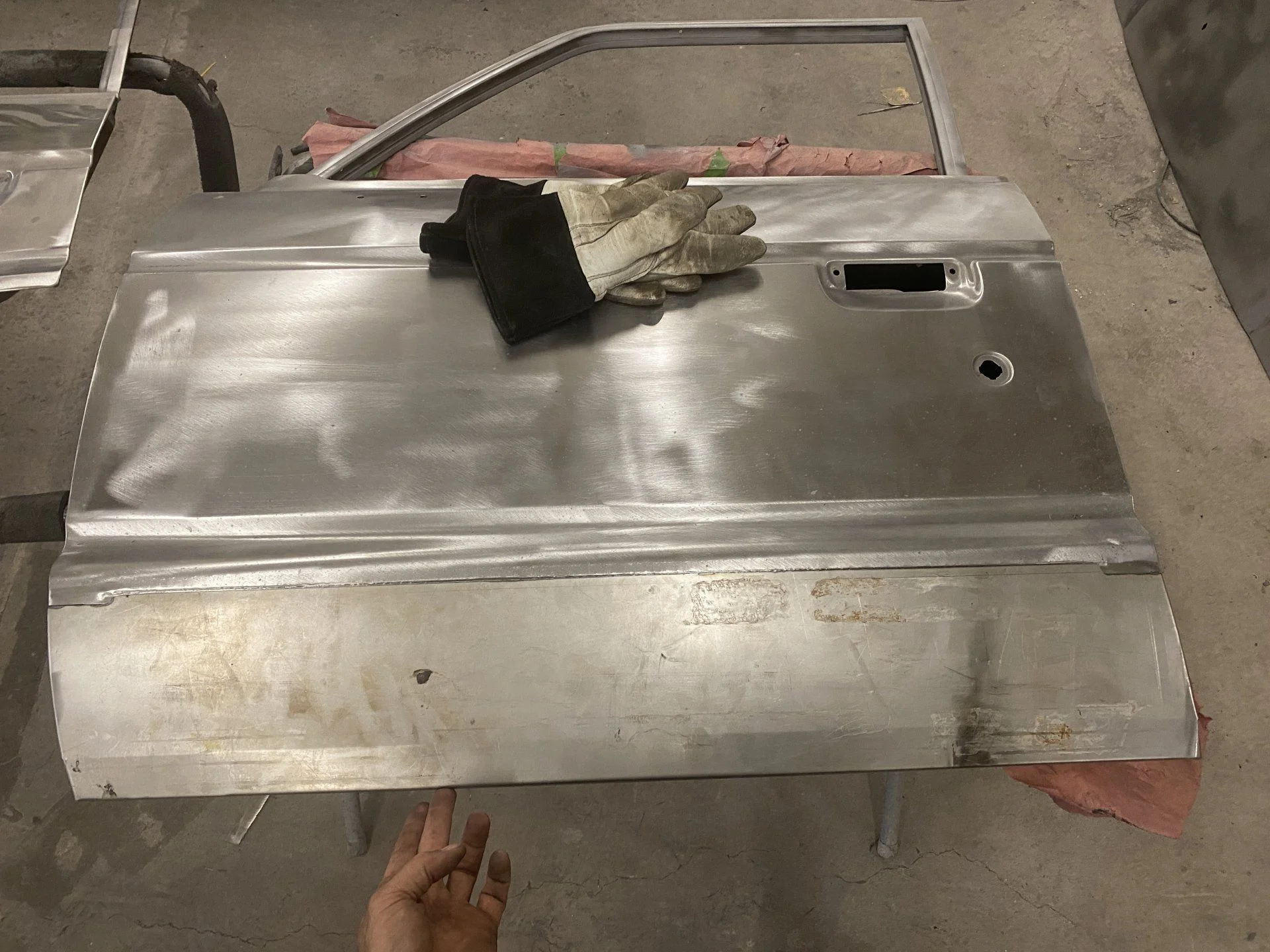

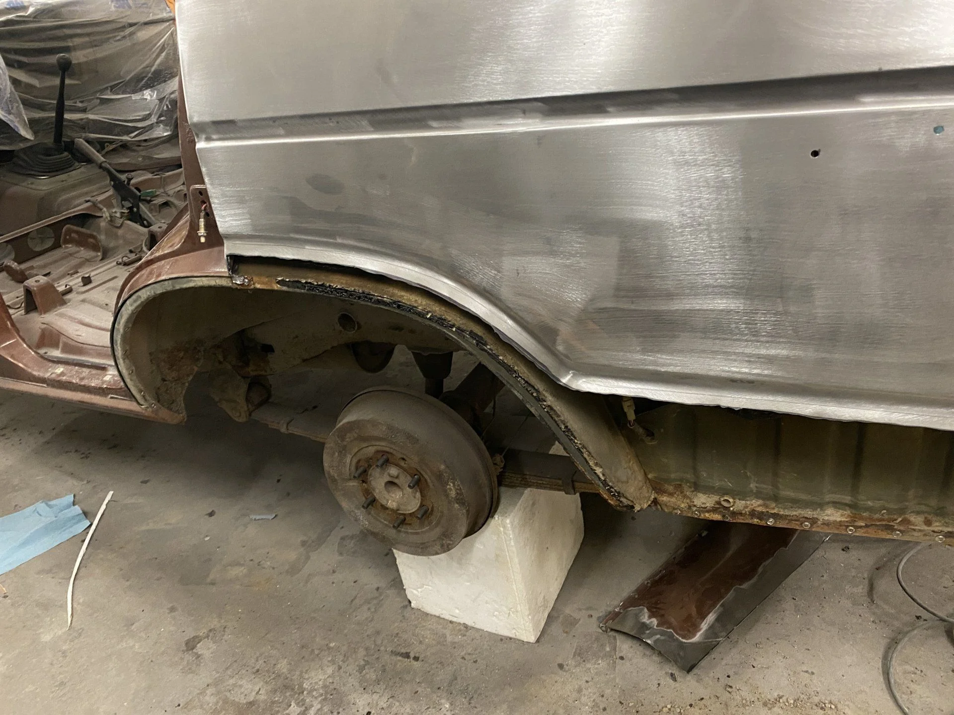

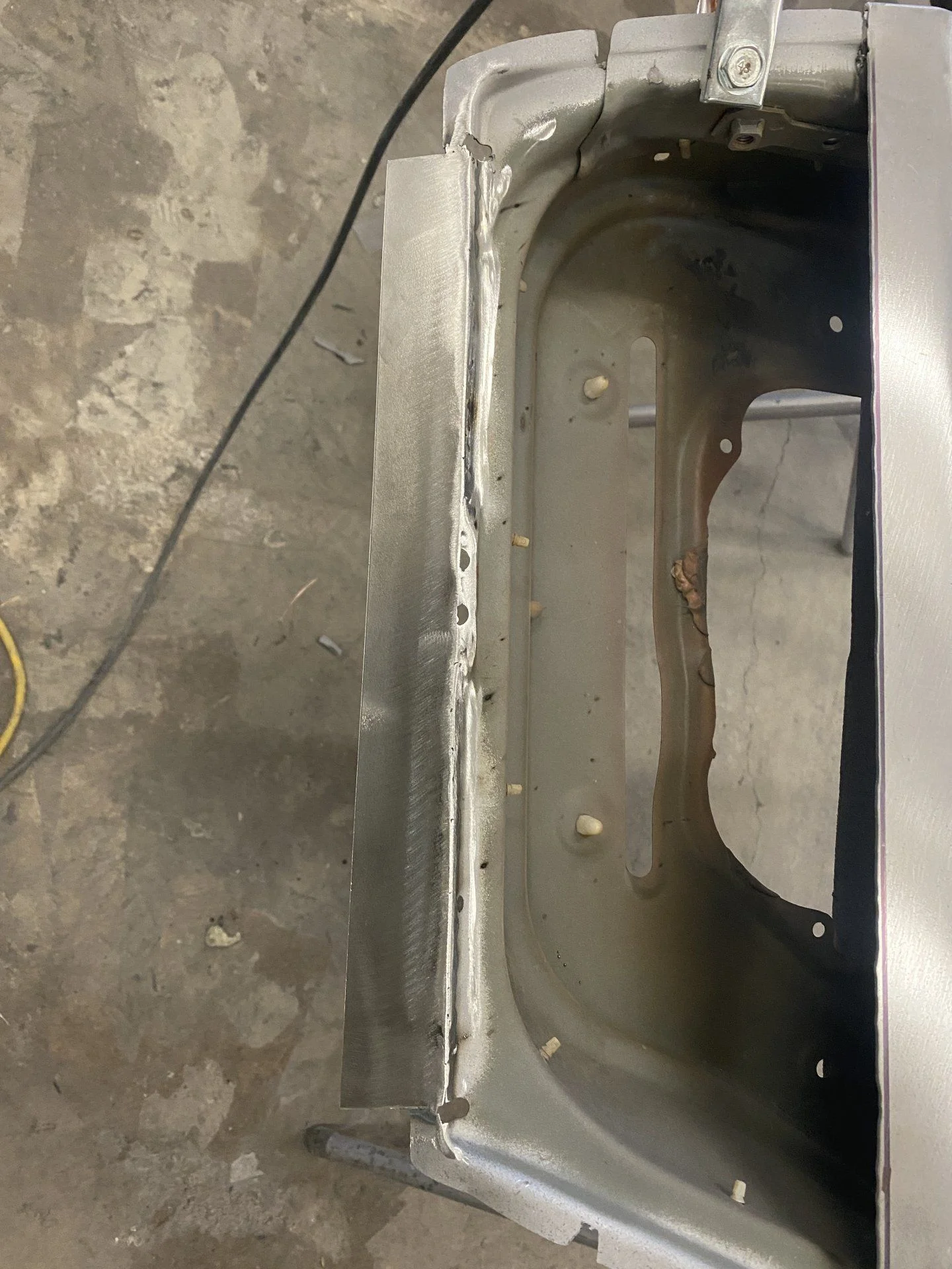

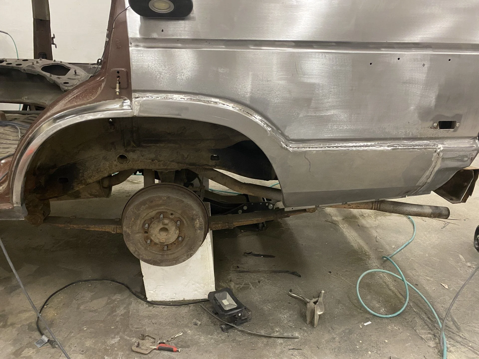

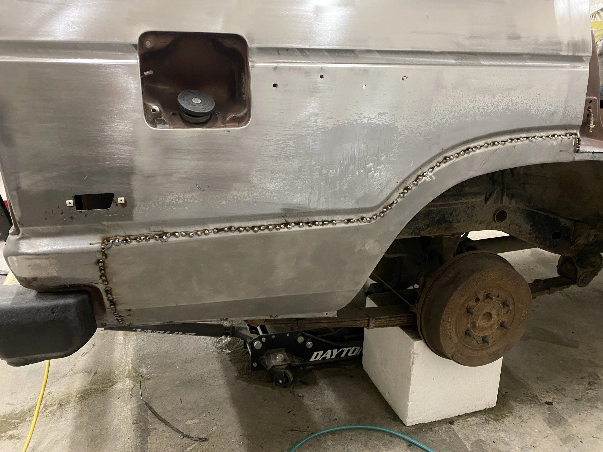

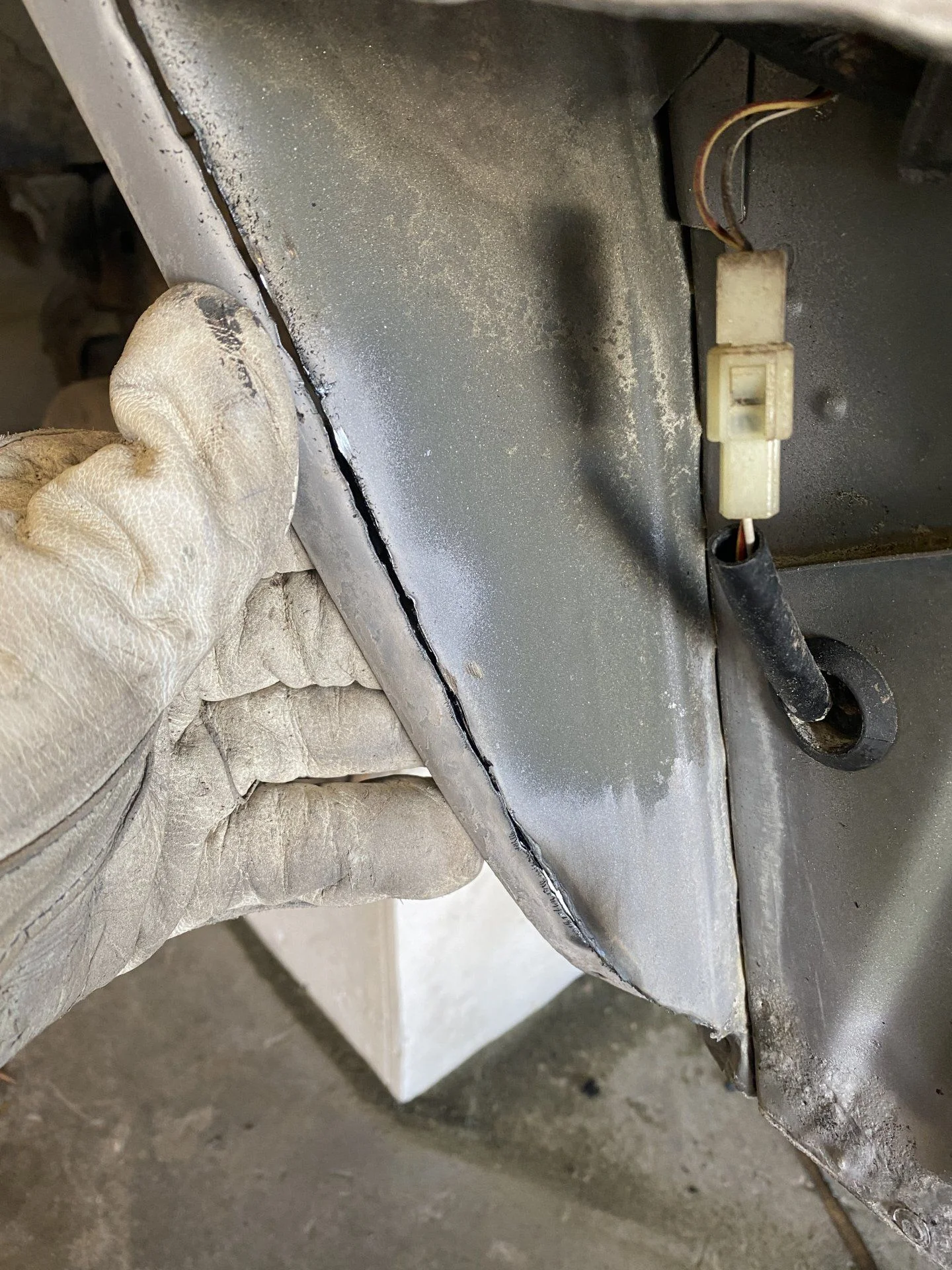

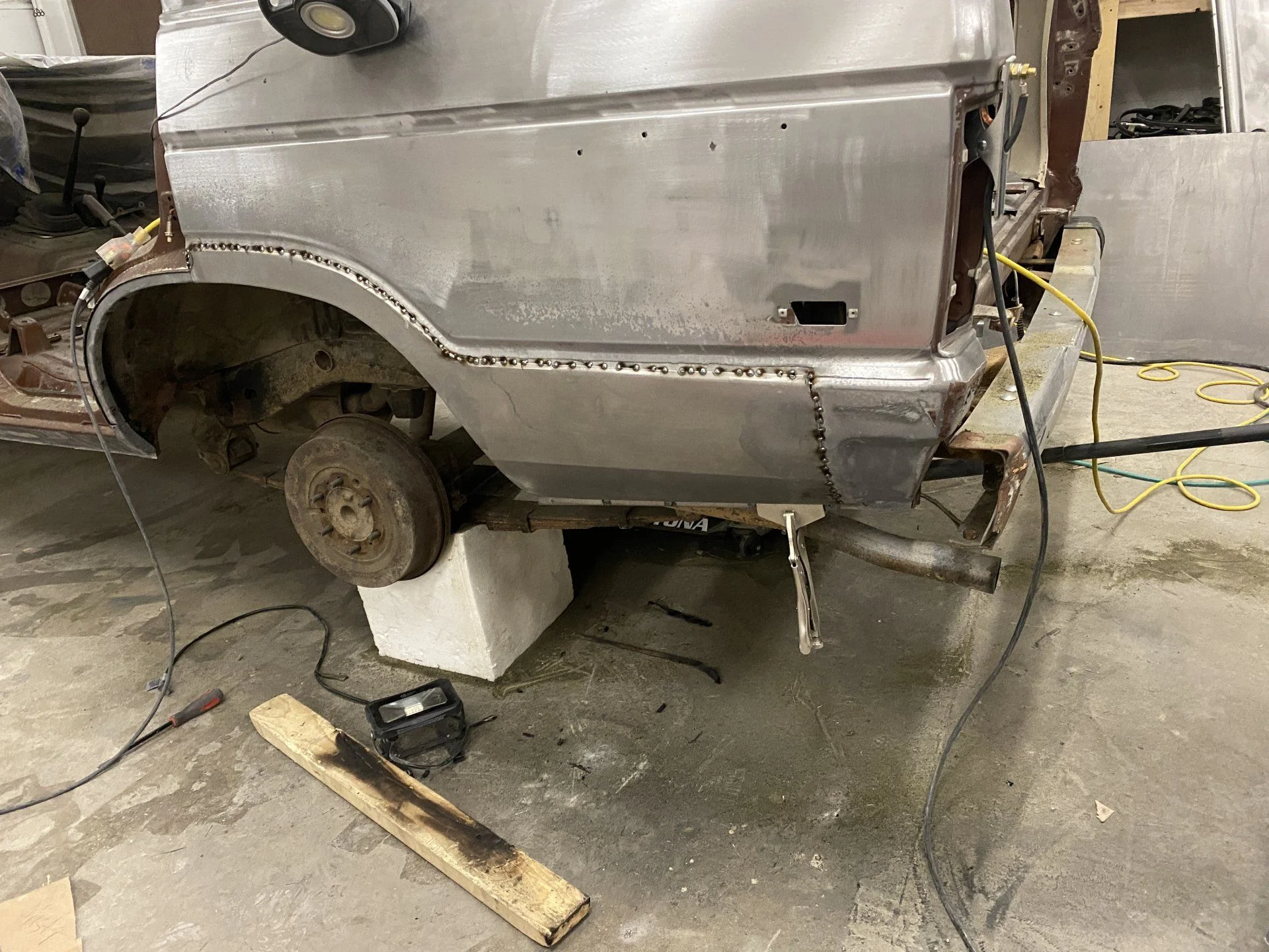

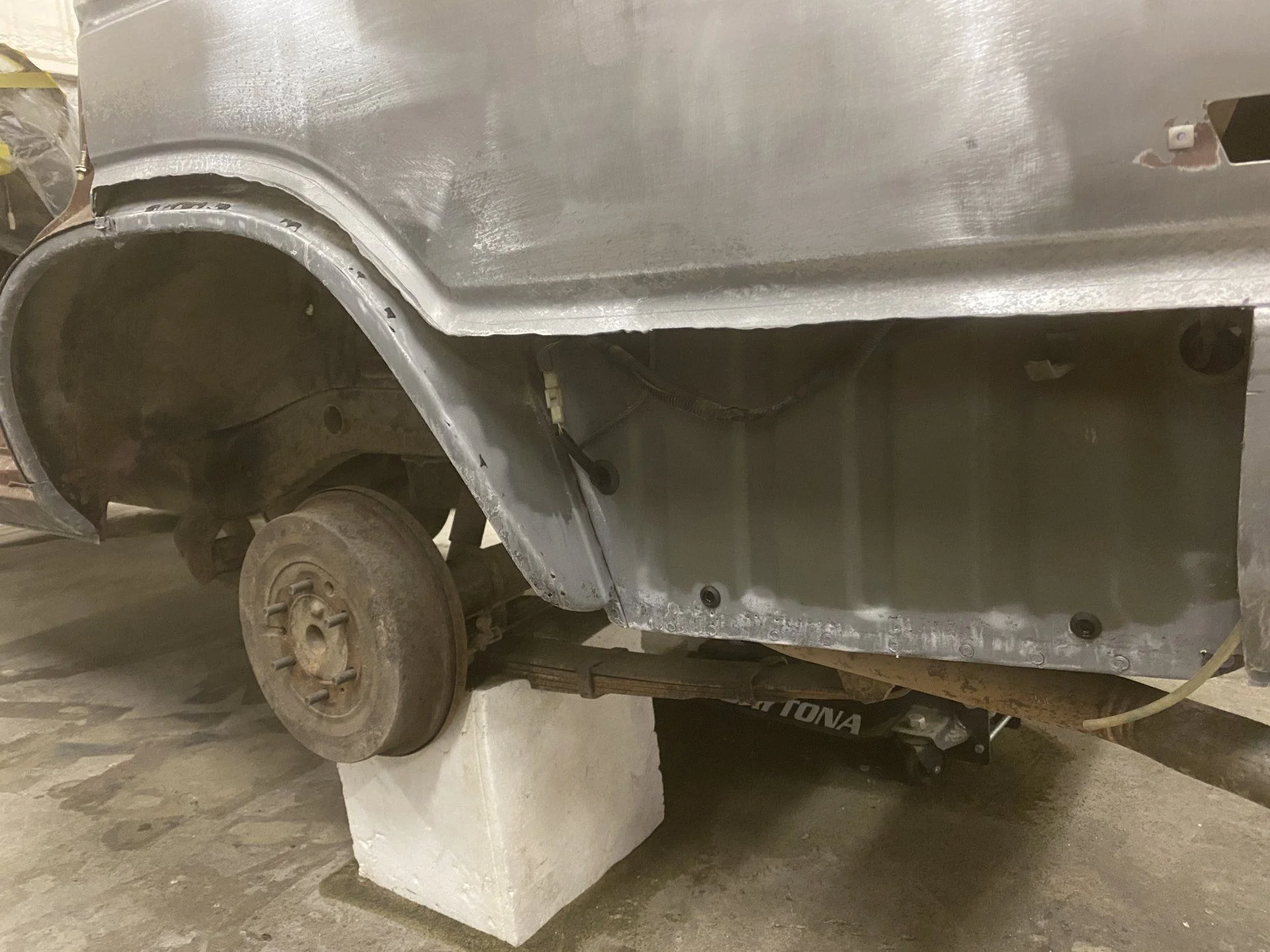

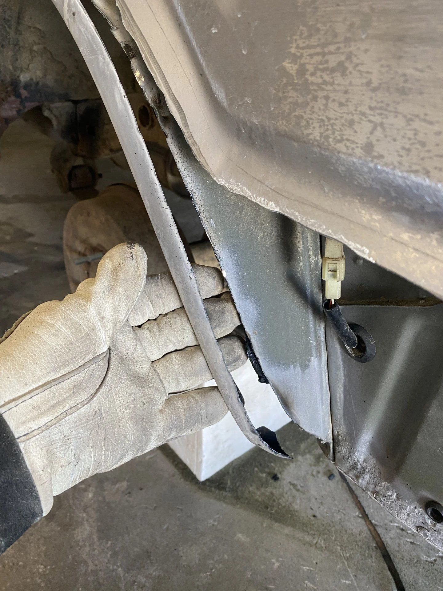

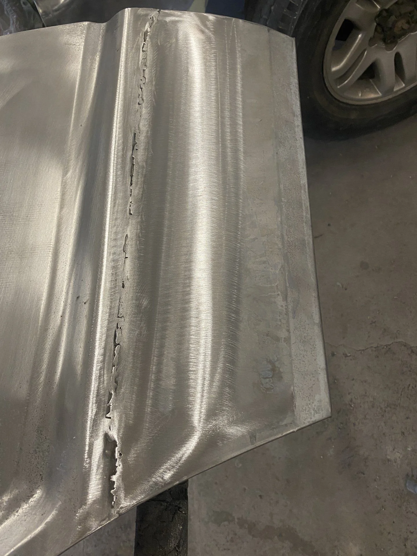

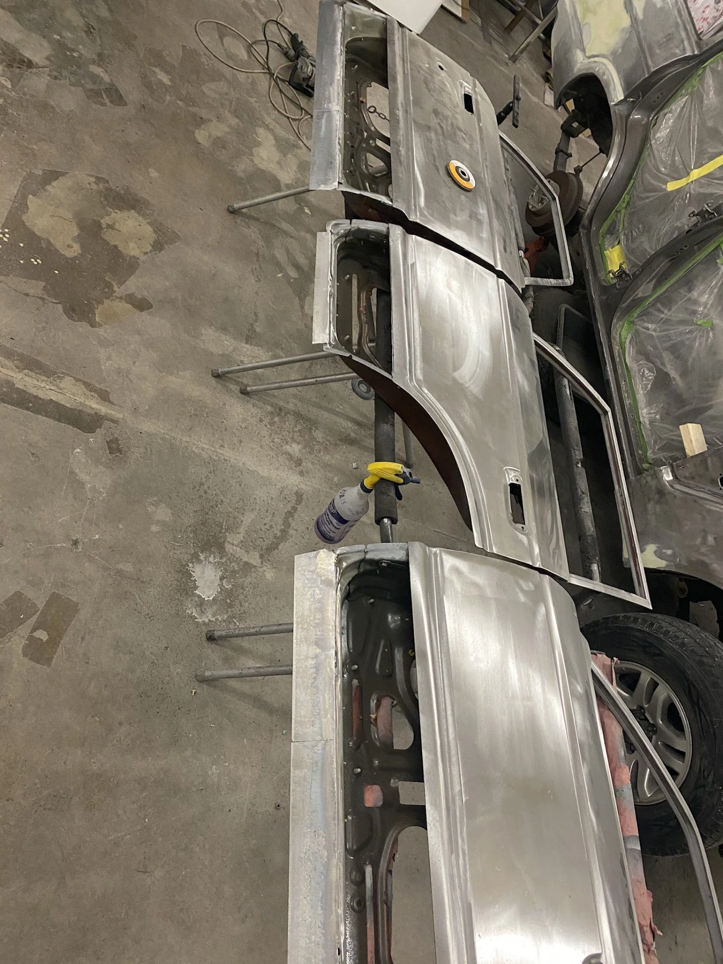

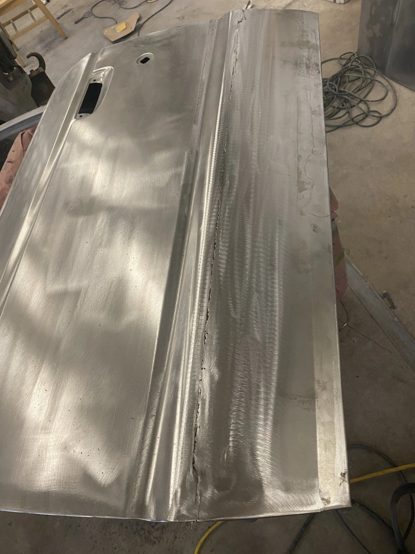

Cut the lower doors off for the new skins today. Lots of rust hiding in there. The inner door lip on the bottom is basically gone on the front doors. Will have to rebuild that. They are ready for sand blasting.
Sand blasted the bottom of all the doors to prep for the door skin panels to be installed. I have to rebuild some areas first because they are gone from rust. Also, all of the inner fender areas behind the old quarter panels and dog legs. Now I can install the new quarters. It's nice to get the blasting done and out of the way. Sprayed with Metal Prep and now it has a nice coating of zinc phosphate. There are a few rust holes to repair on the inner fenders next.
