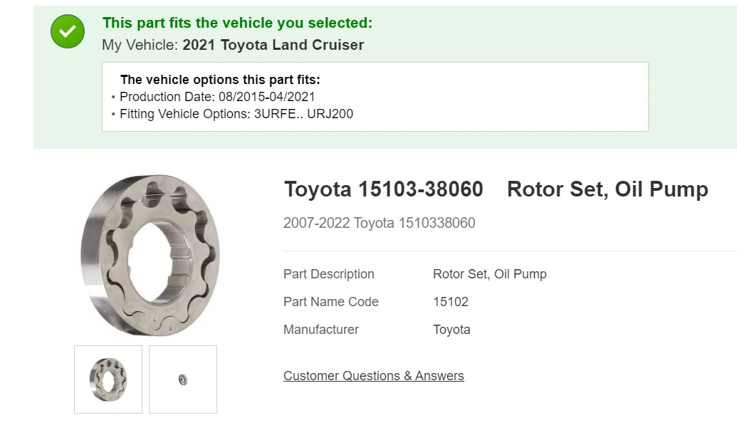

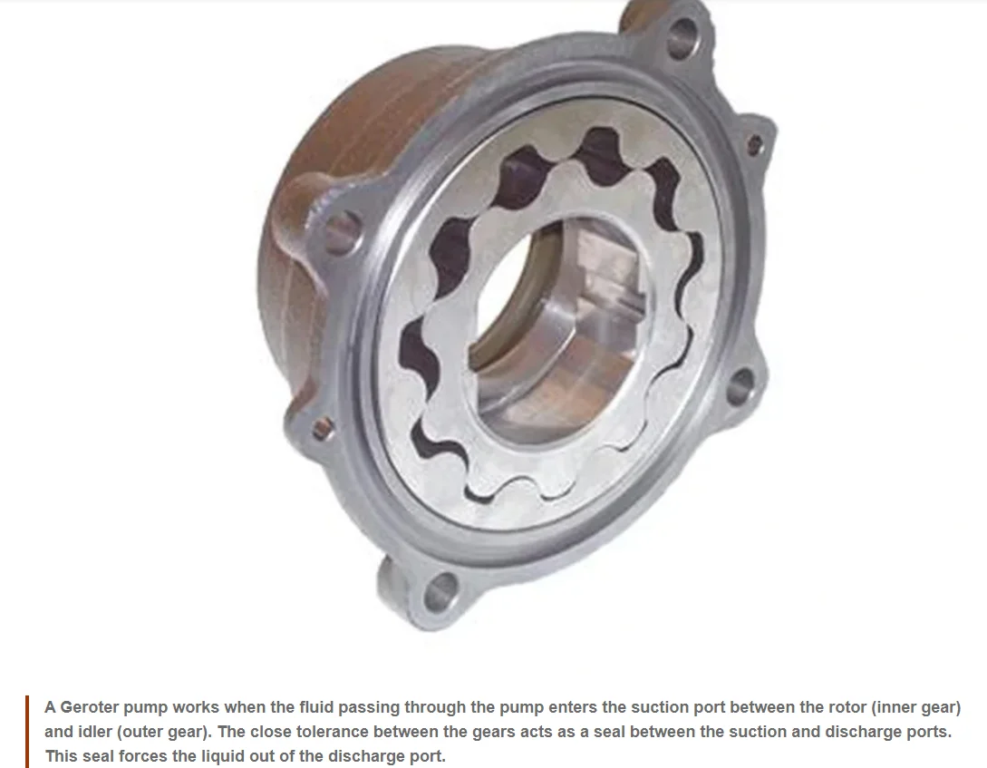

3UR-FE oil pump

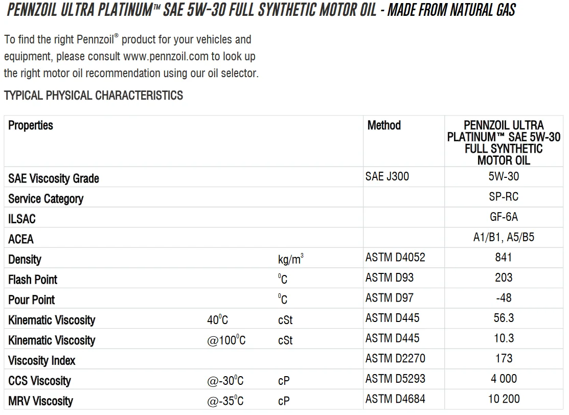

Historically, PUP 5W-30 tends to run on the thinner end of the 5W-30 range, closer to a 20 weight. Its still falls in the 30 weight range but there are thicker ones out there.
There is nothing wrong with it but if the goal is to run a thicker oil to help with the timing chain tensioner, there may be better options.
Could also look into some 5W-30 Euro oils. The Euro oils tend to run a bit heavier I think, but many of them are API SN, SN+ or SP rated which I think is all that Toyota really requires in the owners manual.

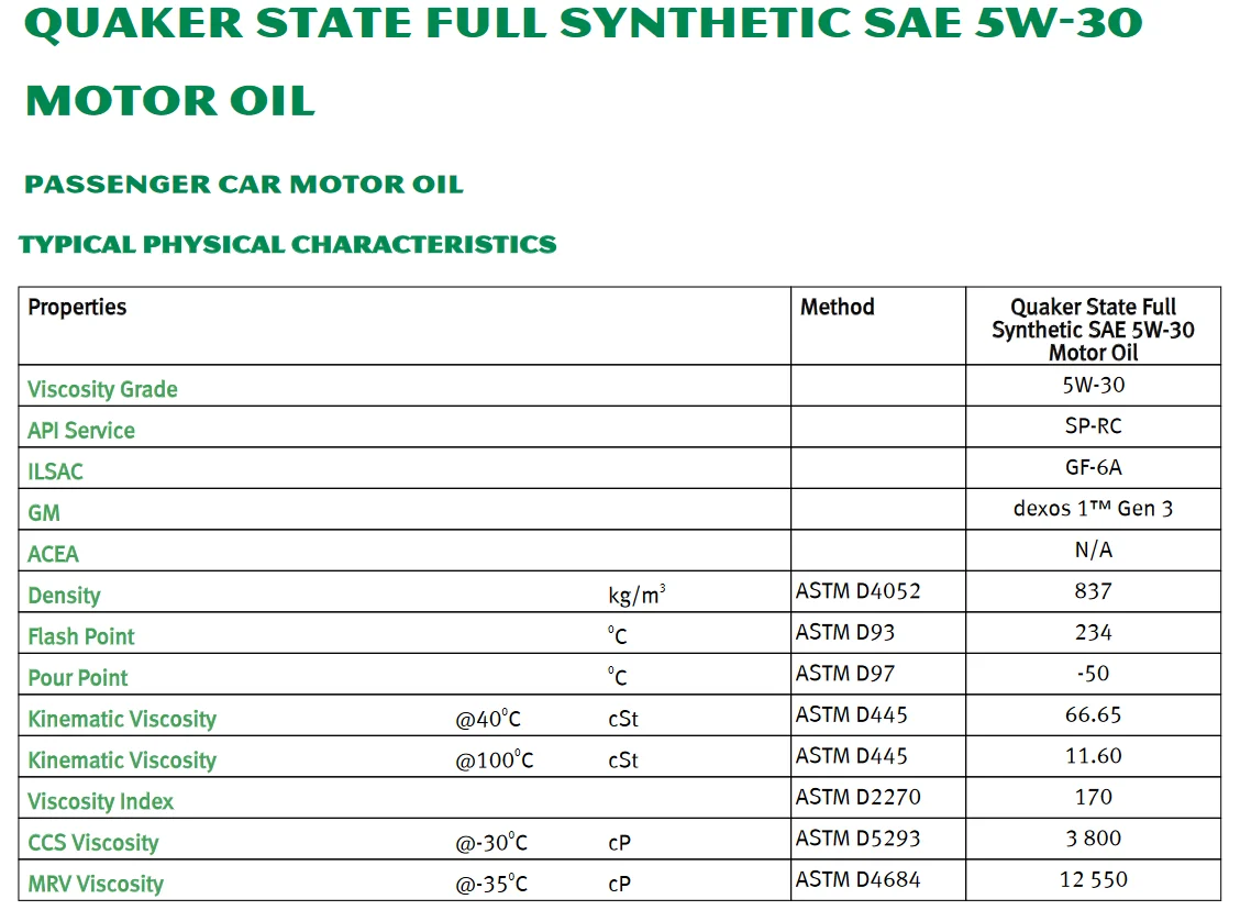

I think a lot of other 5W-30 will be a bit thicker. Just one example is Quaker State Full Synthetic(used to be called Ultimate Durability) which is also produced by Shell. Here is the PUP 5W-30 data sheet which says the viscosity at 100C is 10.3:
QSUD 5W-30 is 11.6:
QSUD 5W-30 is 11.6:

Per data above, PUP 5W30 is 56.3/10.3 cSt and QFS 5W30 is 66.65/11.6 cSt. Quite an increase actually in viscosity and during transition from startup to full operating temps.
Also looked up TGMO (Toyote Genuine Motor Oil) 5W30 which is 56.2 cSt/9.95 cSt at 40/100 C. PUP 5W30 is viscosity wise about identical, so probably will give that a go.
