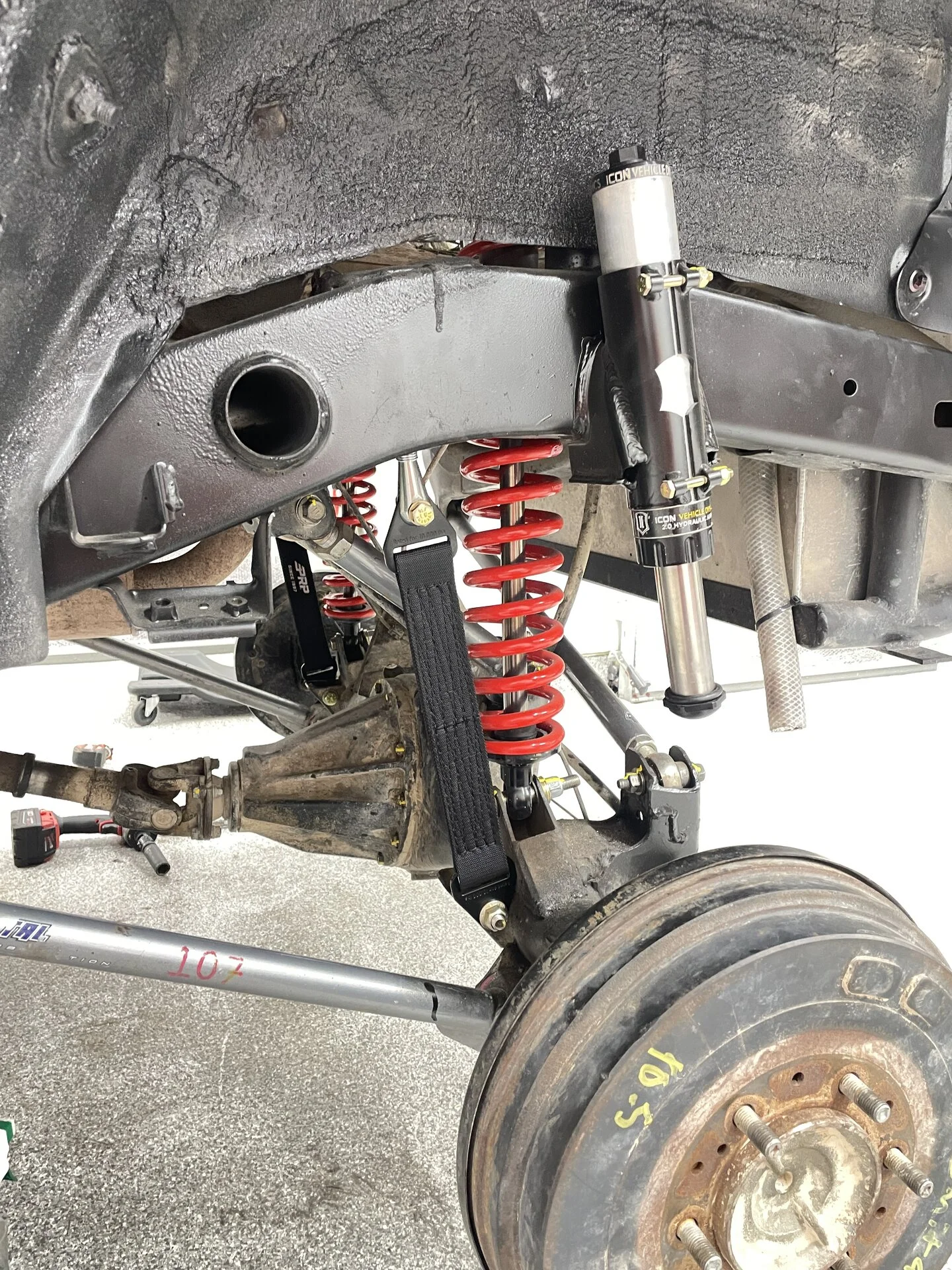

The 4runner is slow, because it's undersprung. The springs limit the speed we can go. They're good and soft for weekend wheeling, but too soft for racing. With the roll cage now welded into the engine bay at four points, the frame is stiff enough to force the suspension to work. The suspension frequency is too slow at speed. It needs to cycle faster than it does now, by alot. After a month of research and discussion with my racing mentors what we're trying next.
Fronts: 550 lbs/in --> 700 lbs/in.
Rears: 100 lbs/in (200\200) --> 127 lbs/in (350\200, with 350 overtaking at 2-3" before bottoming out)

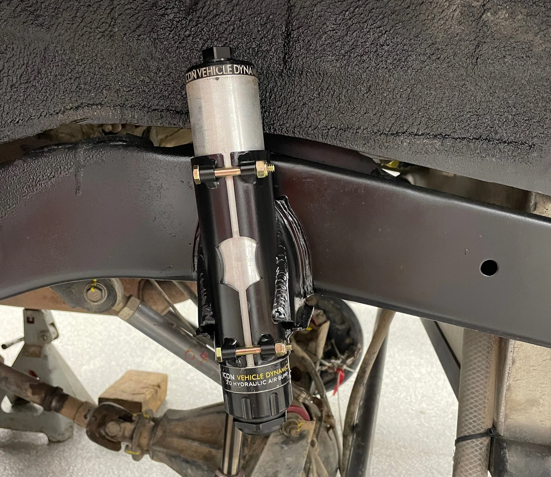

The rear now has Icon hydro bump stops, thank you TPM racing for providing them! Check them out for shock rebuilds and the like. I welded them into the OEM brackets. That took some time, but the results came out very clean. It's welded around the back side of the bracket as well. Images are at the end of the post.

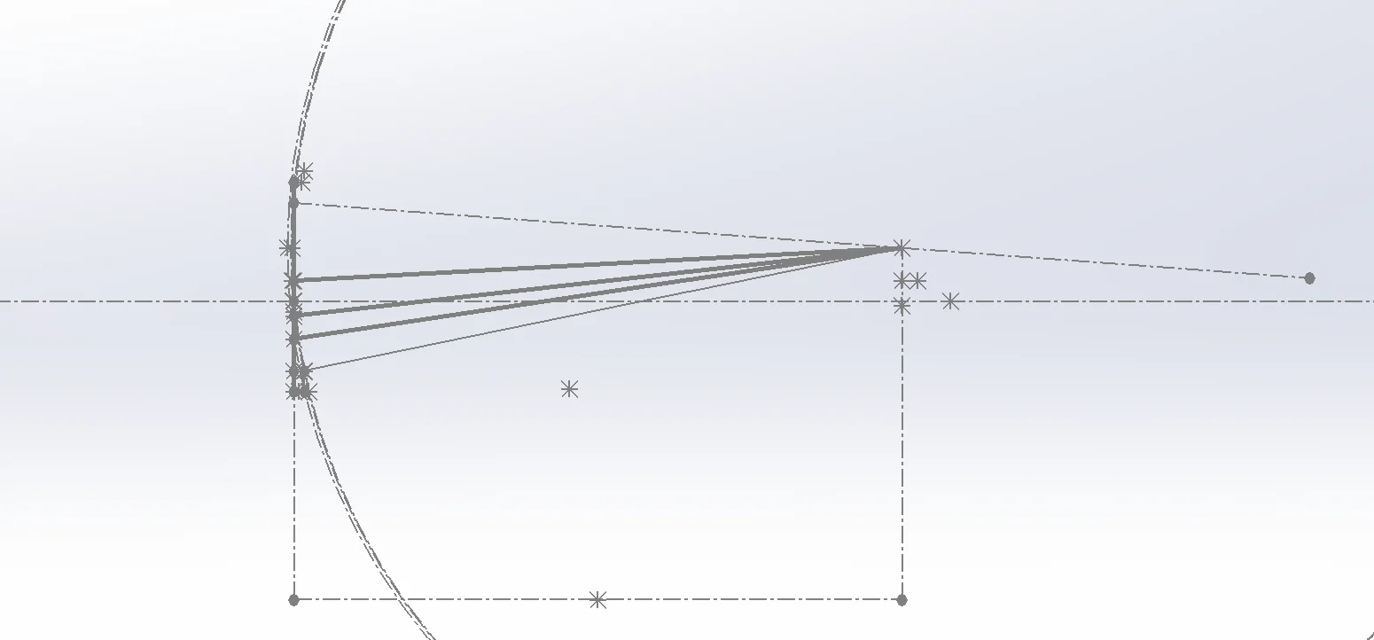

My rear suspension has a binding issue with the panhard. At it's current length, the panhard bar cuts out 1.5" of droop at it's bolting point. Right side fully droops, left side stays a few inches high. Therefore, I'll split the added length of the panhard with a pck bracket to rise the panhard bar on the axle. That also explains why I have such brutal axle steer on RTI ramps. So we'll try to make that better. Most rear LT's for 3rd gens are 10" long shocks and this one is 12. The bump stops are + 5/8" over stock, so most of the OEM travel is maintained.
The front suspension did great during the race, but again, undersprung. The first woop would load the springs almost completely, the next bump would almost bottom them out, and the 3rd woop would be a hard bonk if we were going all out. We kept our speed down to prevent that from happening. Our left front dipped into a rock ledge at 30 miles and hour and bent a grade 9 bolt, but it didn't work itself loose until a week after the race. That impact also caused a flat tire, which caused a 30 minute delay on time. It was so jarring neither I nor the navigator remembered to mark the hazard on the nav.

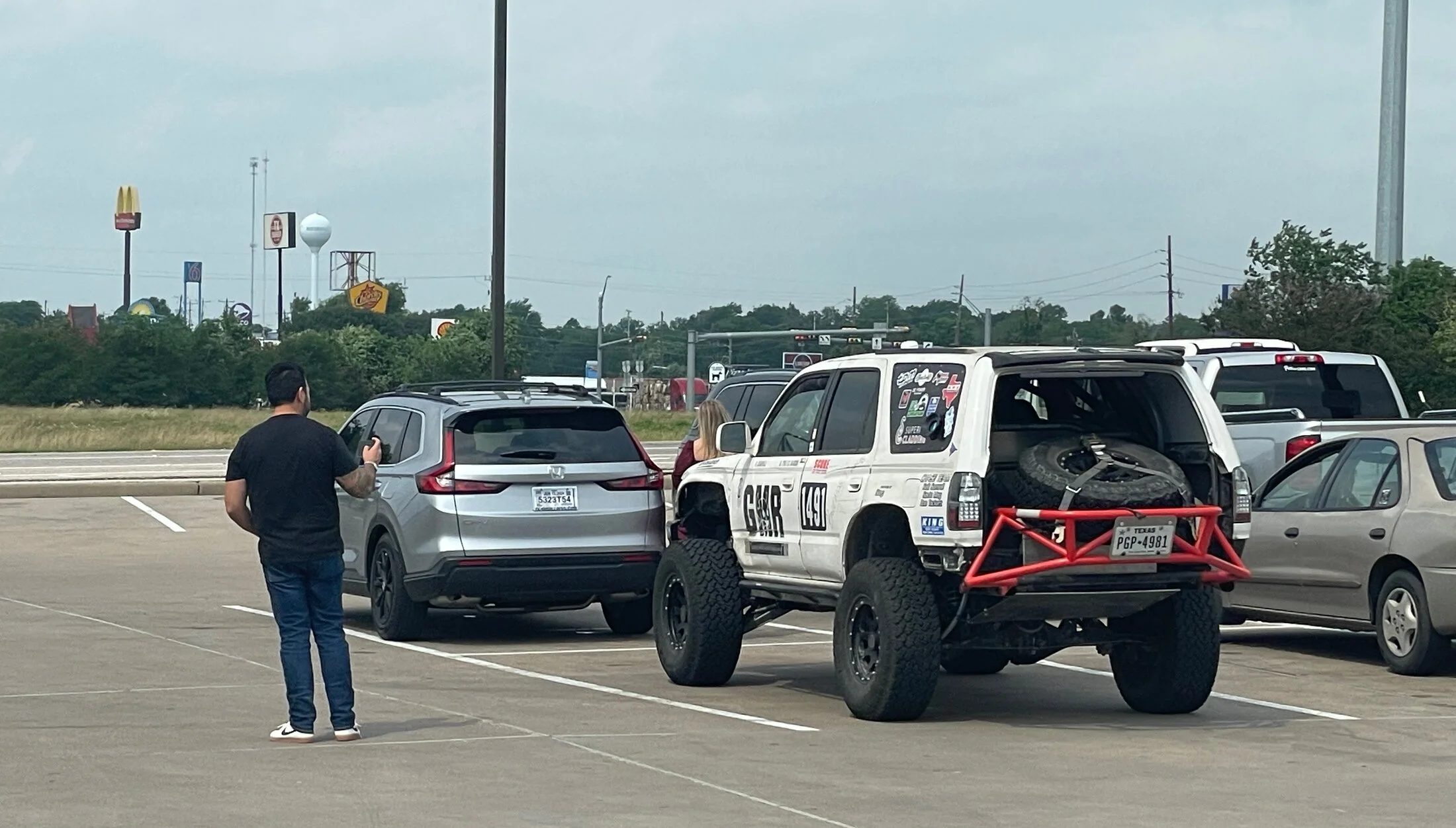

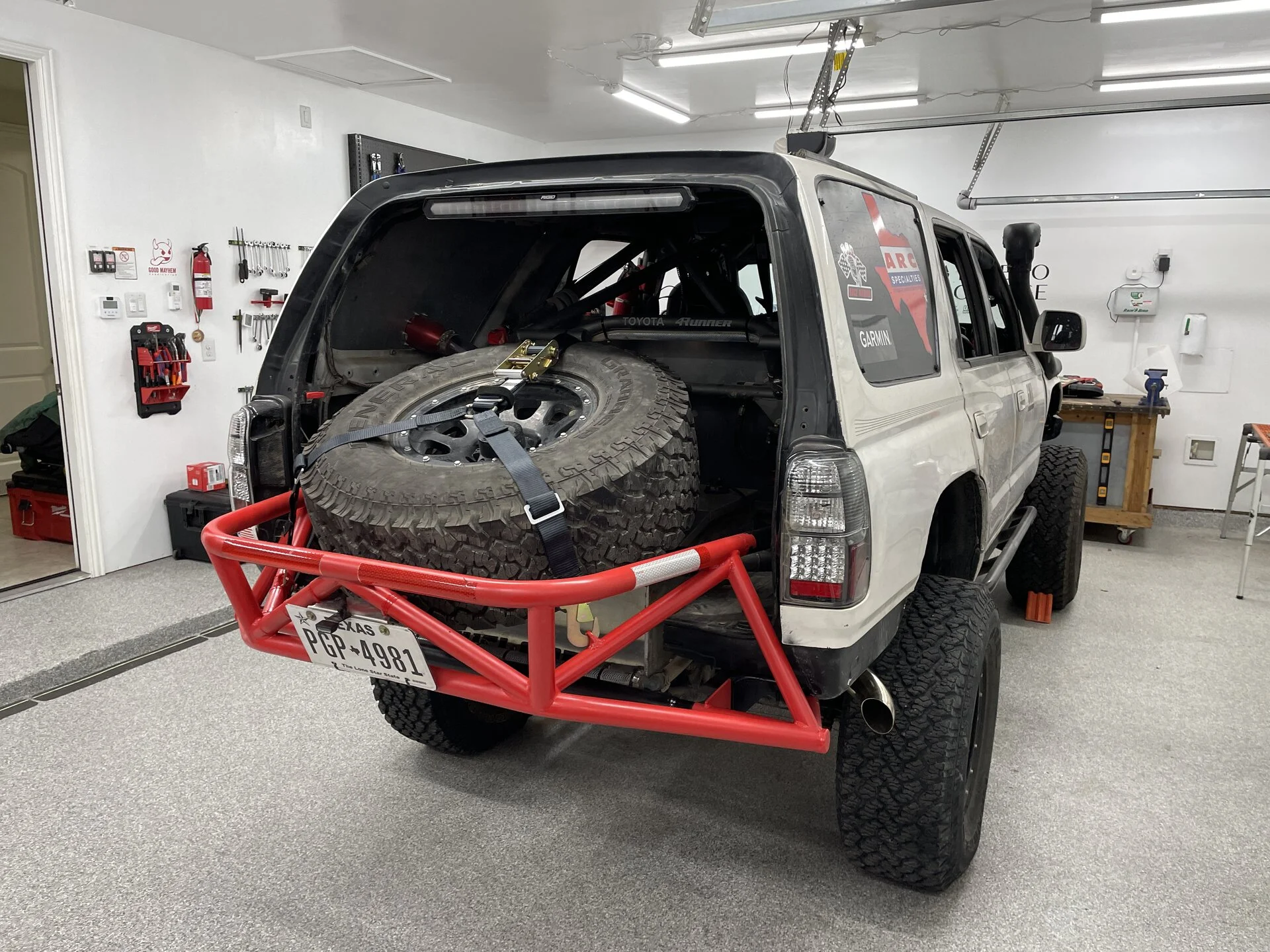

The back end needs extra tubing to make a bumper for the other racers to nerf. We'll start welding that this week. image below.

2. Rear crash bar is fabricated and painted.
3. Spare tire mount is redone and converted to use a ratchet strap.

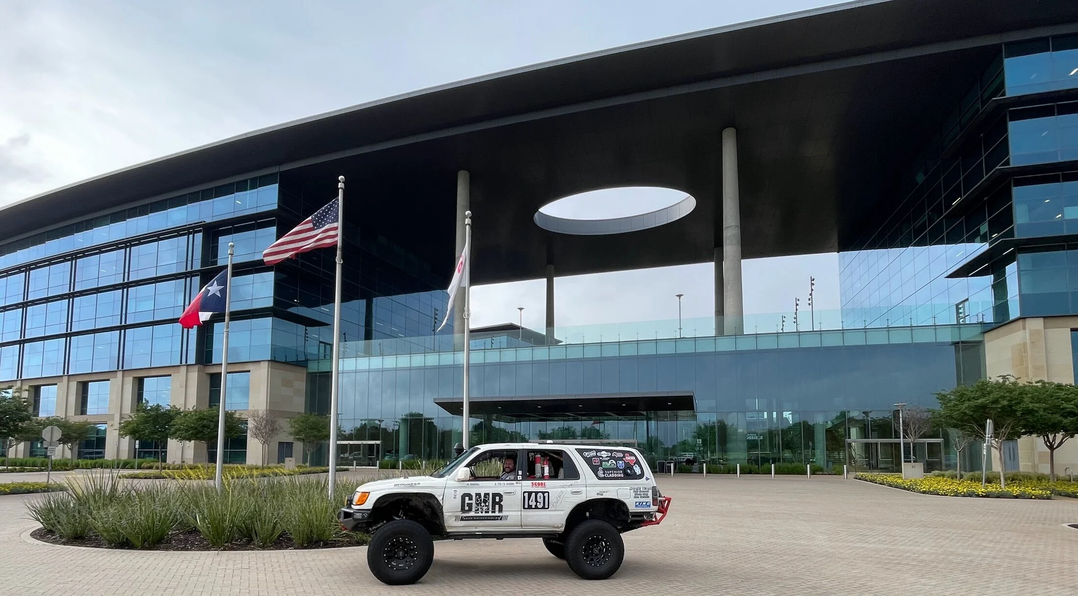

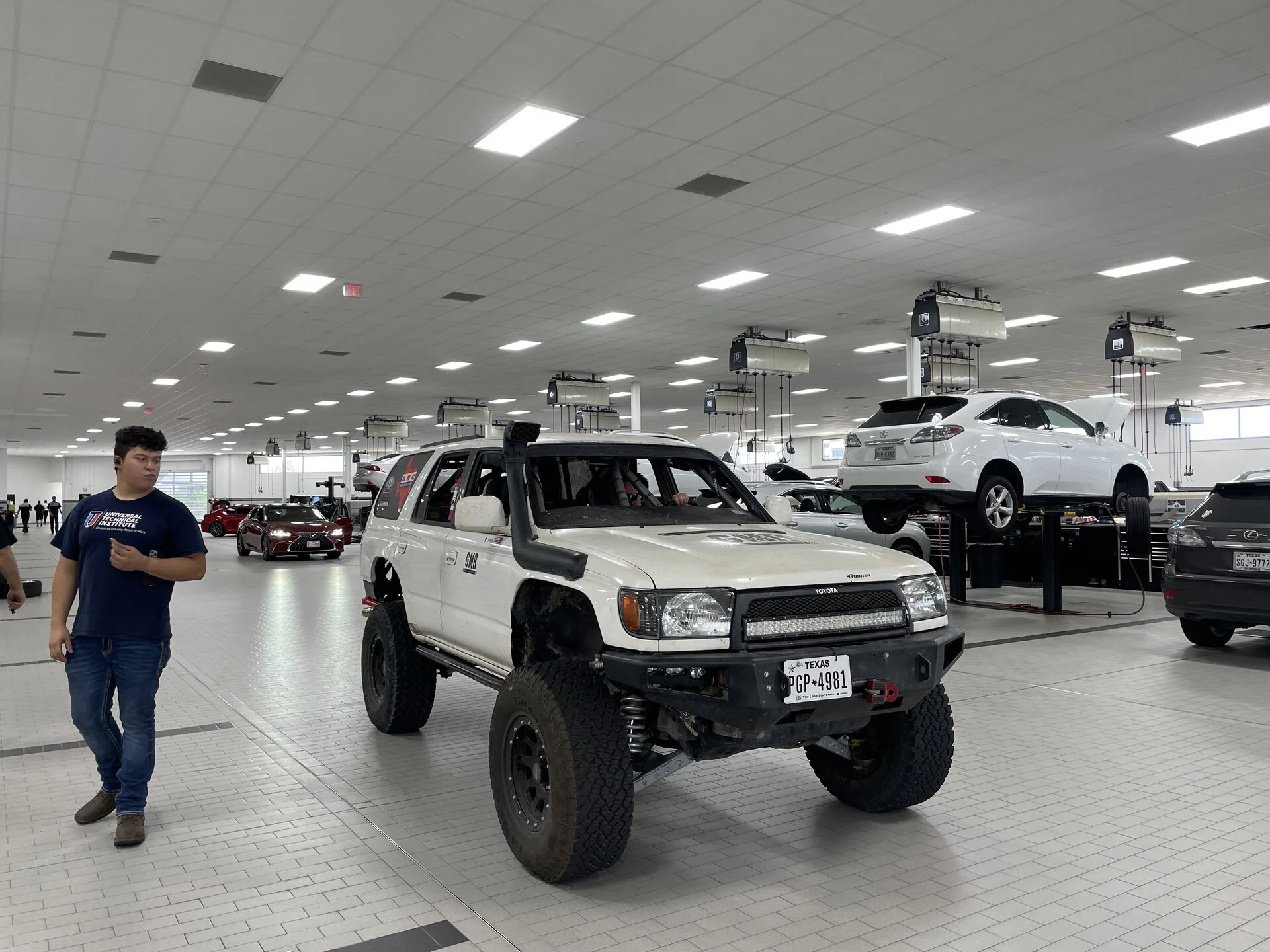

10. We got to share the fun at Northside Lexus in Houston. Cheers!

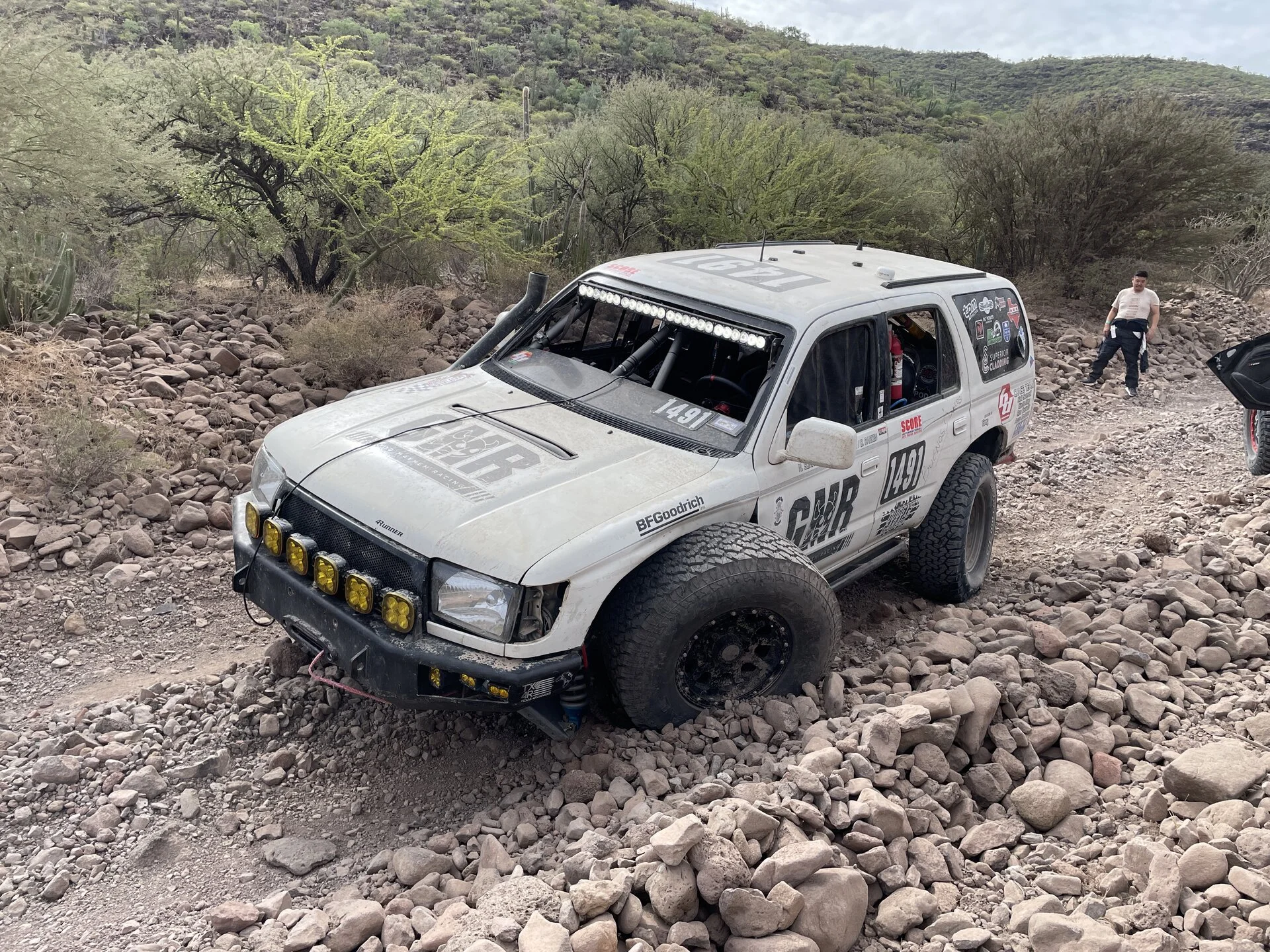

At Race Mile 366.6 on the #Garmin, the left front spindle failed and the lower ball joint ripped out its bolts. There was no obvious obstacle or rut that caused it. The race course was a gravel road at that point. The steering knuckle’s threads were sheared clean. Duc and Sam C. tried to Macgyver the spindle back together, but it gave way again. They spent the rest of the night on the mountain, suited up with helmets in the 4Runner.

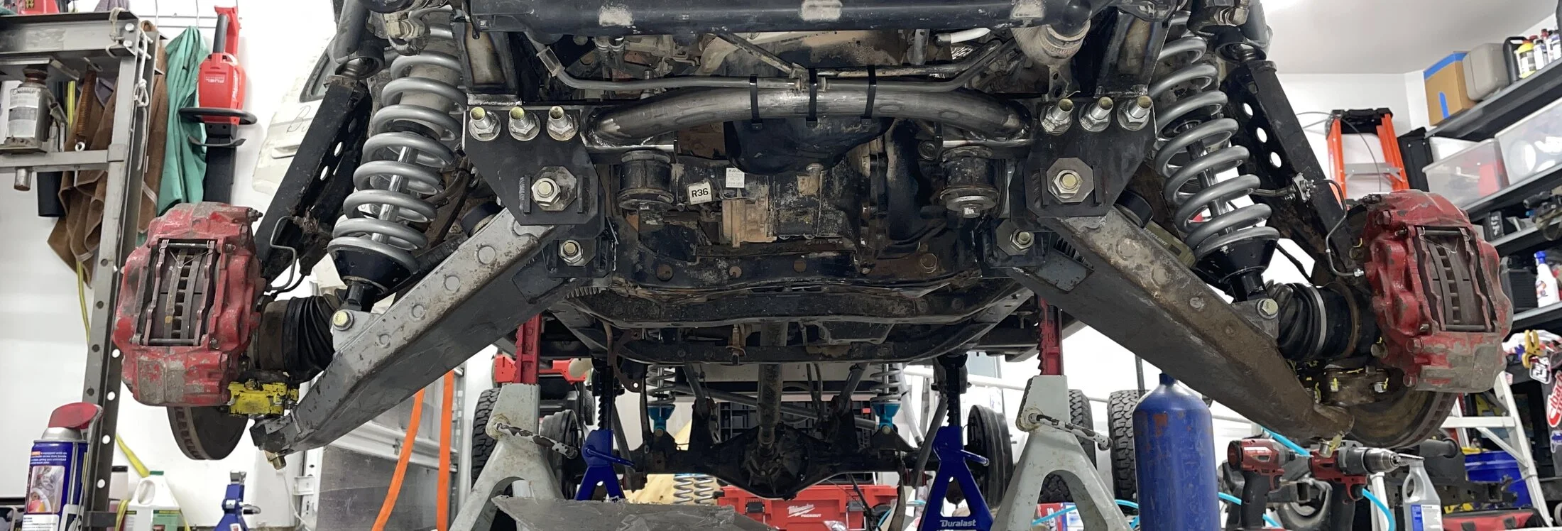

  • Design and fabricated new front subframe
  • Fixed broken spindle

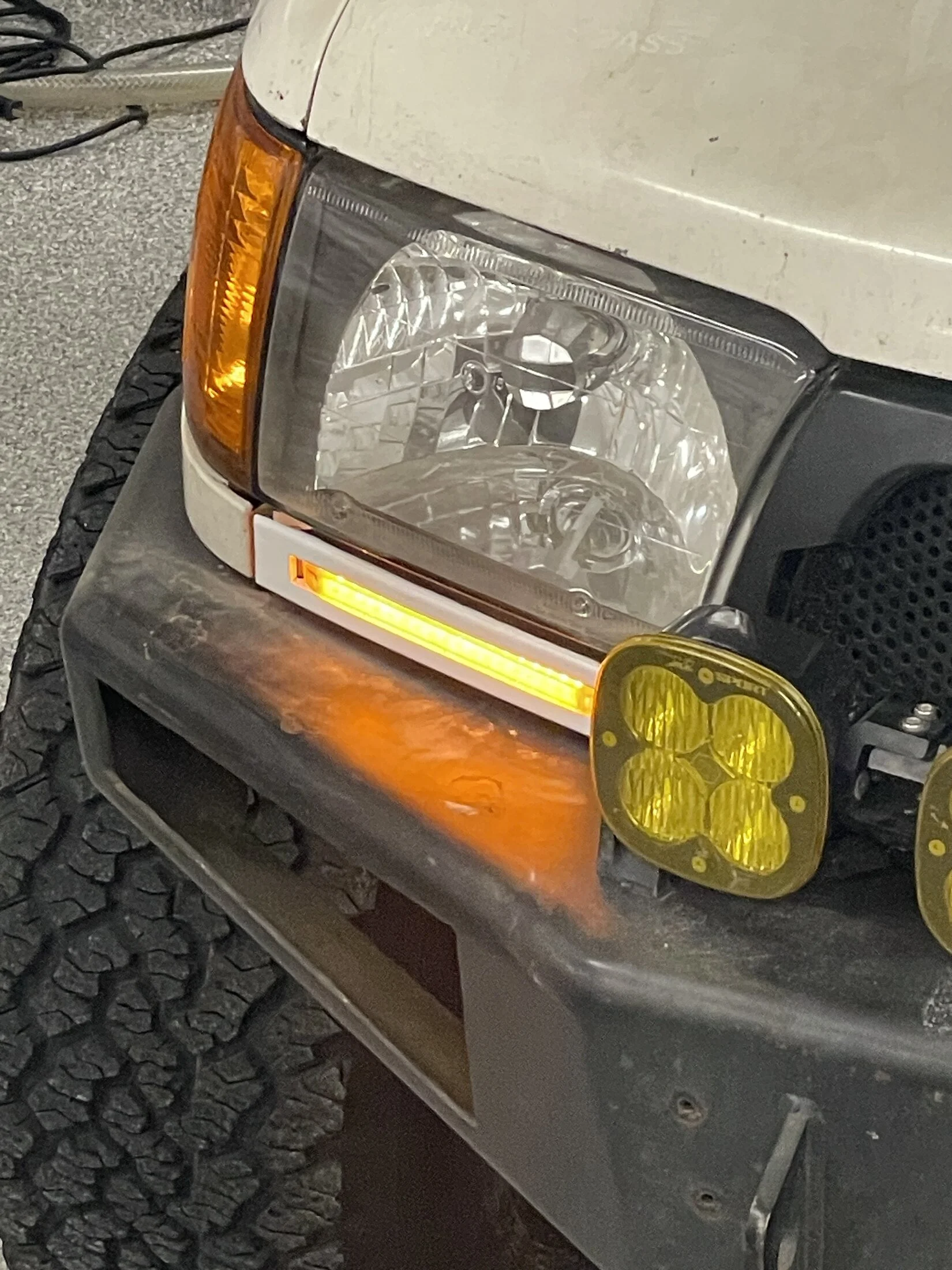

And now onto the group buy:
I have made underlights for the 3rd gen 4runner. It fixes a couple of problems we had during the Baja 1000, and others want the same thing on their SUV. with that in mind, group buy is live! Links below:
