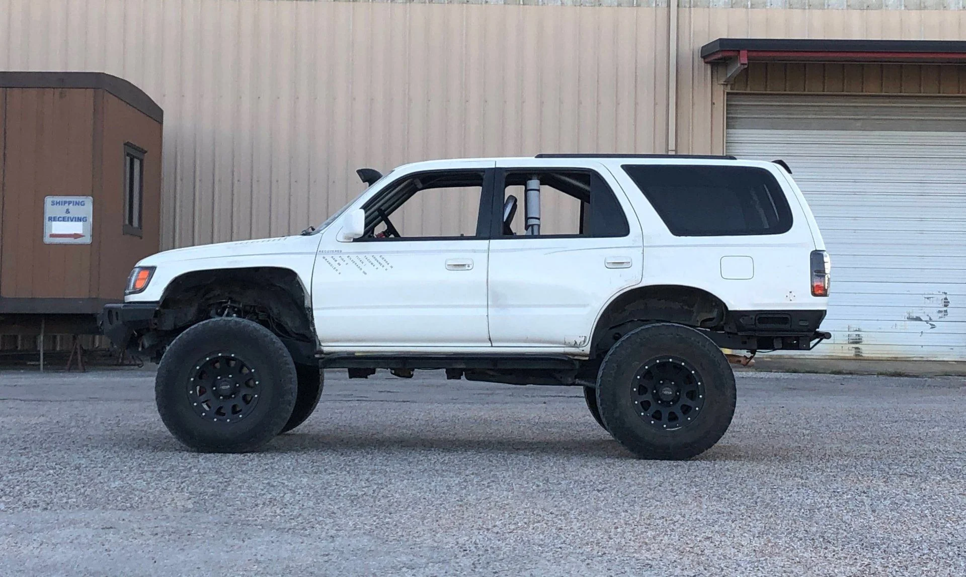

Howdy folks, I am building a '99 4x4 4runner to Score competition reg's. It's been wheeled alot from Moab to Texas, and I decided to build it for racing. The goal? Build a race-spec 4Runner, get some experience with smaller races for a year, then tackle the Baja 1000.
^Current photo
Current state of the build?
Wheeling Mods:

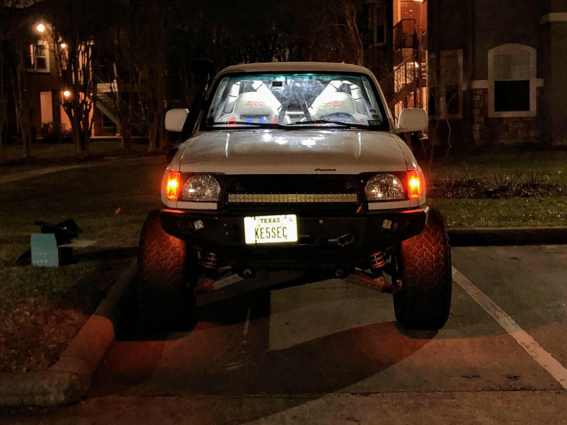

- Long travel Total Chaos Front with rear coilover conversion (this will likely put the truck in a Sportsman's Unlimited or Modified class)
- Radflo coilovers w/ Eibach springs. Dual rate setup in the back, 500 lbs in the front.
- Shrockworks Front bumper and sliders (mounts welded to frame)
- Warn Winch
- Some lights
- Not enough lockers
- Alot of Fender Cutting
- LBJ uniball conversions.

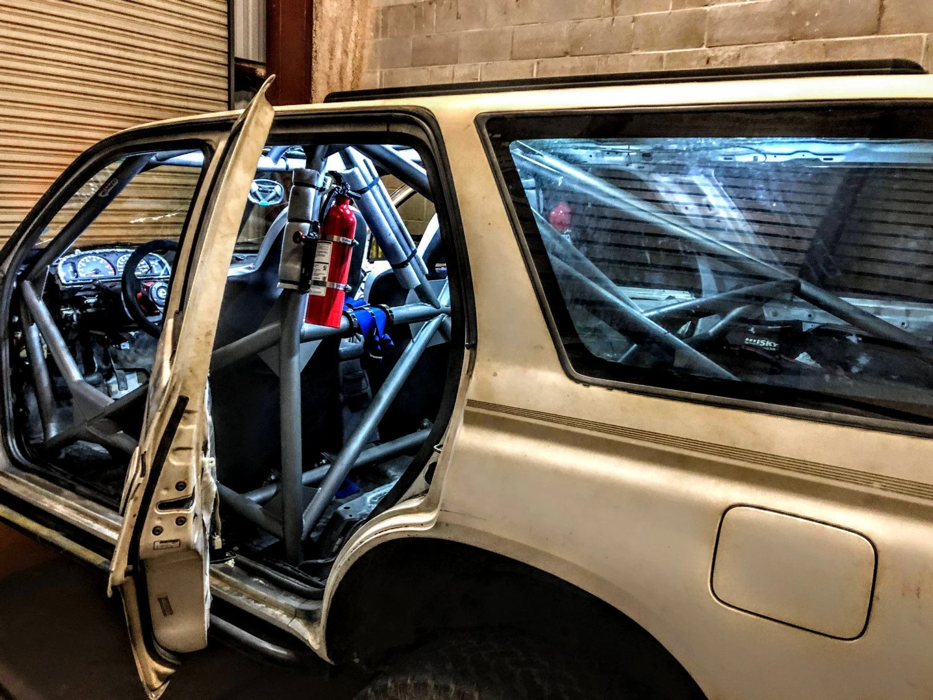

Racing mods so far.

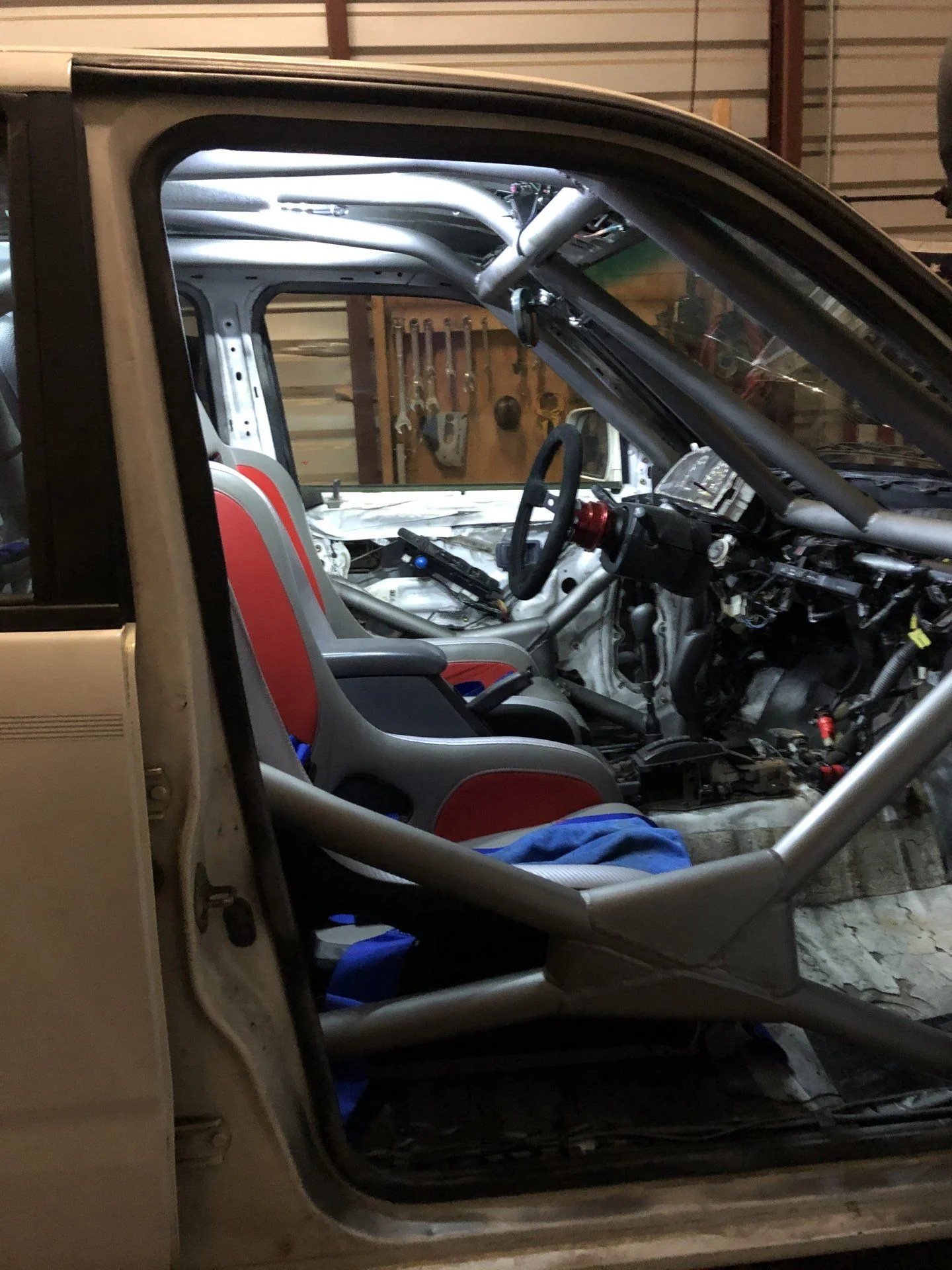

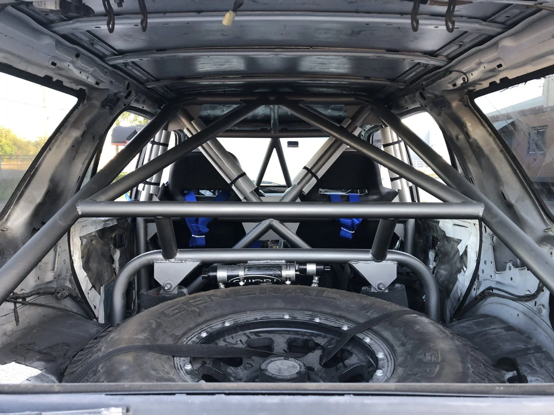

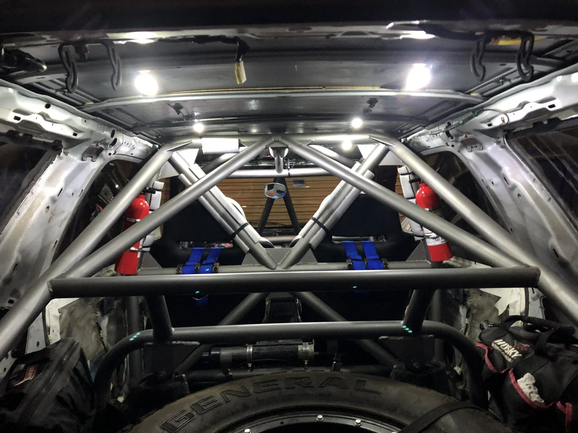

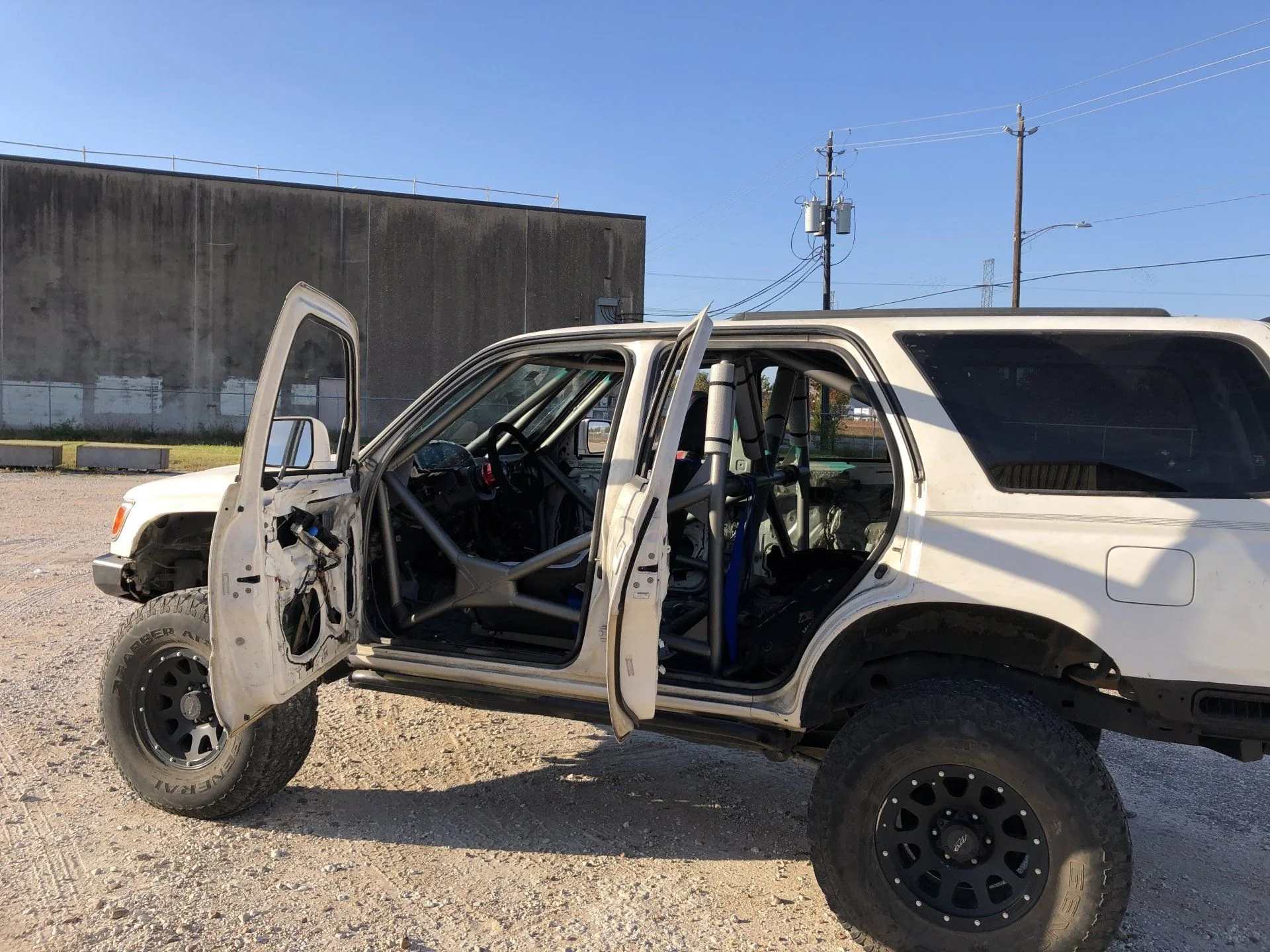

- Frame Mounted Roll Cage (AWS D1.1 Tubulars/Clause10, GTAW, Spec size is 2" .120 wall DOM Tubing // welded with ER70S-2 and ER80S-D2, undersize tubing is 1-3/4" x .120wall tubing). Bend Radius is 6.5", Steel-it gray and black

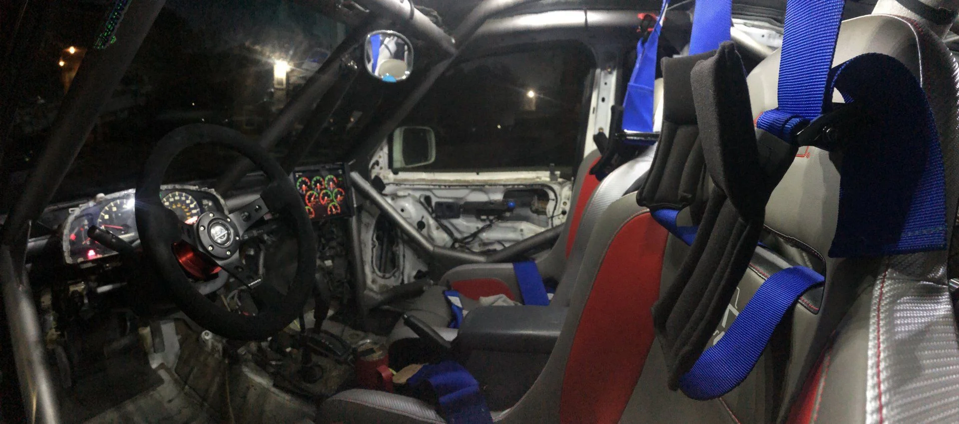

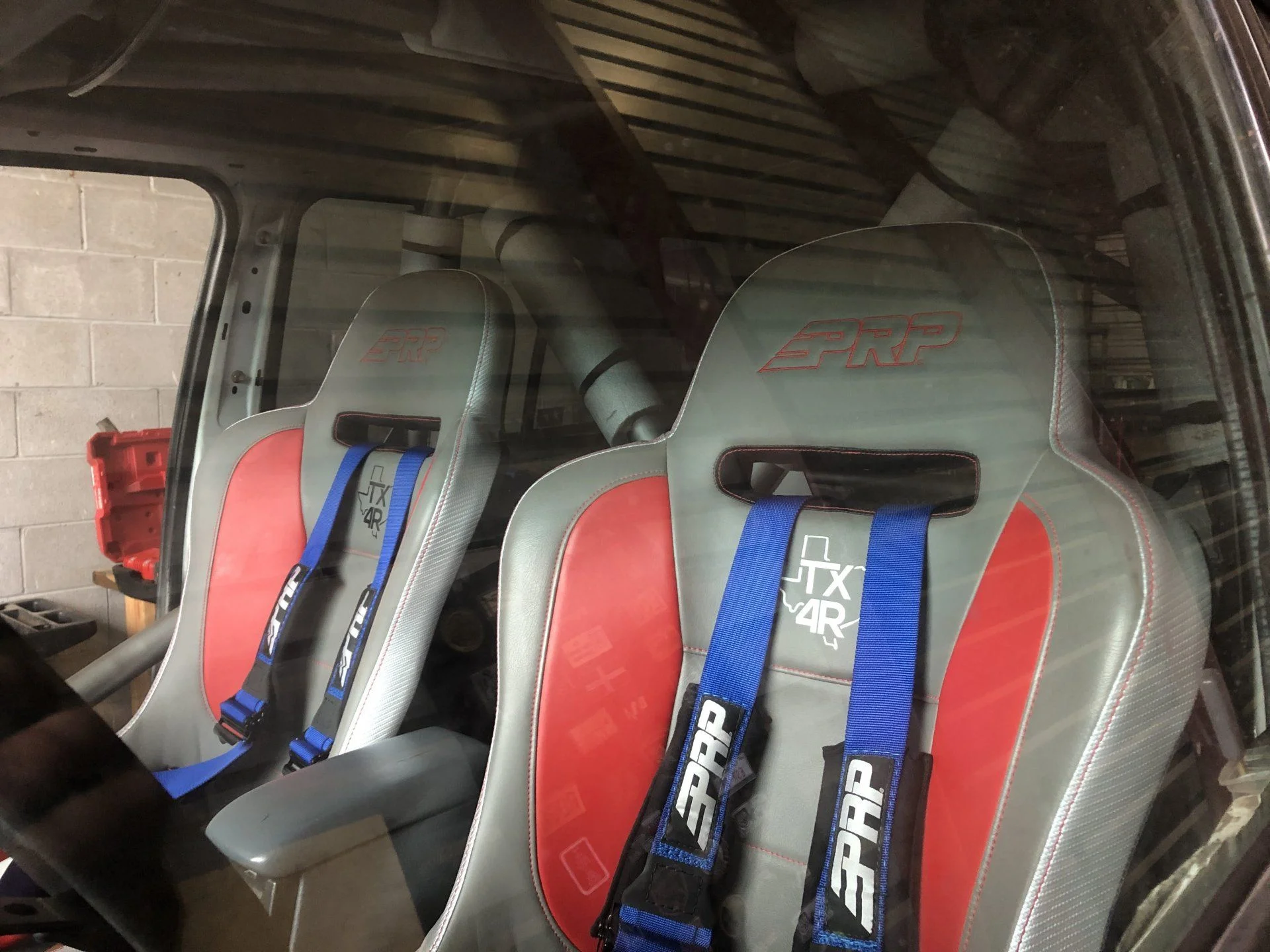

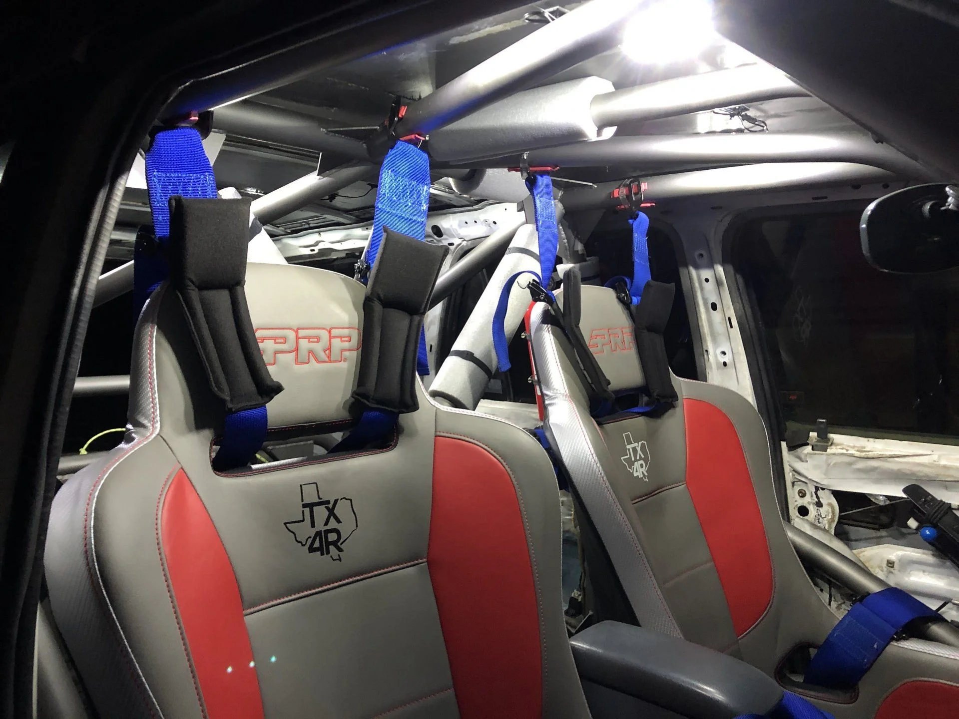

- Seats and Harnesses Mounted (PRP Podium Elites & SFI 16.5 / 5.3 point harnesses).
- QD Steering Wheel
^photo doesn't include passenger seat^
^current photo^
^current photo^

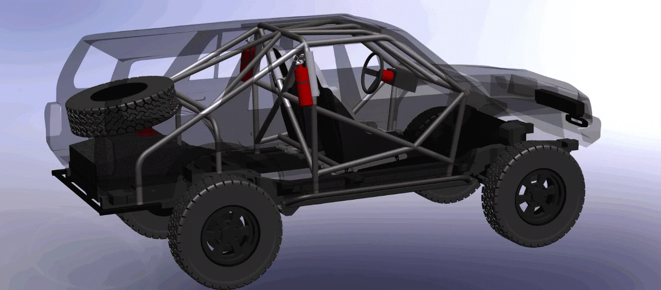

Here's what the mount for the portable fire extinguishers looks like. I think the QD mounts will work, but I had use better hose clamps than the ones provided.

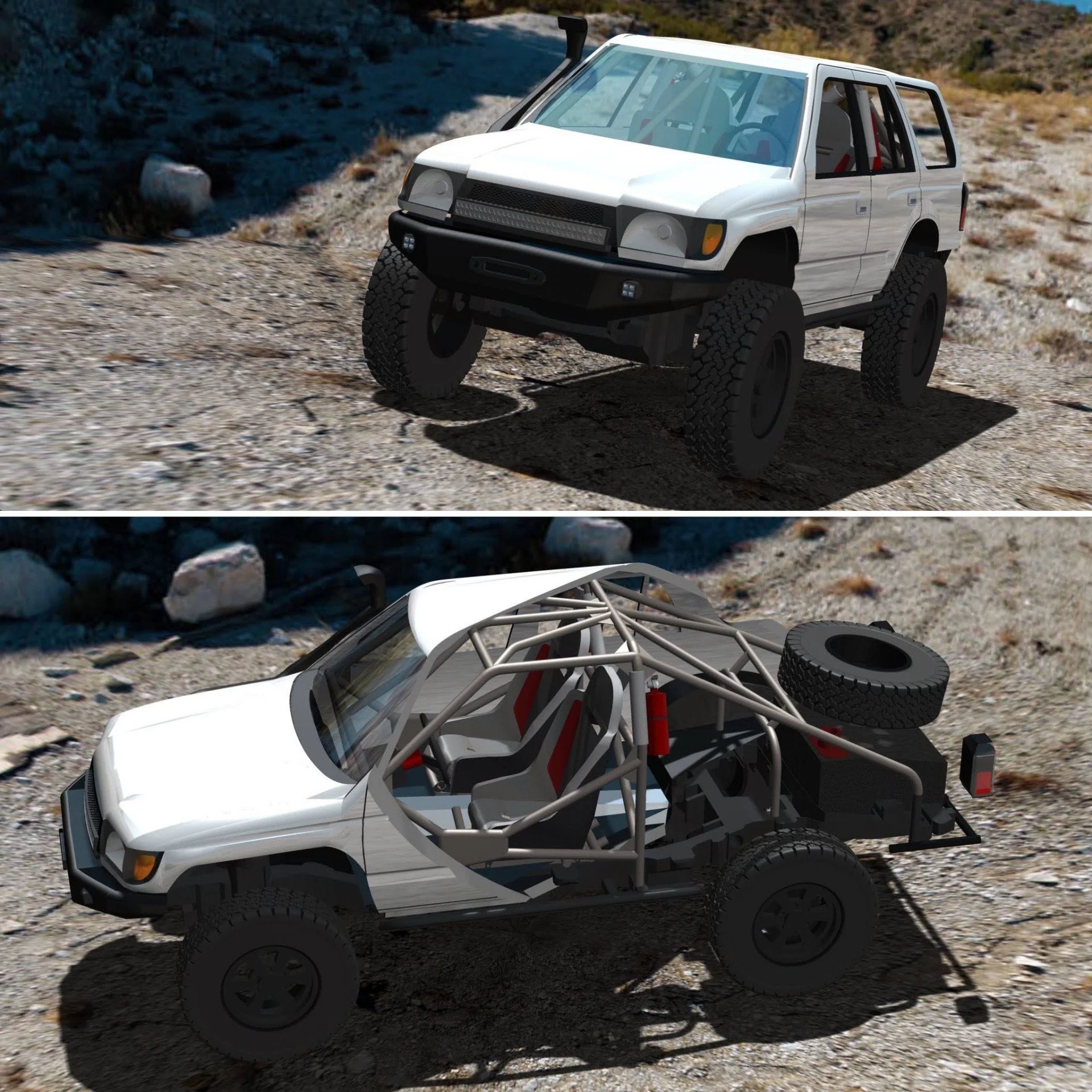

And for anyone who's curious on what's going on inside, here's a transparent view in solidworks. That shows all the roll cage tubing present, except for the gussets. Fuel cell will go right behind the rear axle/panhard, going through the rear floor board about half way.
:cheers:
Hey, keep us up to date on this, ok?
Here's the updated model with the gussets--finally figured out how to do them.

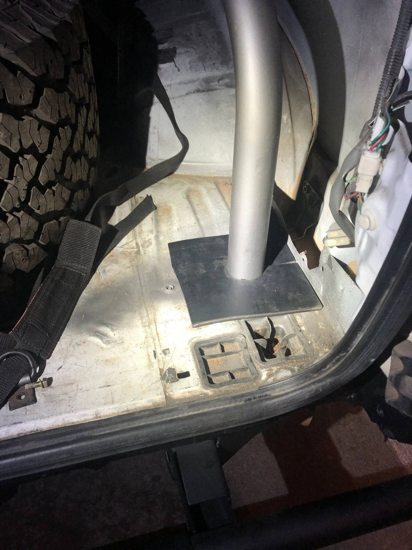

Saddle gussets were welded where occupants get into the vehicle, and plate gussets were used everywhere else. If I remember right, there's 10 saddle gussets and about 50 plate gussets.
Currently I'm working on sealing up the roll cage holes. Since the roll cage is frame mounted, it cannot be welded directly to the body. For convenience / inspection sake, I'm just sealing off the holes with rubber and making some gaskets to make them water tight. A couple of examples are included below.

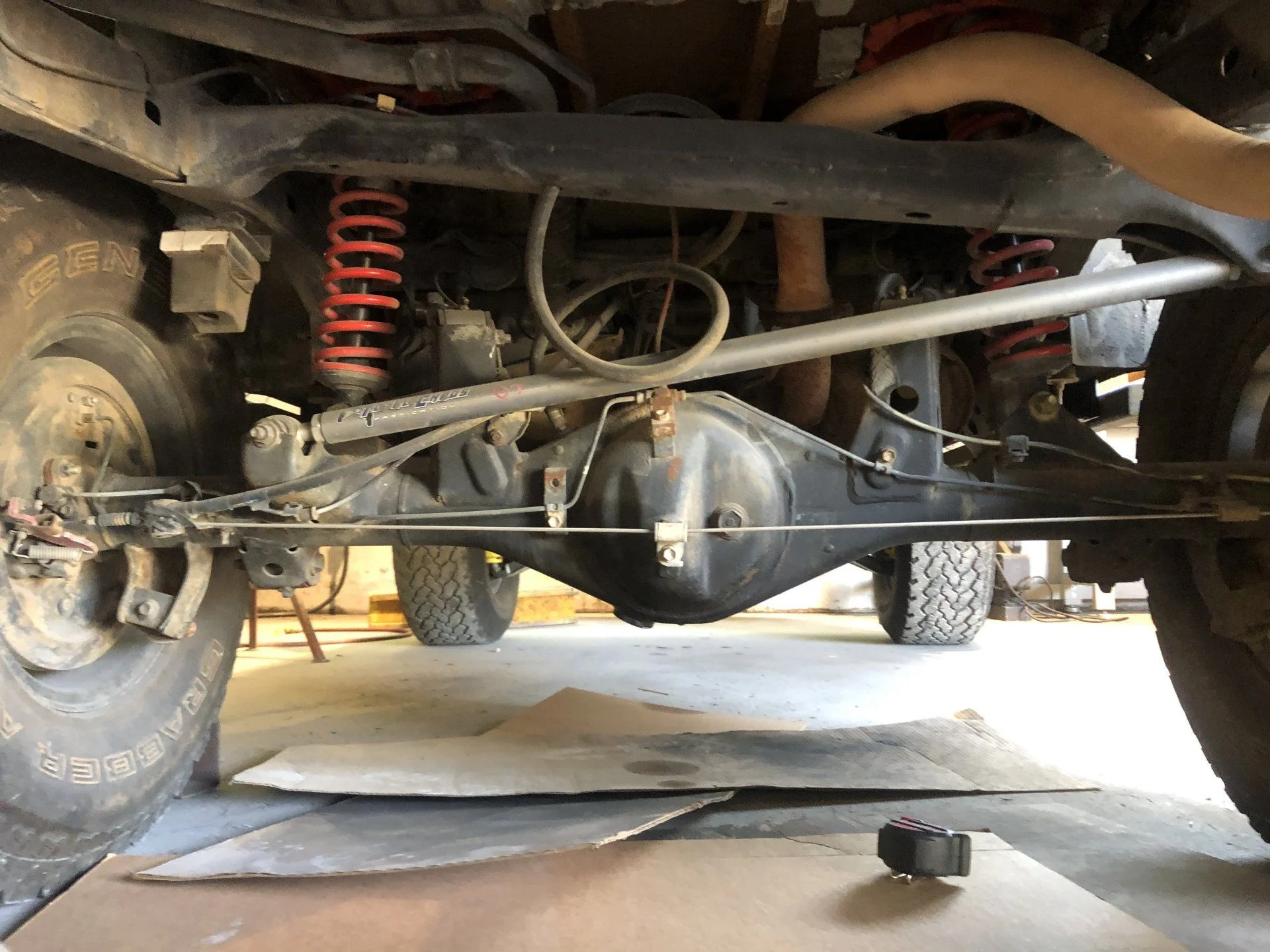

- It's 4wd, and I plan to keep it 4wd. The extra 1/2" of long travel that can be added by losing the front diff isn't worth it in my opinion, especially since my truck isn't fast enough to really push the 100mph+ rated 4x4 setup Toyota manufactured.

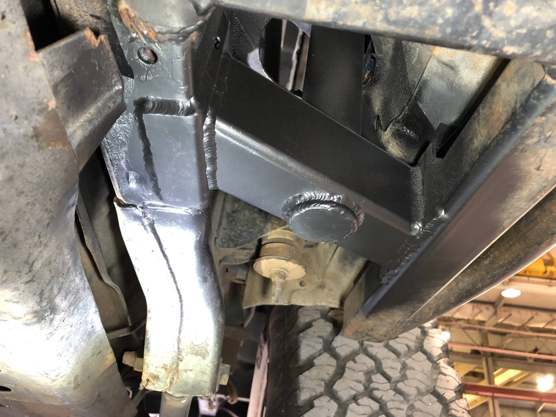

The cage ties into 2.5" box tubing that is welded/gusseted to the frame and rock soliders with solid 6"-10" long pins that cap the 2" tubing.
- I might do an engine cage, but I would use to to protect the engine, just tie the front of the frame to the roll cage.
- I like Total Chaos's design and recommend it. I came up with the rear coilover conversion with the limited space the 3rd gen has between frame and axle. Cutting out the spring perches and installing coilovers in their place made sense, and I use traffic cones to waterproof the coilover perches.
-Welding machine is a water cooled Miller syncorwave. Water cooling is probably not needed for welds like these. I am a degreed welding engineer in heavy fabrication, so this has been a fun learning project. I used a crane to lift the roll cage up and down to fitup and weld in position.

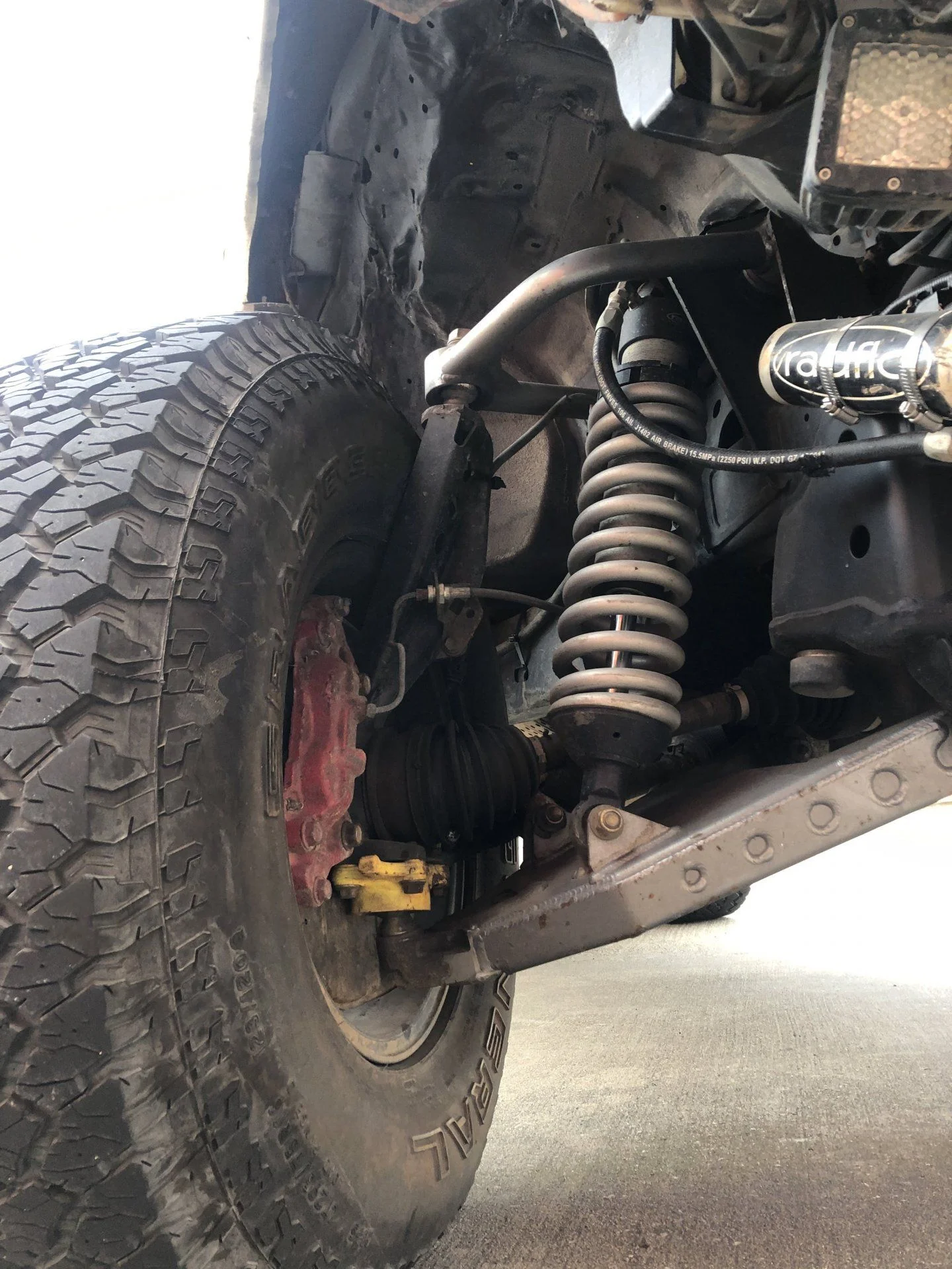

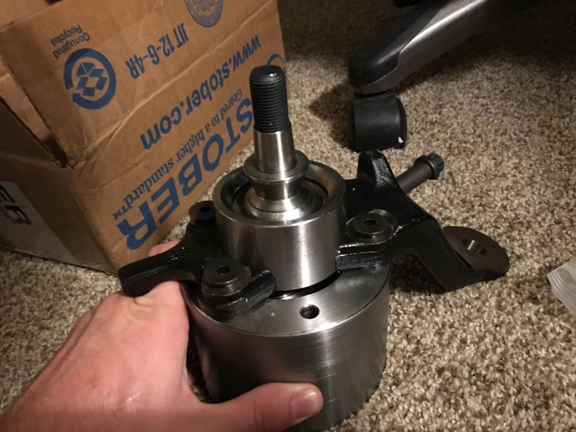

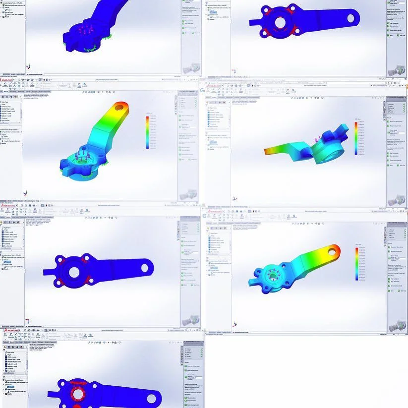

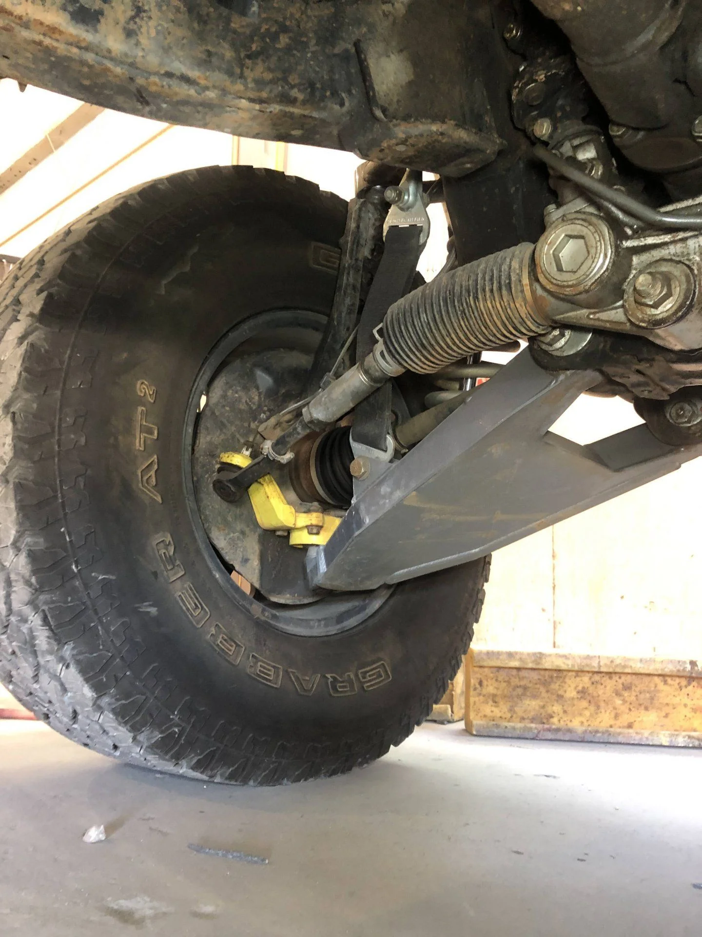

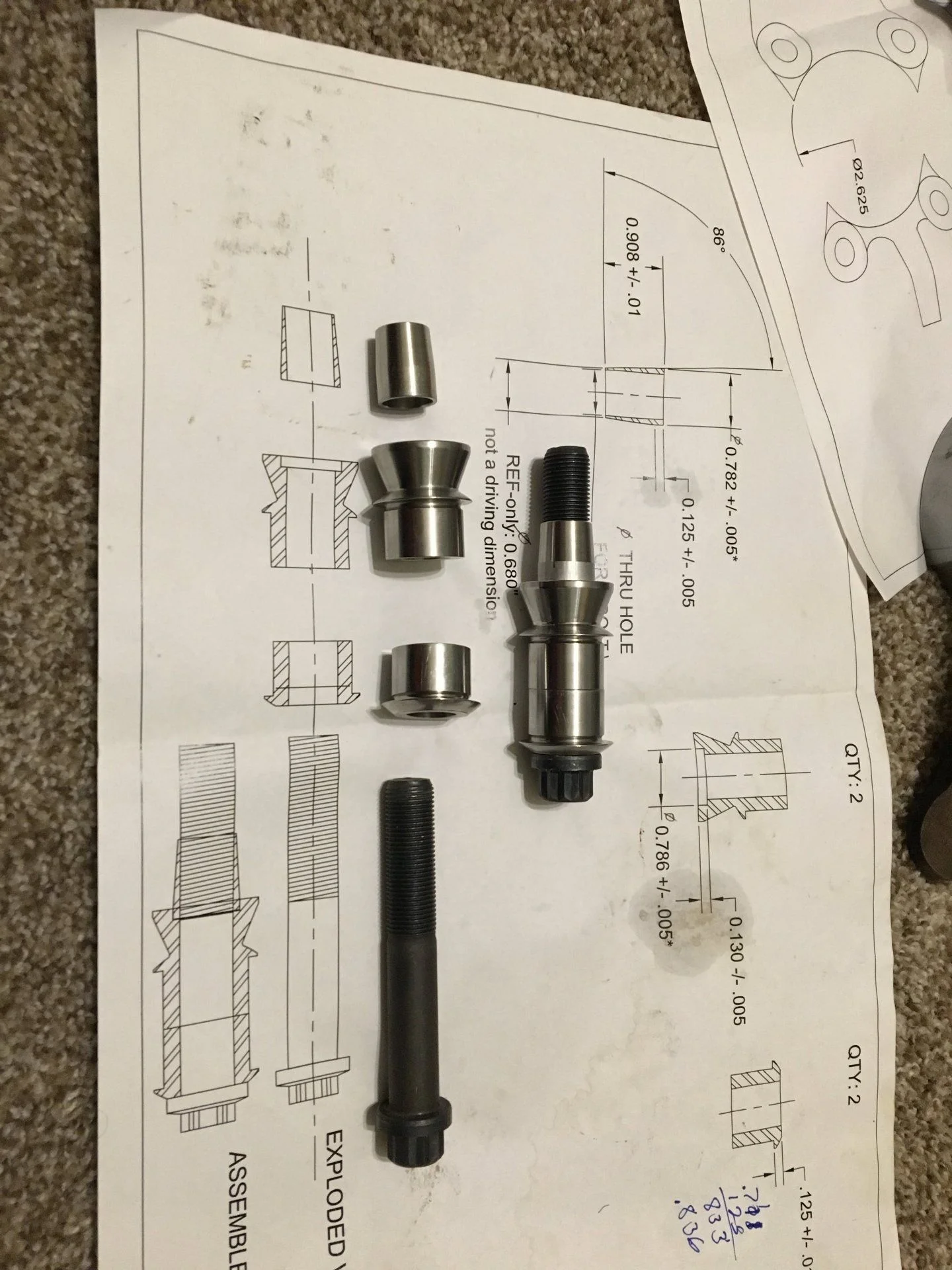

- I designed my own lower uniball conversions for the front. Bored out OEM balljoints and fabricated a uniball cup setup with shearpin-sleeve connections. They work great.

- I learned solidworks as part of my degree program, but it was only one class. I've been learning and practicing with solidworks after hours as I've been getting more serious about modeling more than just the cage.

Here's more photos from my uniball conversion.
^^I also modeled it in Solidworks before manufacturing them.

Thanks man! It's fun to build the 4runner to utilize long travel to it's full extent. By the time 3rd gen drivers push their long travel kits to the limit, bet's on the rest of the truck is feeling the pain. From daily driving to the woops, making it more usable is worth it.
^long travel + uniball lower ball joint conversion + 13WL brakes.

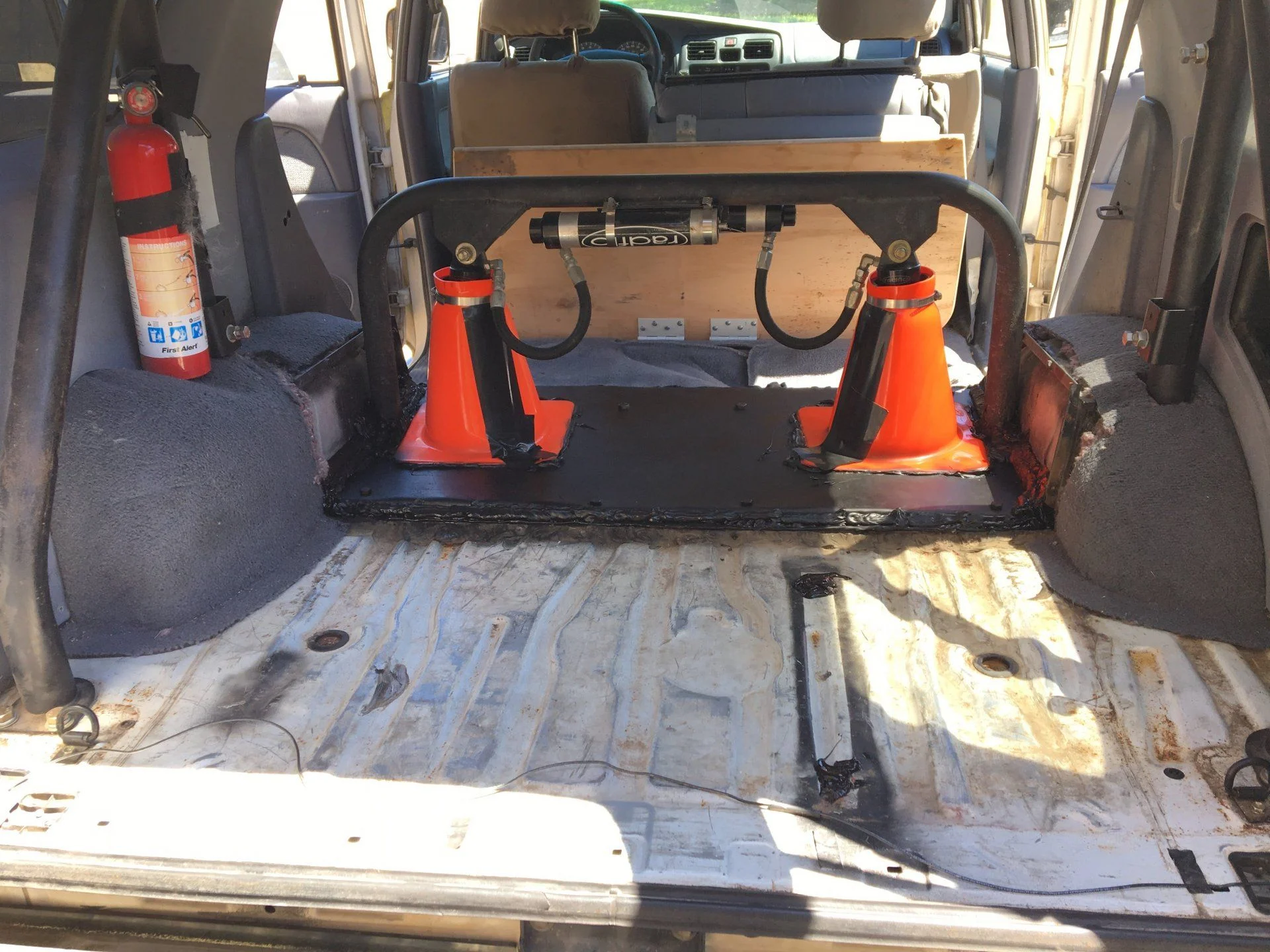

^rear coilover conversion mounted where the previous spring perches were.

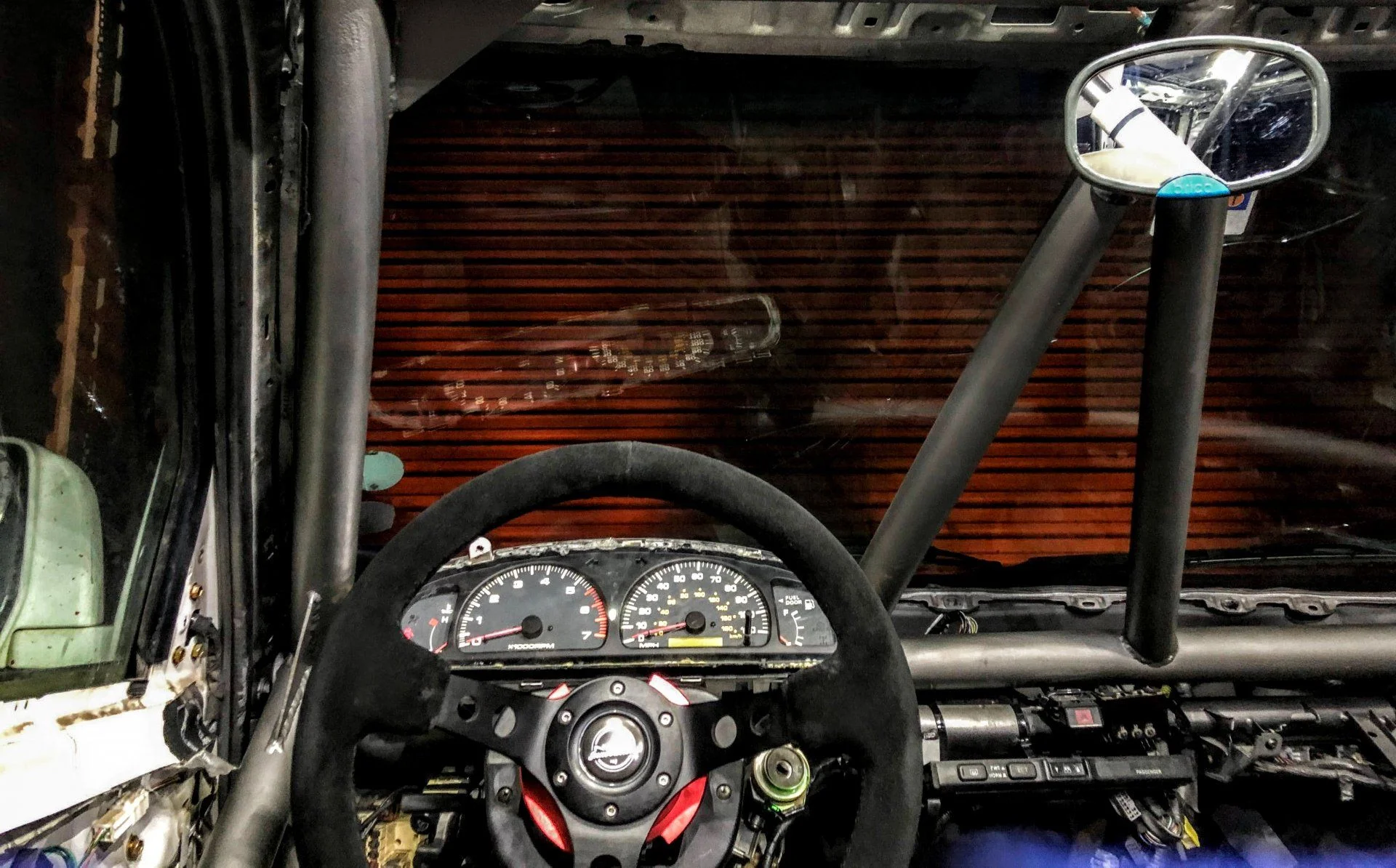

This weekend was a tedious batch of minor work.

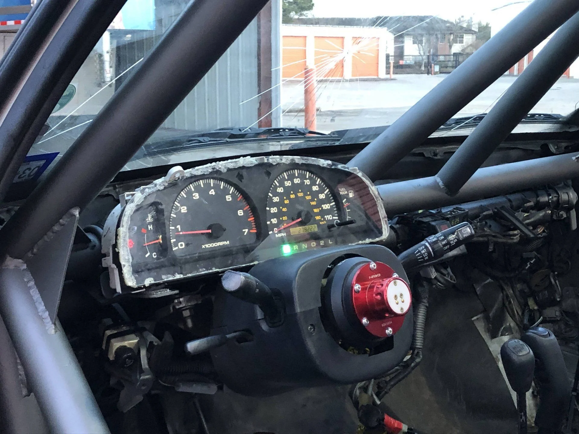

-1 chop the steering column cowling to better clear the instrument panel.
-2, splice the wire to the ebrake/parking brake sensor---I cut it accidentally during the roll cage work.
-3, wire the horn, torque the QD steering assembly correctly. I used a dome light's grounding shoe to complete the circuit. I think the Honda Shoe Horn connector is a better idea, so I've ordered one to keep laying around if mine starts having problems.
^^fun fact, all of the wiring harness for cruise control is still there. Cruise control is pointless on a build like this, but it's neat to still have the option to fiddle on.
-4 remount my wheel facing, marker lights, I had broken a few zipties over the years.
-5 get it state-inspected (passed with flying colors)

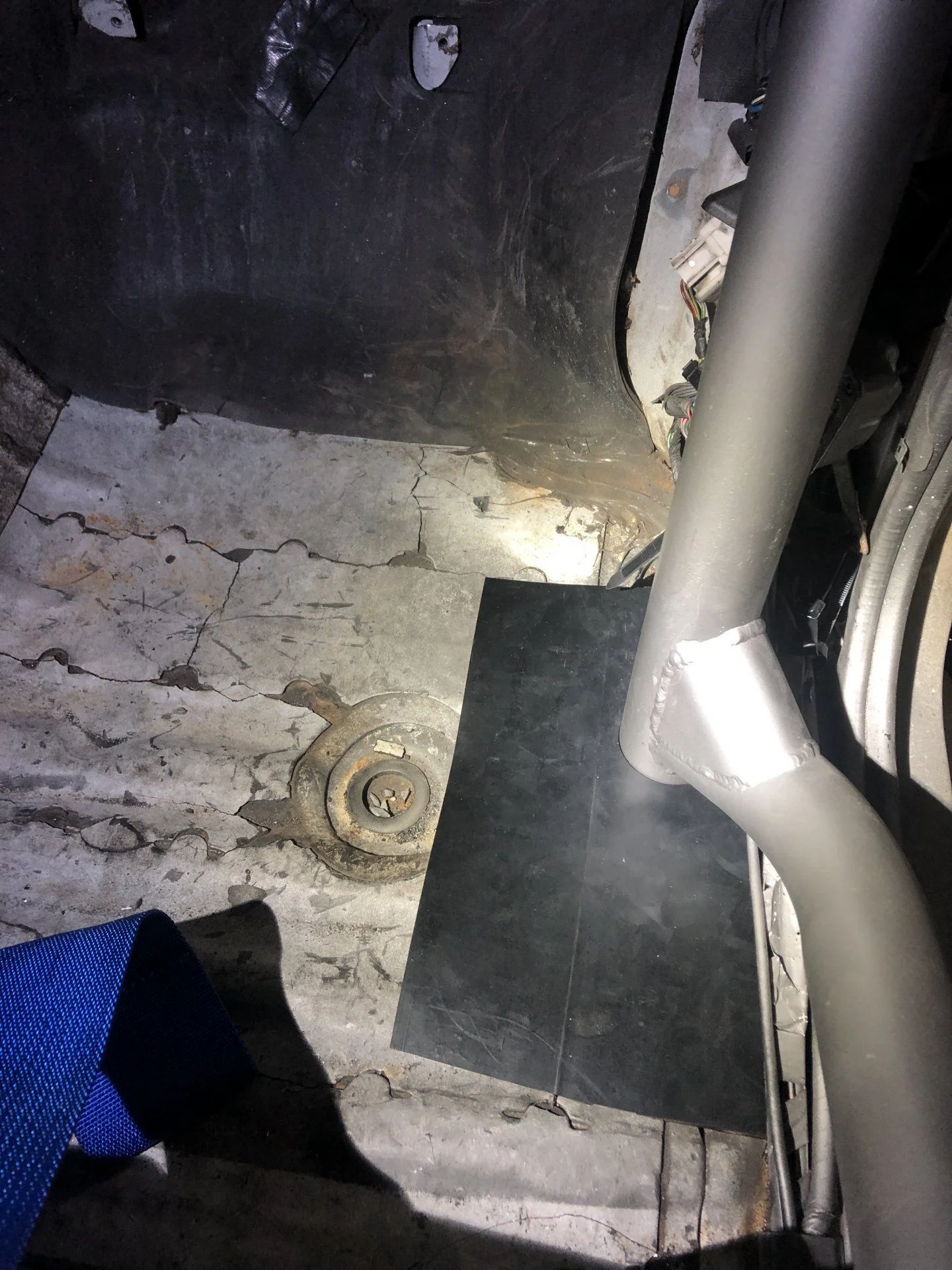

-6 dry out the firewall/floorboard, because a couple of fresh rock whips in the windshield allowed water to leak through during some rain today. Time to get a new windshield, again.
-7 ordered a replacement instrument panel. I'd like to figure out a better way to mount one, but I broke 3 of the 4 mounting points on mine. Once I get that figured out, it'll be time to fabricate a dashboard.

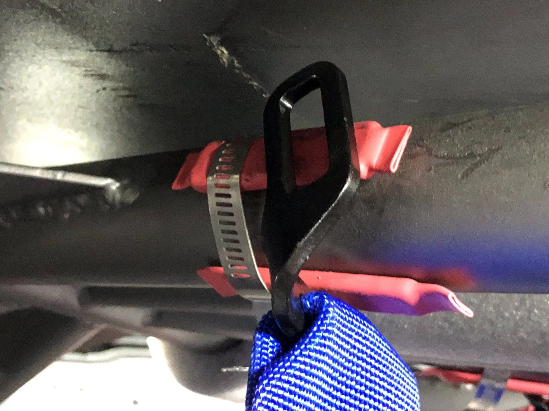

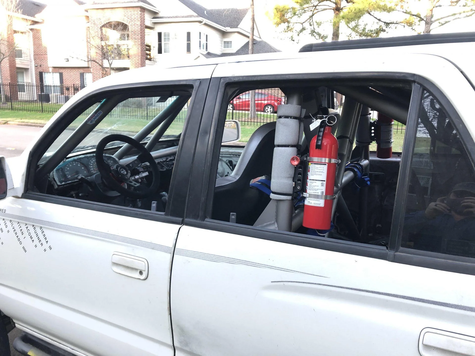

1. Added magnets to the rollcage overhead to act as QD points for the harness buckles. It makes both ingress and egress much easier. They're strong enough to hold the buckles during road driving and speed bumps, but light enough to easily pull overhead.
Next up was an ipad mount w/ an obd2 scanner full time, Veepeak OBDCheck BLE+. The ipad's old, so it's slow at refreshing. Maybe I'll try my iphone and compare it to the ipad, see if the ipad's the limiting factor. However, I wonder if it's just as limited by the data rate of the 90's erra OBDII computer system instead, since it's about 50 times slower than today's CANbus computers. This would be the copilot's/navigator's gauge cluster if I keep the stock system in place. If I were to ever do an engine swap, I'd rather do a double-dash setup where both occupants can see drivetrain/temps info.
