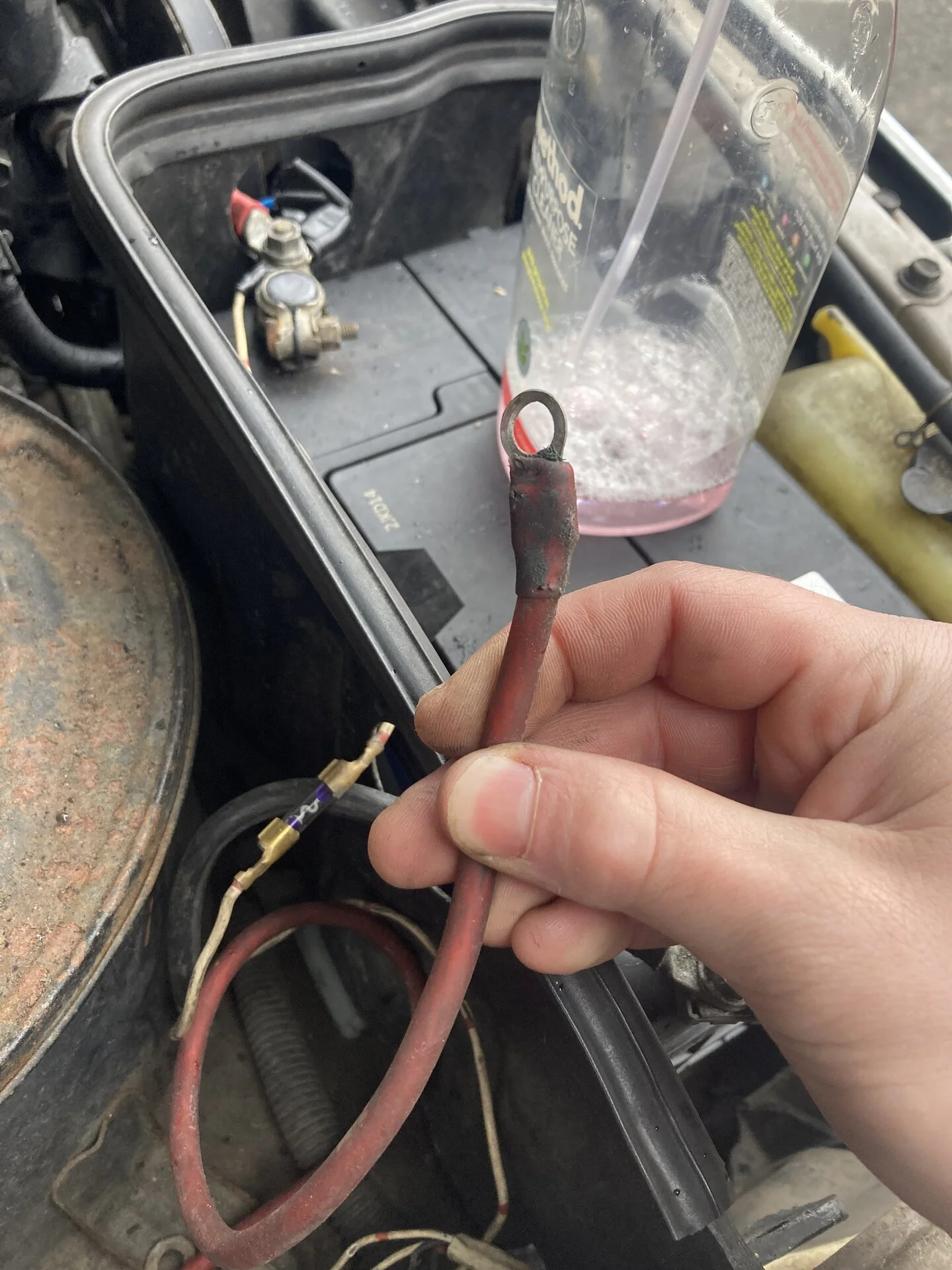

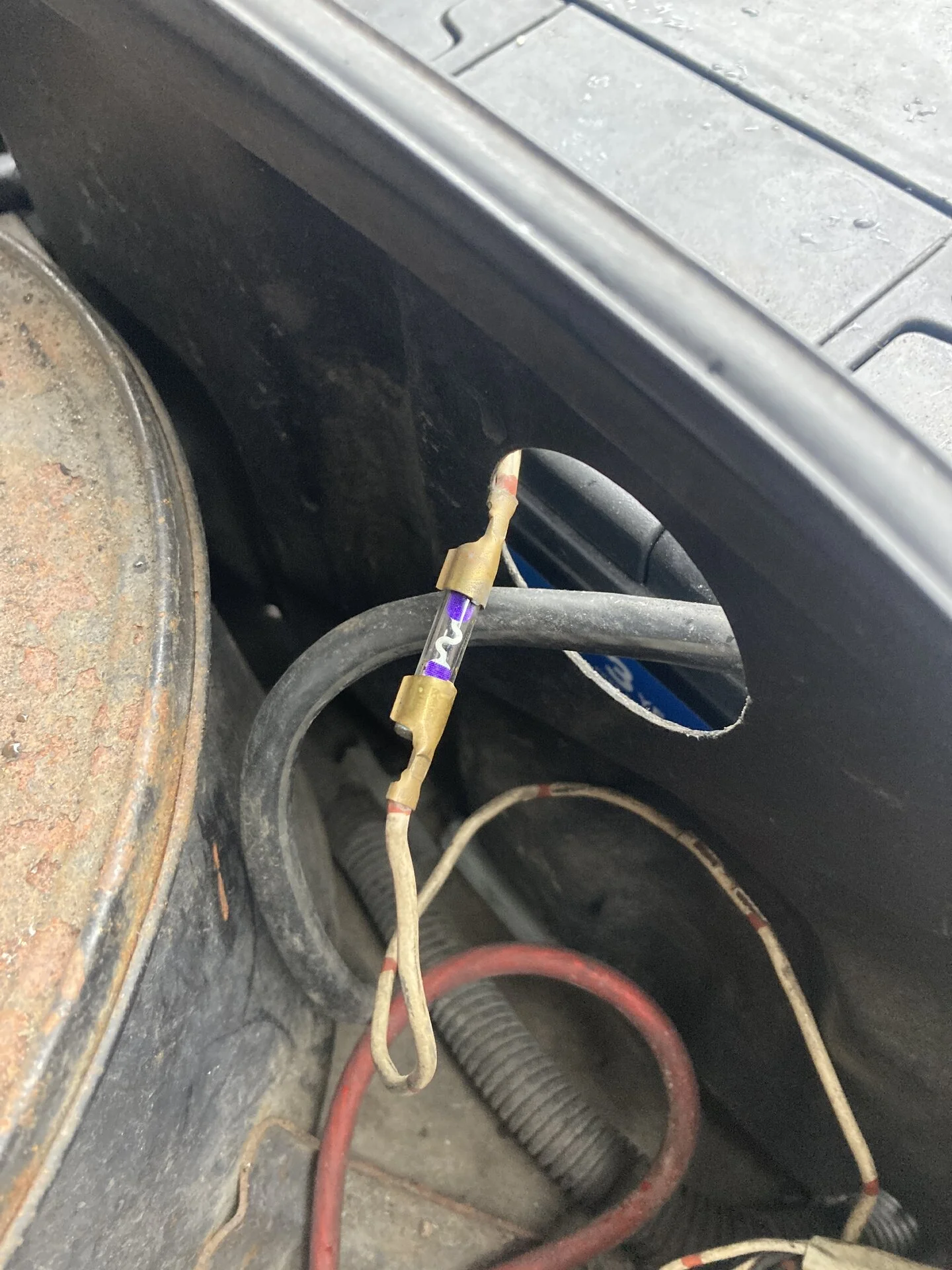

Sidenote: the top connector (mustard colored bit) of this white wire with red bands was unclipped from this little glass tube when I started poking around, what is this? The ground? The section I clipped back onto the tube was connected to the positive battery terminal with the fusible link.
Also, what in the hell is this red wire that's just sitting disconnected? Leading to the port in the back left of the engine bay. Please excuse my ignorance I am learning, but very slowly.
Looks like an old school glass fuse. And the (brass) terminals are exposed, likely to short out on something if not protected. That large red wire looks like it is extending power to the interior cabin, you should be able to follow it from where it comes in the firewall behind the glovebox. It could go anywhere. The one on my 80 goes to an ARB compressor in the cargo area and the one I put in my 200 is for rear cargo area accessories.

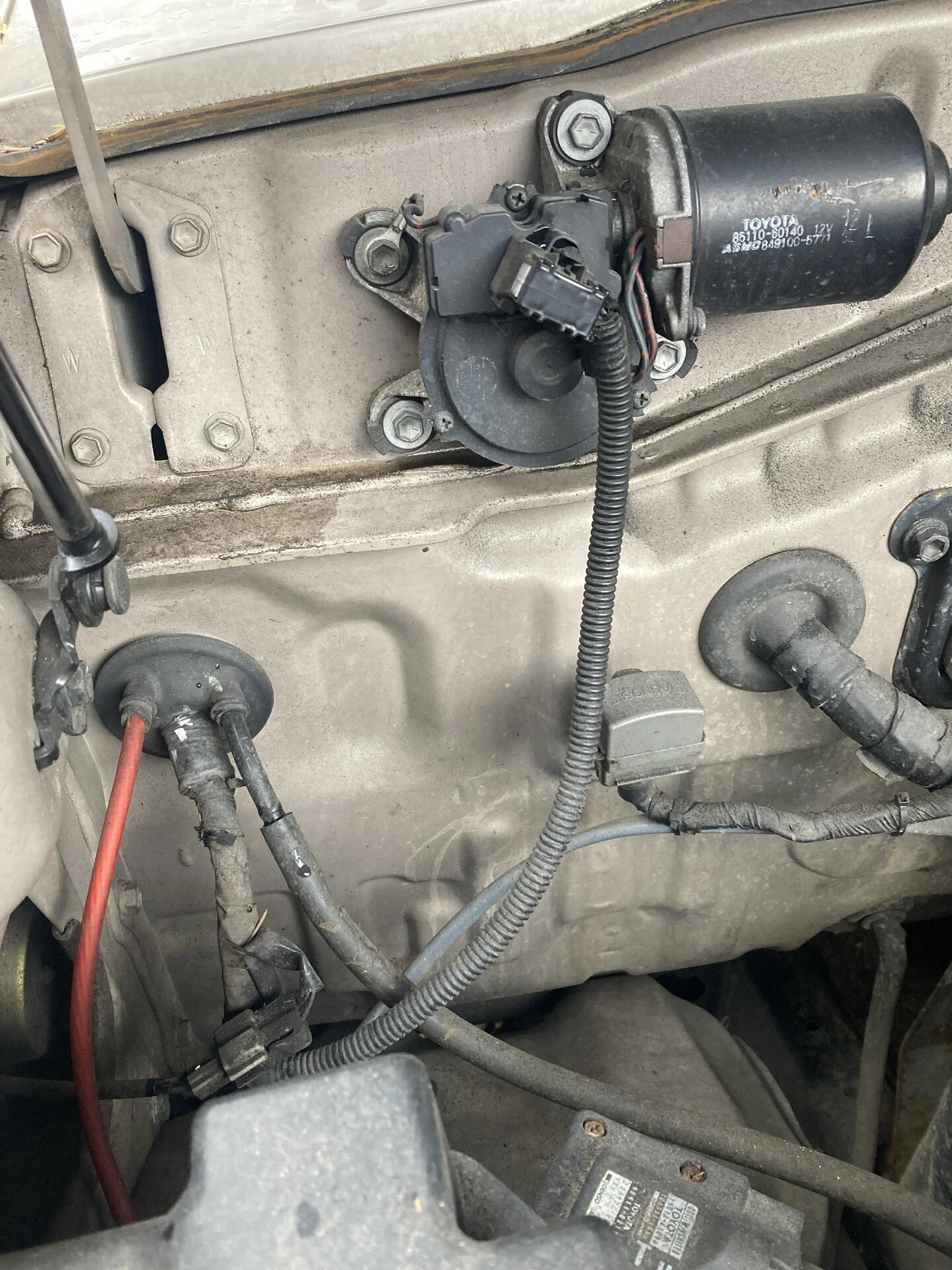

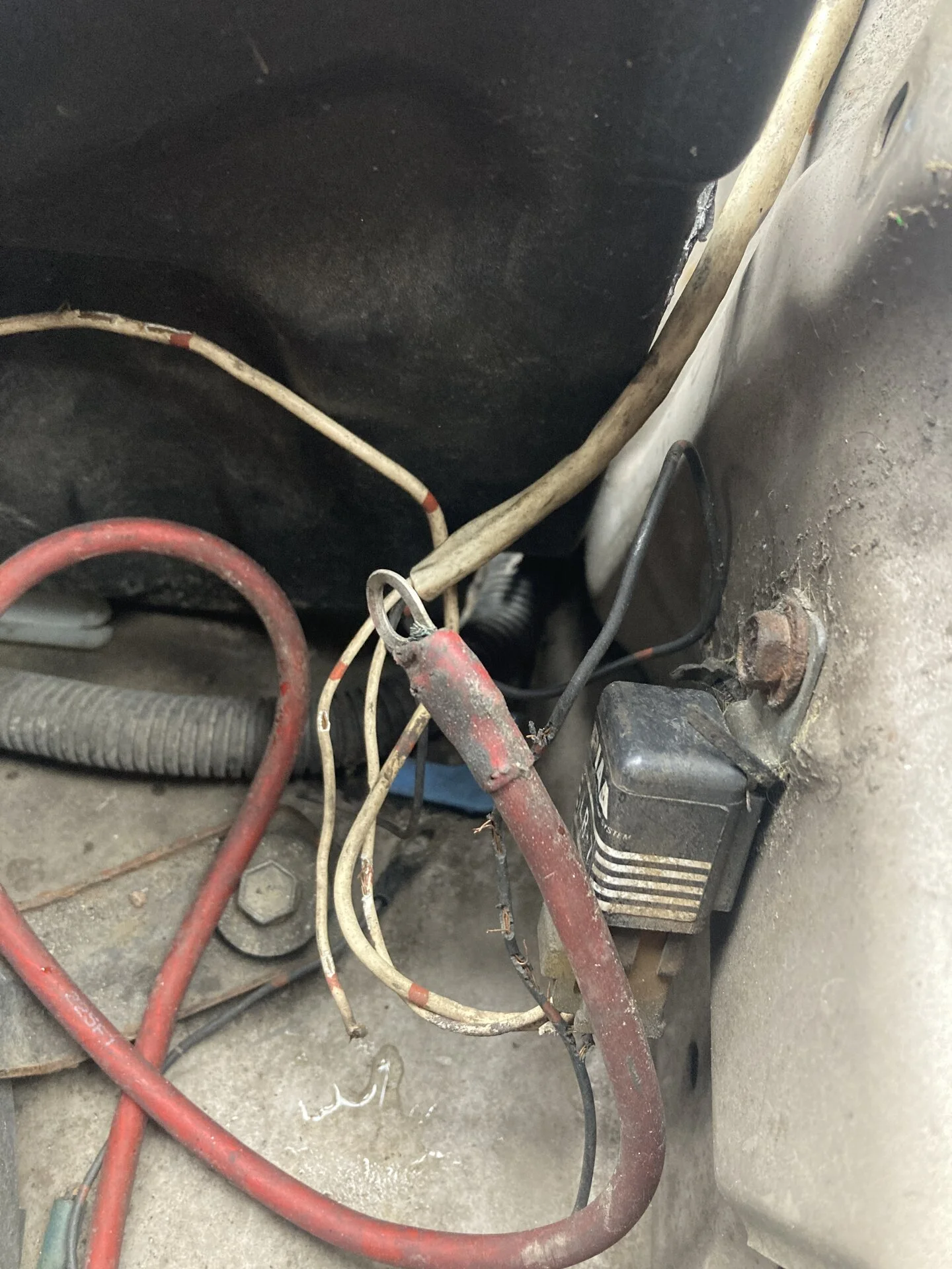

If that white wire with the red bands and the glass fuse run over to this box attached to the chassis, any idea what it is? I'd never noticed it before today, maybe it been wrapped in electricians tape before or something, but more importantly, would it relate to my charge lamp/CEL not coming up on the dash when the ignition is turned to ON?
As for the red wire, that makes tons of sense. Previous owner had it routed back there and tucked under the mats in the trunk.
That black box looks like a relay for a PIAA fog light harness.
Looks like a mouse has been chewing the sheathing of several of those wires. I'd be on the lookout for other mouse damage to wires.

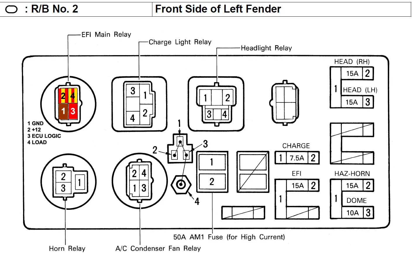

Are you seeing +12 on the screw in the relay box as stated?
Are you getting constant +12 on pin 2 of the EFI MAIN relay?
With the key ON are you getting +12 to pin 3 of the EFI MAIN relay?
Are you getting a solid ground on pin 1 of the EFI MAIN relay?

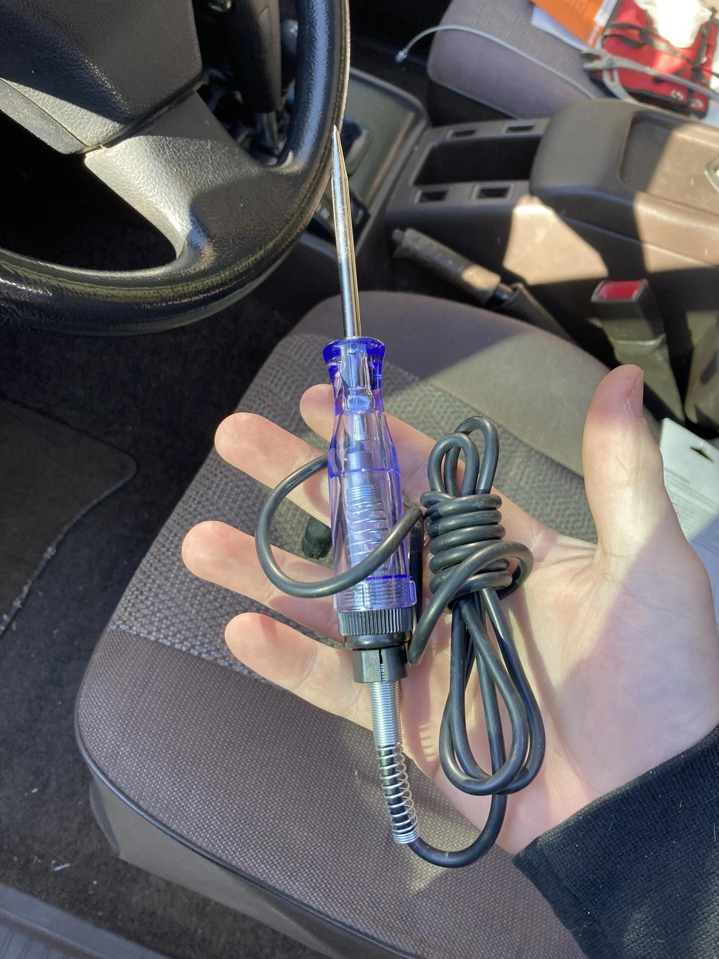

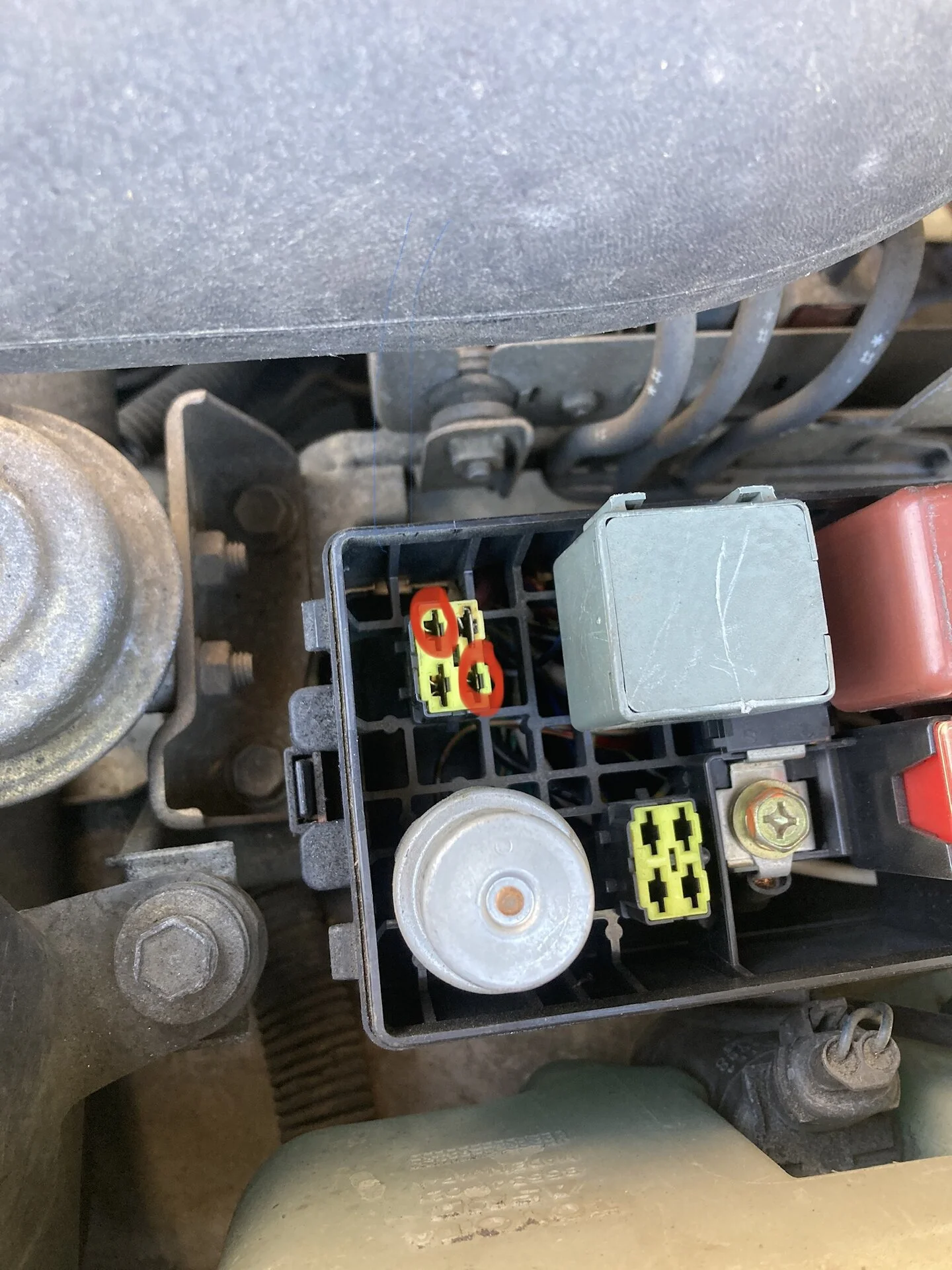

Alright, granted I'm working with a very basic voltage meter - the only one available at my nearest hardware store. ordering a one that isnt just a lightbult connected to a metal point and a ground to use later.
However:
+12 on the fusible link screw confirmed
On the EFI relay I got +12 on the two circled pins, I'm not sure which number they are or how that's ordered, but no charge on the other two and couldn't fit the ground clamp inside them
The 15A EFI fuse in the fuse box also had a charge according to my little lightbulb indicator
In the driver side knee panel, the 7.5 IGN fuse yielded nothing, but neither did any of the other fuses i tested, so I'm not sure if that's a limitation of this obviously not very well made or useful tool or something else entirely, unless somehow no power is running to the knee fuse panel. Thoughts?
The 2 circled pins are 2 and 3. 2 should be constant +12 and 3 should see +12 with the key in the ON position. Pin 1 should be ground.

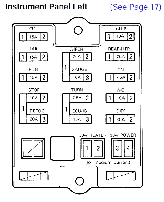

Fuse box 2 is by the driver's left knee. Since I don't know what fuses you tested and power to that fuse box comes from 2 different sources, I don't know what to tell you. You really need to be specific when doing remote diagnostics and you have to remember that I'm not looking over your shoulder.

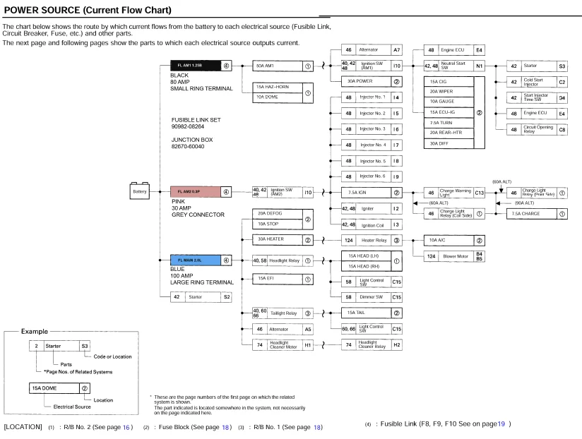

See the documents below from the 1991 Toyota EWD.

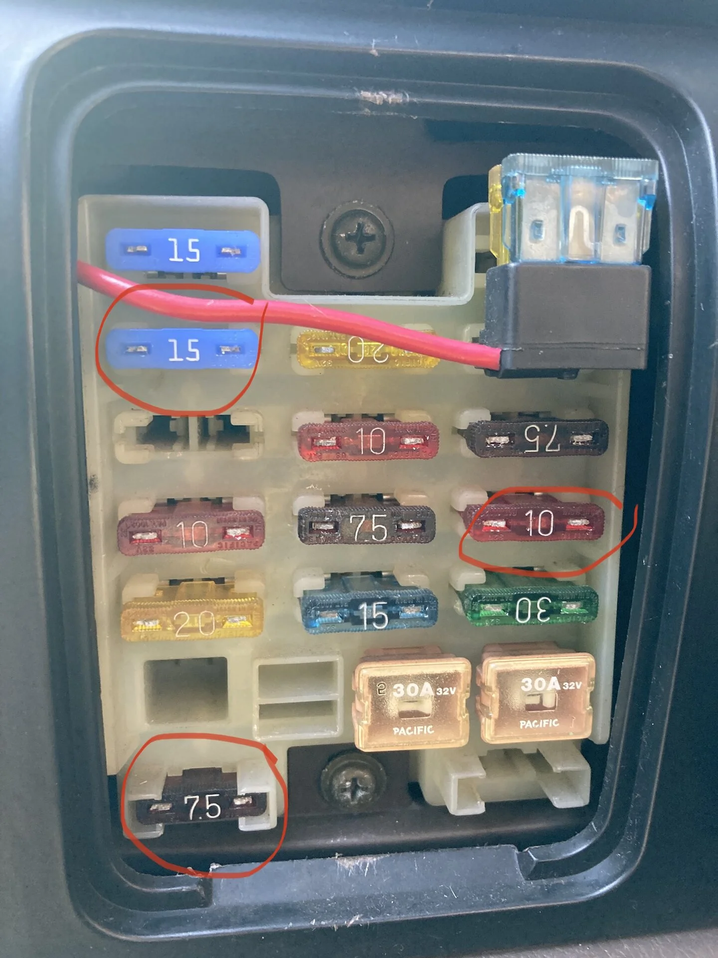

Alright, accounting for being so unspecific (apologies), I tested each fuse in fuse box 2 with the ignition set to ON. All but the fuses circles in red showed a current.
I see the 7.5 IGN fuse is the one in the top right there, which showed a current but other 7.5 in the bottom left did not and was also indent and slightly look, I may take some plier when I get home and take a look but it was the only seemingly damaged one in there.
Another reason to have the Toyota FSM and EWD.
The bottom left and right are slots for spare fuses.
There are no contacts/no fuse in the top right ECU-B slot in the USDM.
The slot to the left of the 30 AMP heater fuse is for a plastic fuse puller.
The other 2 fuses in question are TAIL and A/C. The A/C fuse won't be active until you're running either A/C or heat.
Both of those fuses are fed from fusible link MAIN along with 20 amp DEFOG and 10 amp STOP.
There's some sort of bastard fuse tap with 2 fuses (20 amp and 15 amp) in place of the 20 amp rear heater fuse. That looks like something I would remove immediately because it has the potential of overloading that circuit, as the feed wire was gauged for max of 20 amps, not 35.
Looks like a power wire for a stereo amplifier...

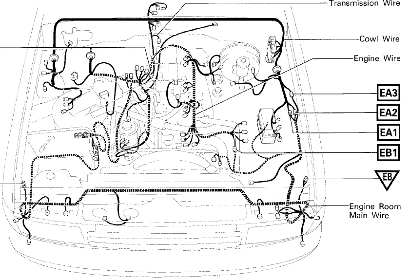

There is a connector under the hood EB1 which all +12 to/from the EFI relay runs through. It is located slightly forward and inboard of the 3 emissions VSVs. Be certain that this is in good shape. It has 3 wires: red/yellow stripe; yellow/red stripe; solid red. See the diagrams below.
