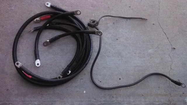

The battery cables were pretty ragged when I first got the truck. Tried to get some OEM from CDan but he informed me they were NLA. Held off on buying custom ones because of price but finally decided to bite the bullet and called Urban Land Cruisers to put in an order for their cables. AWESOME. Extremely beefy and well-built. Install was ok, but the cables were super stiff. It helped a little to warm them up to room temperature first. As it turned out, I didn't even have a ground cable going from starter to frame any longer!
Along with installing the batt cables, I spent time stripping all of the crusty electrical tape off of the random wire harness ends/connections and re-wrapped everything with fresh electrical plastic tubing and tape (including battery cables).
This pic doesn't do the cables justice. Had only wrapped a couple at this point.

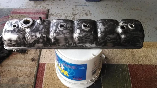

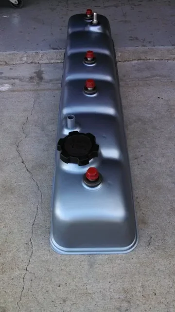

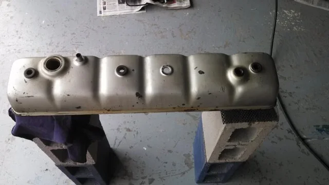

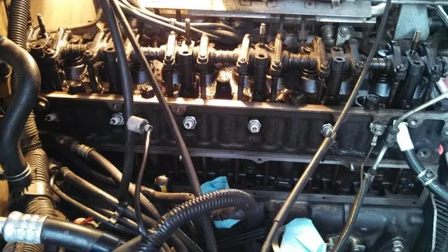

Removal of the cover gave me some trouble. Kept wanting to hang up at the very back on the rocker assembly bolt. Was difficult to maneuver up and over. The PCV valve was so caked with crap on the inside that it was all I could do just to blow a tiny bit of air through. It also took for freakin ever to yank that little donkey from the cover. I wasn't about to let a $4 part defeat me though. :hillbilly:
Finally got it off. Wasn't in too bad of shape, but was a little beat up.
LOTS of wire wheel action.
End result. Took a full day between everything else to apply a bazillion coats of primer and high heat engine paint. New PCV valve, new oil-fill cap and all new grommets. The red valve cover nuts are supposed to be good for about 3HP. :p WOOT!!

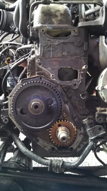

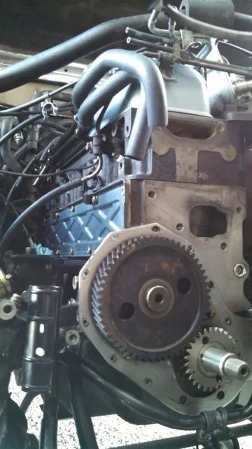

Tear down continues.

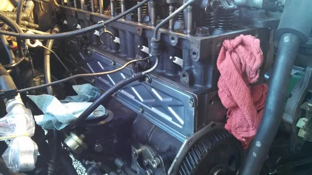

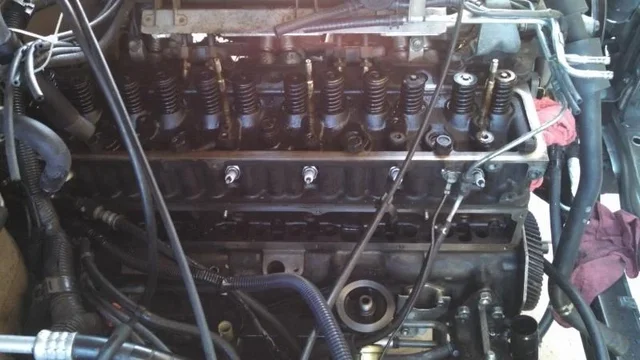

Getting the pushrod cover off was a real treat. I don't know how some of you guys manage to get that gasket replaced without removing almost everything on that side of the engine bay first. What a drag that was. Cleaning the old cork gasket off was even more fun. Again, green Scotch Brite pads are my new best friend. And a painter's razor blade scraper...
Spent a lot of time with kerosene-soaked rags cleaning EVERYTHING. I think it turned out ok.
This is as far as I went in tear down mode. I didn't want to pass the point of no return.... although I'm often (usually) tempted to. :grinpimp:

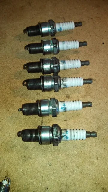

Old plugs didn't look too bad, actually.
Jason

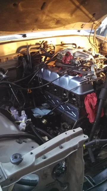

Got the front end tidied up.
Before:
After:
Got the pushrod cover cleaned/prepped/painted and gasket on. I used some Permatex high-tack (super sticky purple crap that's really hard to get out of your new coat once it dries) sealant to fix the cork gasket to the cover prior to install. I let it dry for a couple of hours and then it was pretty easy to get the cover back on (relatively). I found that the easiest way to get at the far back bolts was to use a little 1/4" thumb/wheel ratchet. Torqued them from the inside out to the edges (lightly). Seems good to go!

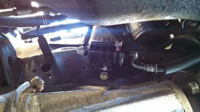

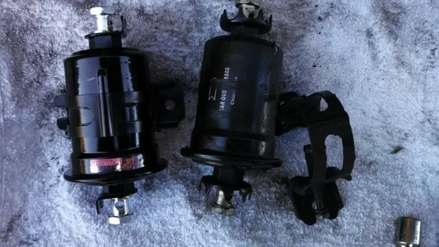

Decided at last minute to do the fuel filter. Not too bad a job when all the junk is removed & you can hit it from above. Hardest part was getting the banjo bolts loose - you can't put too much torque on them because you risk tearing the fuel line. A little soak with PB for a few minutes & all was good.
Old filter was Chinese. Who knows how long it was in there.
Ahh, OEM goodness!
Jason

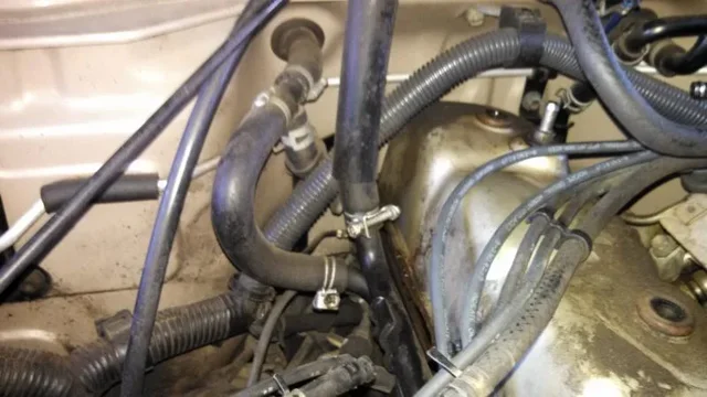

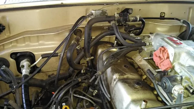

So now that all the cleaning of parts is out of the way, it's on to replacing hoses and vacuum lines. Bought every single hose that I could think of. Even screwed up and bought some twice. :doh: Ordered lots of the bulk vacuum line, too. Replaced one at a time

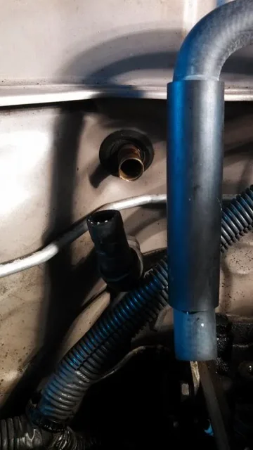

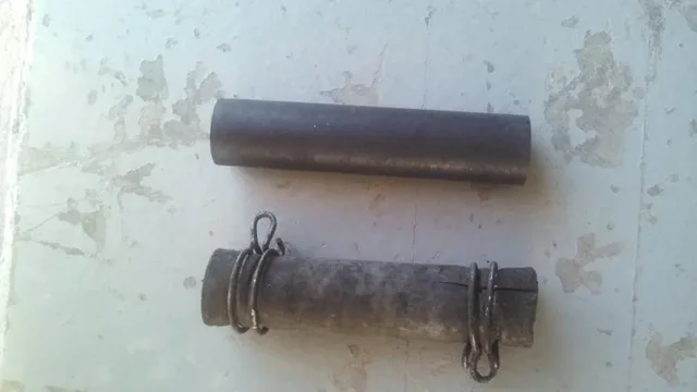

Ran into this little situation when I was replacing the heater hoses up against the firewall. Not sure how long the pipe was like that. Amazingly, I was still getting heat front and back.

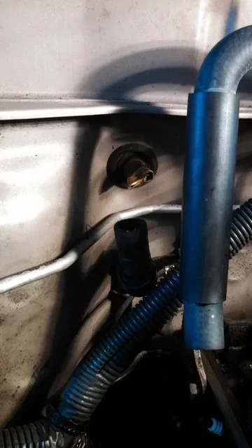

Fixed it up the best I could. Hose went on fine.
Ahh, it's the little things that are going to help me sleep better. :p

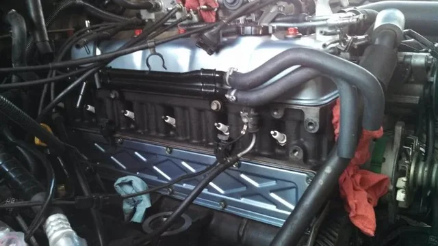

Button-up mode commencing!

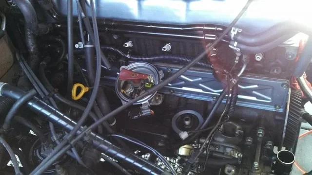

After I got the rocker arm assembly back on, I tackled the valve cover. Used the hi-tack sealant to glue the gasket on and then smeared just the smallest bead of Permatex #2 along the edge. Let it dry for a bit and then wrestled it over the rocker arm/valve 'bolt' at the back. Was tough to get positioned without knocking the gasket out of its groove. Finally got it!

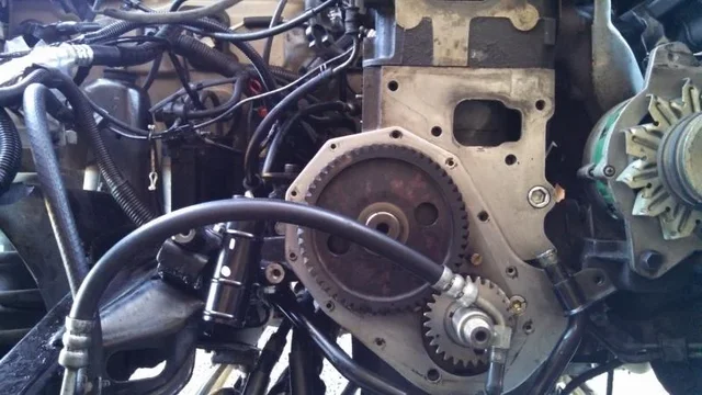

Called Beno to order this coolant line/hose assembly. Took a few days to get in from Japan (I think). Apparently, you can't buy just the hoses, have to get the whole thing. Be prepared, Mr. Toyota will require a left nut for this unit... which was okay with me as I wasn't using mine anyway (see comment at top).
Frontal view of the nut-robber hose assembly. I guess the pipes are brazed, which is one reason it costs so much.
Dizzy back on. Went on pretty easily.
Jason
