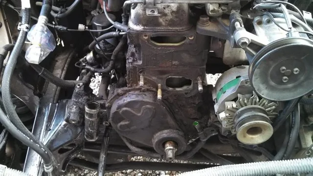

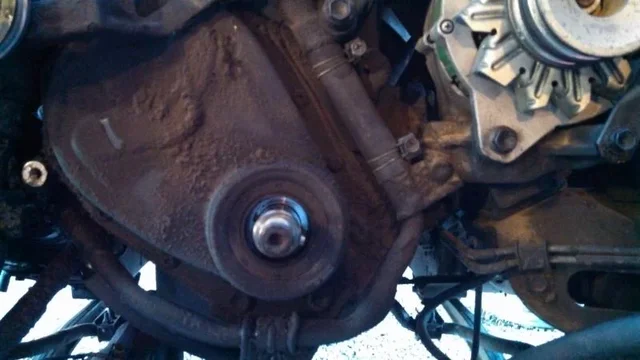

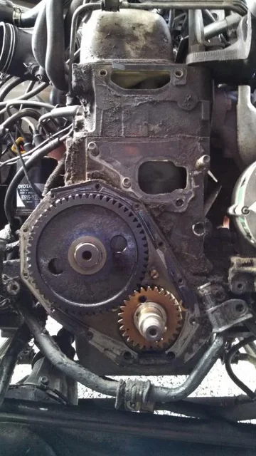

I was a little concerned with the removal of the crank pulley nut. I've read all the threads and decided to give the bump start method a shot. My battery is pretty old and weak so I wasn't too confident that it would work. Disconnected the dizzy wire and strapped my shiny new 3/4" breaker bar/socket to the frame. Hopped in and turned the key and got...nothing. It sounded just like the starter does when she's about to crank over. I was expecting some clang bang and scary ruckus but only got a whrrrrr. When I got out and checked the nut, it litterally fell off in my hand. Yay. It was as if it wasn't on tight enough. Anyway, that was a huge psychological hurdle for me that turned out to be a non-issue, so hell yeah to that.
The timing cover came off with ease. The bolts were all barely just finger tight. :eek: The hard part was getting the oil seal out. Using a seal puller, I pried on that puppy with a lot of force and it wouldn't budge. Finally put the timing cover in the oven and turned it on to 250 degrees & let it 'bake' for 10 minutes. The old seal literally fell right out at that point. Took a long ass time to get the old gasket off of the cover. The old cork was fused pretty good.

Oil seal doesn't appear to be leaking but felt good to change it out anyway.

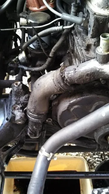

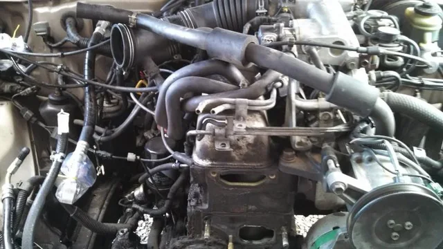

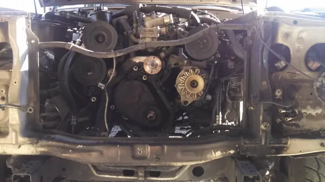

Can't imagine getting this hose off without first taking off a/c compressor and pulleys/tensioners. NOT easy to get to. This looked like it was about ready to blow.
Was careful to document everything with pictures to make sure I could put it all back together.

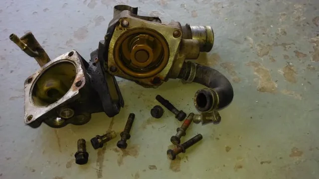

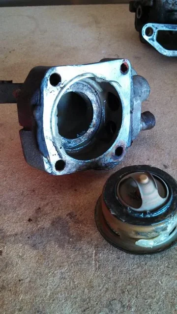

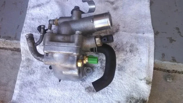

Thermostat housing was NAST. I'm not even sure what the snot-looking stuff is. Could my coolant have gelled??
Got the dremel out and polished off some of the scale. Replaced the gaskets and thermostat. Swapped out the hose and clamps. Buttoned it back up with some nice new bolts. Even replaced the water temp sensor and senders.
Have you taken the valve cover off? Kinda curious if you have coolant milkshake under your valve cover after looking at the gel on your thermostat.
Yep, cover came off. Nothing that resembled the dreaded milkshake. Just a lot of baked-on carbon deposit over everything. The rocker arm assembly was caked in black tar. Coolant also looked pretty good. PO had been using green and when I drained the system most of what came out was bright and clear.

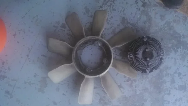

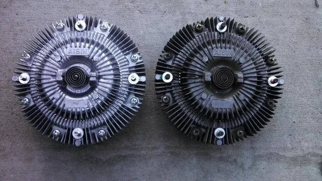

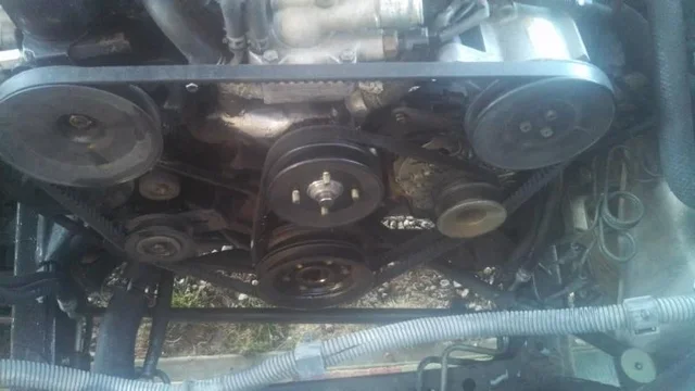

Next up was the fan & clutch assembly. The old fan clutch wasn't quite dead yet, I could still spin the shaft...but it was rough. It definitely had seen better days. I also noticed that over the past few weeks I hadn't been hearing the 'roar' on start up. Time to go!
Dirty fan and old clutch.

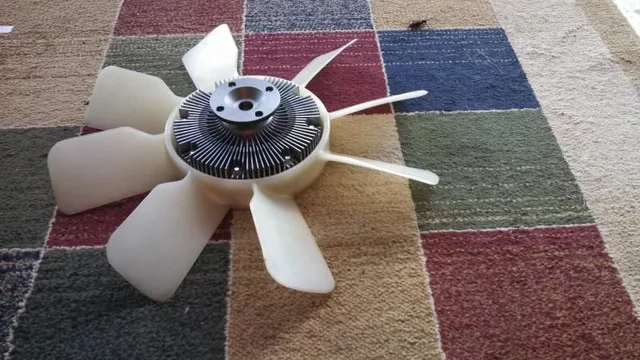

Nice new aqua hub! Purdy. :D
Mounted up and ready to go. Took a lot of elbow grease and Simple Green to get those fan blades clean. I guess 21 years will do that.
Jason

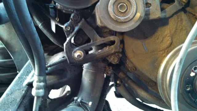

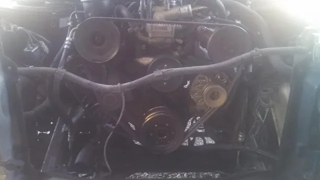

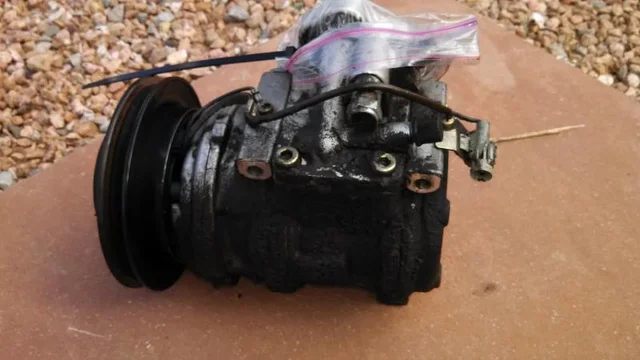

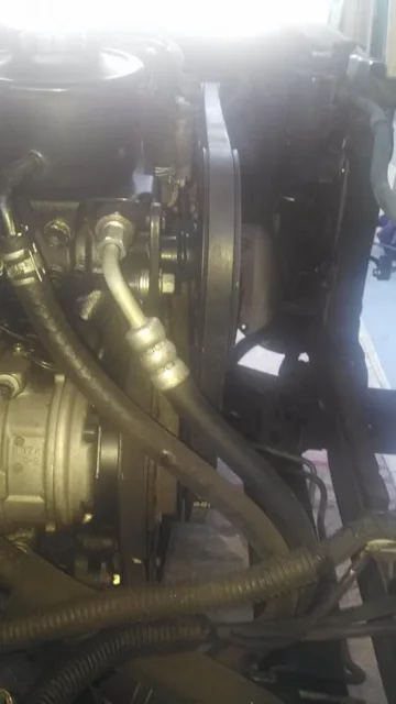

Yanked the PS pump and A/C compressor. The compressor was pretty gunked up. Whatever leak I was having nailed everything pretty good. Wasn't sure how to go about cleaning the compressor so I ended up just wiping it down with a little kerosene. I was careful about all the 'ports' but hope I didn't damage anything.
Can't see in the pic, but the belt chewed into the PS hose at one point, leaving a pretty nasty gouge. I didn't order any steering 'refresh' parts this go-round but have made a mental note.

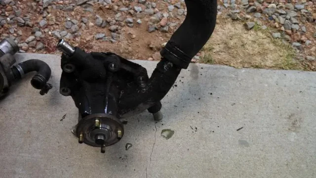

Old water pump. Adios!

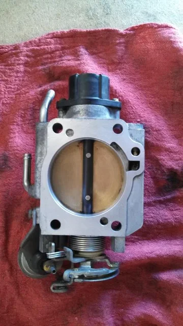

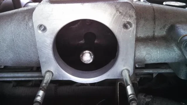

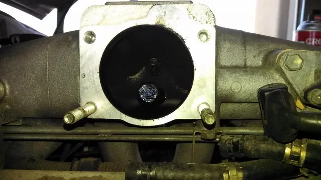

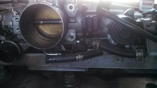

Time to turn my attention to the throttle body. Doesn't look too bad from this side, a little gummy.

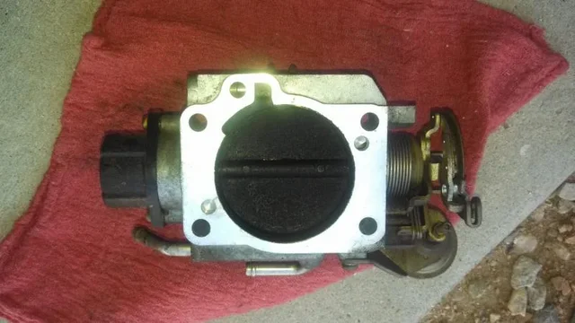

Other side was nice and grimy.
Cleaned everything up the best I could with some throttle body cleaner and a toothbrush. Took some time. Oh, and green Scotch brite pads are my new best friend!
Replaced all the hoses that run underneath the intake and the hose on the back side of the intake. Looked to be part of the PCV valve/hose assembly?? Blew some compressed air down the pipe and got a LOT of oily crud. Must have been pretty choked. Already had a couple of new t-body gaskets on hand (one for a spare). NLA from Toyota, so I went with Fel-Pro. Also learning through this that silicone really helps with getting the old hoses off. Just a quick spray and let it sit for a few seconds and they slip right off.

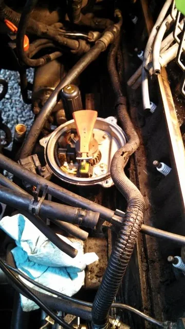

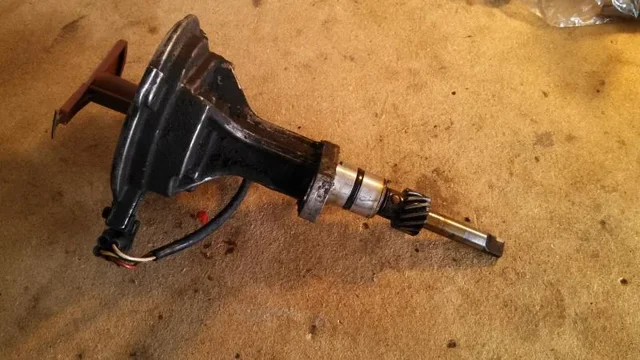

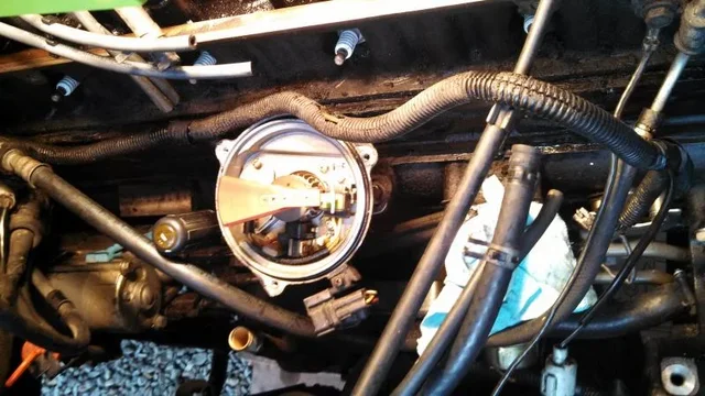

In the middle of all this I decided to switch gears and tackle the distributor. Wasn't expecting this to be as much of a PITA as it was! Had to come at it from underneath with a wooden dowel and hammer and tap it up and out. Tried to mark the orientation as best I could.
This is also when I started to think about the pushrod cover gasket. I didn't figure that in to my first version of this little project. Out comes the speed dial! Also ordered a distributor o-ring since I forgot to pick one up.
Pretty filthy here....as everything else.
Didn't get a picture, but I cleaned the dizzy up pretty good. Had a new cap (with 'packing' o-ring), rotor, plugs and wires all ready to go.
Jason

Hi Jason, great job on the refresh. I've been doing the same thing, but have stretched it out over a few months. My :princess: isn't as allowing as your :princess: when it comes to husband/daddy duty.
Anyway, I saw where you said that your PS hose was damaged by a belt. I would encourage you to replace the high and low pressure lines NOW. The way that they have to wrap over the front frame cross-member and under the radiator, make them impossible to get out unless you remove the radiator. As many before me have had to do, I removed the radiator to get to my PS hoses that were leaking. It is a PITA, so do it while you've got it out if you can.
Good luck!!
