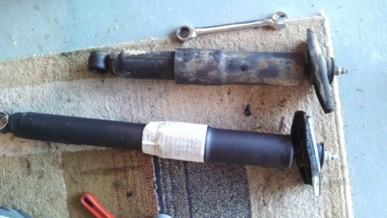

Removing the top mounting plates of the rear shocks was time consuming. Not a lot of room to get your hands/tools up there. The lower mounting bolts came off pretty easily even though they had some pretty serious carnage/rash on them from 20+ years of kicked up rocks/debris. The top shock bolt (to disassemble the shock from the mounting plate) was tough to get off. Hard to get good leverage on it if you're trying to hold onto the shock body with your other hand to prevent it from spinning. Gave me a good excuse to get out Grandpa's old 14" pipe wrench!
Old shocks were DEAD. Cleaned up the plate and installed new OEM shock with new cushions.
