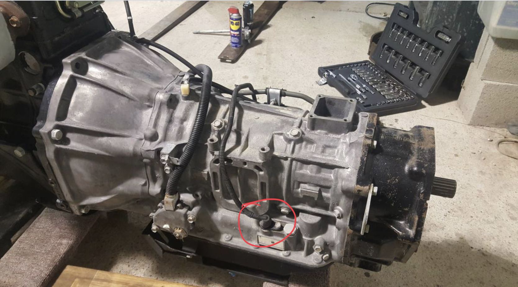

Anyhow was looking under the vehicle and saw this sensor not hooked up on the driver side trans... best I could come up with is for the cruise control. Thanks 🤙🏾
I’m not 100% sure what it is but when my Wholesale Automatics tranny went in the new tranny didnt have the harness on it. My cruise control stopped working long ago but since I dont use it much I dont worry.
