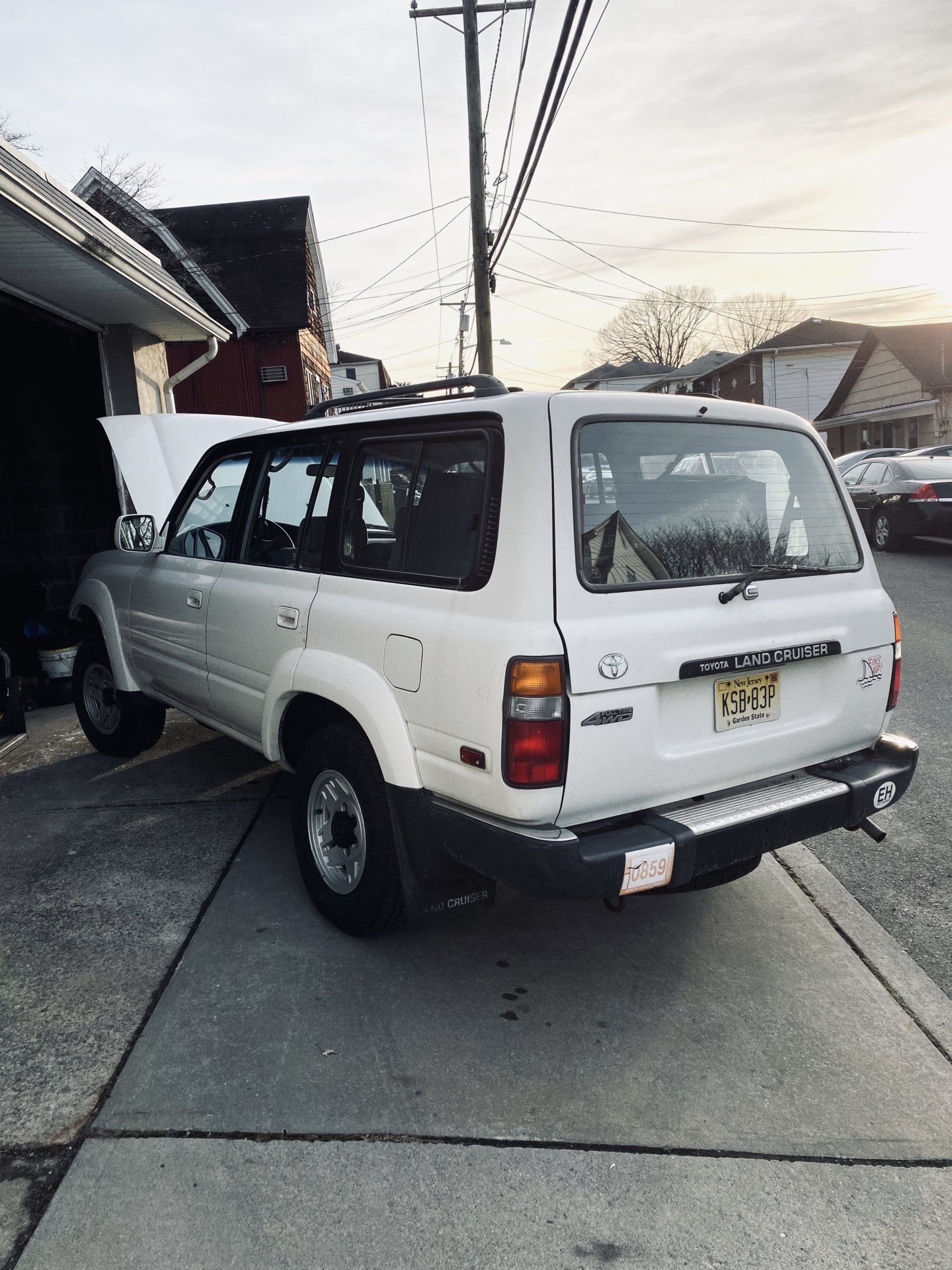

Got around to doing the oil change on it finally today, after 3-4 years of sitting it was definitely due. Coolant is next, stuff looks nasty and the heat doesn't work very well, so I'm going to try a flush, hopefully that can save it. I have a new set of hoses, thermostat and water pump on the way.

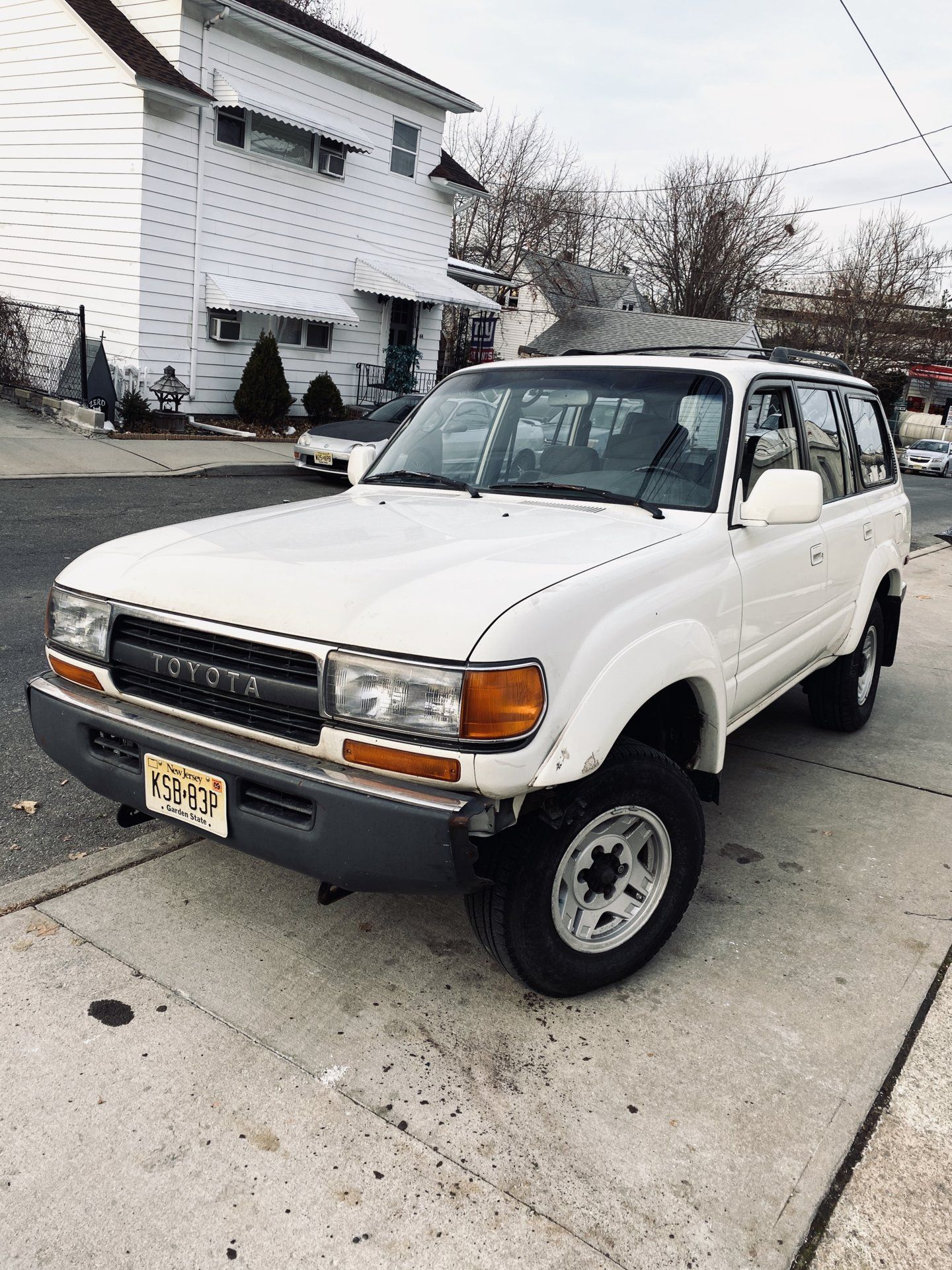

Also took off the damage multiplier, awful running boards, and not-so-in-fashion-anymore tail light guards off, looks much better now! Ignore the broken bumper extension haha, previous owner woes, eventually an ARB bumper will take its place.
Also wanted to note! My hot no start/no check engine light issue ended up being a faulty EFI relay! Hope that can help someone else in need, I'll be keeping a spare EFI relay and fusible links on hand just in case from now on.
