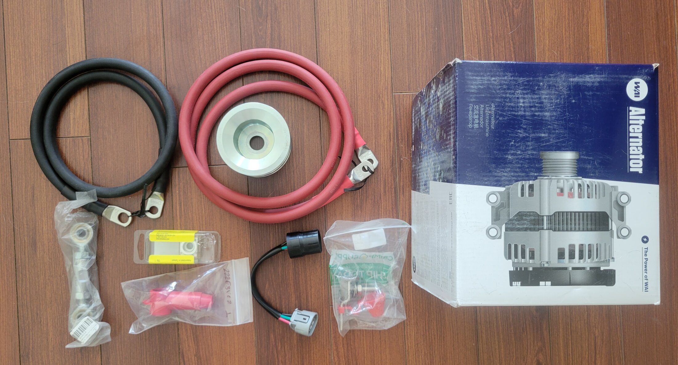

как вы установили кронштейн?
жесткая металлическая пластина вместо кронштейна (натяжителя) генератора и ролик натяжения ремня убран, завтра сделаю фото

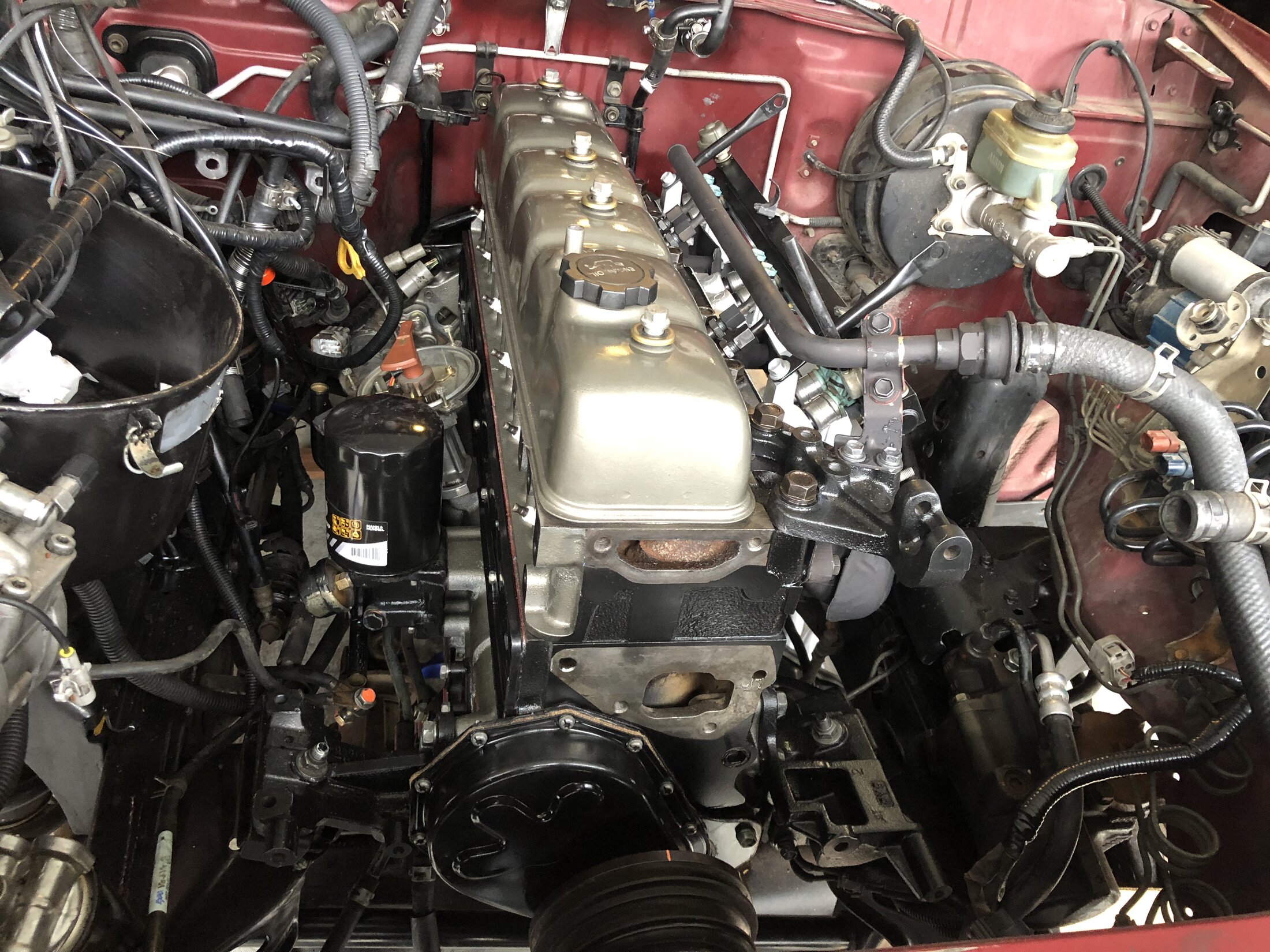

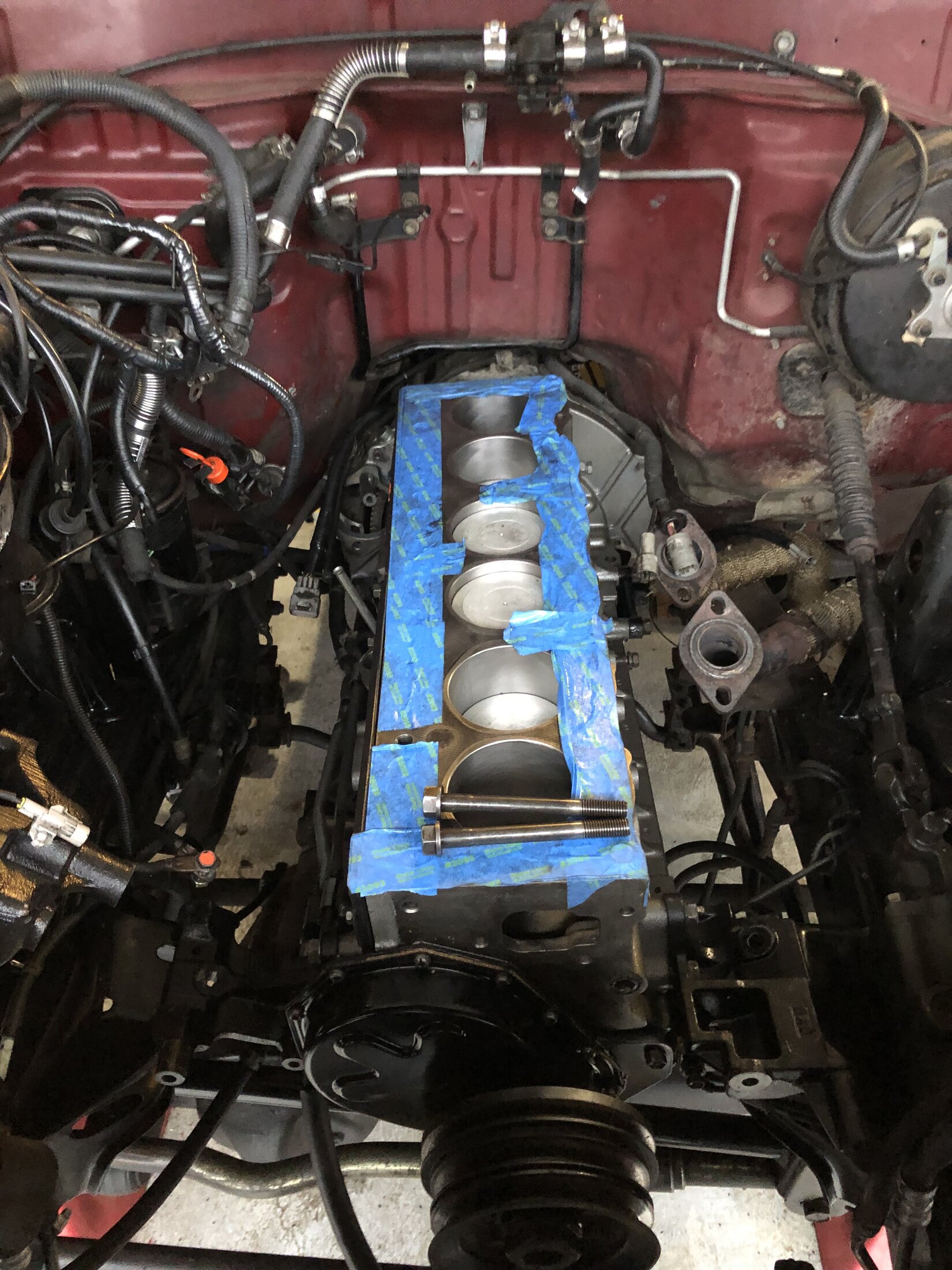

Getting closer!

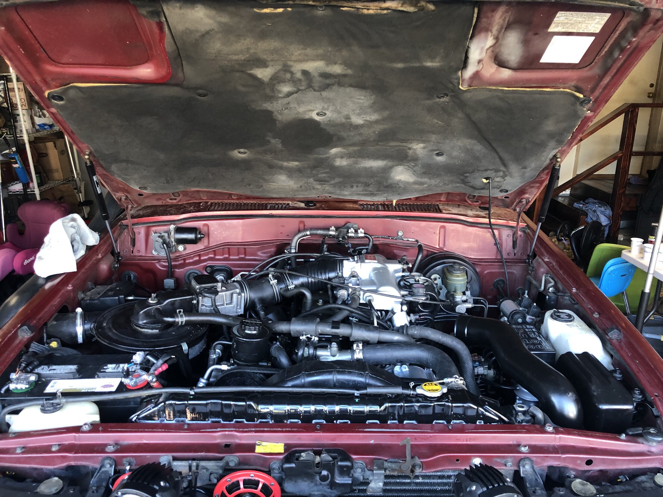

Okay she fired up!! Having issues with the oil pressure spiking, installed new sensor, and replaced some cracked wiring. Still happens. I ordered a set of AutoMeter gauges coolant/oil pressure/trans temp. I’m super pump to almost have the LC back on the road.
Next is split the TC and reseal, new brake lines, rebuild front axle, and body bushings.
