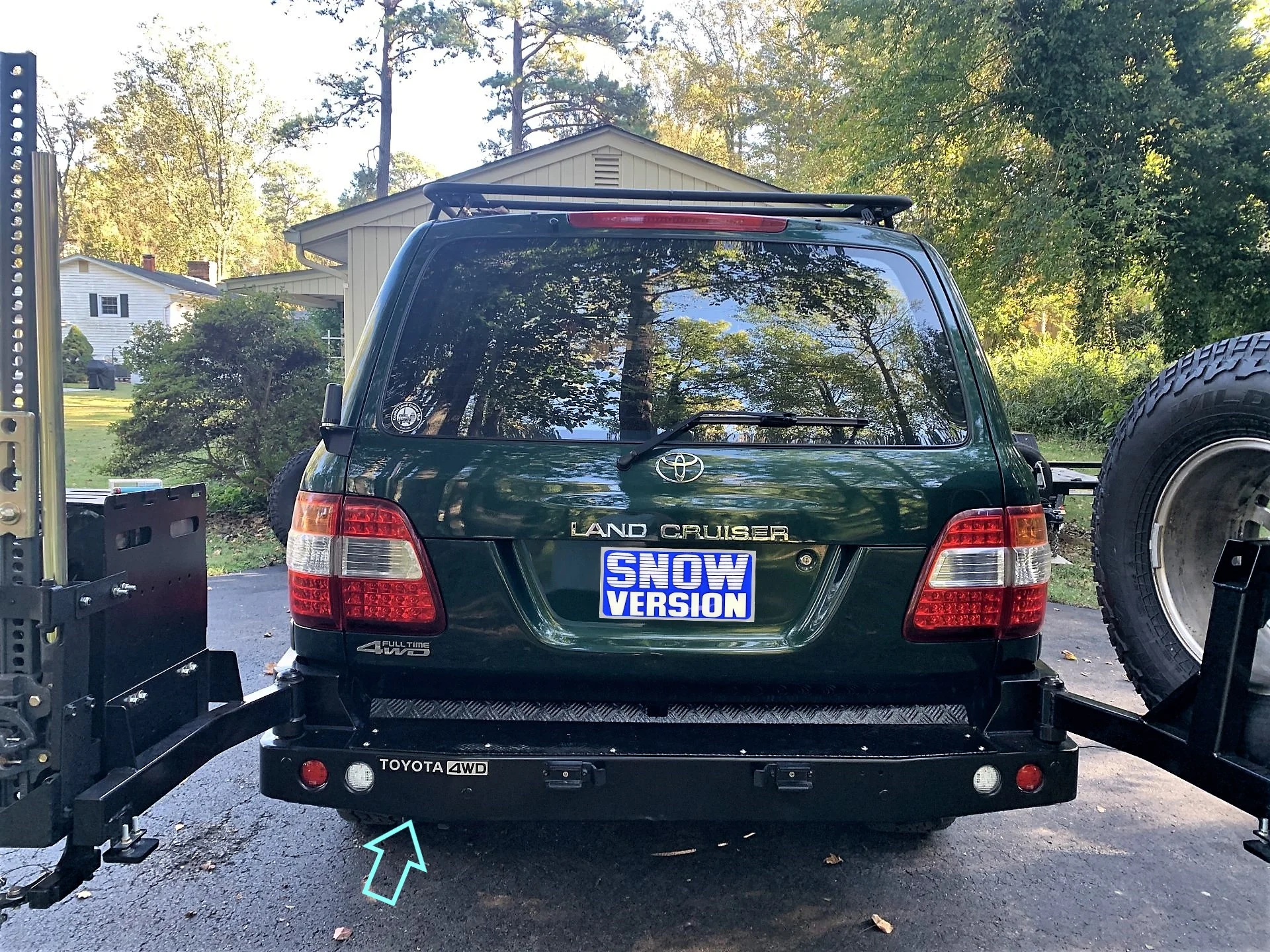

this is a 100 series , but you get the general idea if you look closely at the LH lower corner area ...

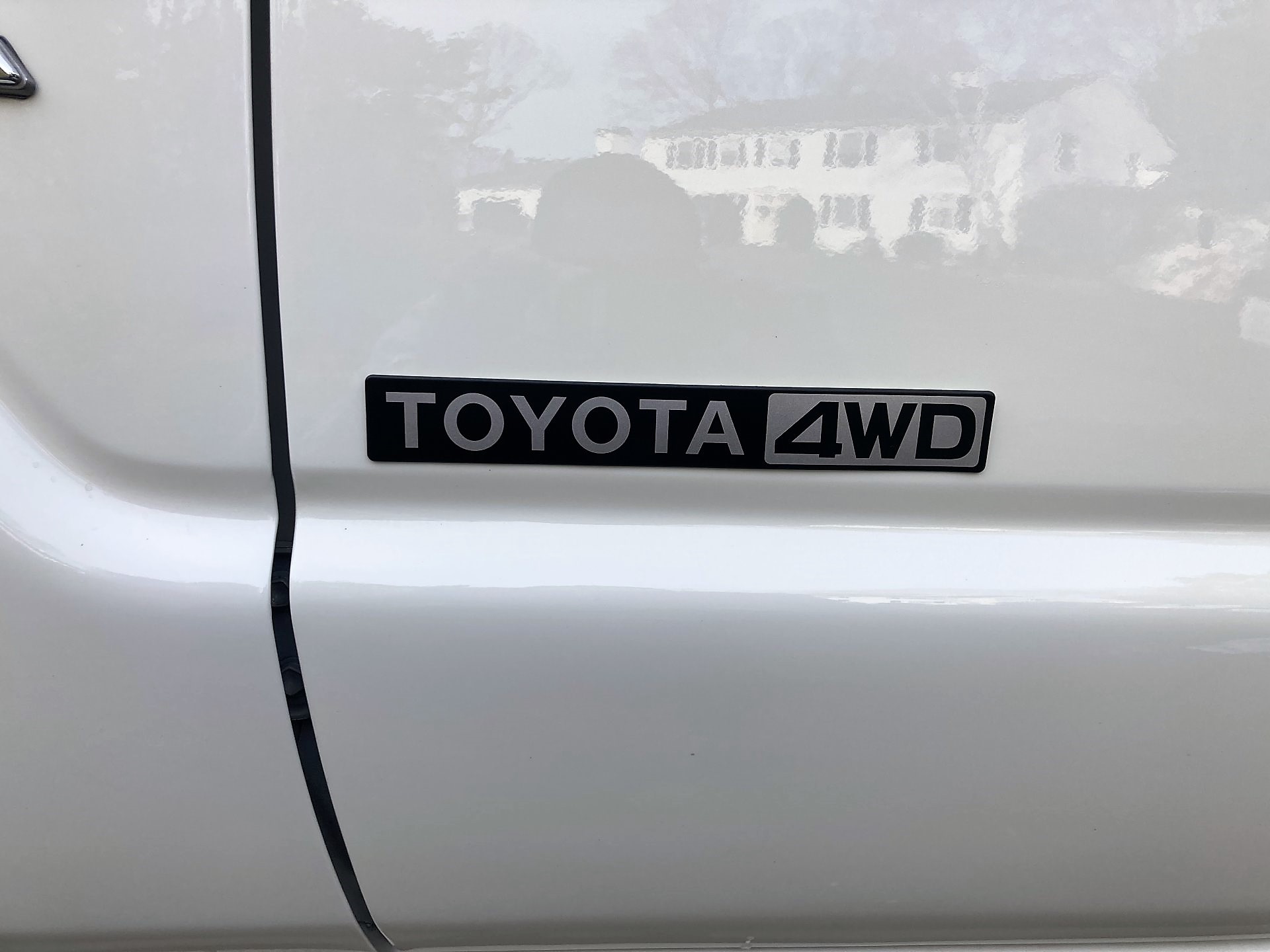

does any 3FE owner operators have ANY input or feedback on our to be Valve Cover offical Badge DECAL that TOYOTA forgot to adorn with for some un-known reason long ago ?
what about 3F-E ?
ok
so i do have a rather different 2nd idea ?
it would be MORE costly , but is in LOCK STEP fit form function 100 % period correct in every way too
- we all LOOSE the generic EFI badge in the top of the intake
- i have the rough info on making this same in kind
3FE
what say the entire global 3FE folks ?
thanks Matt

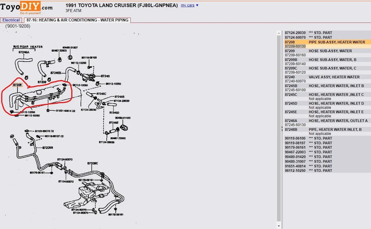

i was hoping that someone familiar with the Double 3FE Heater Pipes on a FJ80 Passenger side Part # 87209-60130 that is DISC. / NLA ....
could explain to me a bit of the TECH. , including if they are prone to corrosion from the inside out ?
- i purchased a 10 pack of these for the FJ6
2 3FE , and 1 is slated for Laboratory study , if need be
- is this a FJ80
3FE needed part or ?

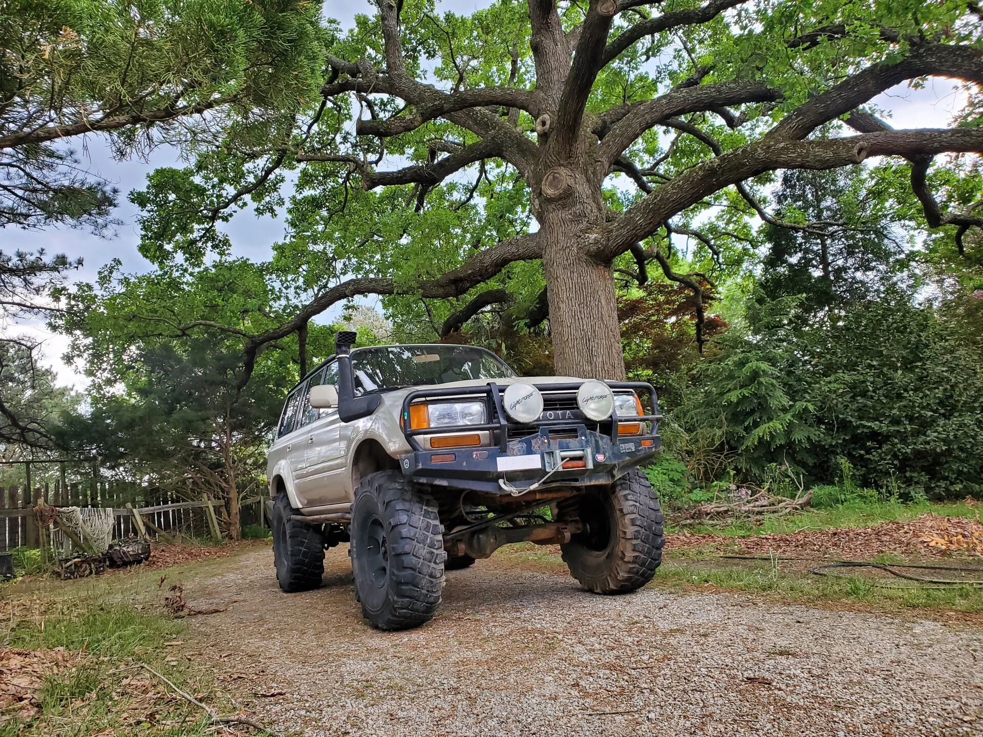

So the date is set to try and get my 2fe in my 80 which is on the other side of the country from me. April 15th in Fuquay Varina NC.
I had thought a friend had pulled my 3fe last september but found out yesterday it hasn't been touched. So i'll be pulling the 3fe, swapping all needed parts to the 2fe, installing along with a body lift and then get he stand alone ecu to run.
Then later in the year when I get it back to me in WA i'll be doing the turbo install.
My truck looking sad how it sits currently.

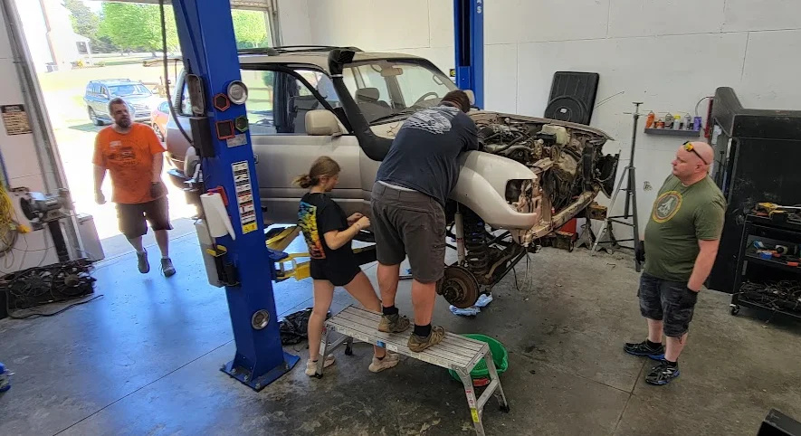

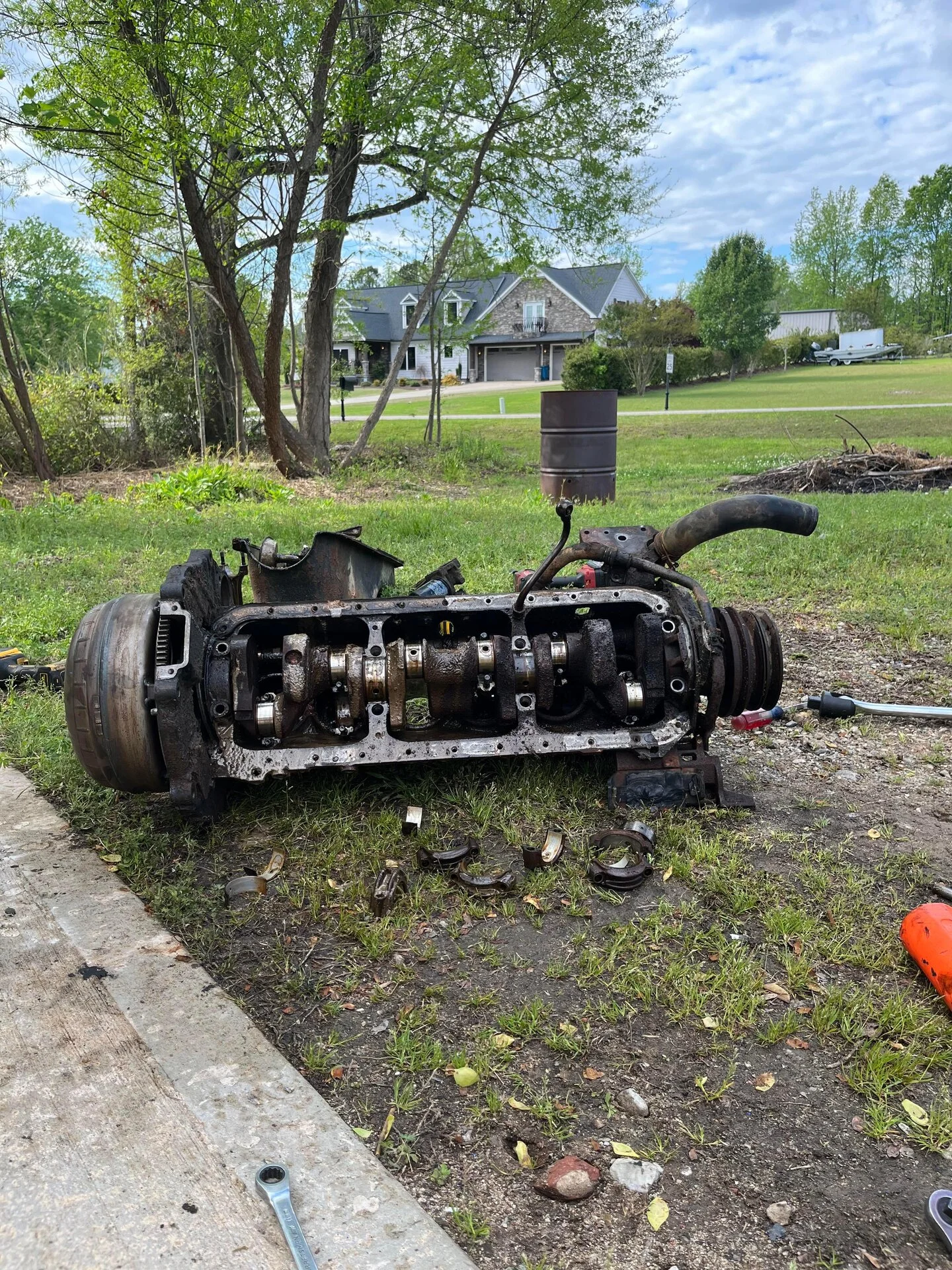

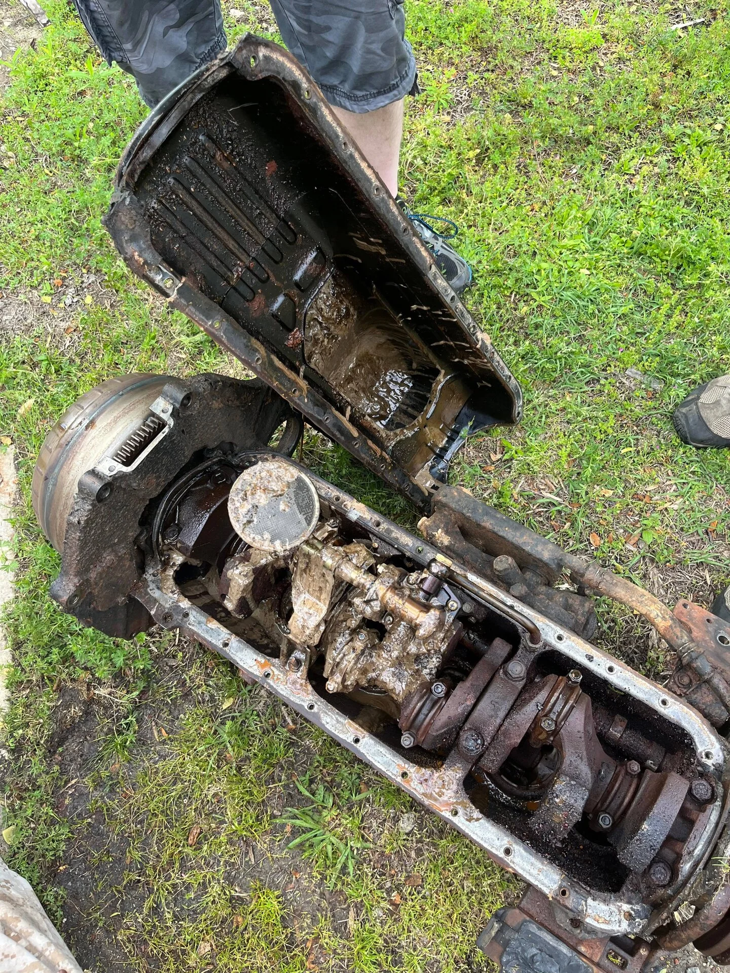

Well this didn't go as planned. The guy I sold my 80 to and then bought it back from had screwed it up something bad and it seemed tried to start and fix it. Found tons of missing and snapped bolts while I was pulling it apart. Could not spin the motor so to get to the Tq converter bolts so pulled the whole driveline. Took the engine down to the bare minimum but the bottom end was so gunkedup with rust and other crap that the only way I was going to get the converter/flexplate/engine to auto trans adapter off to put the 2fe in was to plasma cut the very rear of the block off. At this point I was pissed, I was running way behind and didn't see me finishing up the swap anytime soon. I decided all the effort to get this "easy" swap finished was not worth the final outcome and i'd be right at the total amount of effort just to LS/LT swap it at this point.
I gave the 2fe and turbo kit to a friend who is going to use the 2fe to bring his 40 back to life and if the turbo kit doesn't fit right in the 40 body then that will be up for grabs at some point. Fits any 3fe/2fe motor.
Busted ass 3fe
received_918535259378930-jpeg.3299590

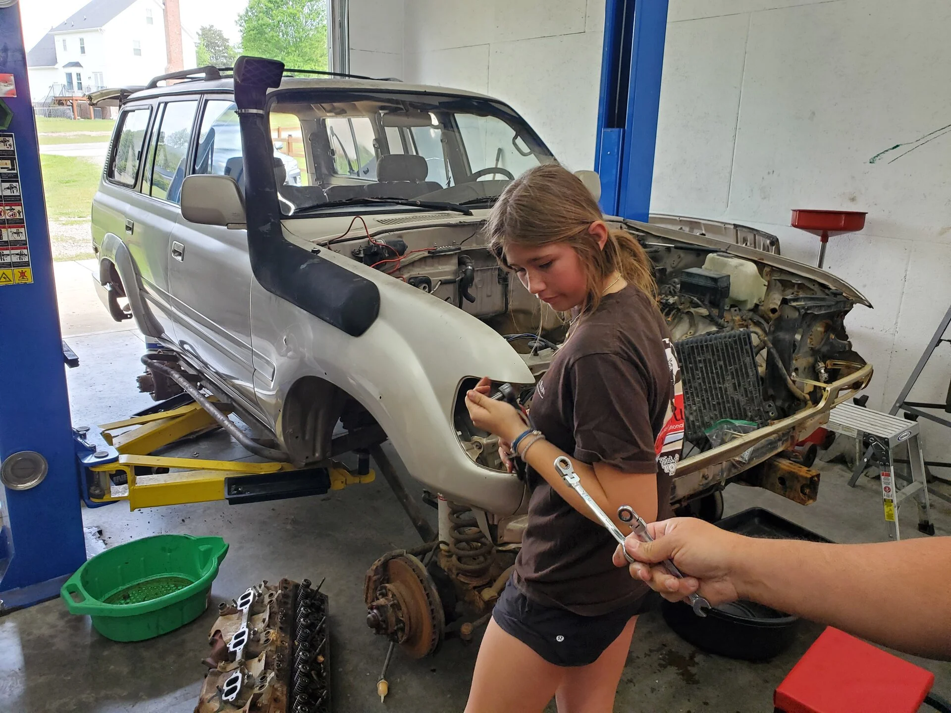

My Niece learning the ropes
20230416_115528-jpg.3300530
Engine coming out
received_1261909834719940-jpeg.3299584
received_1233879090571980-jpeg.3299589
20230416_144653-jpg.3300525

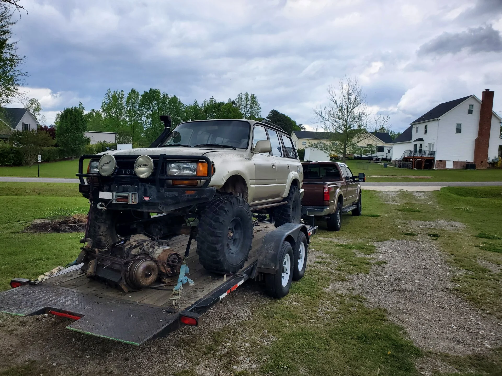

Couple more photos
As it sits waiting to be towed over to the PNW for me to start the LT swap.
20230416_160411-jpg.3300527

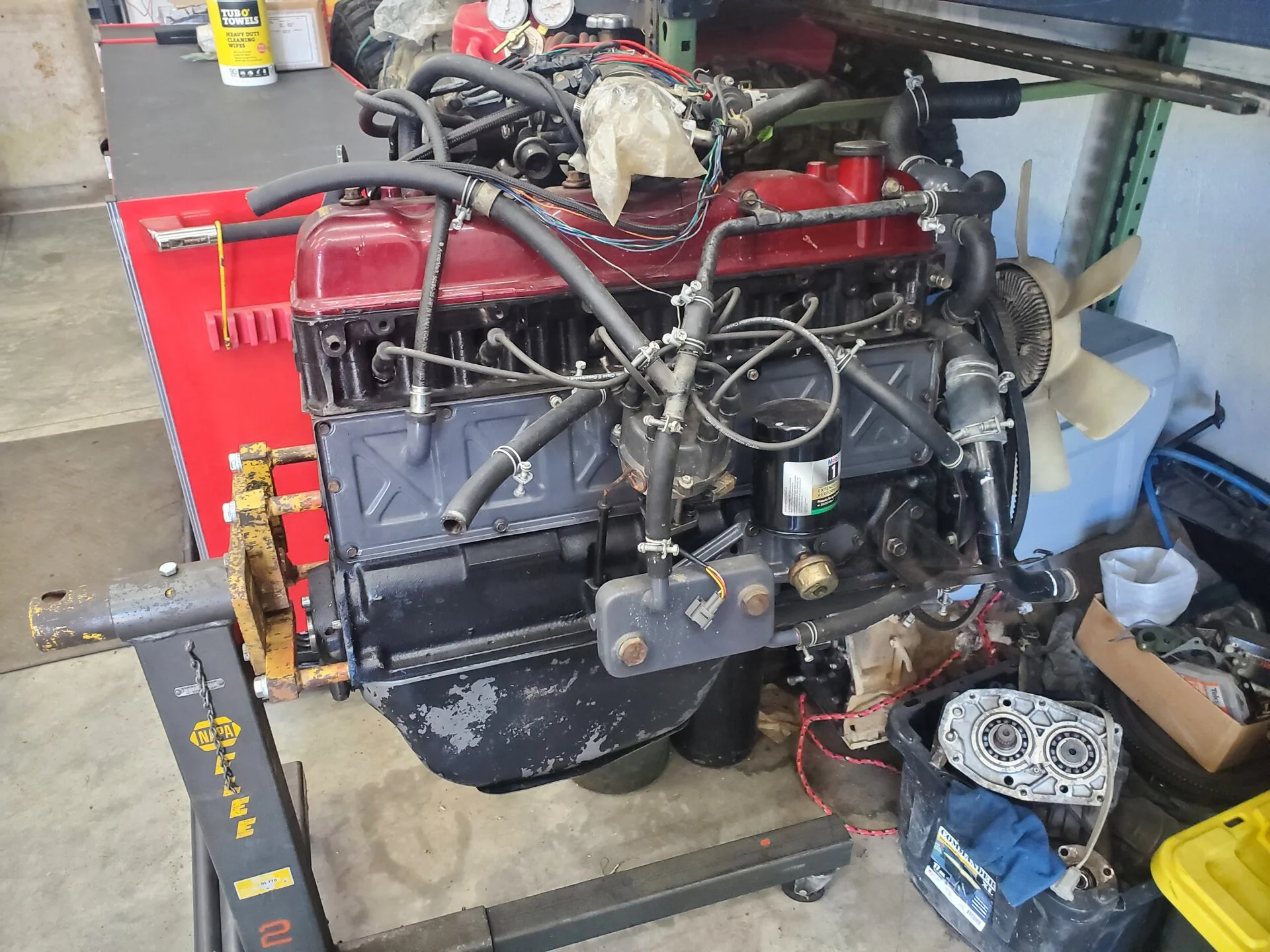

2fe now waiting.for a different host
