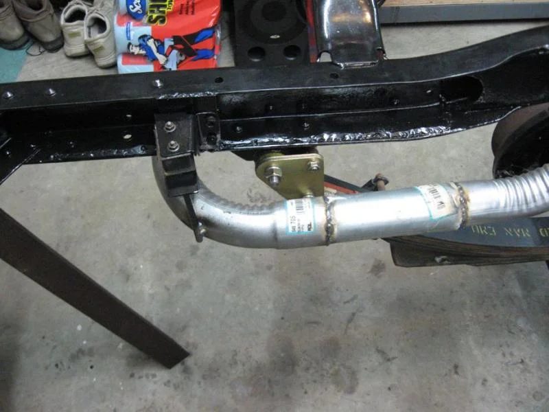

Added some support for the dual pipes
The muffler didn't show up today, so I replaced the universal joint whilst I waited
The other hangers look good.
This one will not last. The sammich type mounts are only for use in compression. They just peel apart when weight is hanging off them.
attachment.php
Edit: Looks like maybe the frame bracket could be flipped, leave the mount bolted to it, so now the mount is on top, in compression. Then extend the hanger rod so it lays over the top of the rubber mount. easy-peasy.
