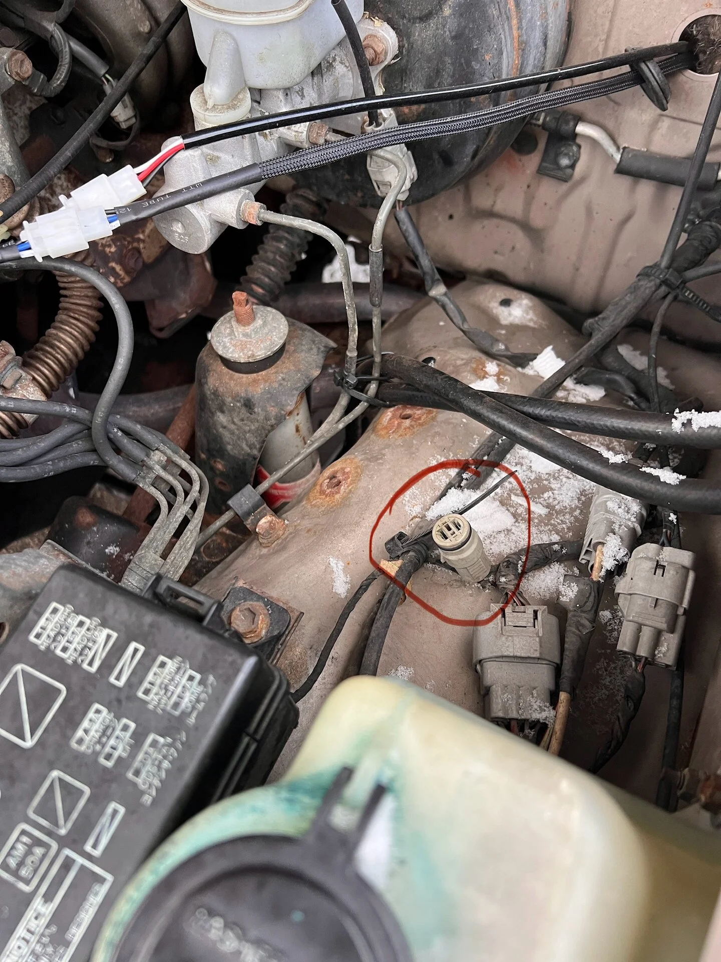

I'm rly sorry for spamming posts here but was also wondering what this exposed connector is for?

Took it to the shop. They found that the Cold start ignition time switch (or whatever it's called) harness was severed and in rough shape. They weren't able to recreate my issue oddly enough but now she starts up just fine. Hopefully it stays that way!

Buy the factory service& repair manual to help you out ......Im coming in late but the cold start injector and wiring would be part of the issue. With my 92, first thing I did was disconnect and lube all electrical connections, plugs, fuse & relay blades with dielectric grease to make them easier to disconnect/reconnect and fend off corrosion due to salt and moisture
