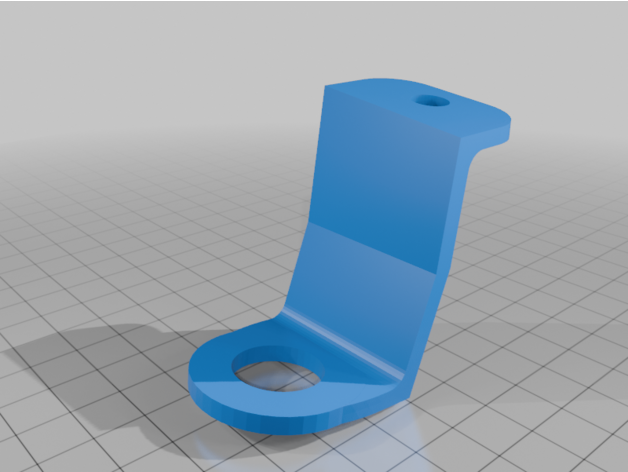

I'm gonna quote BIG4RNR's post here as well.
LX470 NMO Ham Radio Antenna Mount.
