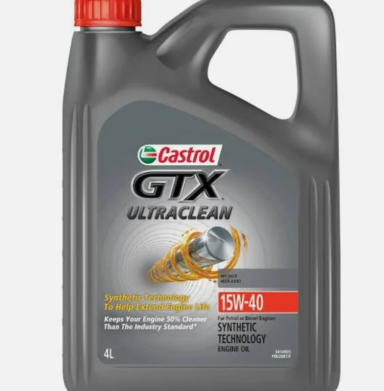

So my 3B is using considerable amounts of Oil (details I'm photo) per week, Thing is I'm not noticing or smelling much burnt oil from the exhaust or any leaks. It seems to mostly be coming from the breather pipe. I wondering if switching to a thicker oil would help at all and also why it's doing it. It's just had its headgasket replaced and oil cooler gaskets etc.
Any ideas??
Not sure if it's worth noting but when I'm driving around 100kmh on flat(ish) on full oil it sits at around 40 psi it's that normal or should it be more
Cheers.

You need to be using a Full Mineral oil.. switch oil to a mineral oil and reassess. Valvoline Super Diesel is good value at the moment in Aust/NZ. Who did the head work, surely they didnt advise you to use a synthetic oil?

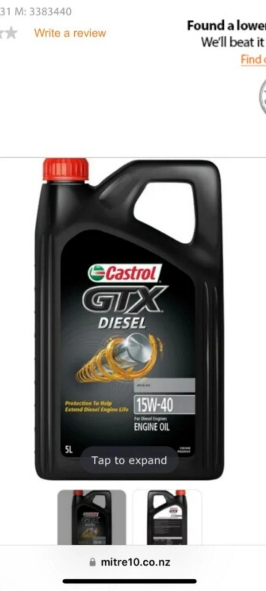

Something like this?
GTXDiesel is a great oil. Keen to hear back if your oil usage dramatically reduces or not - I have no idea why, but these old indirect injection diesel engines seem to burn through the synthetic oils quite quickly.
Yeah I'll let you know

Run mineral oil. At this point, there is chance that your ultraclean synthetic oil had thoroughly clean your old engine and now, it consumes oil.
Stick with what was the norm back in 1985
