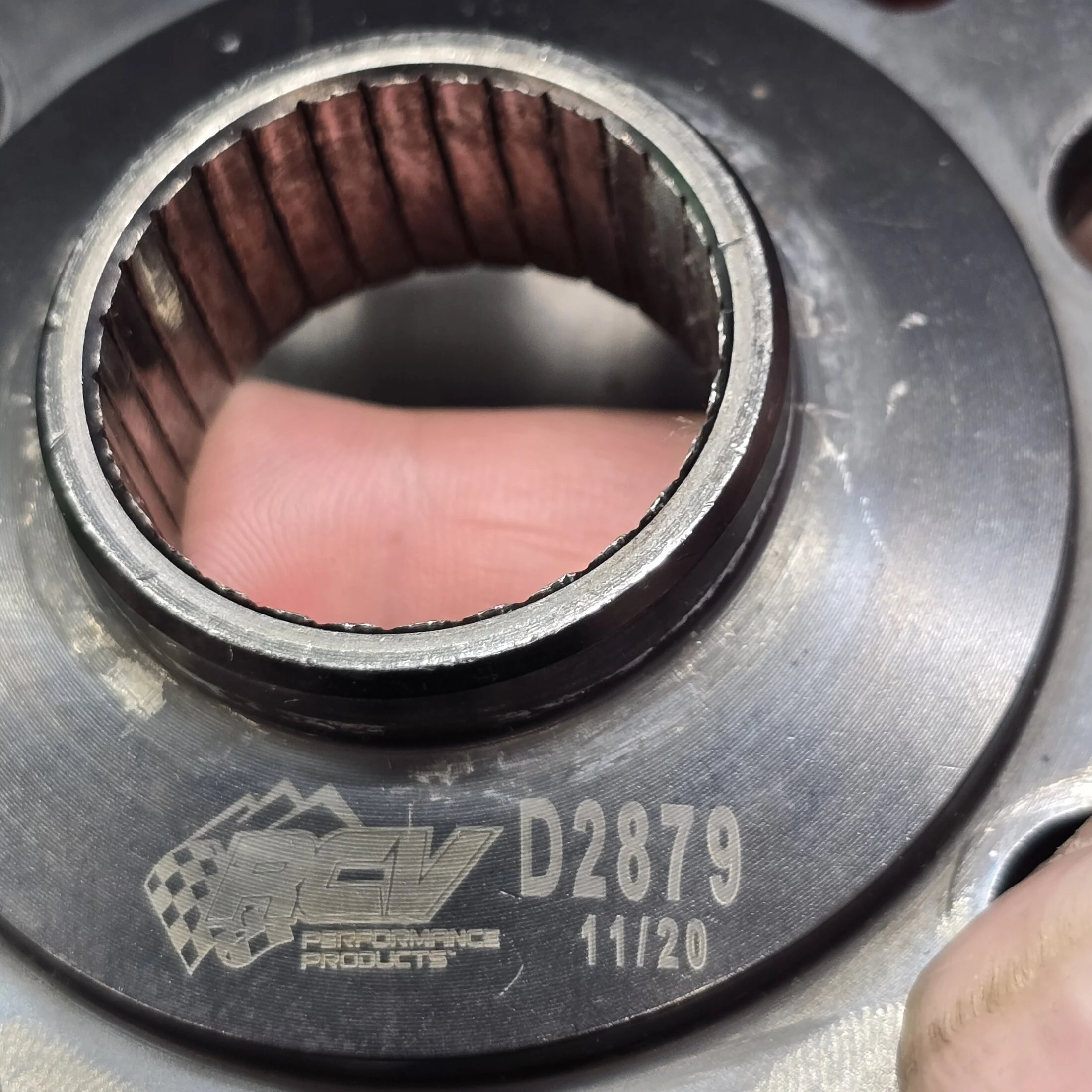

Doug, do you have to remove the tone rings and press them on the RCV's or is there one under the wrap ?
Knock them off with a brass drift and reinstall on the new birf. (Unless you no longer use tone ring.🤫)
Front is inner hub rings on the Aisins that go for me now

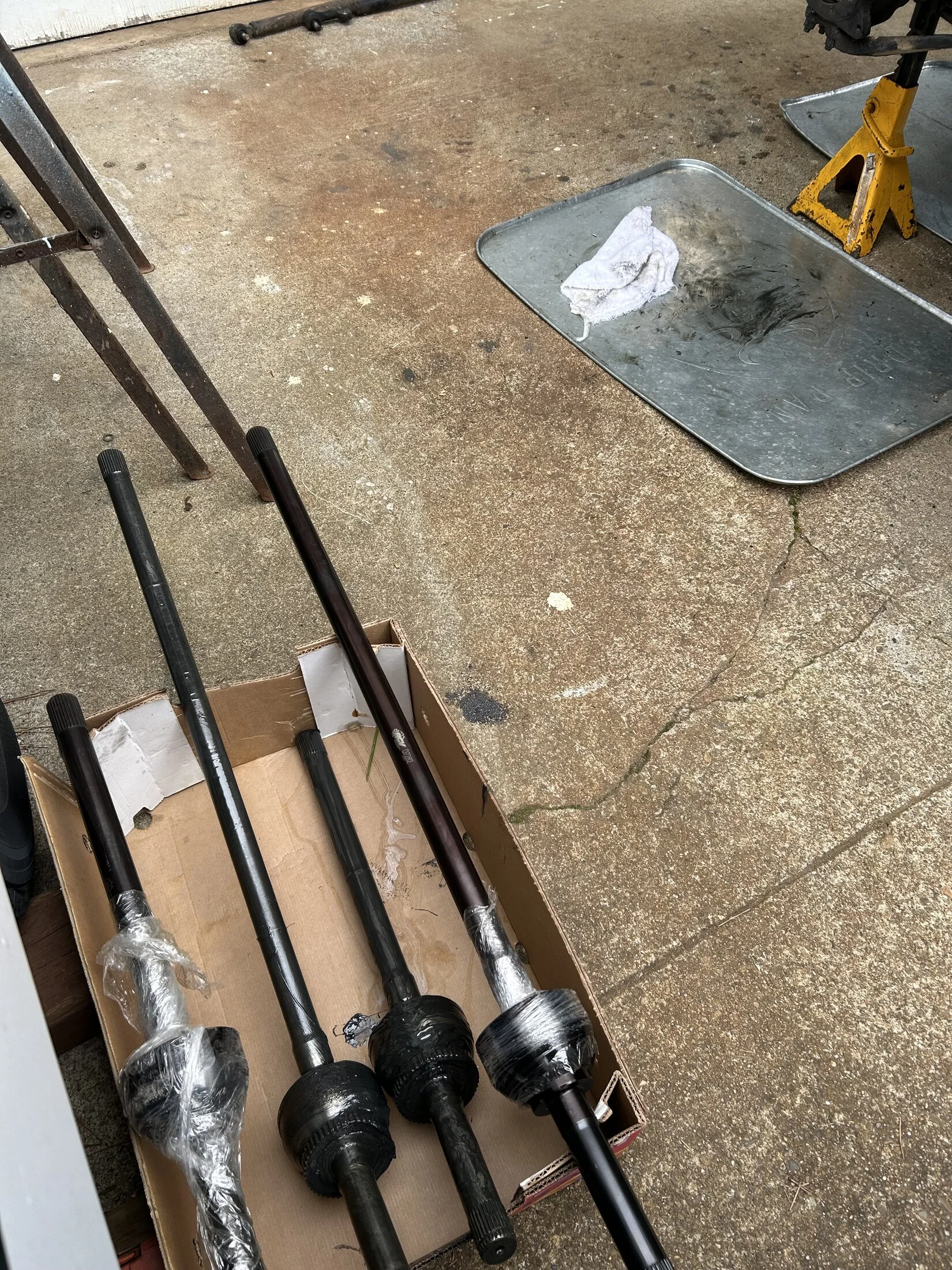

I have flanges as spares (assuming it doesn’t take out the splines on the birf stub shaft) and the old axle/birfs as spares. I’m still running 315s and made it about 300,000 miles on the originals before breaking a birf.
I've been fortunate to never break a birf on this one so far. But Longfields went in the week I bought it, and now RCVs. 37s for a while and going to 40s soon I don't expect to have a problem. Gotta keep my fingers crossed though!

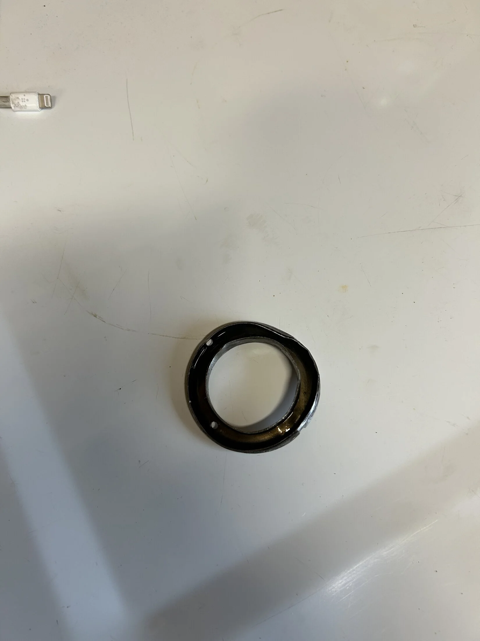

I had a hell of a time installing the long front axle shaft into the dif on the trail. I just yanked the front dif and found this baffle/guide just hanging out in the bottom of the dif housing. I guess that explains it. Amazingly it’s not chewed up. It might have been stuck to the magnet.
