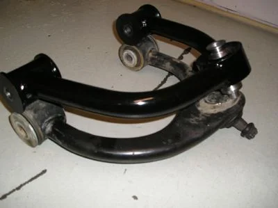

I ran some 1/4" spacers on the front of mine for a while, but I prefer the 1 1/4". Our new uniball upper arms actually clear my 315/75/16 toyos without spacers. I run the spacers mainly just prefer the look with spacers up front, and it clears ok on my truck w/ som minor trimming.

Randy: What is the effective increase in track width compared to stock (stock...without spacers) with your new UCA?
uniball a-arms
Who's randy? Im carl, but to answer your question. The track width is not changed, this is not possible unless you change uppers, lowers, steering, cv axles, etc. The Uniball arm is made of chromoly DOM tubing and is lower profile than the stamped factory arm, thats where the clearence comes from. They use a 1" uniball that is placed to run more level at ride height on vehicles with 2-3" lift. Also allows more droop than factory ball joint. We have been developing them for several months, and I finally installed the final product on mine with some fox remote shocks a few weeks ago. They use a missalignment adapter that has a taper adapter built in, so they are 100 percent bolton. Frontend aligned perfectly. I worked with a company that builds prerunners and competition baja trucks, for the design. I will get more info on here and our website soon.

Looks good!
