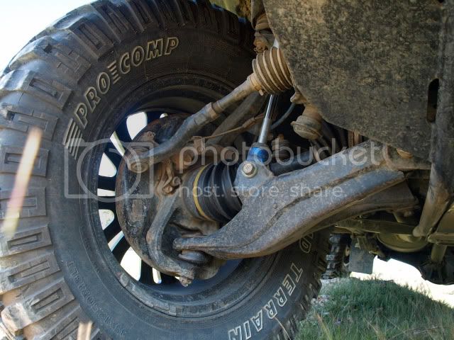

Had a good look under my cruiser today and I think this spacer on the bump stop is why my tires don't rub.

HA! Take a good look Mr Shotts:flipoff2:

Hmm, what have we been saying all along? Oh well, Shotts will dismiss it somehow, as he always does.
The laughs on you guys! Realty is I've got 160K+ miles and 9+ years wheeling with no ripped fender. Maybe my dear old Sway-A-Away's are to be cherished vs OME, etc. Maybe it's because I rely on finesse instead of skinny pedal. Either way...my setup works and incredibly for crawling. I don't jump over dunes and fly down 3-foot ledges...I crawl.
