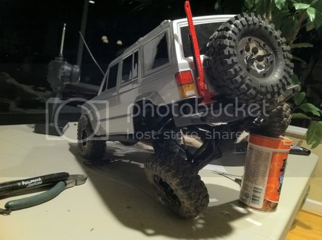

That's one sweet suspension! Those are XJ-N74L++ shocks in the rear. Then notice the front's do not rip the fender off? It's due to the XJ-SFA-BIRF-MOD.

Hey John, my 1.9" tires rub, what can I do to help this? Can I lift it higher or no? I also did the N74L long travel setup and it works GREAT. I CAN'T BELIEVE HOW AWESOME IT IS!!!!
:flipoff2::flipoff2:
pretty amazing, your RTI must be almost as good as roklimo.
