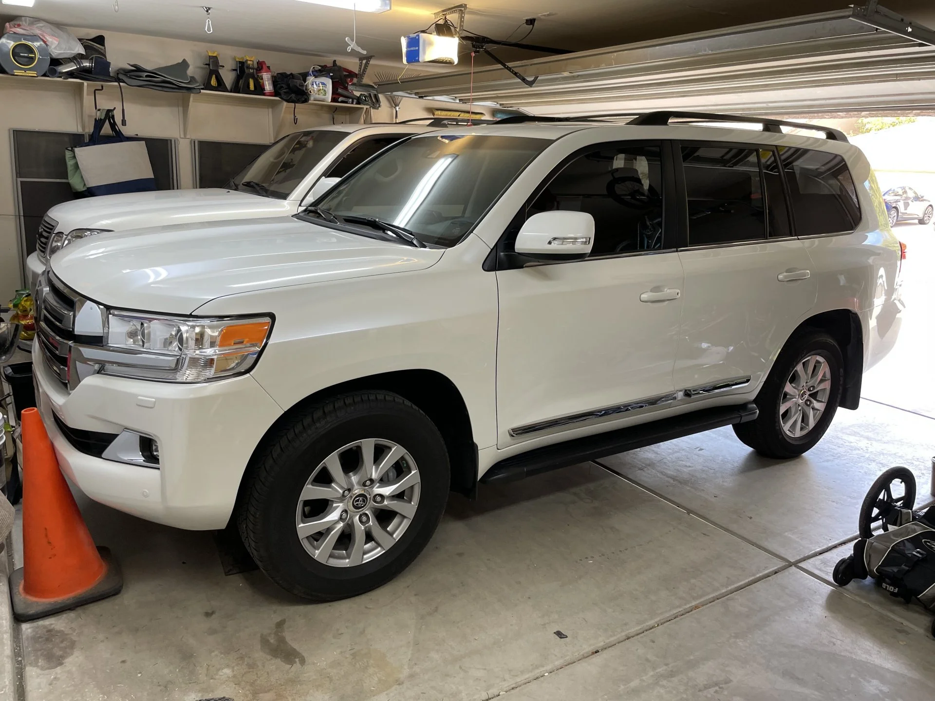

FYI
I installed the Bora 3/4" Spacers today and now the 34" tires fits and clears the KDSS. Looks like about 1/2" clearance.
With the OEM stock wheels the spacers studs fit, no need to grind or trim.
I did need to take a heat gun and bend the front mud flaps a little to clear.
The rear fit and cleared.
This is with a BP51 lift.

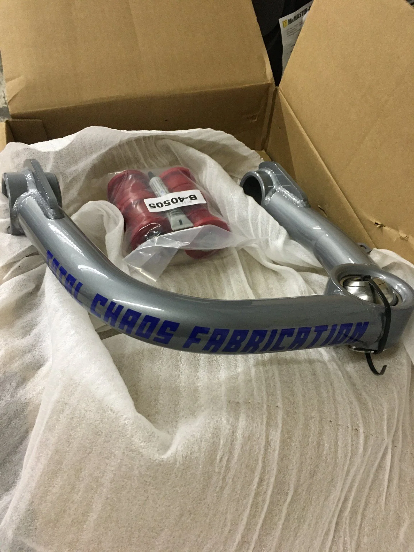

I’m debating on 295/70r17 which is a 33.31 x 11.75 with the spider trax on RW wheels . I’m using a fixed UCA compared to the SPC I have both but once you see the TC stuff no question , I got A set of SPC with a lift I bought they were free I can re coupe some $$$$
I can’t adjust the UCA forward , running a TJM T13 front is not a concern for me .

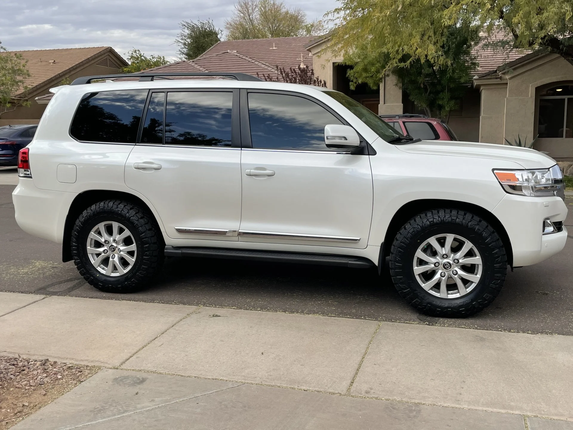

Pretty exciting day...finally received all the parts for the lift (only took 4 months!) and now it's all installed. I'm extremely happy with the on-road feel so far and can't wait to take it out on a trail. Significantly better ride than stock!

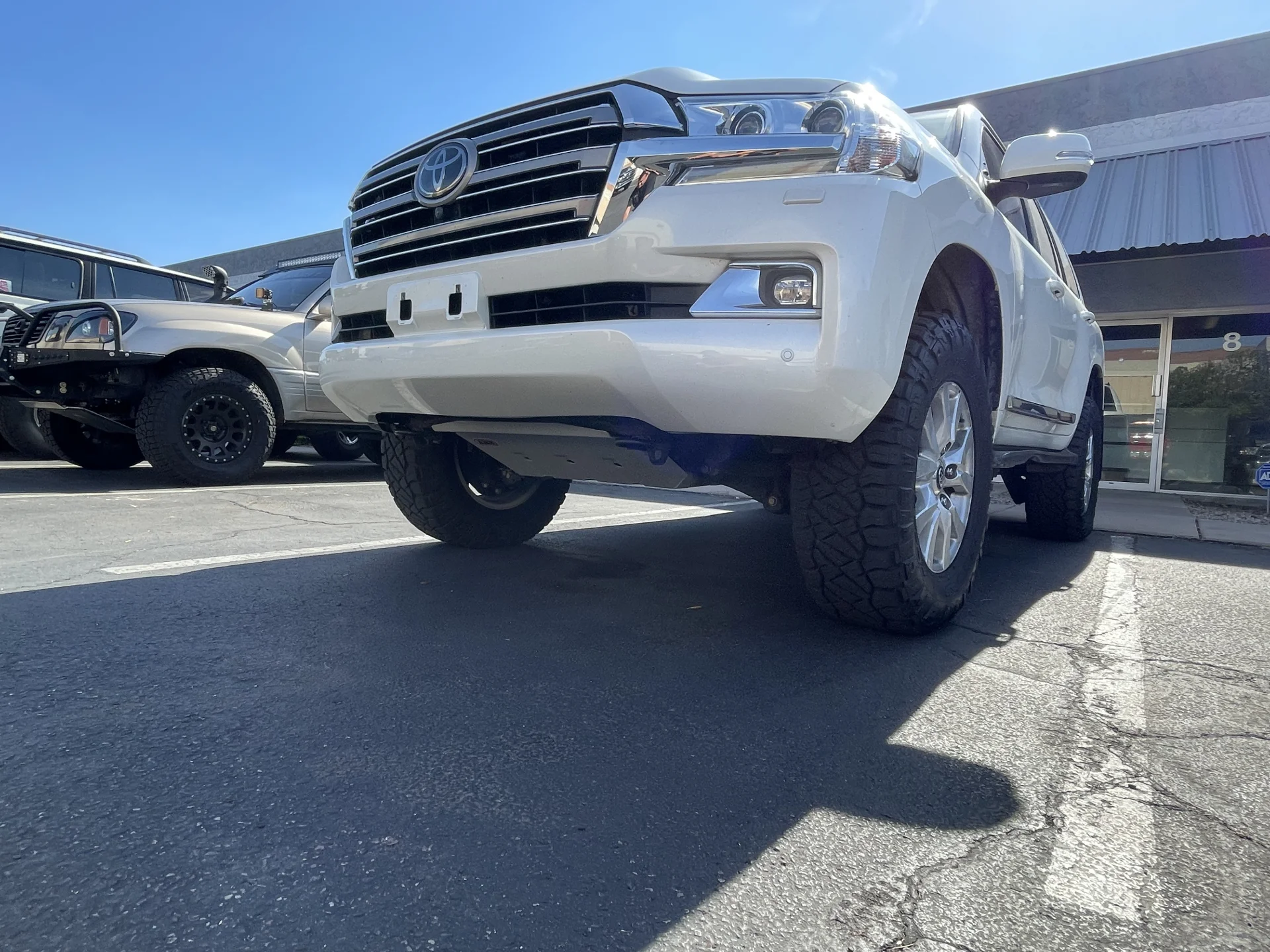

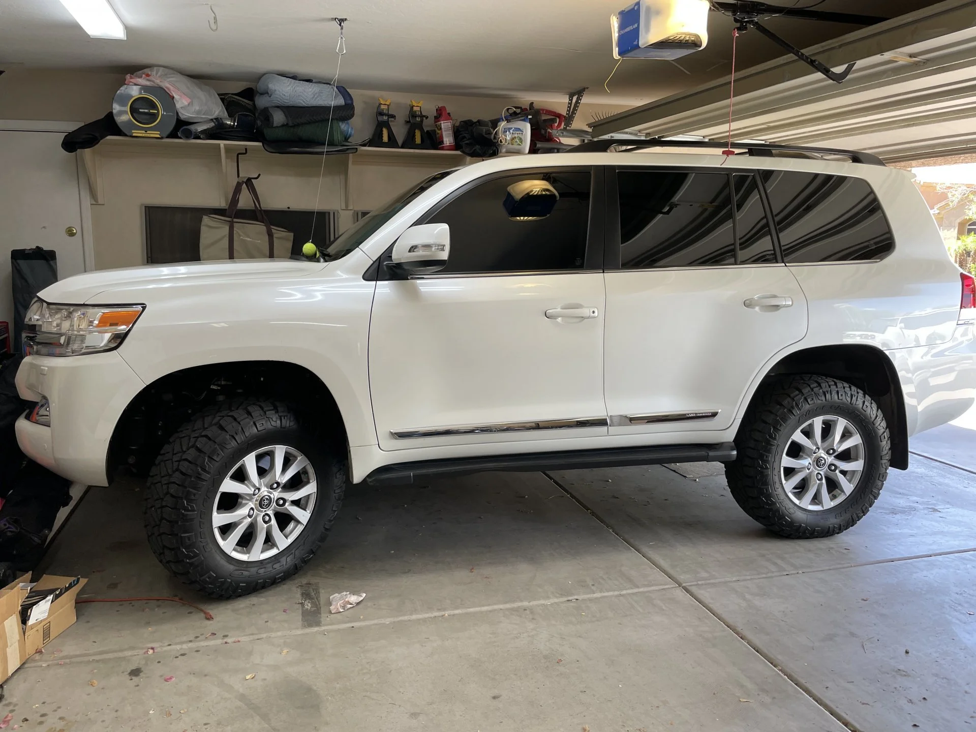

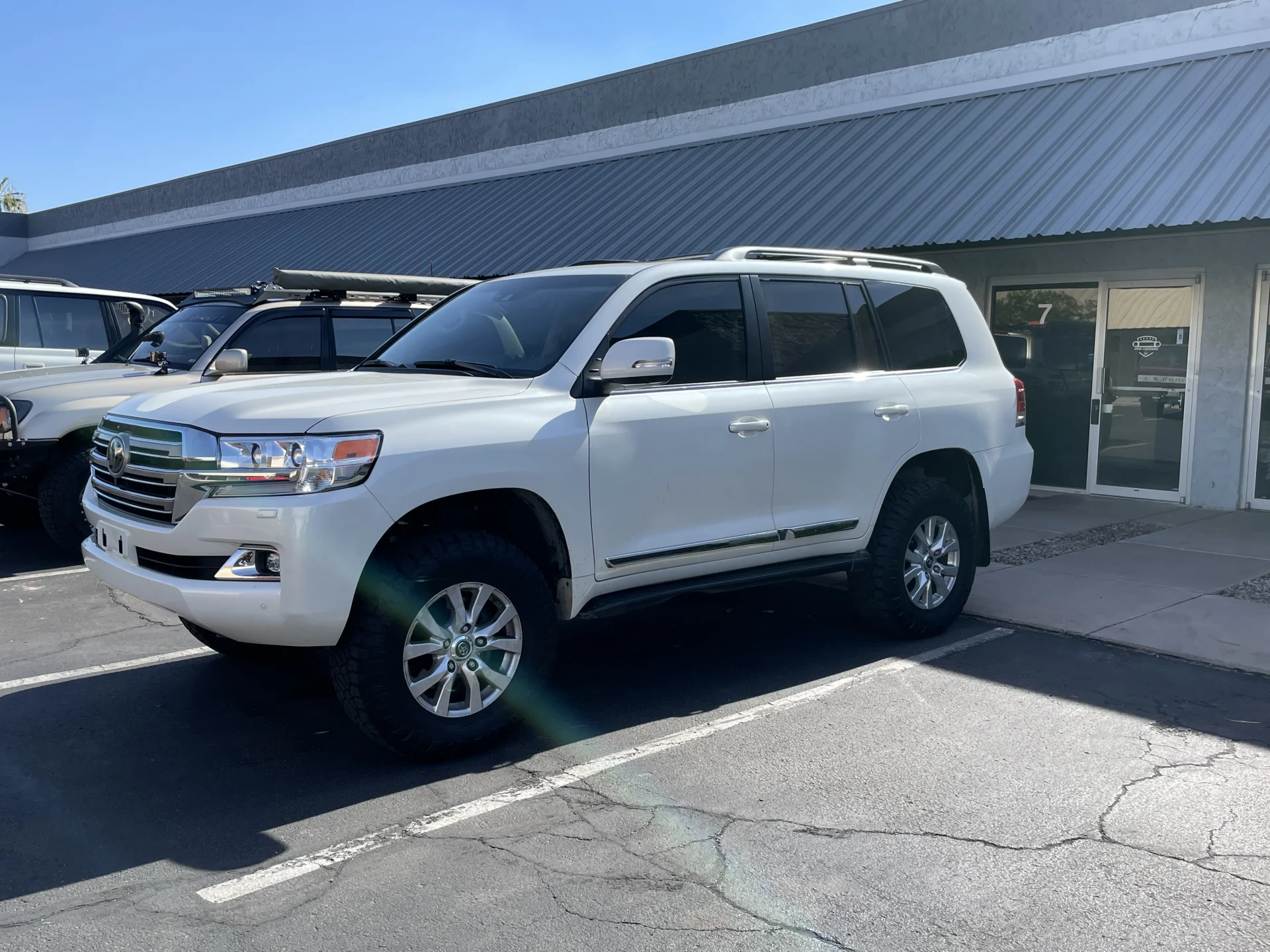

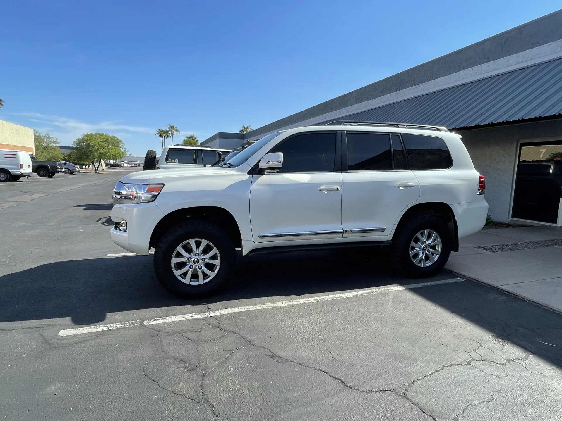

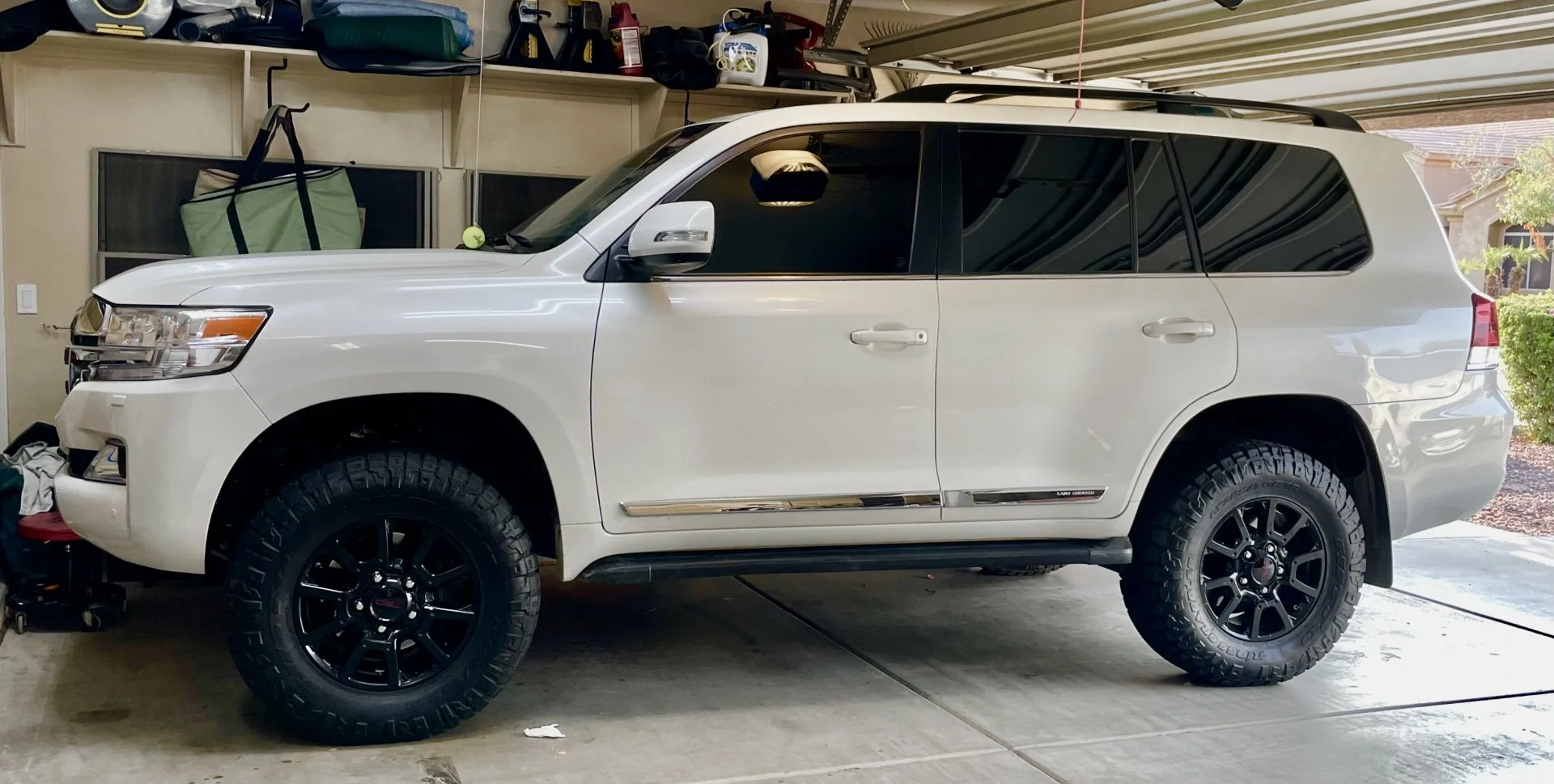

Here we are after the BP-51 lift with 2721 rear spring and swapped out to some 18 inch TRD pro wheels, Spidertrax 1.25 spacers with Nitto Ridge Grappler 285/70/18's.
With stock wheels.
Before lift w/Spidertrax 1.25 spacers and Nitto Ridge Grappler 285/70/18's
Stock:
I don’t have the measurements from before the lift though.
