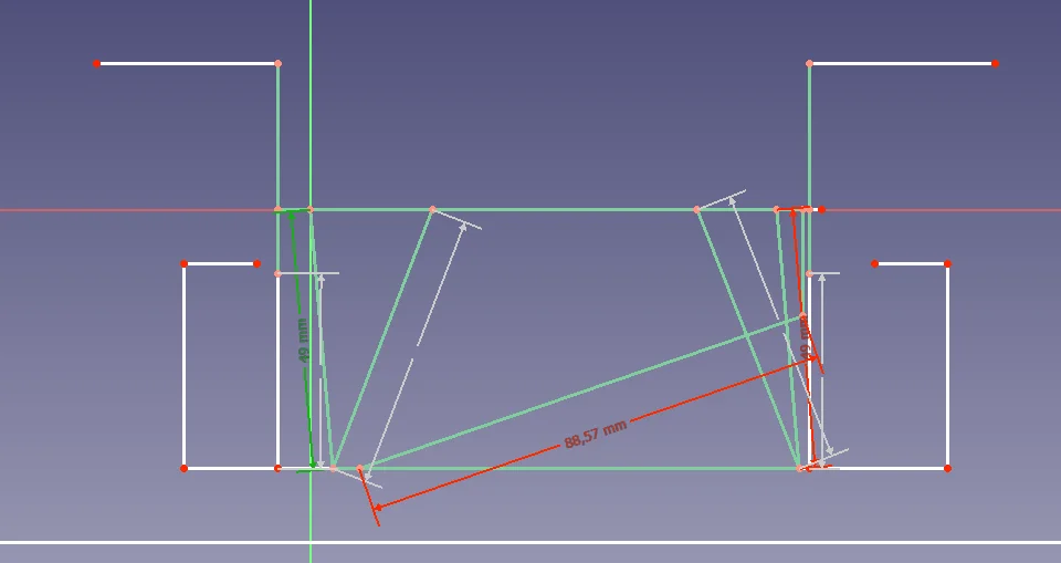

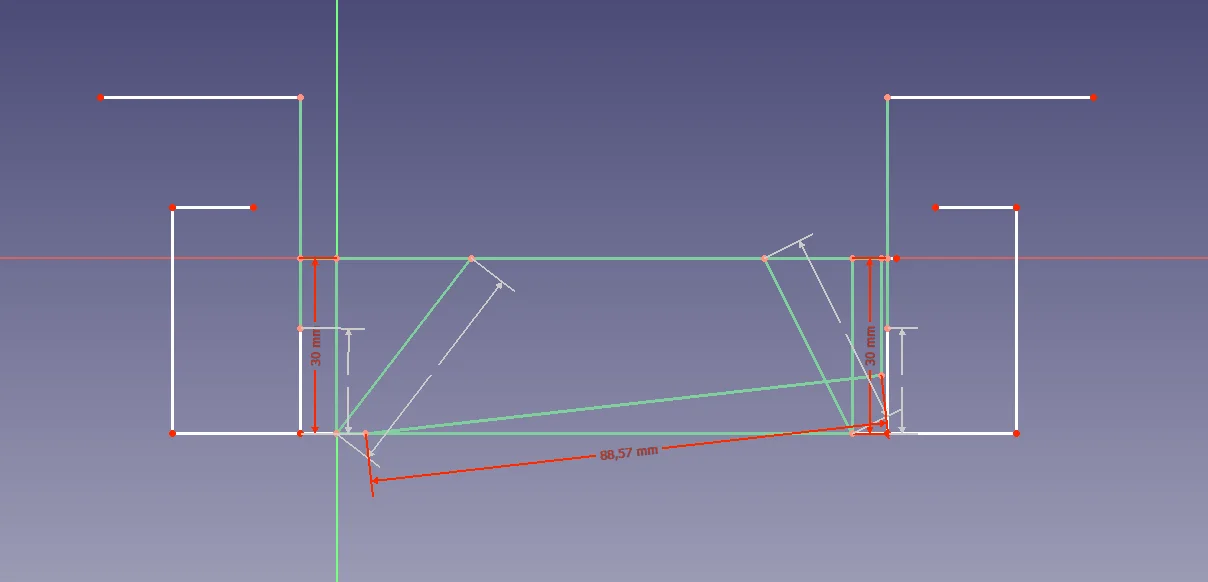

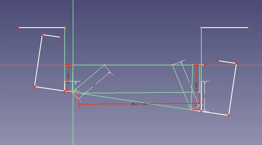

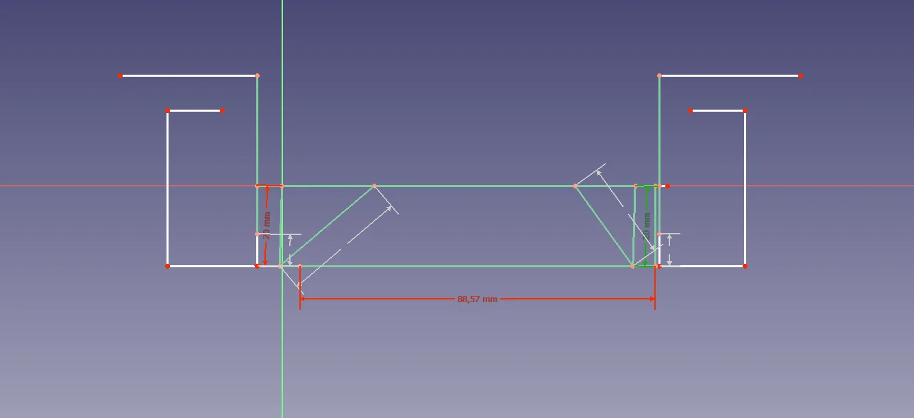

I made a sketch of the rear suspension in FreeCAD to see how 35s, the wheelarches and the air suspension will cooperate. 275/85-16, zero offset and 9.5cm lift should work pretty good.
That's 18.5cm from top of the tyre to the wheelarch and 63cm hub to wheelarch.
Since the air bags are quite long even at full compression, 20cm, the tyres will be 9cm from the wheelarch at full compression. This is with 2.5cm body lift. Suspension wise zero body lift would be best, but I have the PTO shaft and fuel tank to consider.
This leaves 7cm suspension lift (in the back).
I haven't calculated the front yet and I won't be able to do it accurately as I have the wheelarches removed, so I can't use them as a reference.
According to my previous estimates though the front should be lifted 1cm more than the back to sit level, which would be 10.5cm, or 8cm suspension lift. This should require caster correction. Rubber correction bushings are expensive and according to this thread not very durable. There's three other options:
1. Modify axle mounts, either by moving them around the axle or drilling new holes.
2. Polyurethane correction bushes which will limit articulation a lot, but they're cheap and durable.
3. Leave the caster as it is, lower the ride height a bit if it's too unstable. I would actually prefer slightly lower ride height, but as it is I have 10cm of uptravel, and I feel like less than that will be too little even for on road driving. The source for that is just me sitting at my desk and looking at a tape measure though, so I might be very wrong.
There is about 3.5cm interference between the rear tyre and the inside wheelarch at full articulation based on the 29cm travel of the springs, but according to this thread I won't get more than 20cm difference between the wheels, and in that case I have more than enough clearance. I should be able to get slightly more travel though since the air suspension will put equal force on both sides regardless of position, while coil springs puts much more force on the higher side.
The rear axle will also get stock rubber bushings for maximum articulation. Three link would be fun and I'm sure I could make one, but I don't want the hassle of getting one through inspection.
