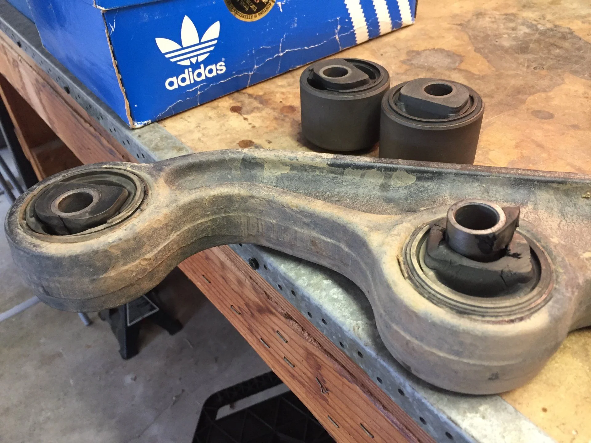

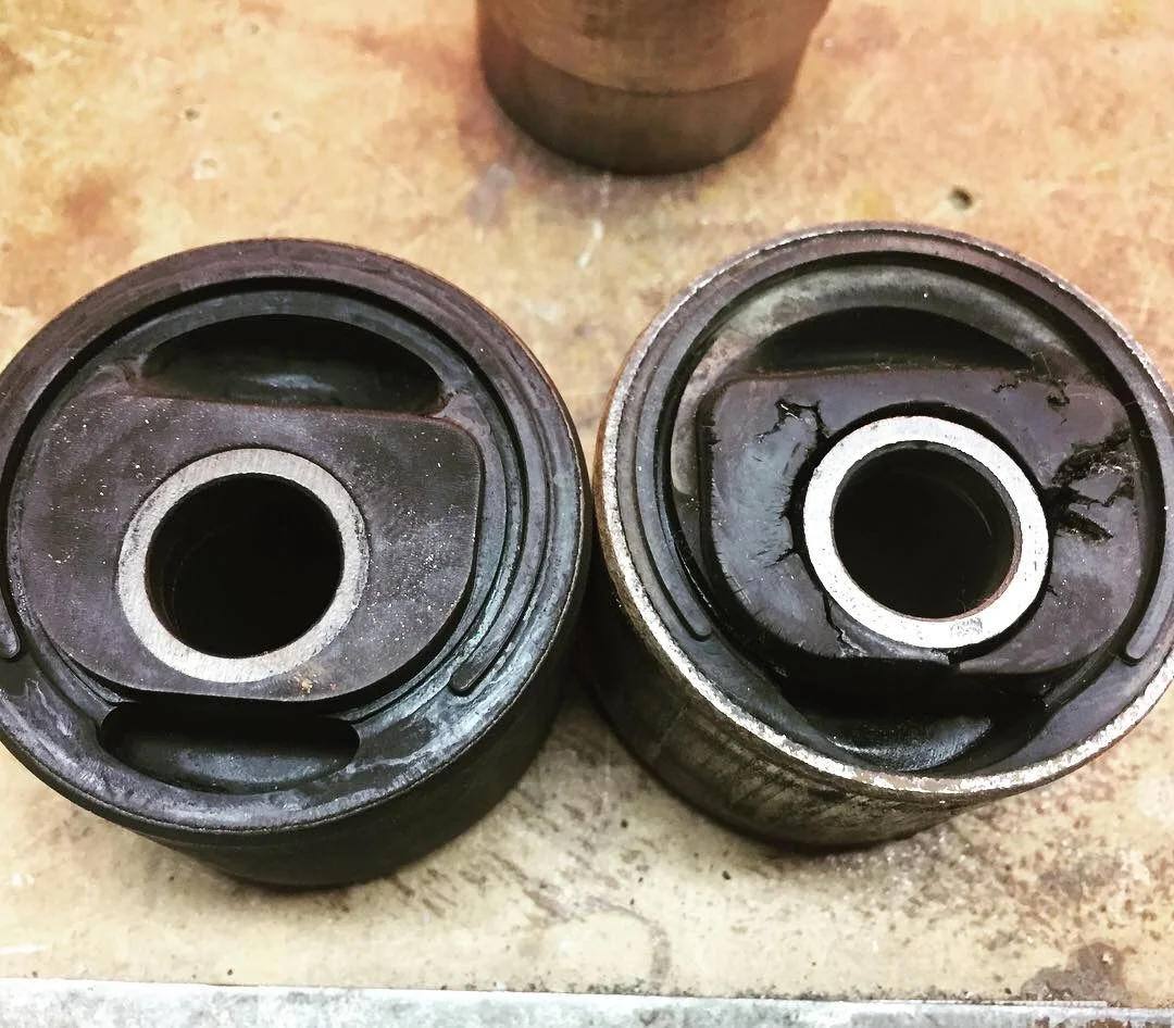

Here is my long term update/review. I had them installed September of 2017 and as of August 2019 my dobinson rubber castor correction bushings are toast. I haven't removed them yet but looking at the gap between axle mounting and the control arm they have clearly given up. Will be going OEM with castor plates. Since 2017 they (dobinson rubber) have seen a lot of wheeling but the OME poly bushings before that had lasted 4ish years with some hard wheeling, rubicon (every summer), moab, etc. I thought they would do better than the ome poly and from a flex standpoint they definitely had more give but from a maintenance standpoint replacing the front bushings every 2 years is not very ideal. Would not recommend them, go OEM rubber with castor plates. There are 2 other 80s in the family with castor plates and oem rubber holding up just fine compared to these dobinson bushings

I had similar experience with aftermarket rubber offset bushes.
The ones I used appeared well made, but failed in short order with only mild wheeling

Similar results here. The inner sleeve had almost separated completely from the rubber. I had a set in from Sept 2015 to February 2019. 50,000 miles during that time, of daily driving and monthly wheeling and camping trips on a heavy, built 80. Had to readdress caster at that time, and I actually replaced them with another set, due to them being the lowest cost option and the fact I have a 20 ton press. Won’t buy them again though. Just gotta sack up and spend some money next time. Sucks to blow out a bushing when you’re out on a trip.
