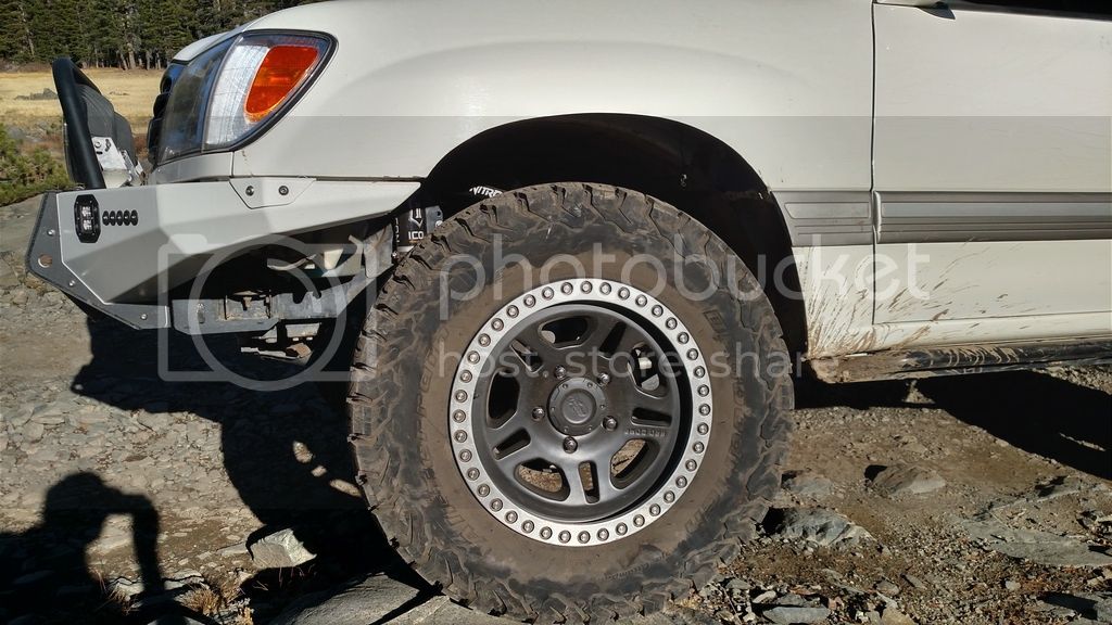

Any thoughts on whether this size will fit on stock AHC suspension and stock bumpers? For that matter the whole truck is stock for now.
Thanks,

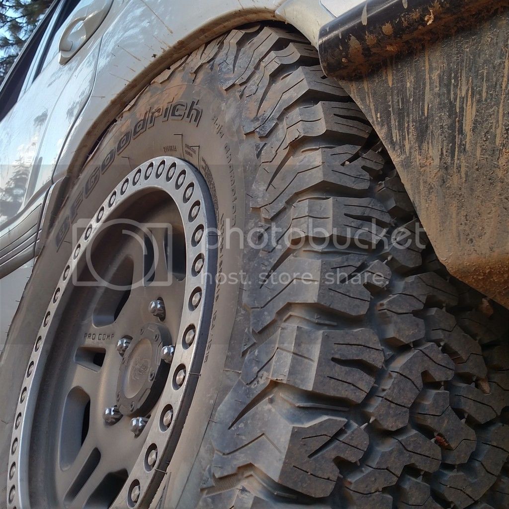

The truck I pictured second with the 305/60/18's.....that is stock. I think they 305/65/18 will fit tightly. Lift is pretty overrated on these rigs.
Sleeoffroad.com makes a switch that will keep you in the HIGH position. That for sure will work.
Thank you, I was concerned about the tire rubbing the upper A-arm. Since the 305/65/18 is the same width all's good. I knew about the AHC switch, but plan on having Slee remove the AHC and put springs and shocks on in the next month or so but wanted the tires on before I get over to Slee

That size wasn't on my radar but those look great. Sub'd to see if anyone ends up running with TV UCAs and has proper clearance.
How well does the 65 profile conform to obstacles? I realize it's still the height of a 33.5", just wondering if the tire structure is pliable at that size combo?

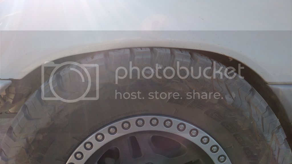

I just had some 305/65/18 KO2's installed on my 100. I have been running 295/70/18's......I never really loved these tires. They were a bit too tall (34.5") and a bit too narrow (11.25") for my needs.
While I was at it, I decided to raise my truck a bit.
I replaced the OME866's with some Slee Heavies. The ass went up 1.75" so I raised the front a bit to have a .75" rake rear to front.
