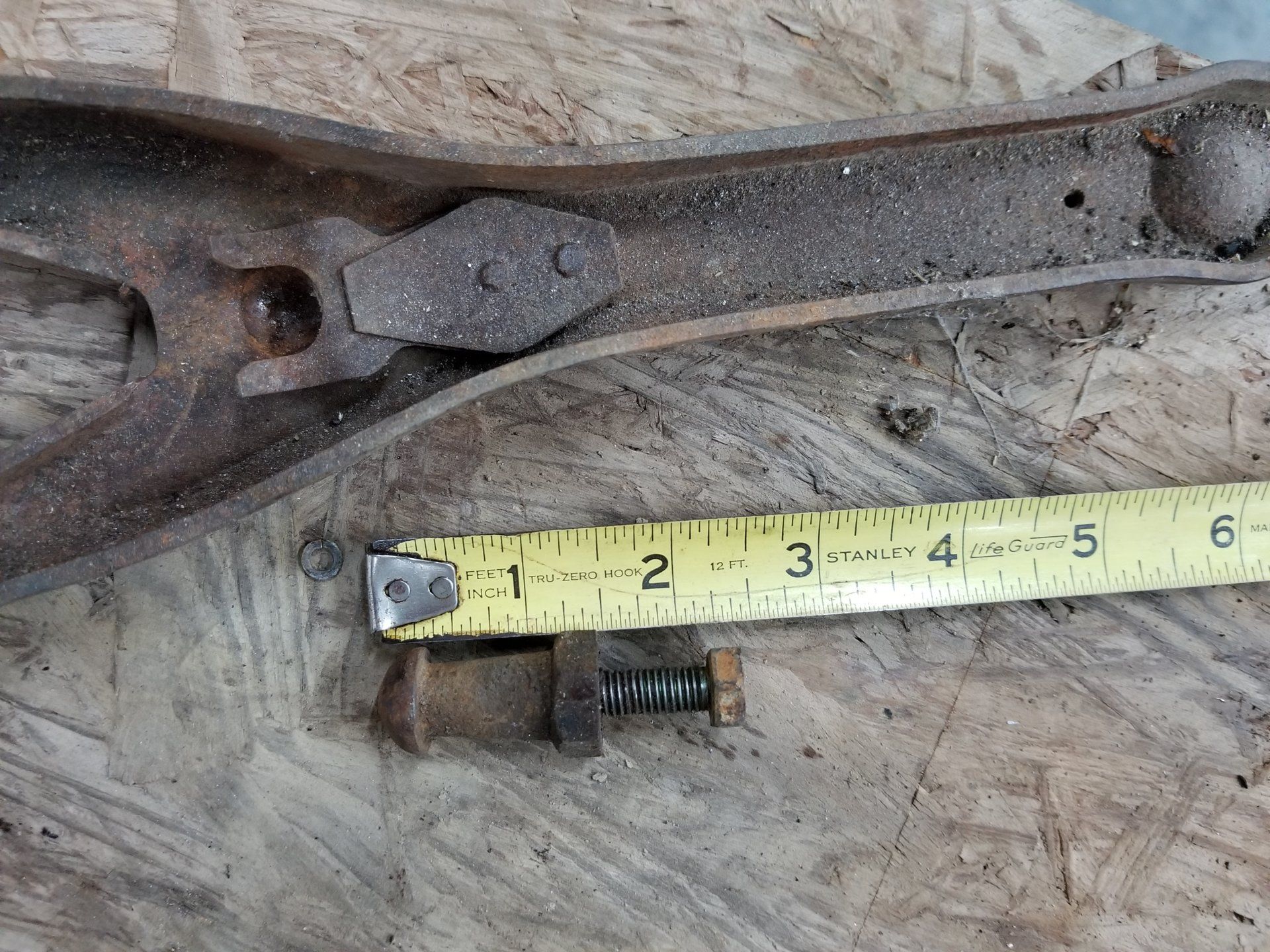

Could someone identify which of the two pivot balls in the following picture is for a 3 speed clutch arrangement?
I presume that the two pivot balls shown are OEM for 3 and 4 speeds.
So, the long left one or right short one is for the 3 speed?
imgp1930-jpg.292948
Borg & Beck is the Toyota 3 speed, OEM style pressure plate that would be part of a 3 speed clutch arrangement. That is what I need to identify the correct pivot ball for.
Makes sense the 4 speed pivot ball would be shorter because the later fork is a thicker cast iron.
Mark’s Offroad Enterprises in California would know what’s what. @65swb45 :cheers:
Long one for the 3 finger; short one for the diaphragm.
