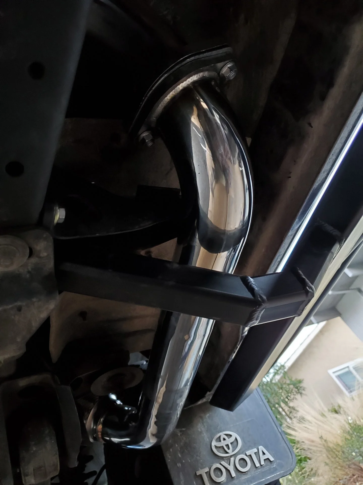

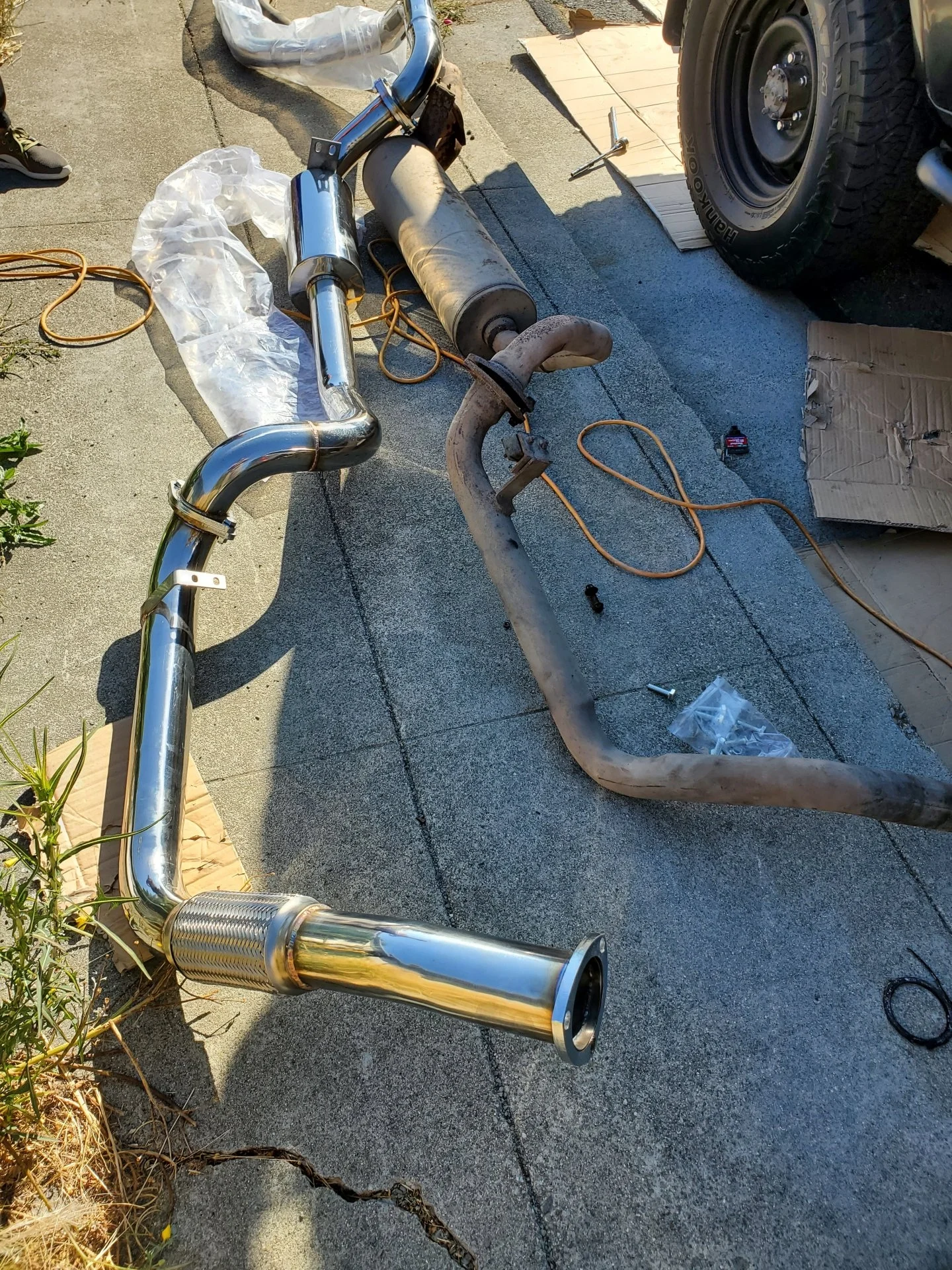

I just installed a 3" ppd exhaust yesterday. I really like the Beaudesert but for the price I got, you can't go wrong. I might modify for a 3.5 downpipe. Installation was overall easy. The downpipe that came in mine was slightly touching the frame.
It's not as loud as I expected and which I like. I had it sitting here for months and should have installed it sooner.

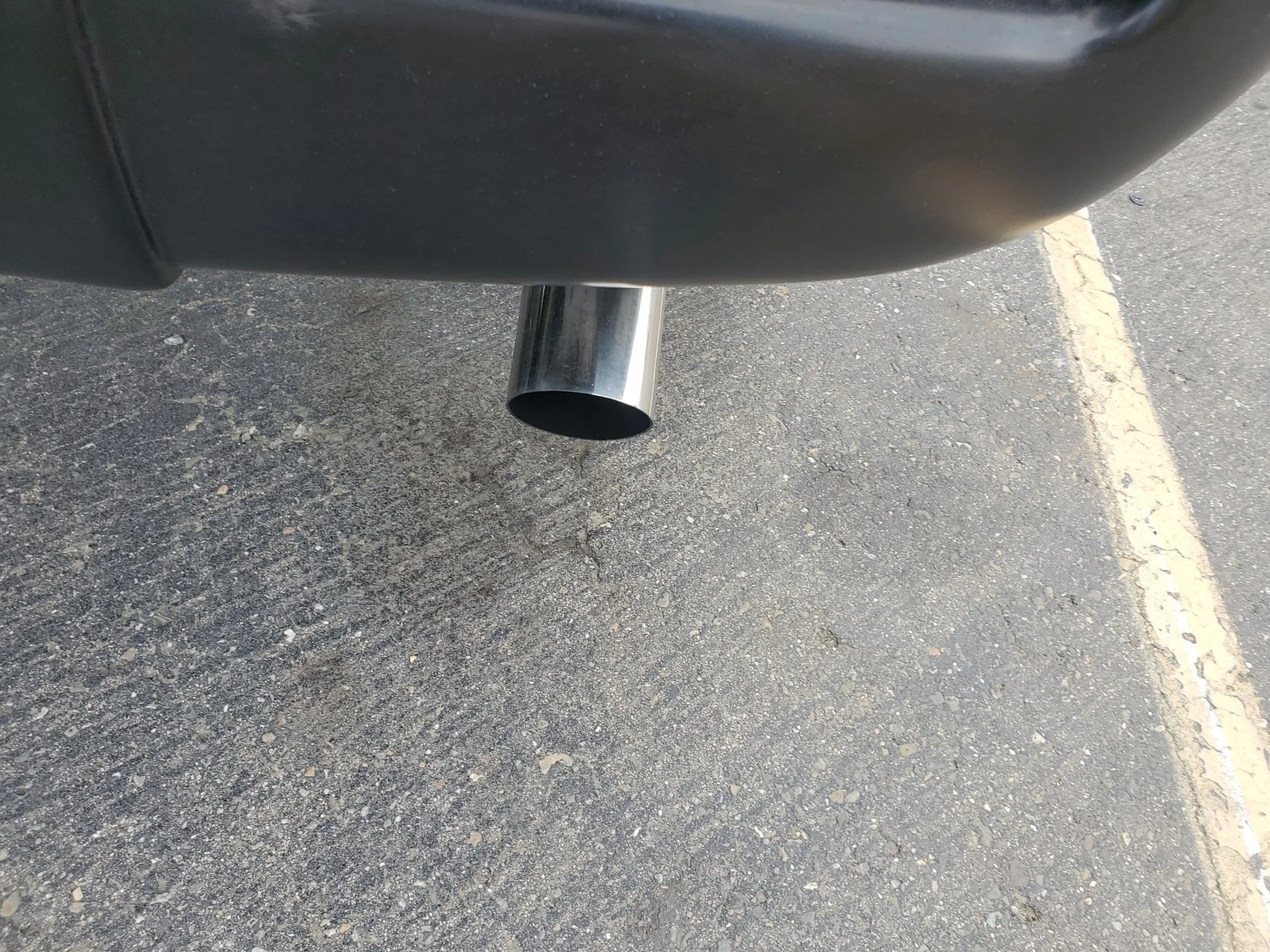

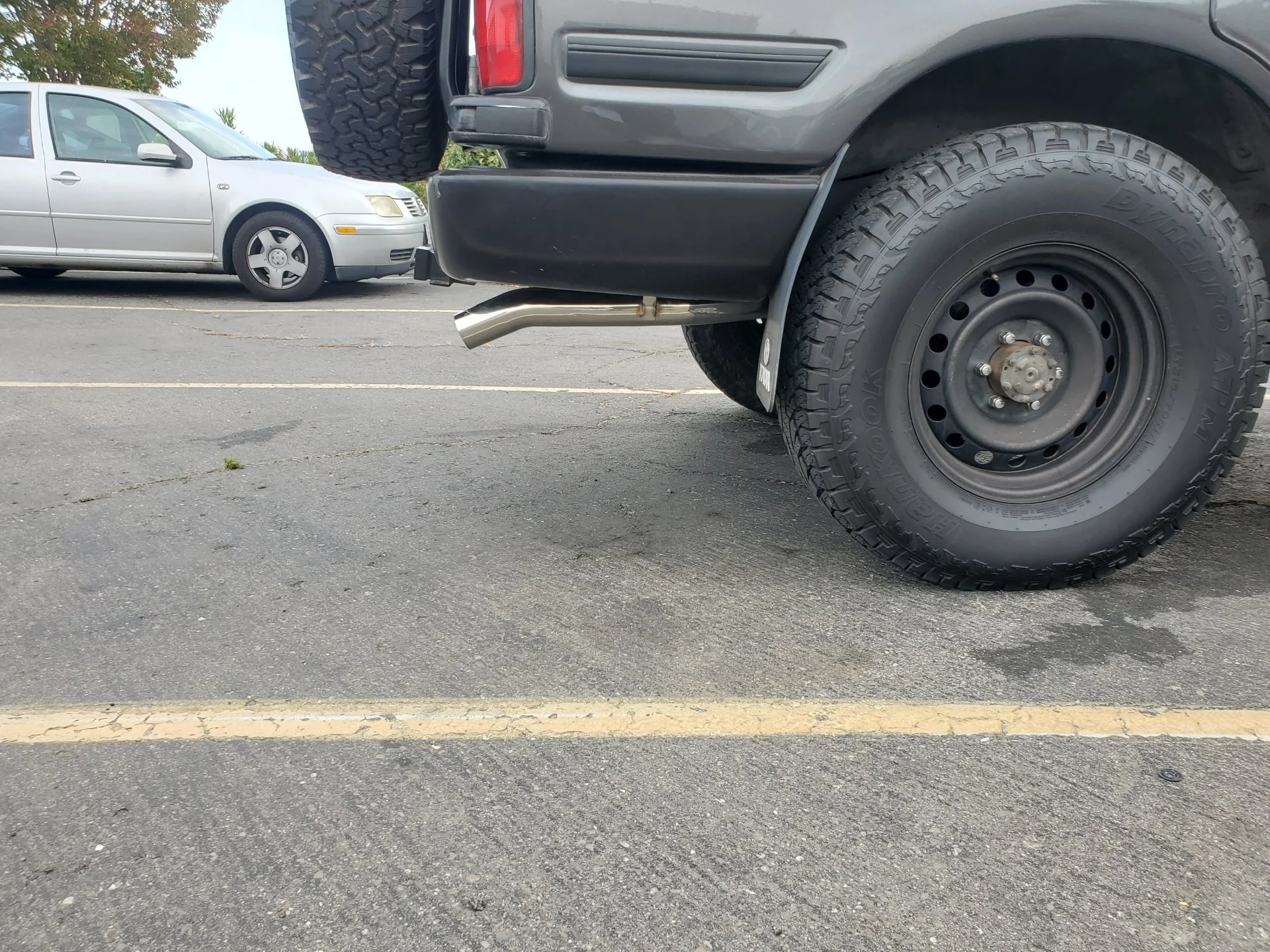

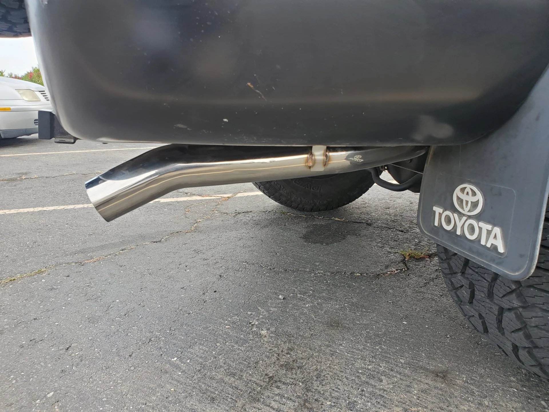

Definitely!! Almost anything in 3" is an improvement over the stock setup. The rear tailpipe section hangs a bit long. On an inclined its almost certain that it will scrape.
Can you post a pic of the rear section showing where the tip ends up? I have a custom rear bumper I want to make sure this would fit with.

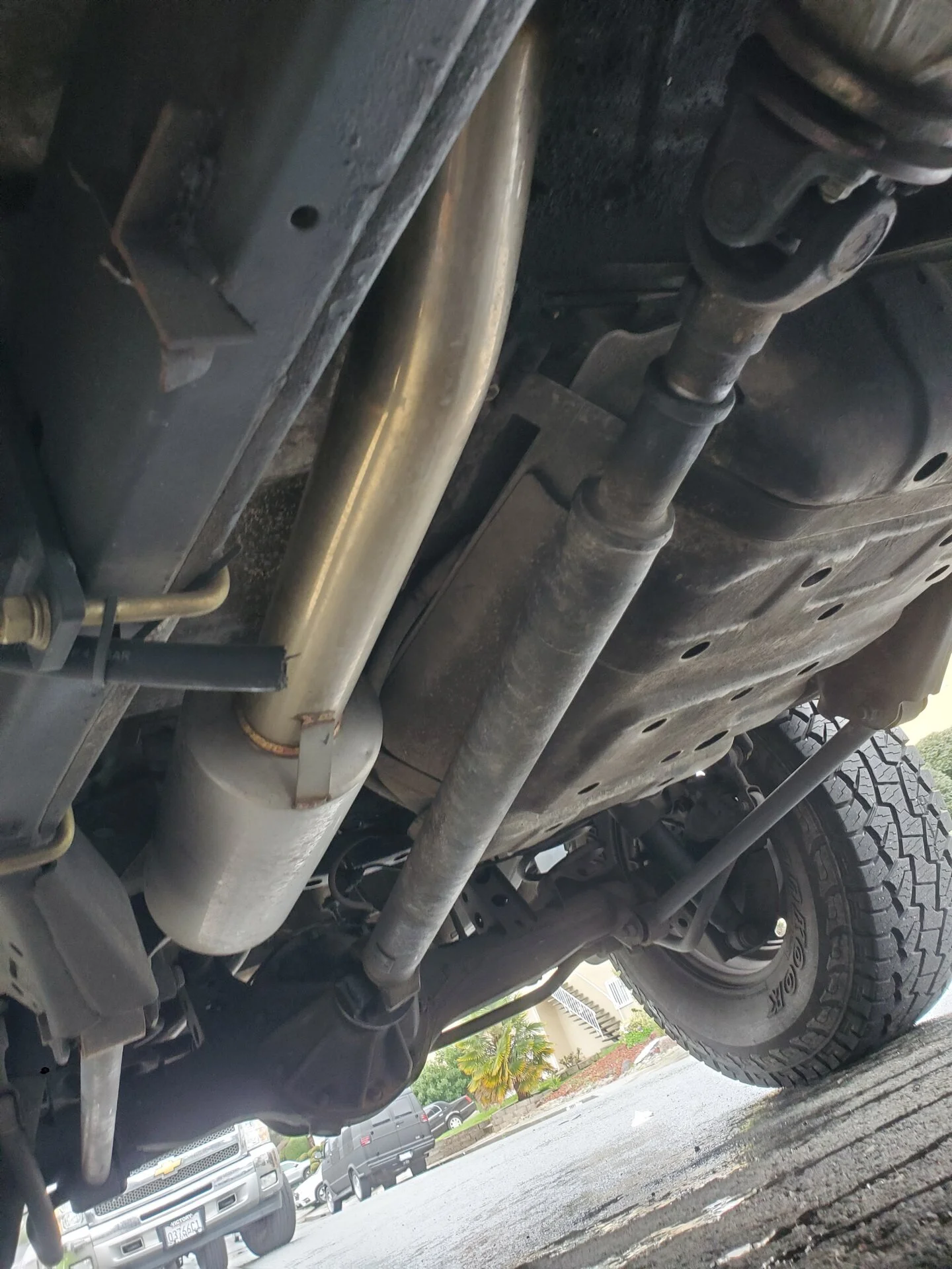

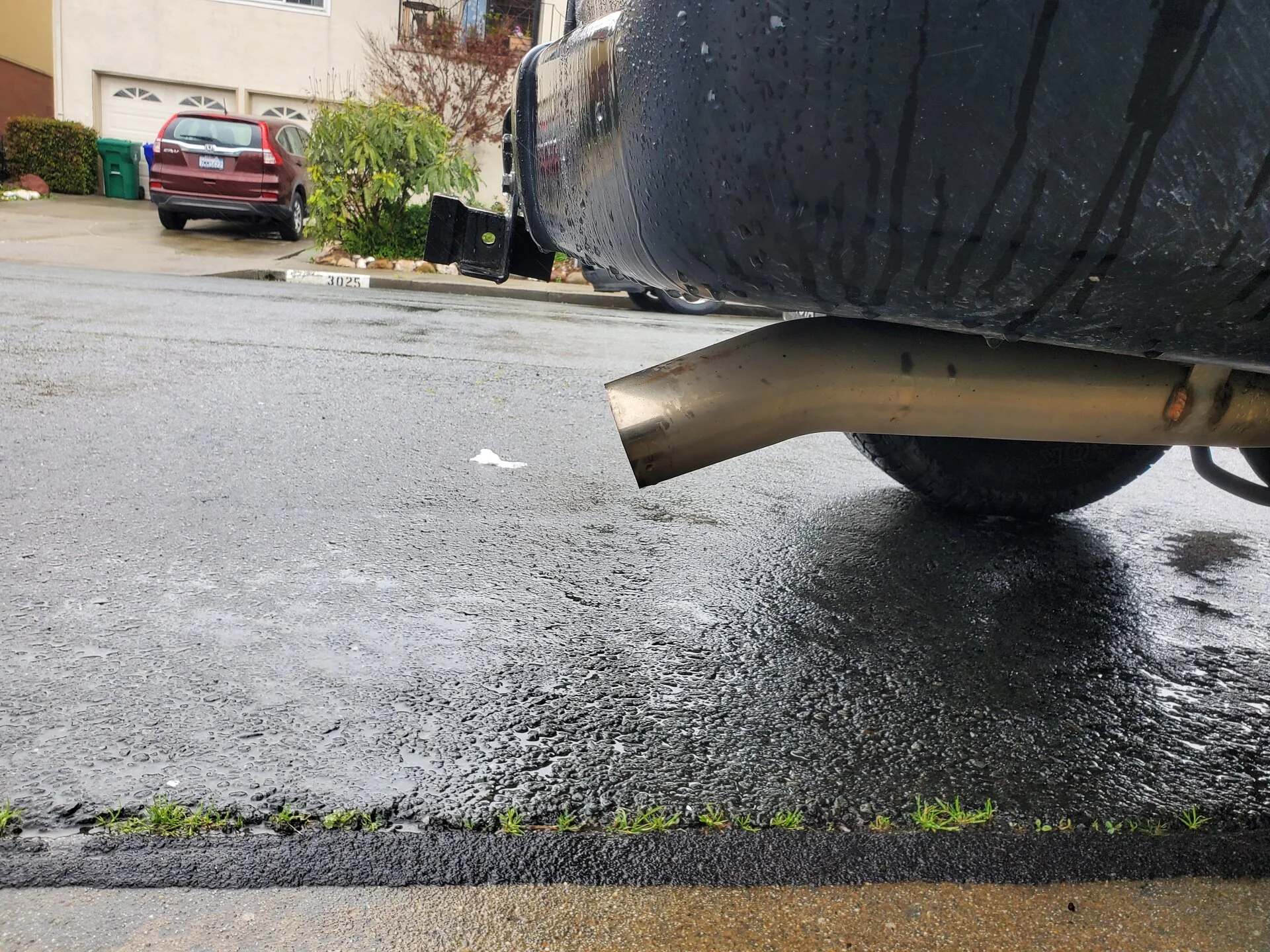

@chelo - How is the PPD exhaust holding up? Any exposure to salty roads? Can you share a few updated photos to see how its doing?
When I get home I can take some pics. Overall I'm pretty happy with everything. No exhaust leaks which I like.
Only when going to the Sierras would be the only time i encounter salt. I wash all my cars before going and when coming back so really no issues.

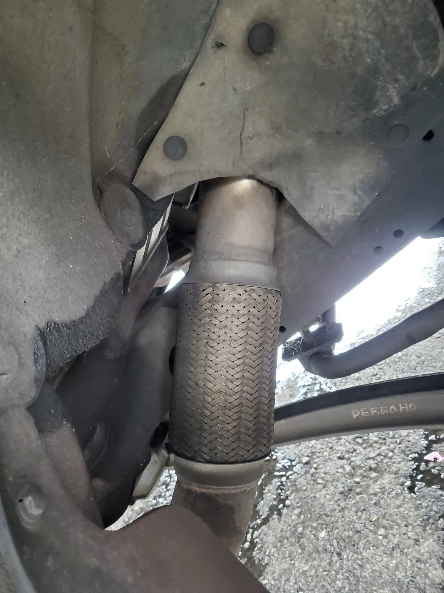

Here are the pictures I took a few minutes ago. I haven't done an under carriage clean in some time. I rubbed my finger across the stainless and it actually brightened up.
